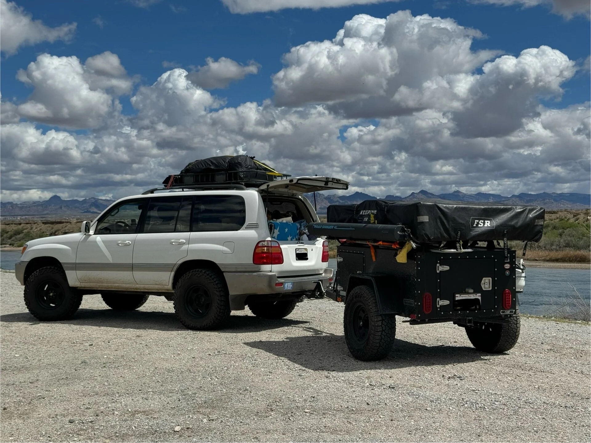

Had a week on Mojave Road and Offroading around Joshua Tree in dry and muddy conditions. Tires performed great, suspension worked great. I might have to dial it in a bit more on the rear, but will only start working on it once I have my front and rear bumper with all day to day weight.
The rear coils also seem to be right. Once loaded with our "family of 4 camping gear" + a small offroad trailer the car was sitting nice and level. So skip the trailer of a friend, add the rear bumper and it should be comparable.
Yes, I would do it again!
