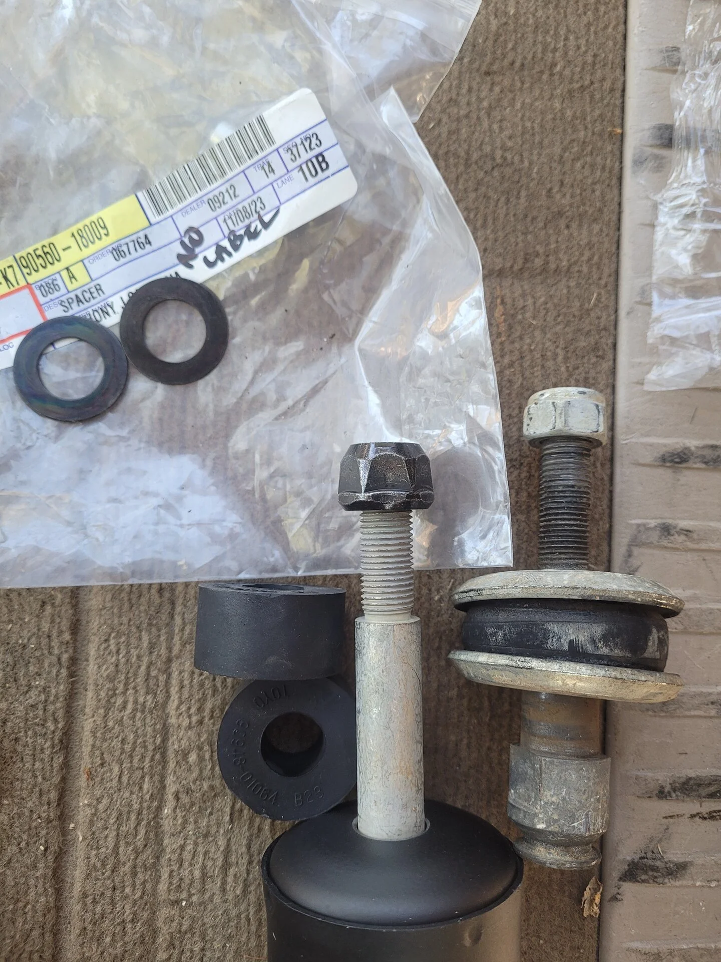

The 2 Bilstein shocks I'm removing each have 2 cupped washers with a rubber spacer between them, at the top of the shocks.
The new OEM shocks I received each come with 2 thicker rubber spacers (90948-01064). Do I need these? How should they be placed?
The dealer also said I needed these 2 washers, part number 90560-18009, but I can't figure out where they should go. They're nowhere near as thick as the washers that I removed from the lower shock mount.
Any assistance is appreciated!

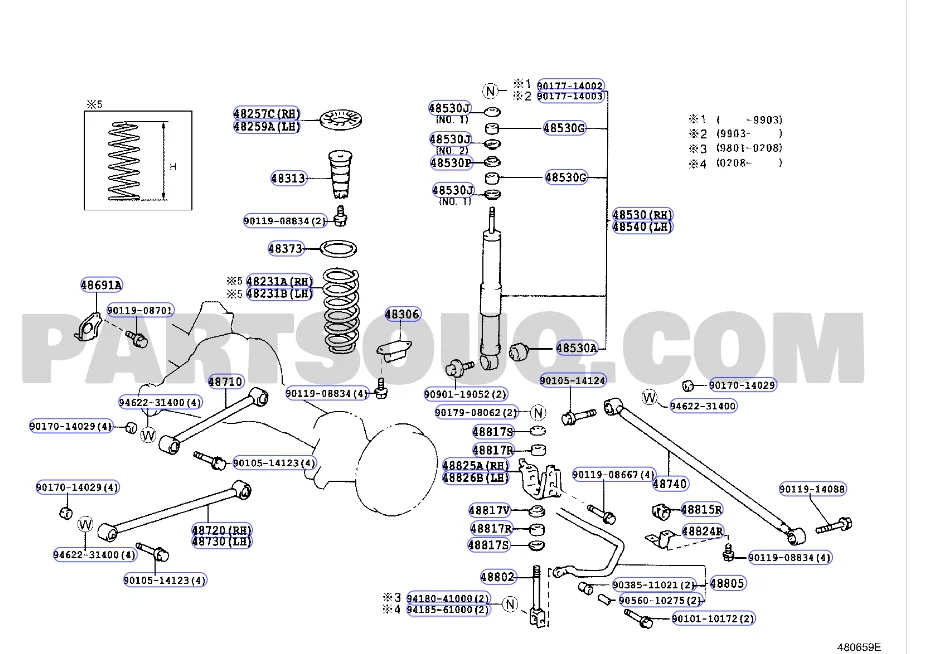

There should be overall 3 washers. First goes into the shock stem, then a rubber washer, then 2nd washer and then mount the shock to the frame and then rubber washer and then the last metal washer.
Enter your VIN into partsouq.com and go to power train and chasis. Scroll to the bottom and explore the parts diagram.
I didn't see the old rubber and metal washers above the shock (they were still sitting there). Makes a lot more sense now, thanks.
