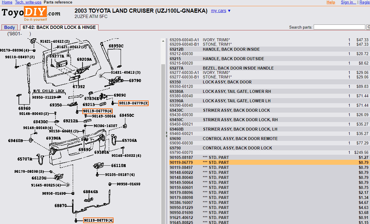

I'd like to bump this up, and "revisit" it as I'm about to replace the rusted handle assembly on my 2003 100, and ai need to source the two bolts for the handle assembly { P/N 69090-60020 }.
I'd rather not make the trip to a dealer, hoping somebody has a part number for the bolts so that I can order them.
Thanks.
90119-06779 - 3 pcs
Just out of curiosity: Are you guys able to access this web page in the USA (with the diagrams showing properly), or is it banned?
