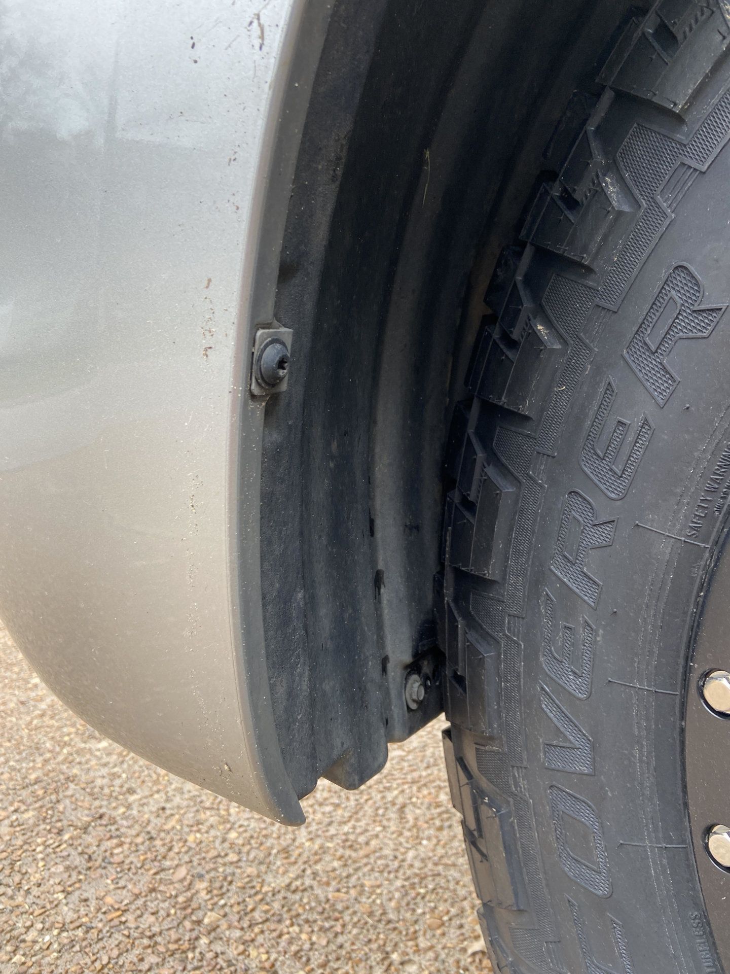

No issues in the back of the front wheel well that I've noticed so far. I removed the mudflaps and no issues there at all.
If I crank it all the way to the right, the front left edge of the left tire is rubbing the bottom of the front fender liner and vice versa on the right side if I turn it all the way to the left. I'll try to get a picture of it tomorrow in daylight.
Ah. That would be the 25mm offset.
Below is where it's rubbing in the front wheel well. Is that a "heat gun" fix or something else?
Oh there. That’s a push the liner forward fix. you take out the three vertical screws, push the liner forward an inch or so (reuse the existing holes) then cut a slit and put the z clip back in for screw three. A couple write ups around, someone did it last week. and took a couple pics. 10 or 15 min per side
Here:
Here:
Perfect! The pictures are worth a thousand words. I got one side done this afternoon and will do the other tomorrow.

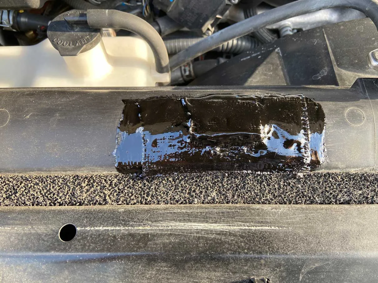

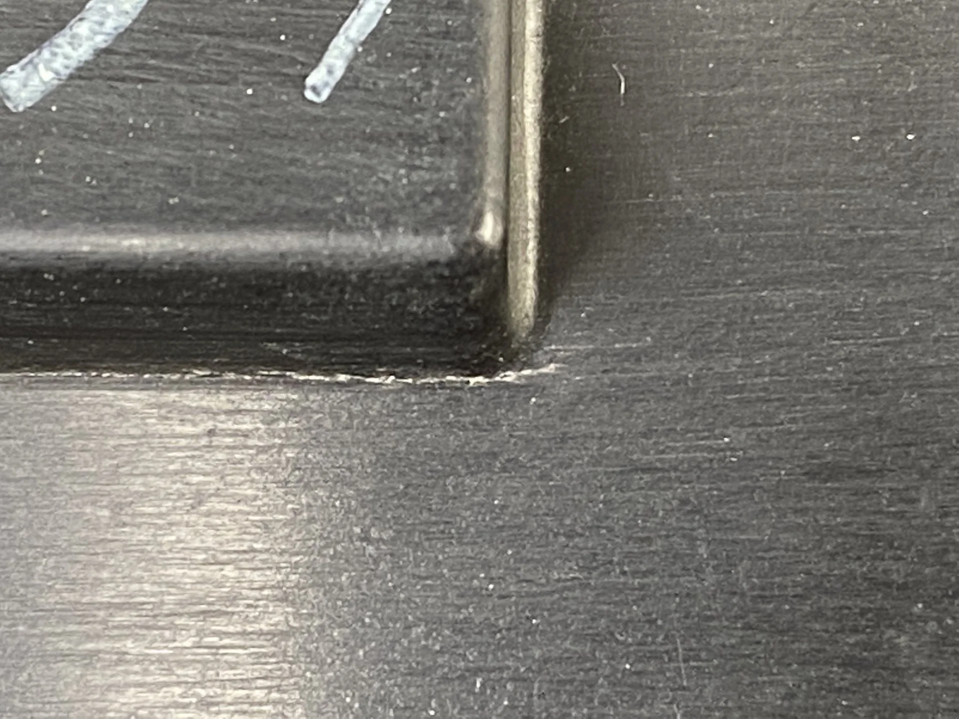

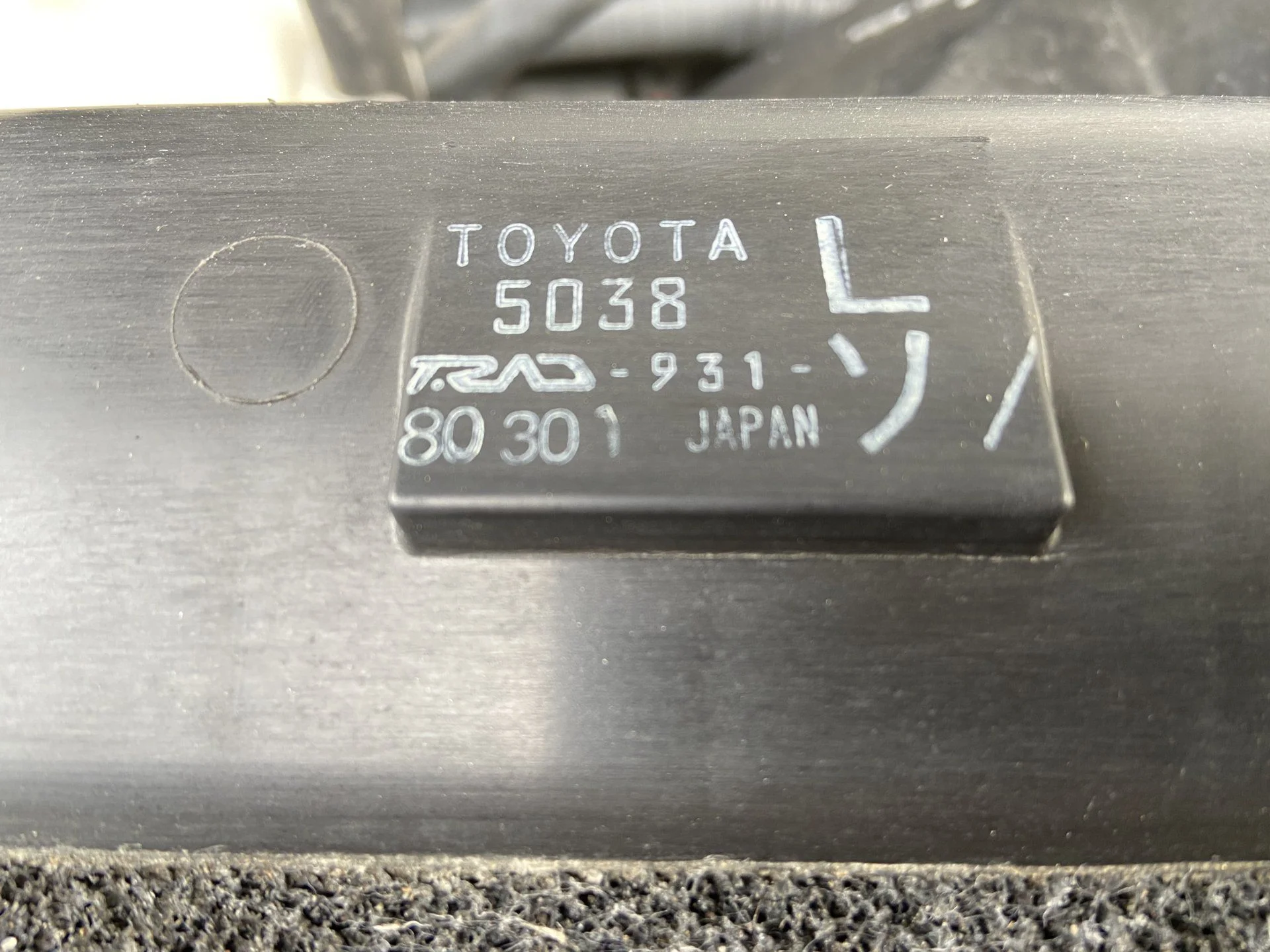

Took a closer look at my radiator today. I'm worried I have the beginnings of the dreaded crack leading to failure.
Well, I've decided to go with the "patch and wait" approach to the radiator crack. Based on the fact that I'm not planning on any hardcore solo adventures to remote locations in the next year or so, I thought it would be ok to try the patch and see what happens. Perhaps I can add to the collective knowledge along with @FinallyGotOne! and see how long the patch will hold out if you catch it early. FYI, I used the JB Radiator & Plastic Tank Repair Kit and purchased it at my local Napa store.
I’ve got that kit in my rig. No crack yet but assuming one day I’ll see it and want to stop it early. I’ve considered prophylactic patching too.
Never heard of that but I'm going to give it a shot as a form of preventative maintenance on my 2008 LX. Or maybe like Grinchy, just keep the kit in my truck. Sounds like you are being very thorough and we can all learn something from your care and attention. Nice work! Looking forward to see your progress.
I'm curious. What did they do in the later model years to fix that problem? Did they just reinforce that area or implement a new radiator completely?
I have the same radiator design on another car and it has far worse heat cycling, no problem. They changed the part number on the rad for us and there haven't been any complaints since then. Still worth tracking.
