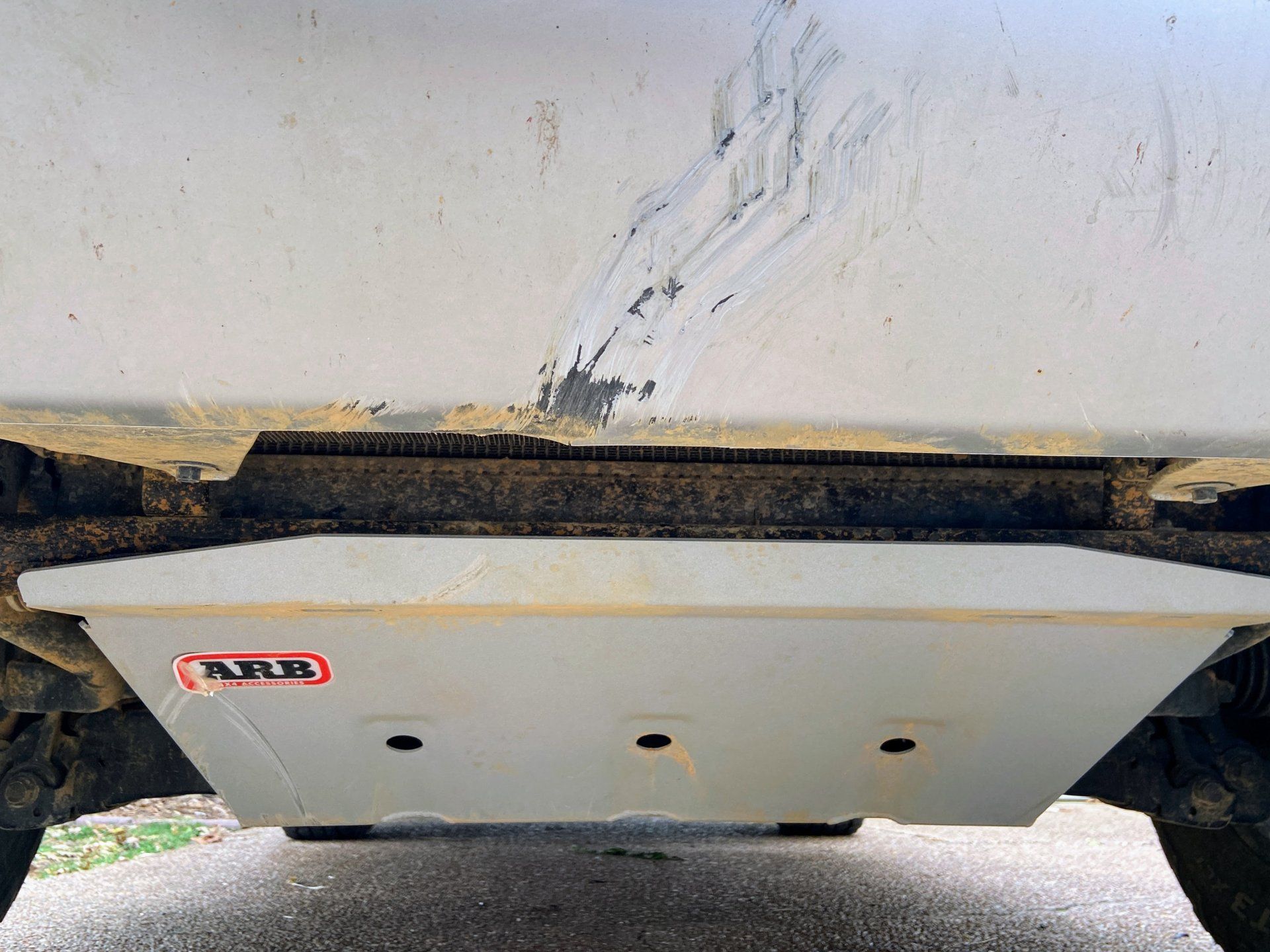

I did get my ARB skid plates installed. Relatively easy. The only thing I'm not happy about but unavoidable (as far as I know) is that I'll need to take the front (and heaviest one) off whenever I need to swap out the oil filter. Think I can drain the oil without taking the middle skid off, but don't think it'll be very easy to do the filter itself.

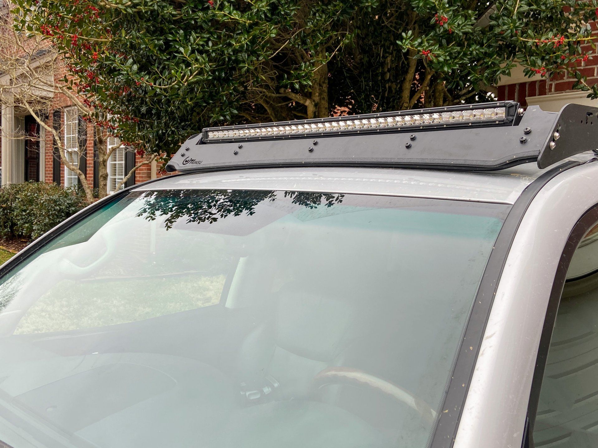

Also, got a cheap light bar installed on the Prinsu rack. I like the slim, almost stealth look and figure at $80 I can replace it yearly if need to and I'll replace the truck long before I spend enough on cheap light bars to pay for a Rigid one.

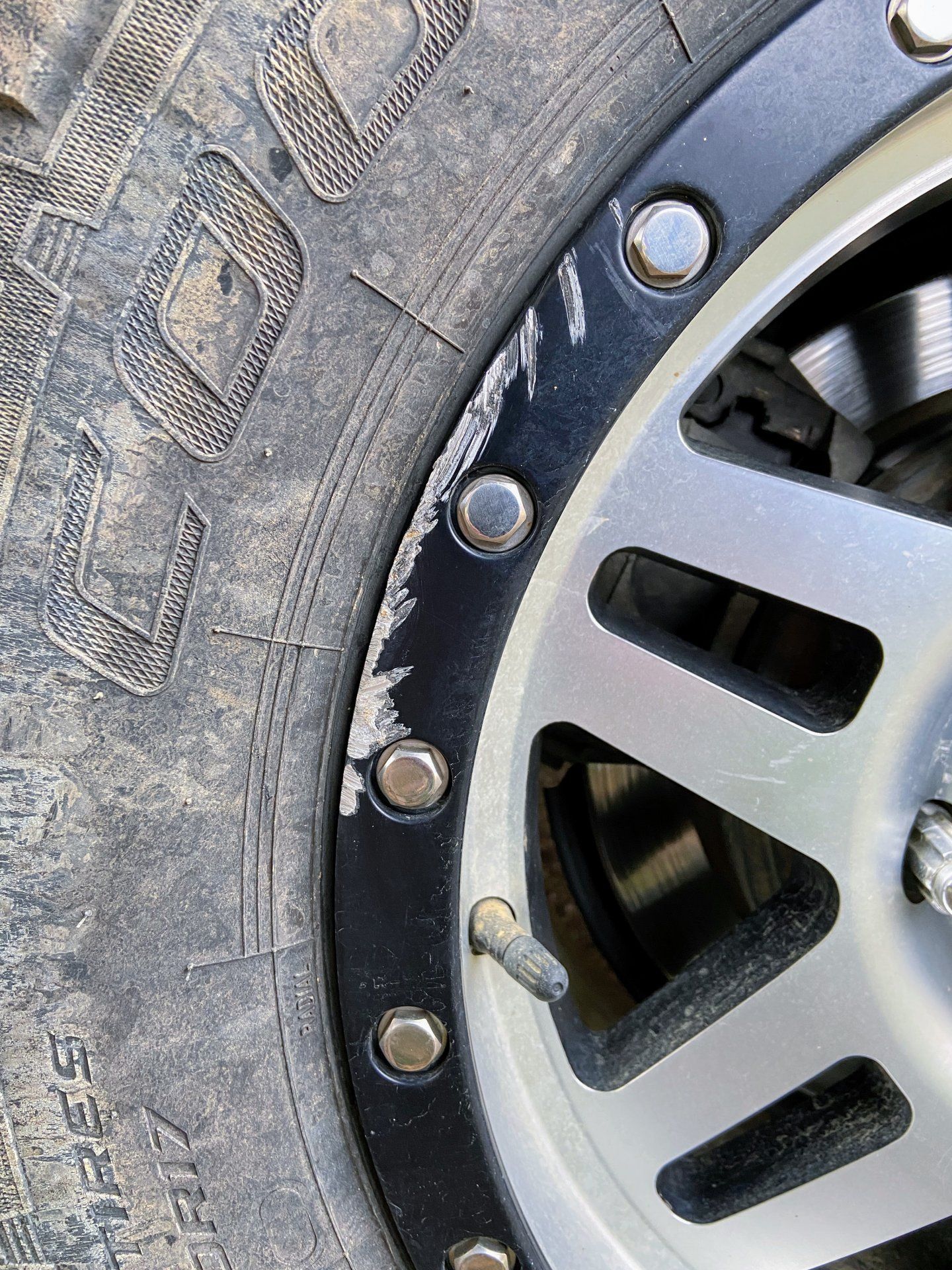

I have bigger needs now like bumpers. Especially after I tore up my front bumper a bit wheeling on New Year's day. I made the mistake of going out with the STLCA group which is mostly 80's and 100's that have been lifted and running 39" or larger tires. I caught a big rock on the bottom of the front bumper and scratched it pretty good. Honestly, don't even remember doing it and didn't notice it until I washed all the mud off 5 days later. Was quite a shock when the mud came off and I saw it. Also, scratched my passenger side wheels pretty good around the lip. Didn't see those until the mud was gone as well. Nothing earth-shattering but still a good lesson on what rocks can do if you're not paying attention.
Nice to see the 200 getting some battle scars. Breaking in those skids!
I installed my arb skids a few weeks back and am curious if you encountered the same thing I did during the installation.
I noticed that the 4 spacers that go between the transmission skid bracket and crossmember pushed the bracket back towards the Transfer case Skid to the point that there is barely any space between the bracket and t-case skid.
I ended up using smaller spacers (extra thick washers) to increase the clearance between the transfer case skid and the transmission skid mounting plate.

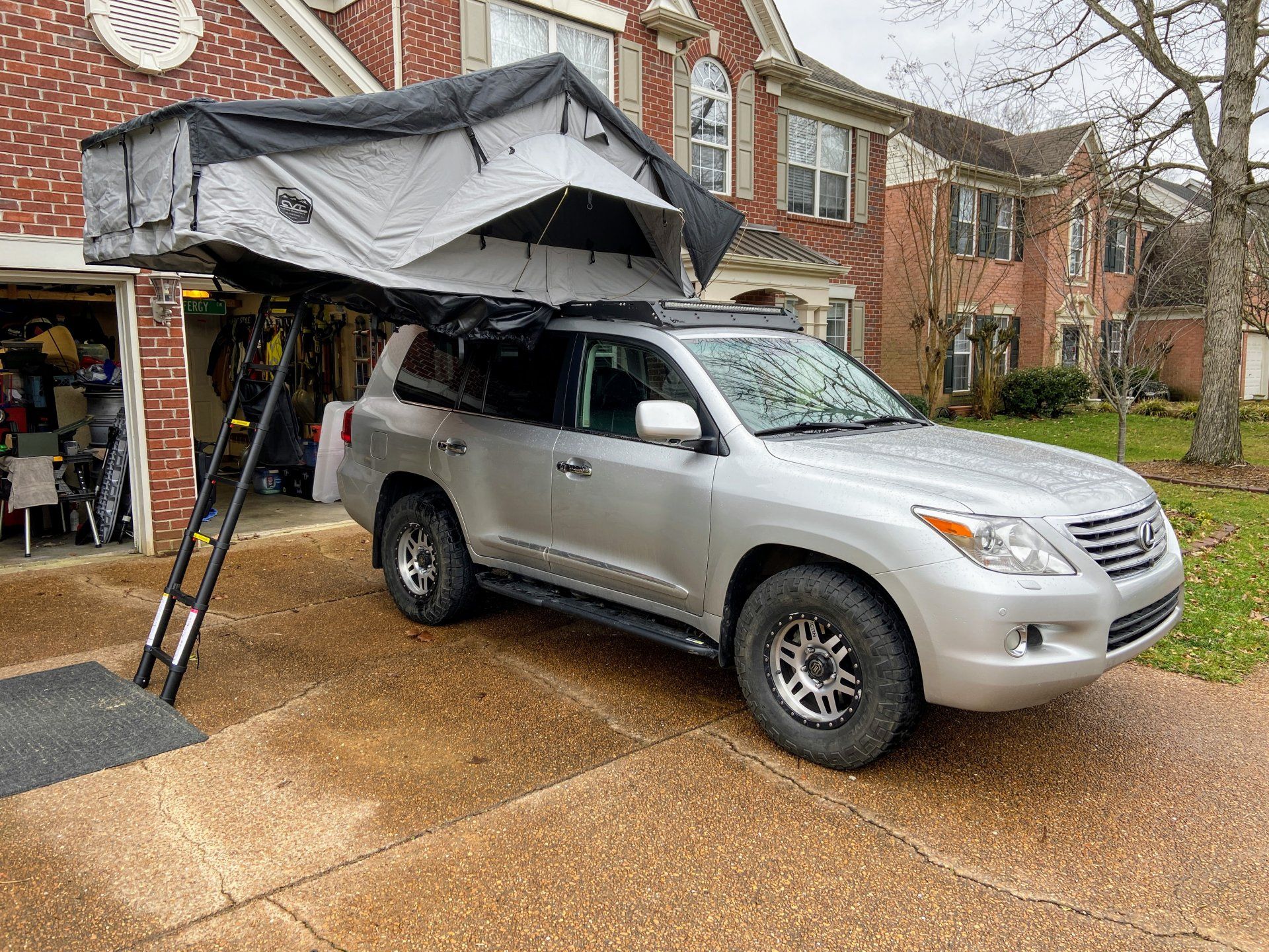

Finally got my CVT Hybrid Shast tent a few weeks ago. For some reason, the Icemagedon 2021 has kept me from getting to try it out yet. Still working on getting it raised a bit off of the rack. The new hybrid tents from CVT are pretty cool in that they fold out like a traditional softshell RTT but they have a hard top with some 8020 cargo bars that will hold up to 150lbs. The challenge is that the soft part of the cover that wraps the sides also wraps under the bottom and is supposed to clip to the bottom of the tent. However, with tent flush to the rack, there is not enough room to reach under and clip/unclip the straps.
Currently, I'm using some cam straps just as a precaution to keep the cover tight around the edges. I've ordered some of the Prinsu top rack feet which I believe I can turn upside down and attach the tent to them. They are similar to the roof mounting feet but add an additional .5" of height over the official feet that are only 1" tall.

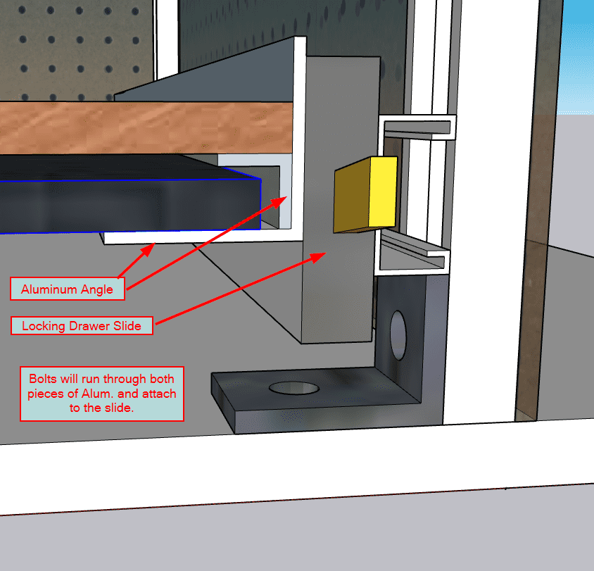

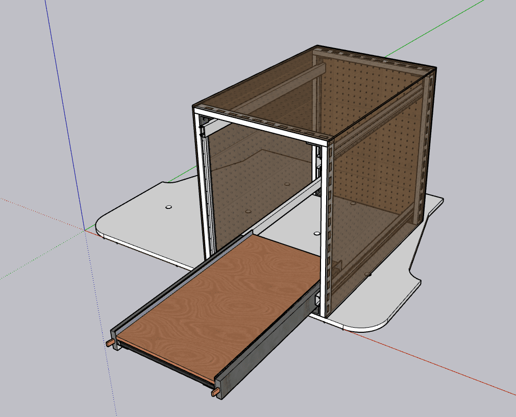

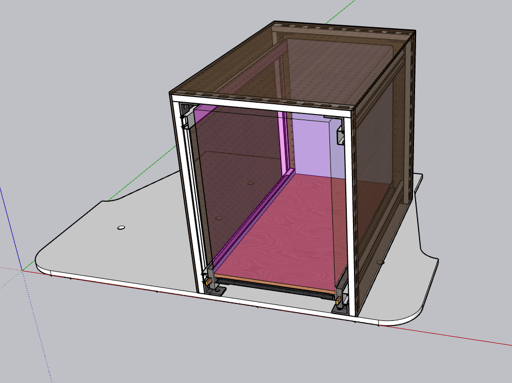

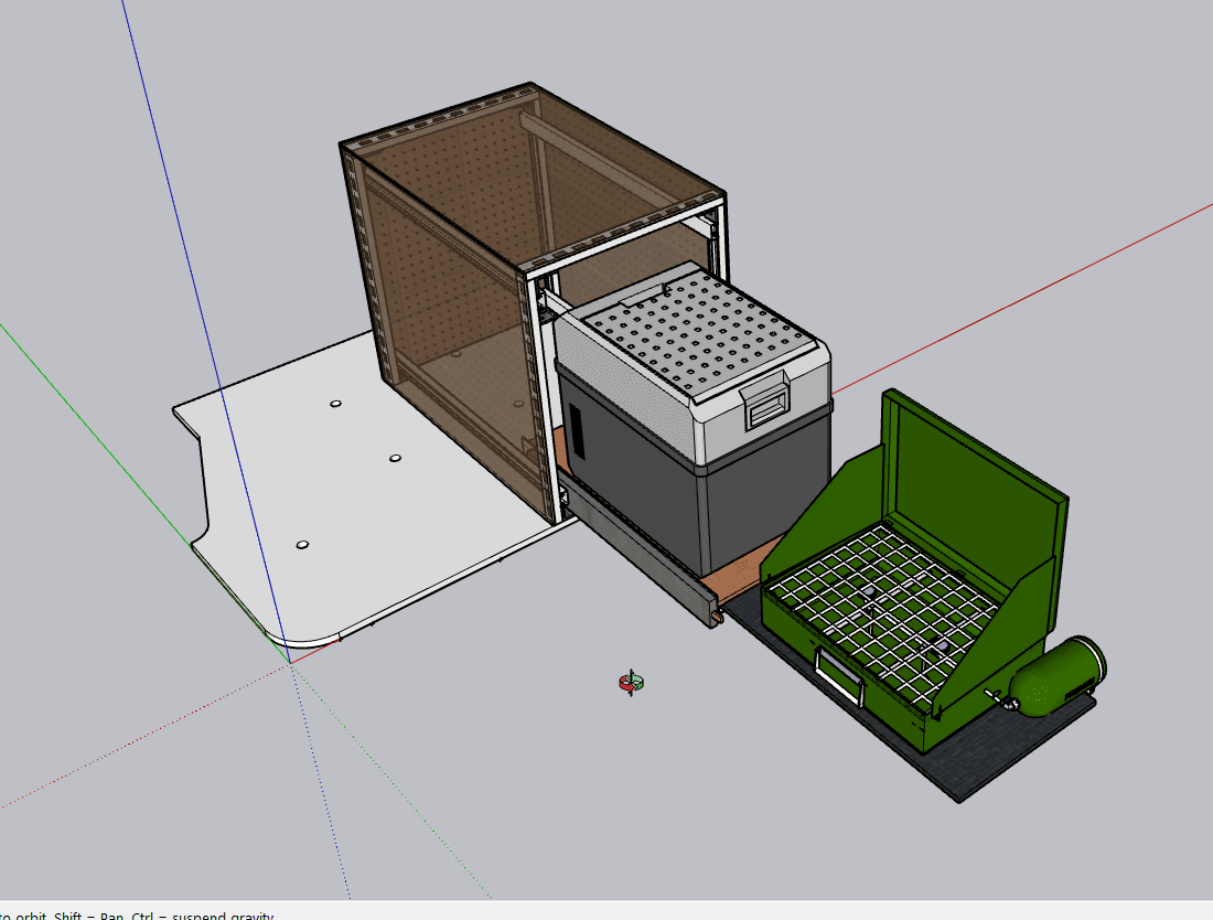

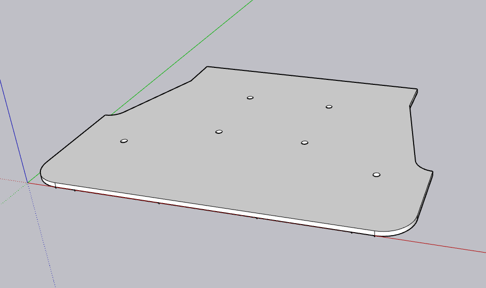

In the planning stages of my rear cargo organization/storage solution. Below are the plans I've developed. I'm hoping to do a build thread/video and if it's successful, I'll actually post it. ;)
Open to recommendations or "You definitely don't want to do THAT because when you hit a bump the fridge will jump out and puncture the gas tank causing a gigantic fireball!" type of advice. Planning on adding drawers to the plan next. Have not added some details like straps to tie the fridge down to the slide.
Base Platform:
The holes are for bolting to the existing holes for the rear seats.
Fridge slide/cabinet:
Planning on utilizing the Superstrut stuff I found at Lowes and was using for my DIY roof rack rails prior to the Prinsu. Also, planning on wrapping in peg board currently to help with airflow and keep things from falling against it. Also, will allow me to stack stuff on top if needed. May put some of the L-Track on top.
Fridge slide extended:
Black HDPE Table that slides under the fridge base to hold my stove or whatever else.
Close up of slide and table:
Really awesome tent and your truck is looking great.
Are you going to give CVT feedback about this? I am sure their engineers will want some real world feedback and I suspect this will not be an uncommon combination.
Yeah, once I get the tent in its final resting place I’m planning on doing a full review. Overall, I’m impressed with quality and included accessories. Their website could definitely use some work but the tents seem to be high quality.

One word of caution about the HDPE, it is slick as snot and may cause more frustration that you’re expecting. I was originally thinking of HDPE for my sliding tray as well but after making folding side shelves for my chuck box out of it I changed my mind. Unless you have it bubble leveled, everything slides right off. Put your beer on it and your beer walks right off the ledge like a lemming :frown:

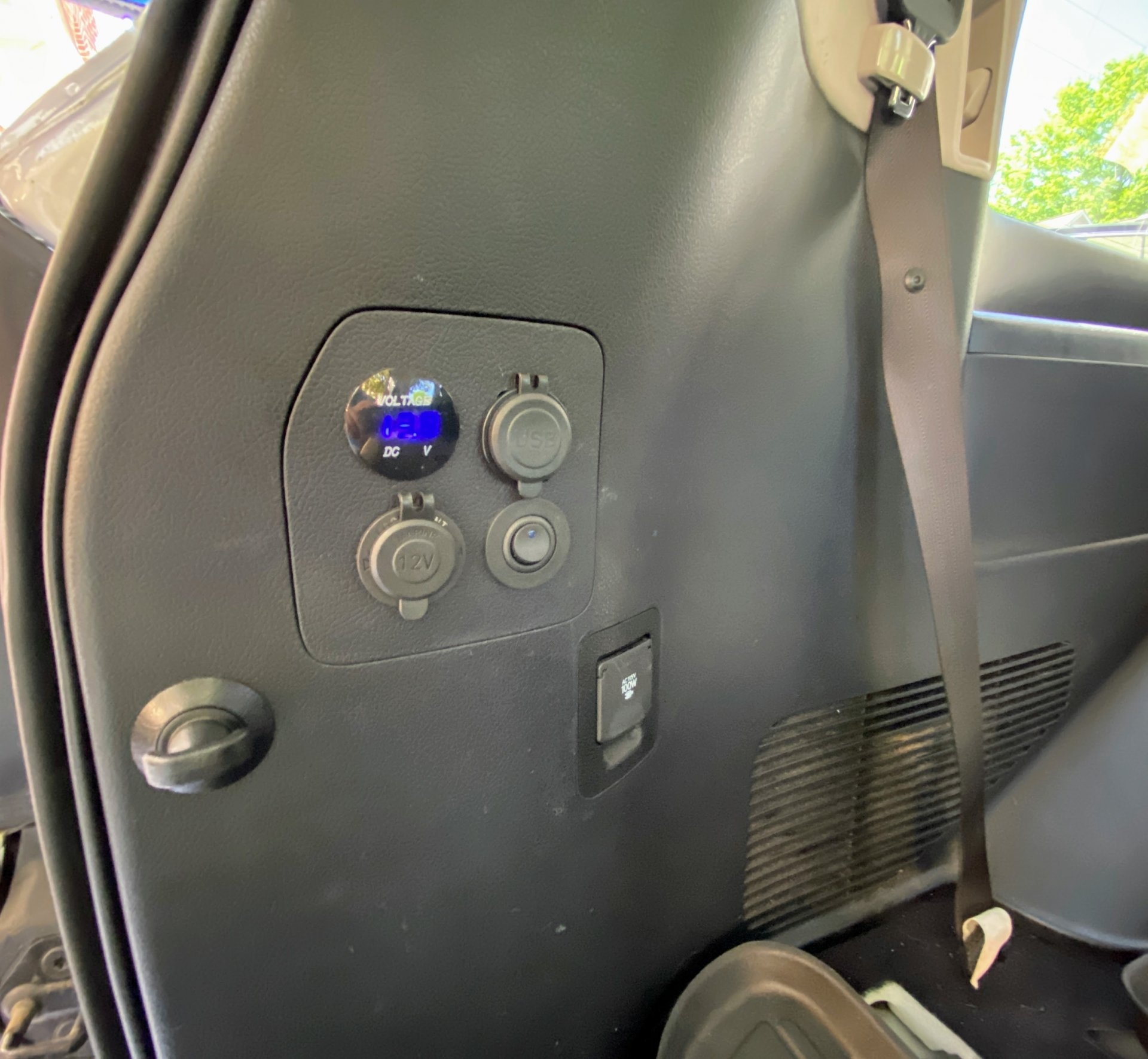

Ran 12V power to the rear to help with charging the Jackery which will, in turn, run my fridge. The overall project went much smoother than normal and was very happy with the results.
I installed 4 "modules" in the removable panel on the left side, above, and to the left of the 110V outlet. They came as a package with a 12V supply, dual USB-A ports, Voltage gauge, power switch, and a faceplate but I decided not to use the latter since the removable panel is curved it would not have been flush. Honestly, I think it looks better without the faceplate. The only remaining thing to do is swap out the power switch that came with the supply for a USB-C module or some sort.
I tied into the cigarette lighter circuit under the driver's side dash with a "tap a circuit" and ran the positive wire down the drive side.

Honestly, haven't used that panel with the 4 modules all that much. I ended up putting my fridge on the other side of the truck and the cord was not long enough. I ran another cable to the back on the passenger side that is still in the "dangly, unfinished state" and not fully installed yet but it's working to power the fridge and some USB's as well. That being said, I am still happy to have those extra plugs there on the rare occasion when I need them.
