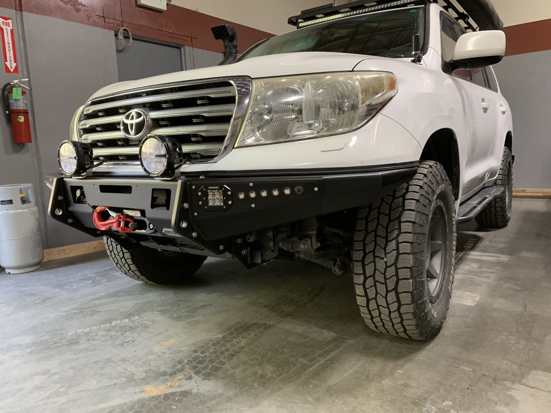

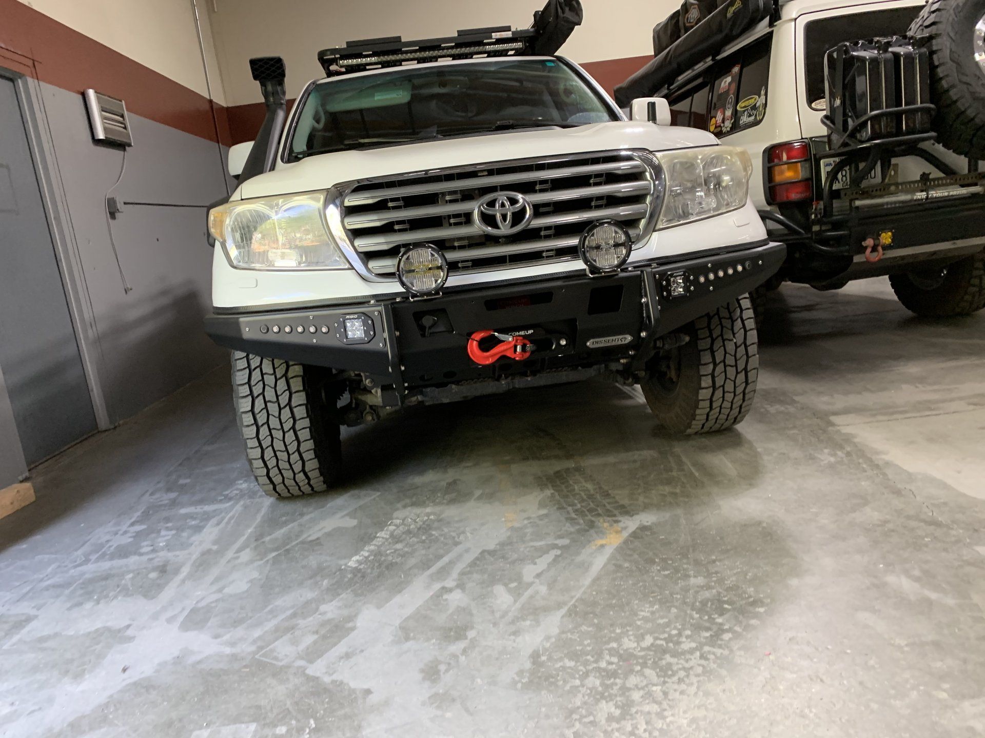

@BigMF bumper work with Ben at Dissent Off-road is completed. Here is the final product. A few more behind the scenes upgrades are happening before we hit the trails again.
Looks great! I'm not a big fan of the big bumpers with the bull bar so this is perfect for me. Are those the parking sensors on outside of some LED's?
