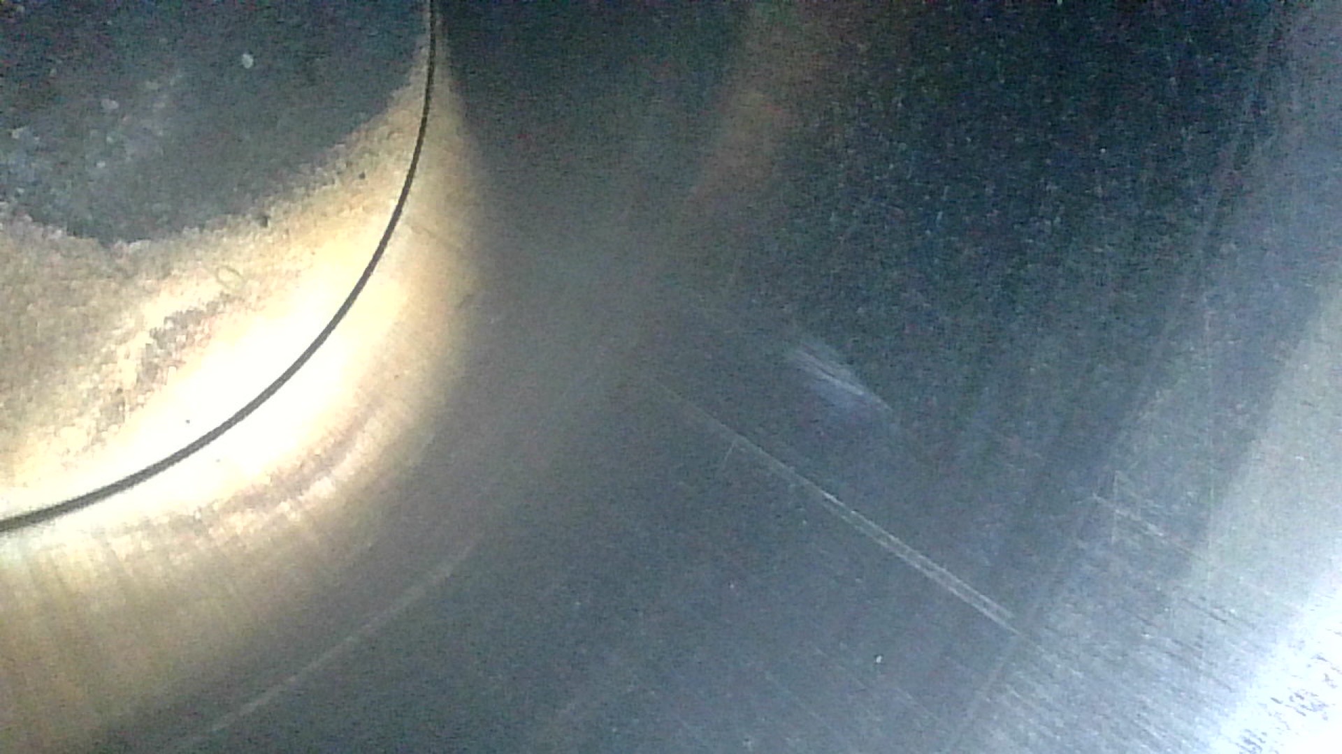

And finally, another fun thing to do, is borescope the cylinders, borescopes are pretty inexpensive now…..mine was $50 from Amazon and I’ve stuck it every car I own…..then again, you may not want to see what’s there…..🤣🤣🤣….but it does have cool factor.
My #6 on my ‘68 F, looks like a vertical score….(piston top to the left)….

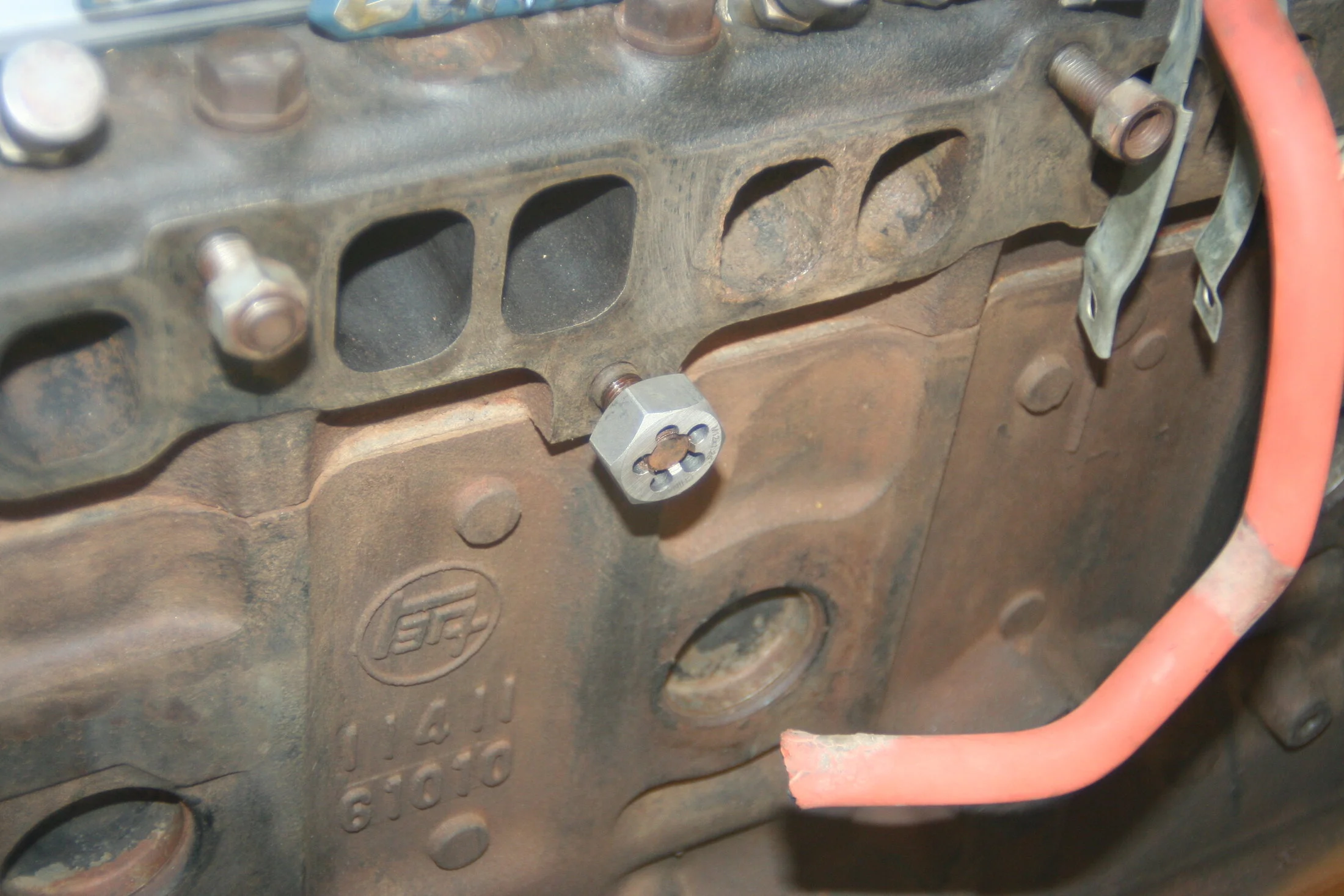

Sometimes installations are kinda compromised by buggered up threads on the head studs. If you can't get a clean pull upon disassembly, the cast iron of the exhaust manifold, or steel header can mar the male-end of the stud thread. Using a die to clear the thread interference from the head stud will be important if you are threading anything back onto the stud (like a double-nut-technique for stud removal/replacement).
Having clean threads is important for manifold(s), as the torque is making a seal for intake vacuum and exhaust.
I don't think that male threads can be restored with dies, as the die usually takes some of the critical thread-root, and plating with it (as the factory never cut threads, but rolled the material to shape). Steel has this interesting property called 'grain-flow.' I kept the original studs for further service, even though I expect them to be much more subject to fatigue/failure. Post-installation, I checked the torque values after some thermal cycling. I've experienced no issues getting a gasket to set for the intake and header.
Maybe the improper manifold stud torque setting is a condition that your F-engine is dealing with? I used copper anti-sieze and the factory torque specs.
