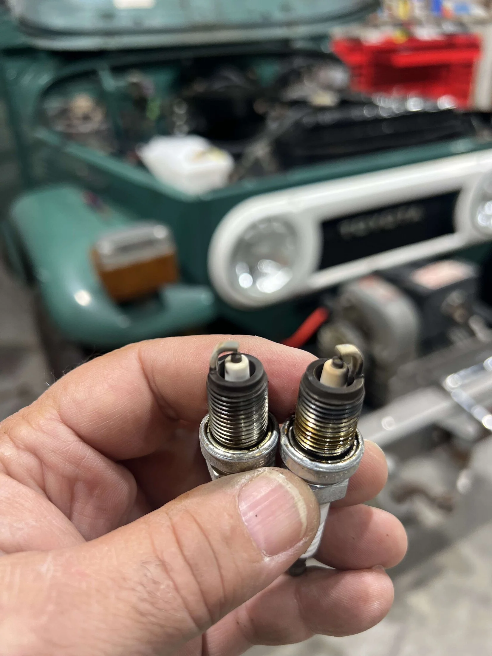

On the advice of posters here I did pull spark plugs for clues. What I found were plugs that appeared to be in good shape without soot - which stood to reason since the problem appeared to be the truck leaning out. Plugs:
Geez, is the picture that big? Anyway, the spark seemed to be consistent when the truck was acting right and when it was acting up. Since the problem manifested itself and all the while the fuel level was just right in the fuel bowl - I went with the problem being somewhere in the carb and ordered a full kit.

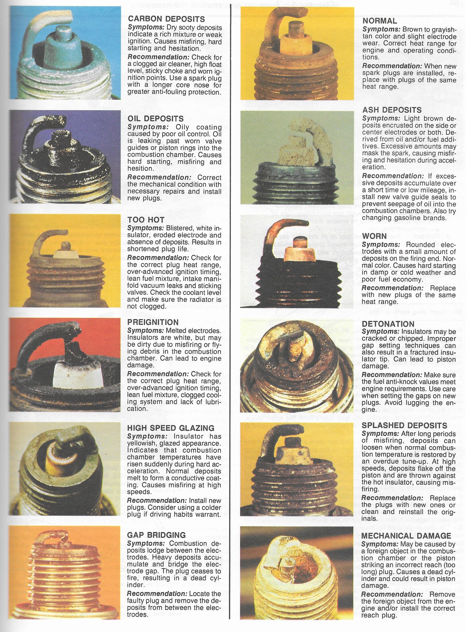

I'd be on the lookout for a vacuum leak, excessive timing advance, engine temp. (too hot). The spark plugs should look tan on the insulator. (Haynes)
Your plugs look fine and the timing appears close enuff.

The image you posted of your plugs suggests something else. There are ash deposits, so maybe it is enough SeaFoam or whatever additives? Gasoline is a straight hydrocarbon, but the oil and fuel additives are mineral or metals (like calcium or magnesium) somewhere placed in a hydrocarbon chain. So, the minerals and metals don't burn, and you are left with a bit of ash deposit.
