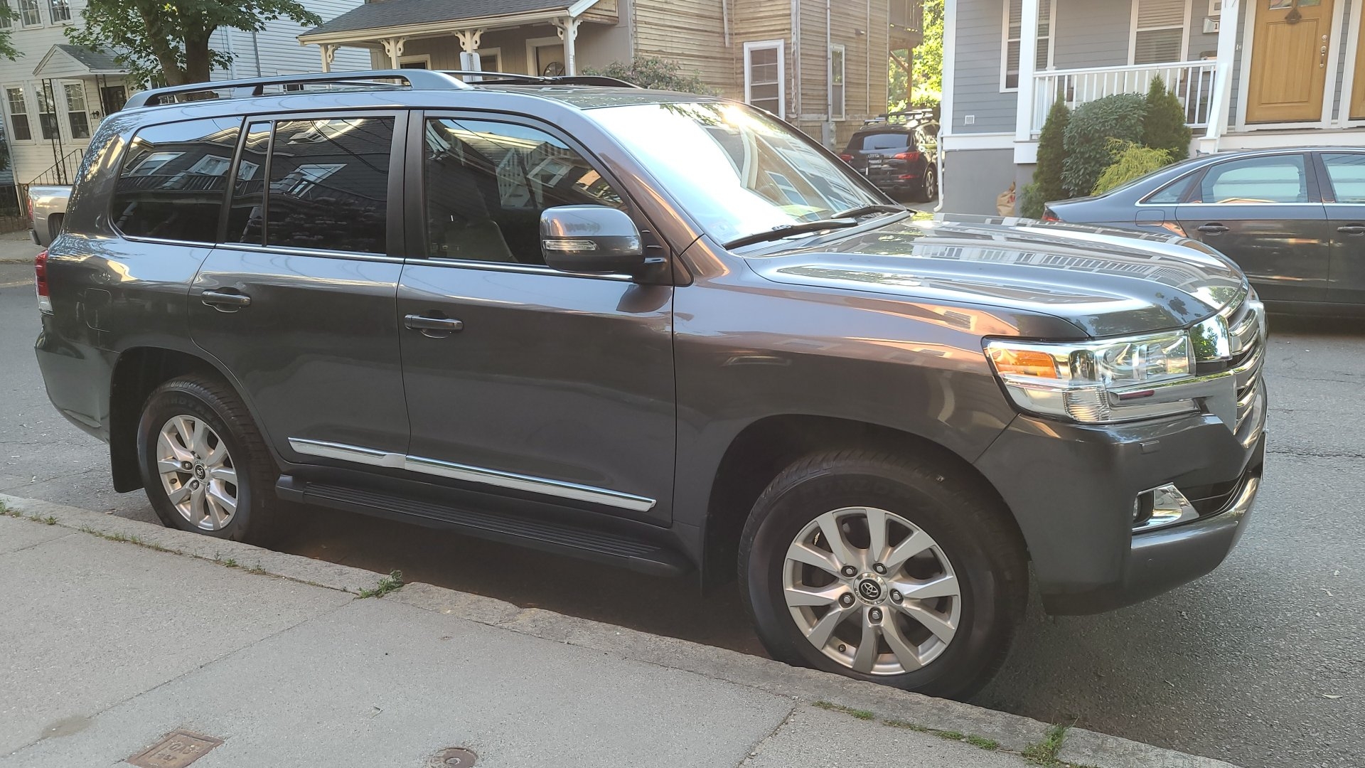

Just picked it up last night. Definitely roomier than the FJ, more quiet. I don't care that much for all the assisted driving electronics (I love the FJ for its basic simplicity) but LC is a big step in luxury. It feels much heavier and less nimble than the FJ.
First step will be to take the 2 rows out, cover the floor with a wood panels. Then I'll try to replicate this clever and resourcefull guy setup:
Here is the new baby
