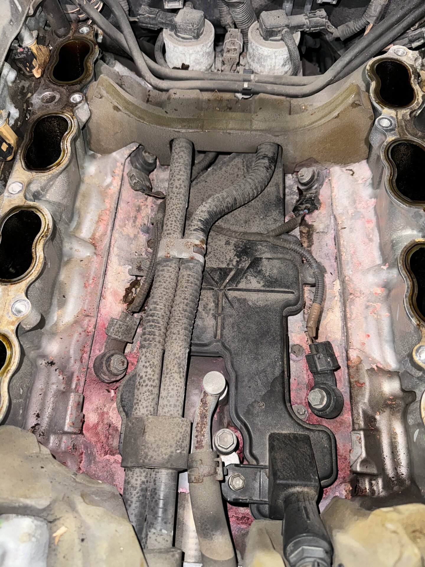

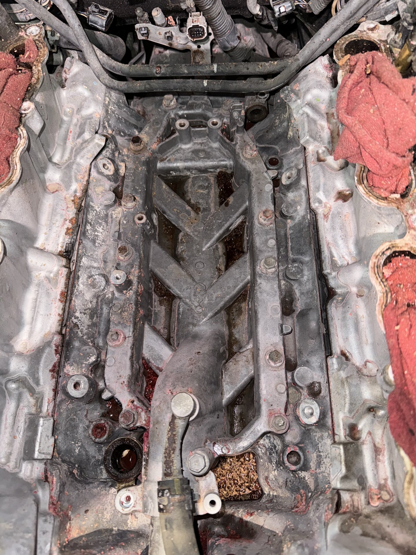

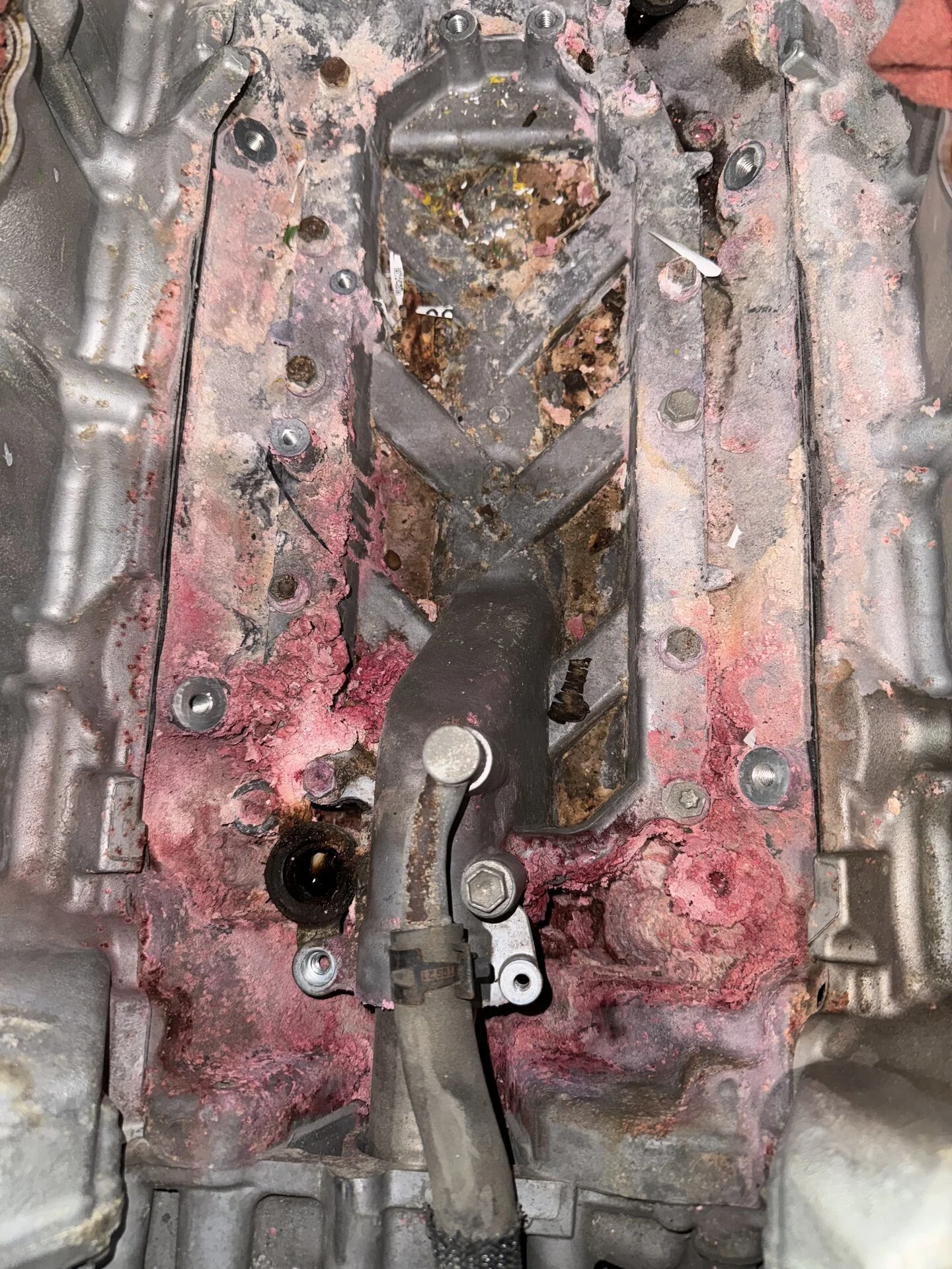

VALLEY PLATE
If you ever wondered what the nastiness looked like to a leaking valley plate. here some examples of mine. When doing this, please be careful with the 4-knock sensors. They are very expensive and DO NOT LIKE aftermarket.

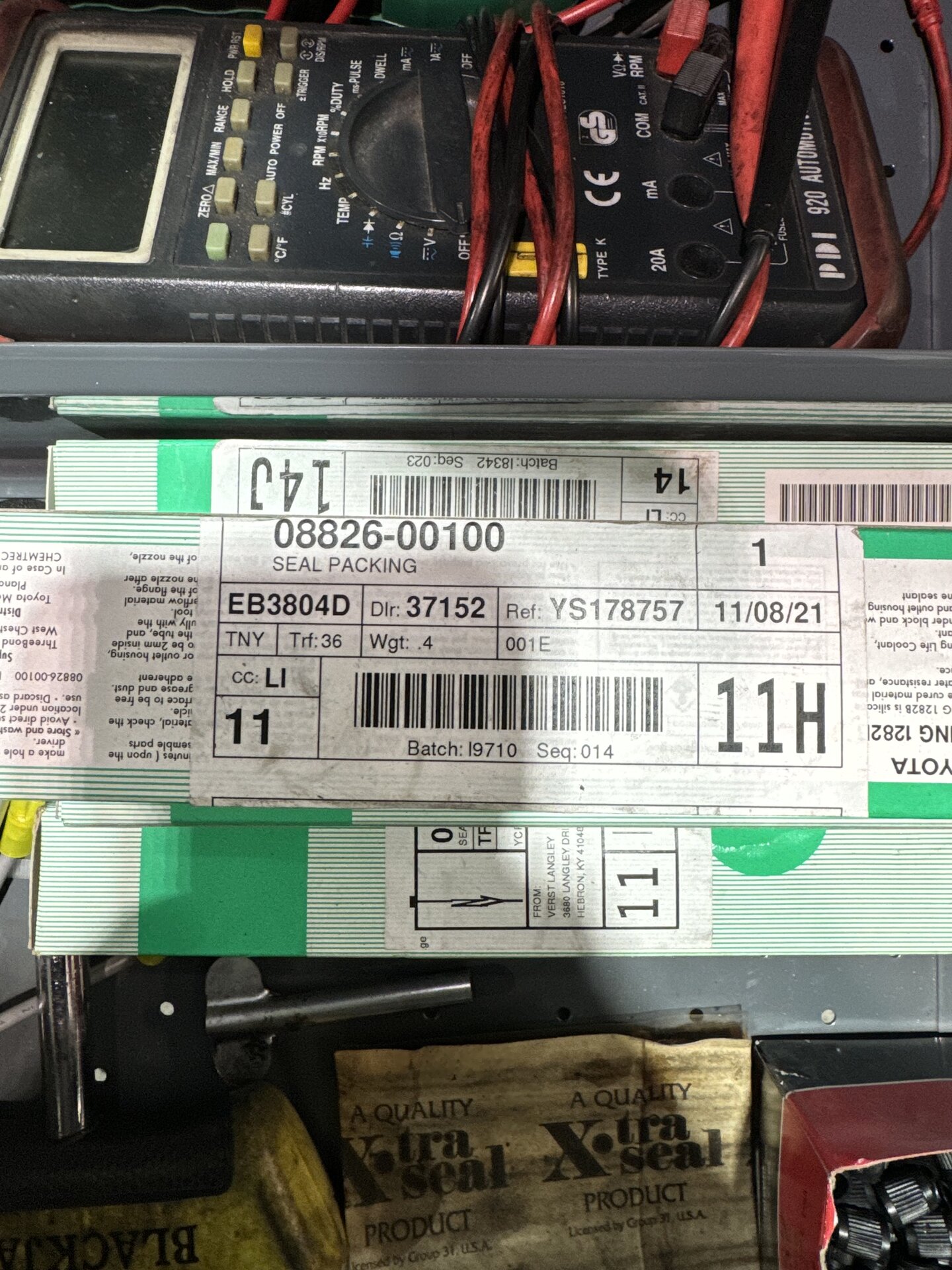

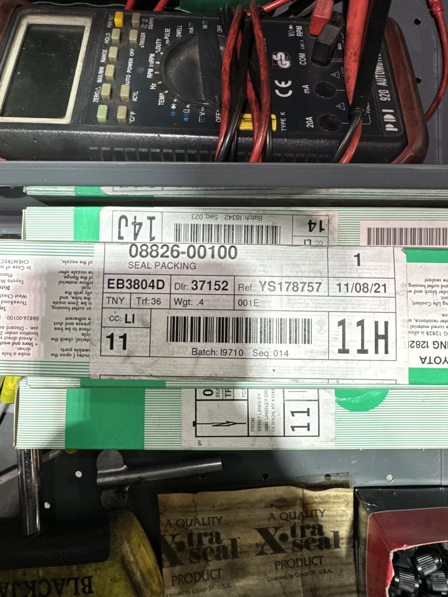

After everything was done, it was all sealed up nicely with this.

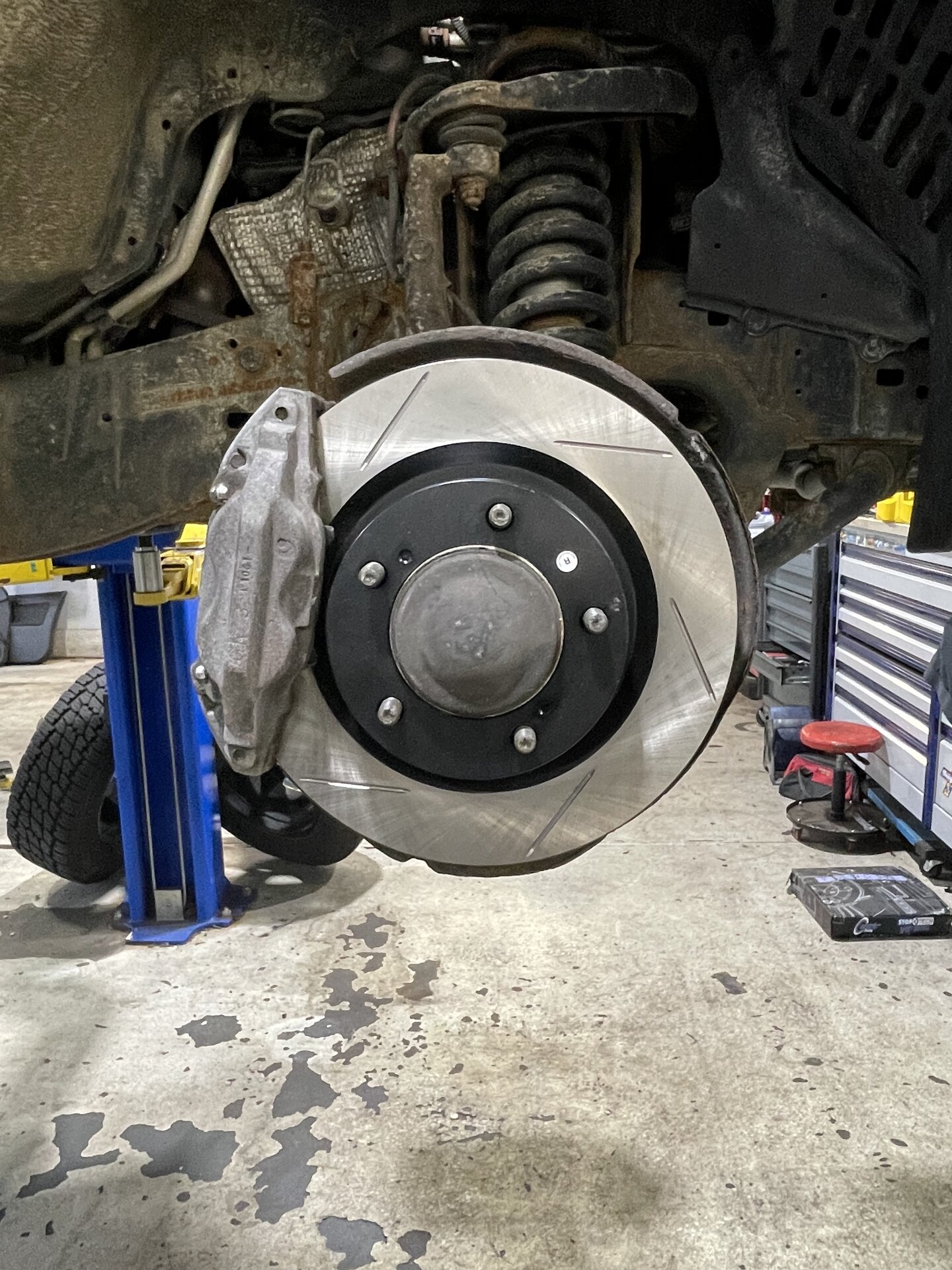

STOPTECH Front/Rear brake rotor replacement. If you are wondering why i installed slotted rotors on the non racing or sports car, its simply because they were free. Brian was nice enough to include this with purchase, so how can i refuse or deny such a nice gesture. He also included a set of Centric fleet front brake pads, so I matched it with a set of rear brake pads. The brakes now feel great especially since i changed a set of sticky rear calipers. Rockauto reman rear calipers were used because they also came with a set of caliper brackets. NEW OEM caliper bracket is $$$ > NEW OEM Calipers, so for not I just opted for after market.

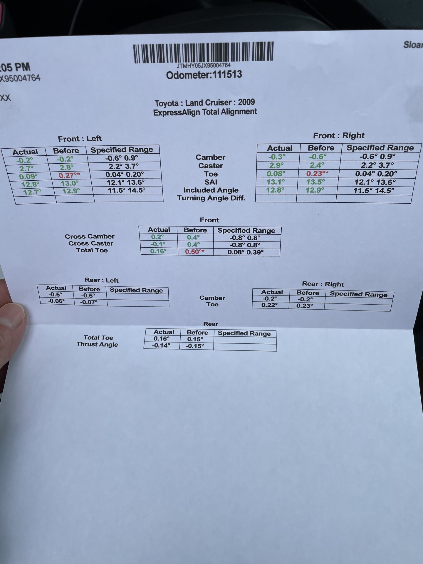

ALIGNMENT
I've searched and messaged multiple members on what's the best alignment for LC200's lifted with tundra front suspension. Everyone agreed to MAX out the caster. I do not have adjustable UCAs yet, but this the best I can do at this point. Also he said my sway bar end links looked bent, which is probably true. I know people were having problems snapping these. Did anyone come up with a solution yet? I've attached a copy of my alignment settings, what do you guys think.

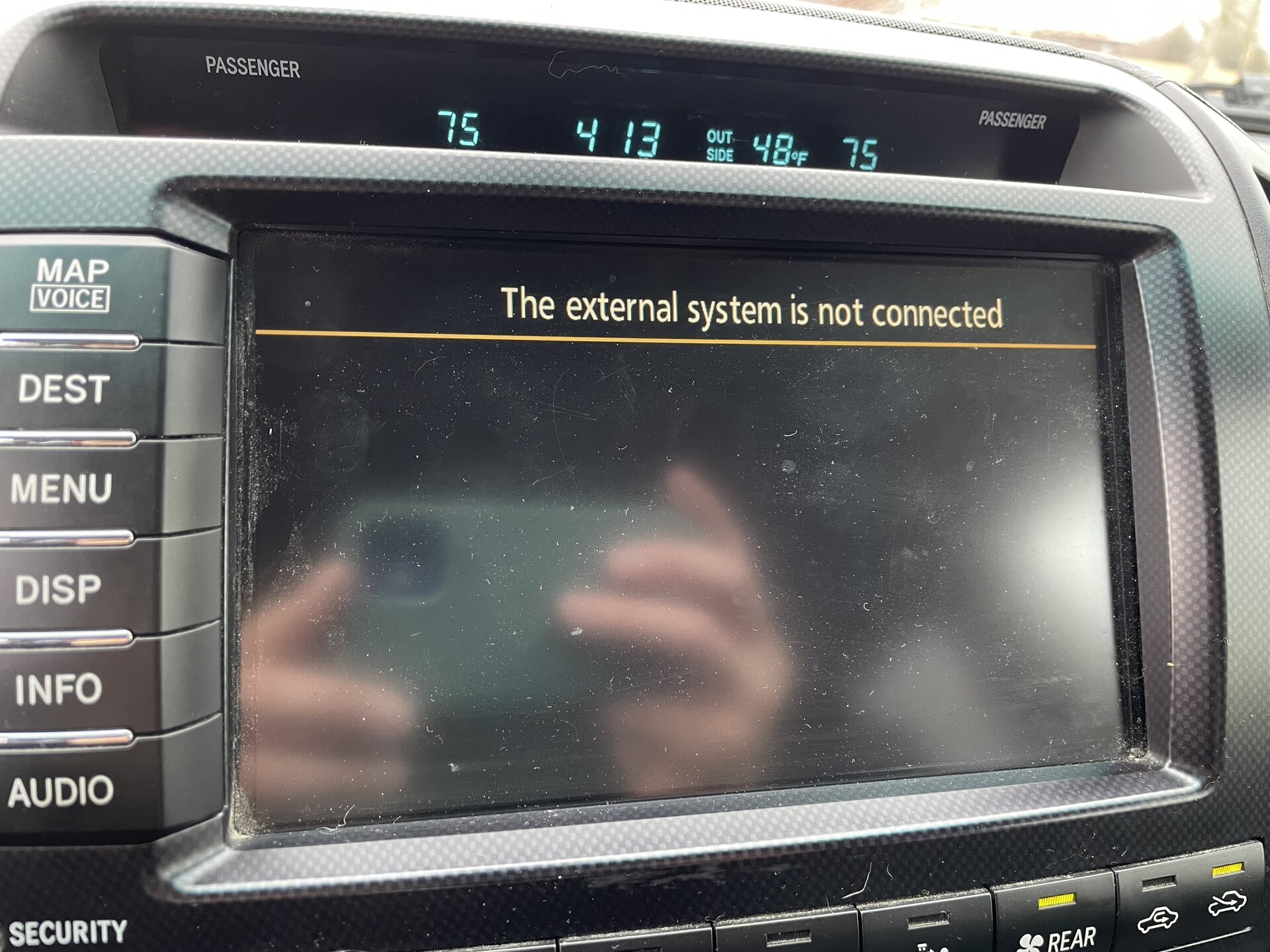

Problem: “external system not connected”, no nav, no audio, but beeping and climate control screens still functioning
The radio and nav was functioning up until I did all the maintenance. Throttle body was cleaned and battery was taken off for the recalibration. Other than that the car runs and drives but just not nav or radio.

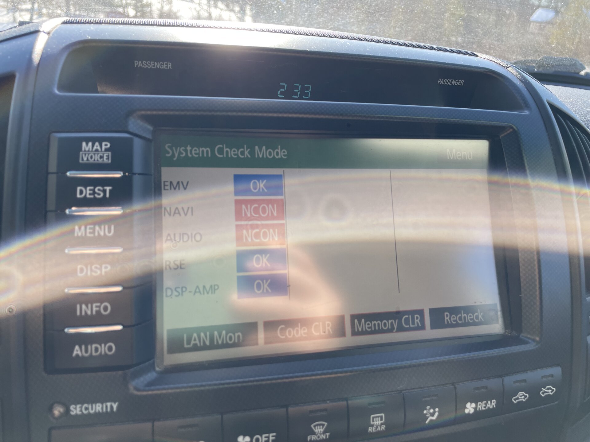

Interventions:
Attempt 1: Unplugged battery cleaned passenger and driver side multiplug connectors with deoxit5, gentle scrub, waited 5 hours and plugged back, nothing
also unplugged and plugged back the amp, all connections secure.
Attempt 2: changed out fuses, 2 in the engine bay 30/10 amp fuses, and 2 in the driver side kick panel 7.5/10 acc/panel
Attemp 3: changed fuse in passenger kick panel, multi display fuse 10amp
Ran the diagnostic menu:
This is where I’m at. Anyone has recommendations? If the nav truly took a dump I don’t mind, my question would be, if I installed a grom or px6 unit, would it still work?
Interventions:

Update!!! My mechanic managed to fix my radio/NAV. I will update the pictures. basically the driver side kick panel, the first big square electrical connector. One of the 7 pin connectors corroded and broke off. he cleaned it, and bypassed one of the wires and wallah!!! everything works from the radio/NAV. that's probably everyones problem for not having a working LC200 NAV/Radio.
