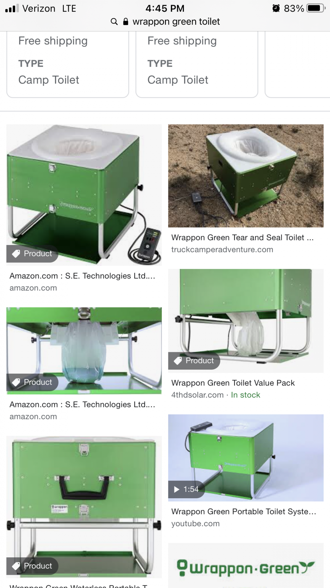

Tell me about this toilet…I’m getting tired of pooping in a bucket

for a bathroom, take the money you saved buying a smittybilt and get one of those $1,000 electronic toilets that hermetically seals your deuce in chemicals. Put it in the “vestibule” at the bottom of your tent near the ladder.

$1000 for a toilet!? It better be gold plated for that price.

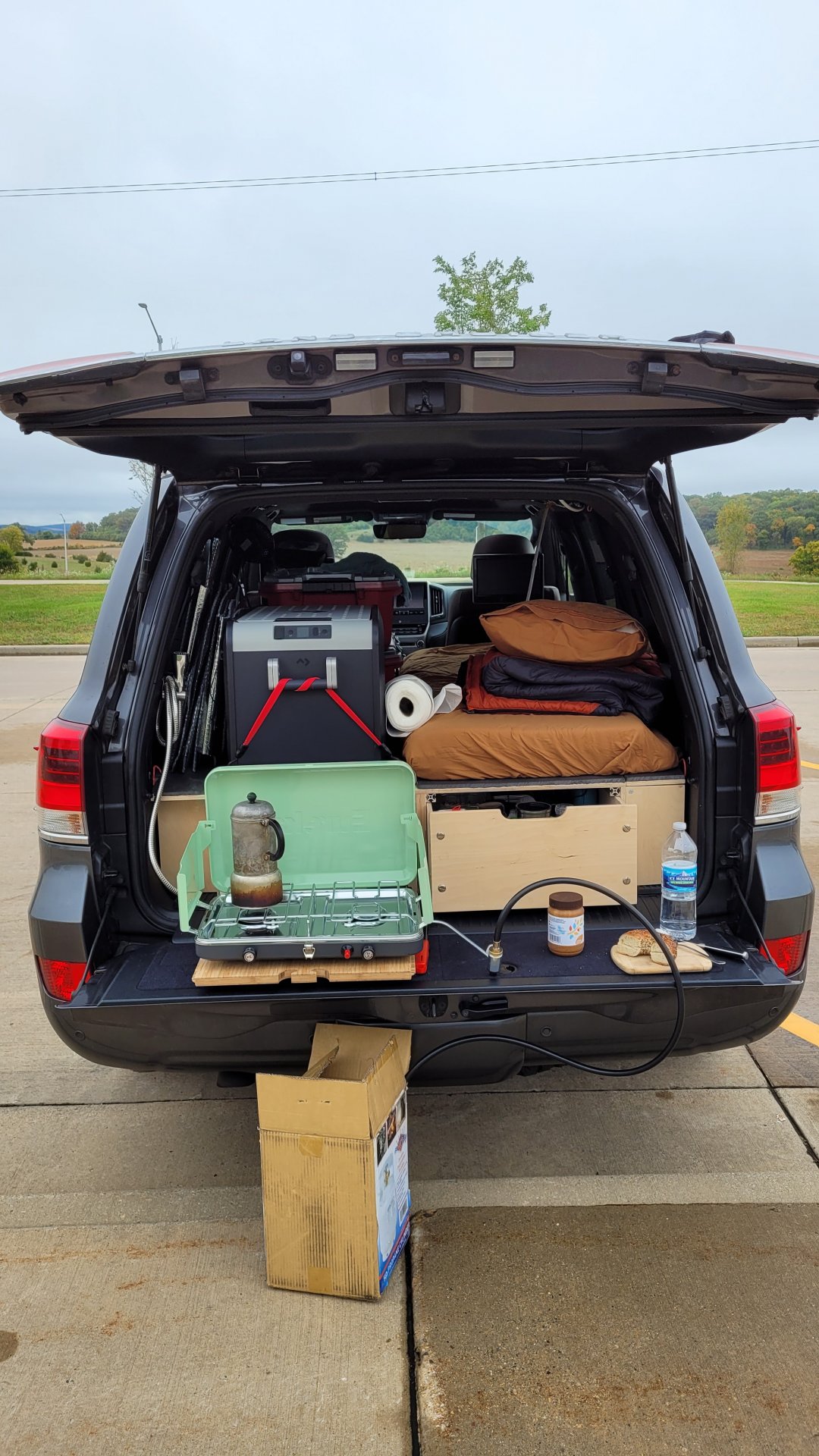

It has been a while since my last update so here is how my lc200 somewhat stealth camper looks like. I have to say, it has proven fantastic in the 2 weeks I have been on the road so far.
My goal was to keep it factory for reliability, keep the stuff on the roof to a minimum to not ruin MPG, but make the inside as comfy as possible.
I went with the Landshark Reef full platform setup which is the absolute best bang for the buck. I installed hinges on the 2 extension panels so I can lift them up to access stuff underneath.
I installed a water pump connected to a 5 gallon scepter tank. I used quick connect at the tank and quick connect at the back so I can plug either the little faucet spray you see in the picture to wash dishes and cooking/drinking, or I have a garden hose connecting to a propane water heater for showers. I setup the OVS shower room for privacy.
For power, I use a jackery 500 which has been sufficient to power the fridge, the water pump, and all the electronic toys I carry around.
