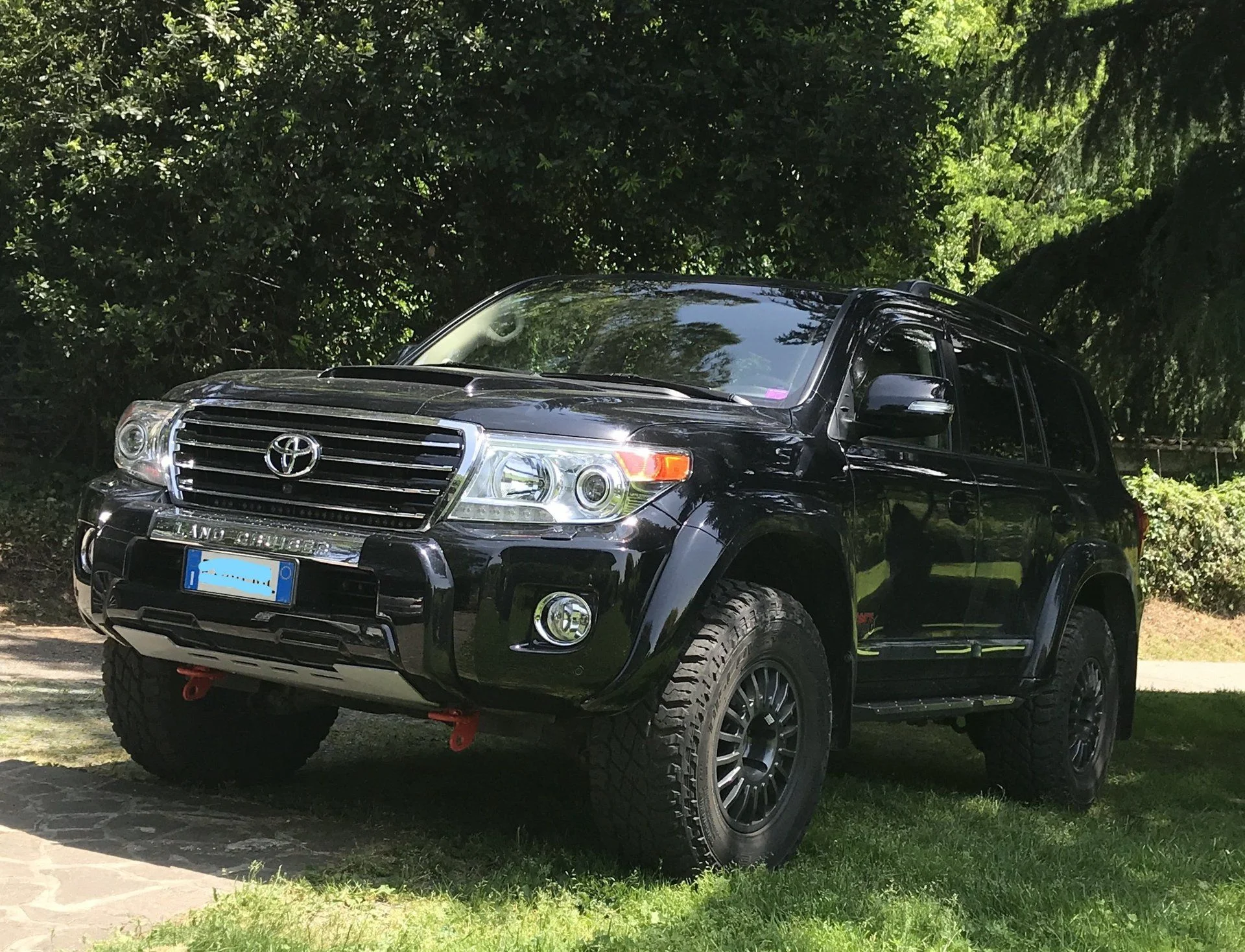

I have seen one other post on this forum from @Wotan back in 2019 who seems to be located in Italy. From what I read, his LC200 is not equipped with KDSS but rather the AHC that I believe is equipped on the LX platform. Here is his LC200 for reference:

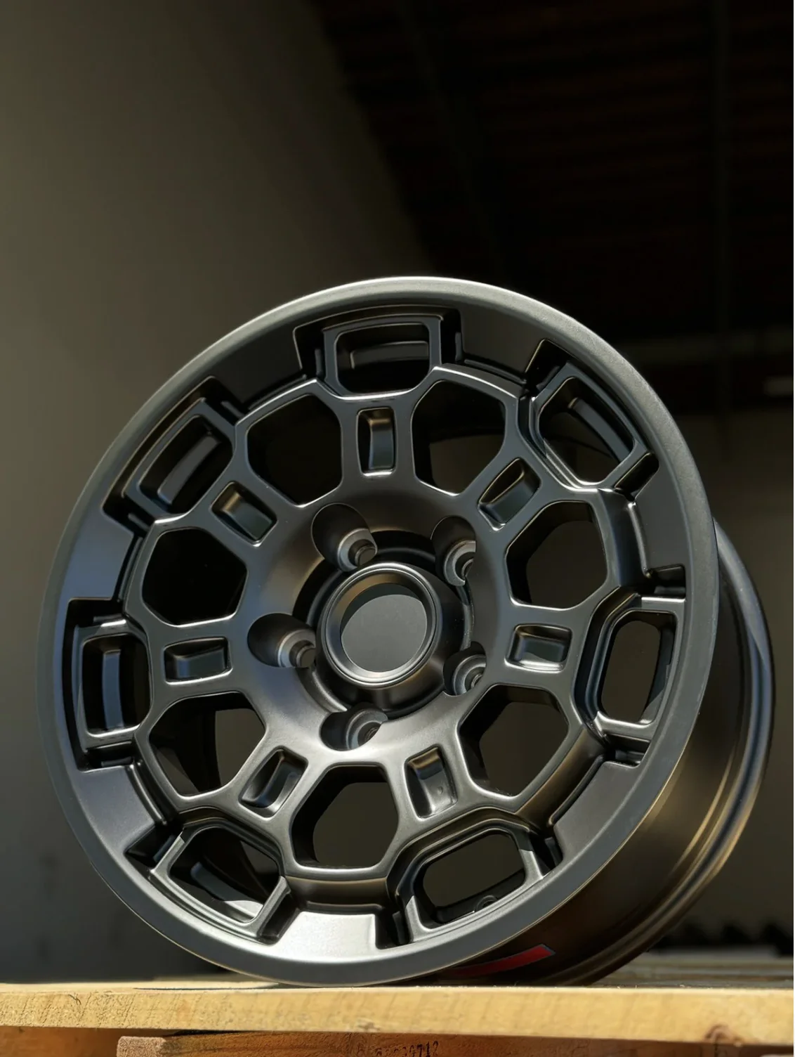

In terms of wheels, I currently like the 2023+ Sequoia/ Tundra TRD Pro wheels. But those come in the 6x139.7 bolt pattern from Toyota and the LC200 has a 5x150 bolt pattern. That being said, I've managed to find a solution to this problem from AGP who offer a reproduction of this wheel in the 5x150 bolt pattern as seen below:
BUT, this wheel only comes in a +18mm offset vs. the factory +60mm offset, which might be good for the wider fender flares but could create clearance problems due to poking out a bit further (and thus having a wider arc). I might eventually be able to offset front clearance issues as I plan to fit either an ARB or Dissent front bumper which I imagine will help in this regard (and massively improve approach angle).

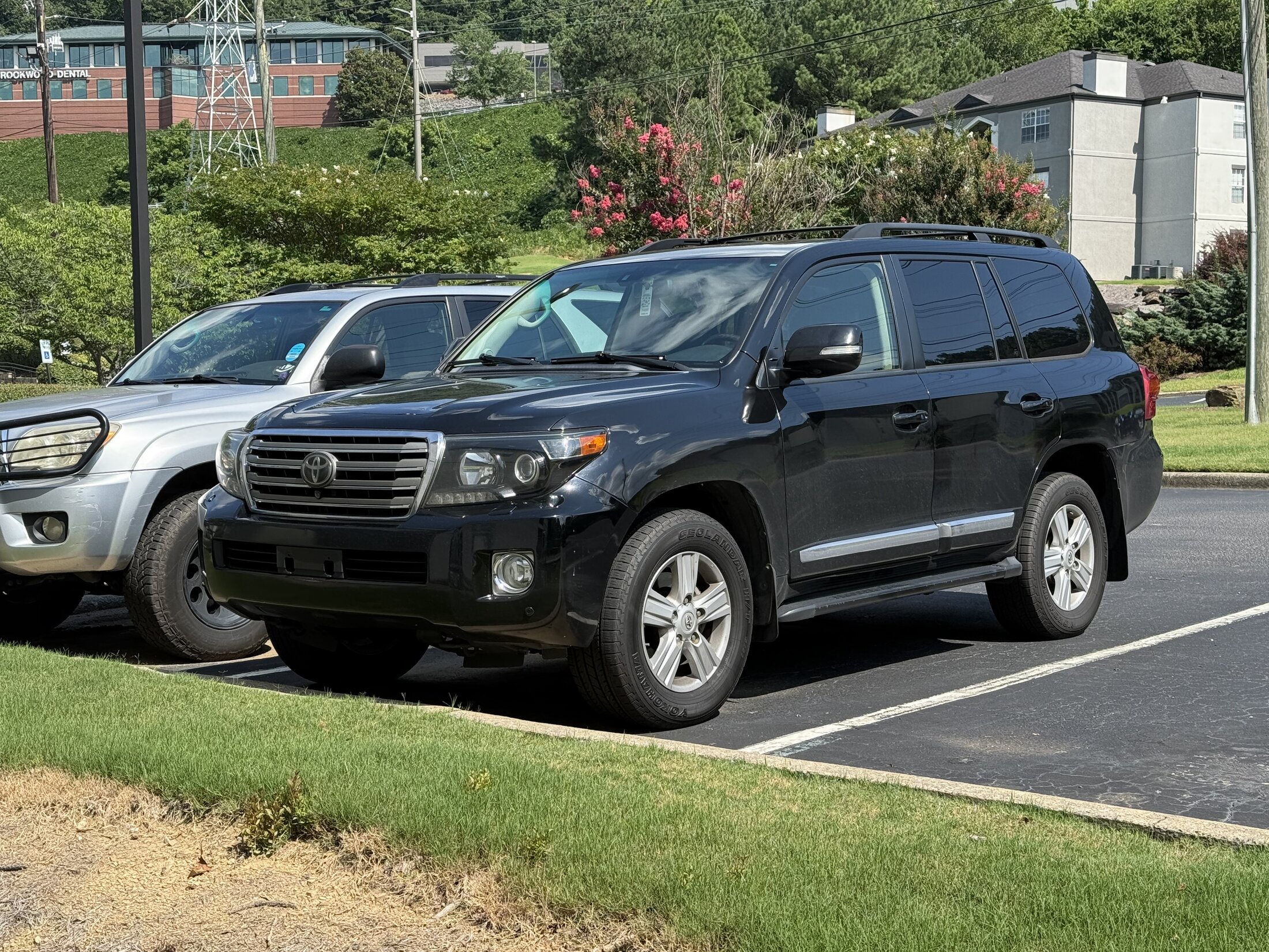

This is my LC as it currently sits:
Let me know any and all advice you guys have for me! Also, if you know anyone in the US or abroad that has done something similar please send them my way or tag them in this thread!
