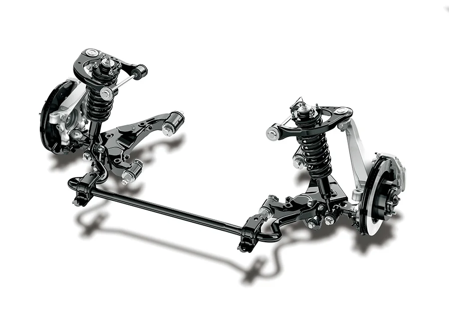

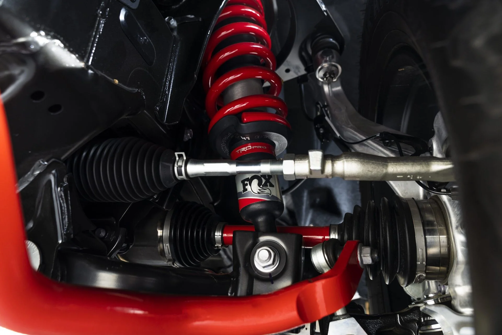

This is 2024 Tacoma front suspension. You can see the swaybar are behind front wheel. The swaybar disconnect are located below engine oil pan. Which might be better for approach angle perspective but definitely need skidplate to protect that.

I guess silver lining for the tacoma - The LCAs are practically built for a secondary shock.
It's interesting that toyota went away from the sway bar mount to the spindle in favor of the LCA. The 4Runner had both designs depending on trim. Since the Tacoma and LC share the same platform and frame layout along with engine, it's super odd to re-locate that one component from front to rear unless they needed the space in front for some unusual reason. The Tacoma location is definitely better for more challenging offroad terrain (rocks). It's protected above the main body of the LCA. I know my KDSS mounts took a beating on the rocks on my 4Runner. The rear fixed link side also got bent a few times. So, maybe the Tacoma is designed around more technical offroad terrain vs the LC? That would help to explain the change. The LC/Sequoia design isn't optimized for protection and high clearance like the Tacoma is.
As i look more at it - the Tacoma really is a lot better LCA layout and design for rock crawling type use. The shock lower eye is protected by a heavy bracket and mounted in double shear and the sway bar and mount are relocated high and protected. On the LC version the lower shock eye is unprotected and just mounted to a single stud. It's exposed to trail damage and will need aftermarket skid plate protection if you wanted to go play very hard in the rocky trails without damaging it.

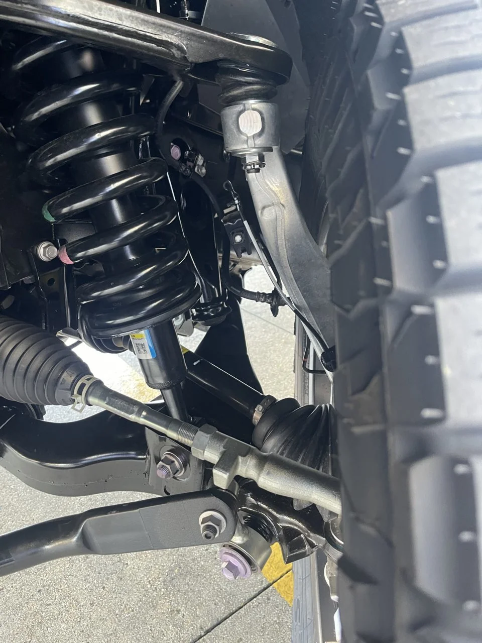

Looks to me - although really hard to tell for sure - that the LC250 LCA is different from the Tacoma or GX550 in mounting location for the sway bar and shock. It appears to be a single shear stud for the coilover lower eye mount without the protection the Taco has, but I don't see the sway bar mount there on the front.

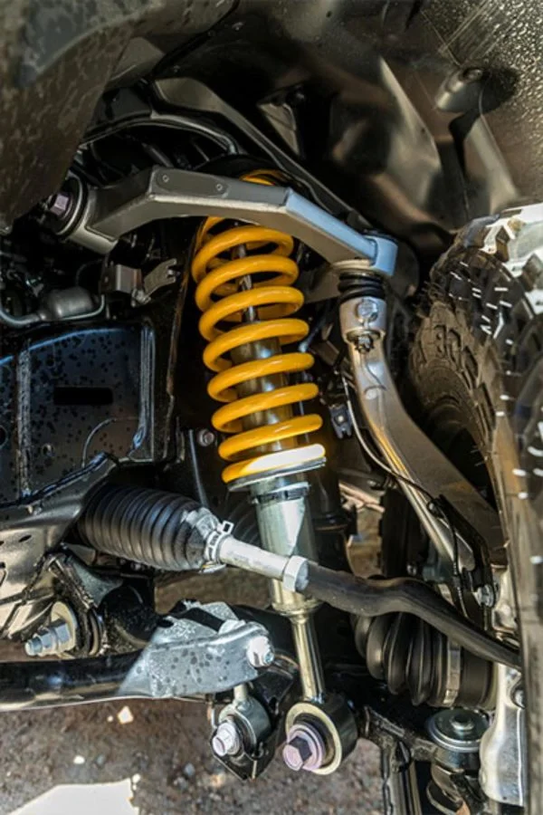

This is TJM 300 front suspension which confirm your observation

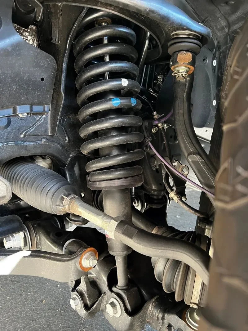

This is 200 front suspension that shows the lower strut are double shear mount.
This is 22 Tundra. The swaybar are outside of coilover. It looks much wider for some reason.
I'm probably overthinking this a lot. Protected isn't necessarily better unless it is functionally better in real world use.
I think that far outboard location on the strut mount of the LC300 is probably protected by the tire in most cases in the real world. The LC300 isn't built to be a rock crawler. It's a utility wagon. The coilover lower eye on the LC300 is pretty close to the tire and probably is not going to be damaged unless you're really punishing it in the rocks. Or you put some wheel spacers on and expose it to more damage. Same reason the rear lower shock mounts generally work pretty well to be tucked up really close to the inside of the rear wheel. It's only on the really rocky technical stuff where they get damaged.
My biggest fear on the LC300 design is that you do hit it hard enough on the eyelet area to knock the metal eye off of the rubber bushing. I have seen that happen on a rear shock of an FJ on the trail. It's a bit of a PITA to put back together in the field, and that's just a shock without being the coilover. On the LC300 it's at least possible in the most extreme abuse situation that you would have the bushing fail due to a rock impact and then lose your entire spring/shock support on that corner and have a tricky trail side repair to sort out. It's not something I'd loose sleep over or even plan around other than probably adding a lower eye skid protection maybe. But given the option - I think the Tacoma might be a little better setup.
The Tundra setup doesn't look very good to me for offroad use in that sort of trail. But I also wouldn't really use a Tundra for that. So maybe it doesn't matter on that vehicle. It's never going to be a rock crawler.

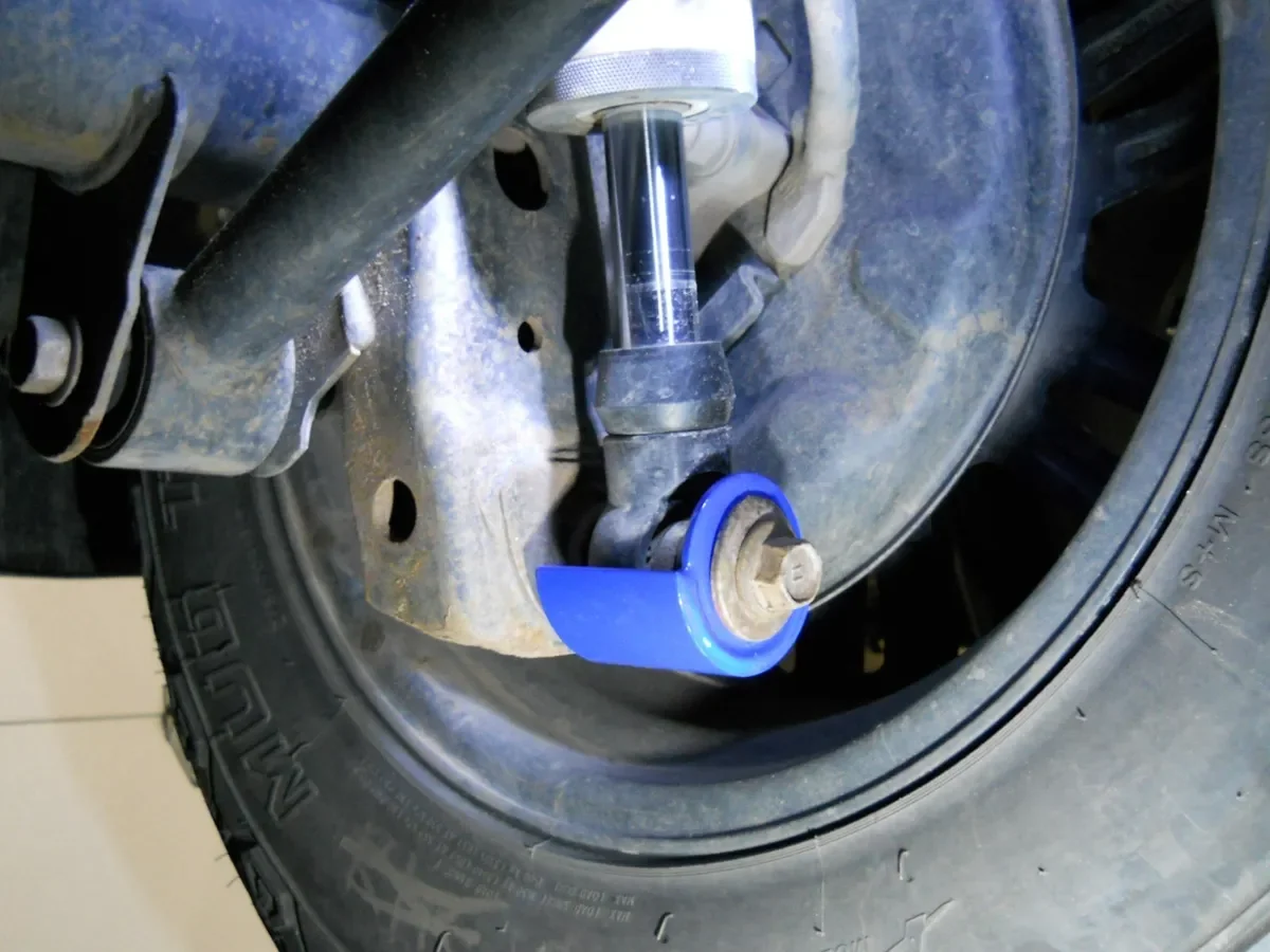

I've found that something as simple as this design (very close to what I weld up for my own junk) is all you need. All you need is a heavy gauge washer and a short piece of tube or pipe cut in half and it takes about 10 minutes to make these and bolt them on. Only difference is that I prefer to extend the tube out forward a bit to protect the bolt head so it's easy to remove later.

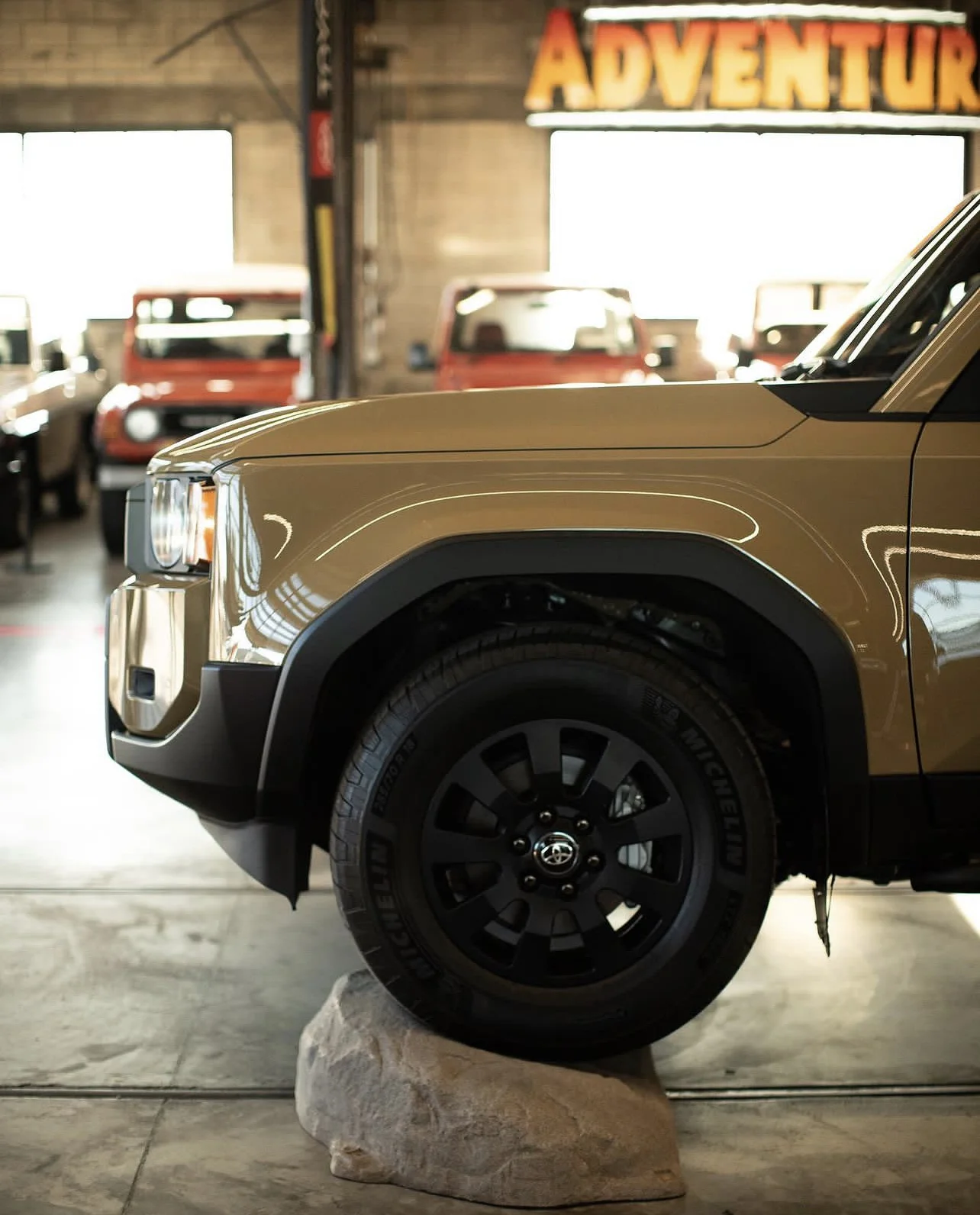

That pastic prop rock goes everywhere together with it. Would it come as part of first edition? 😁

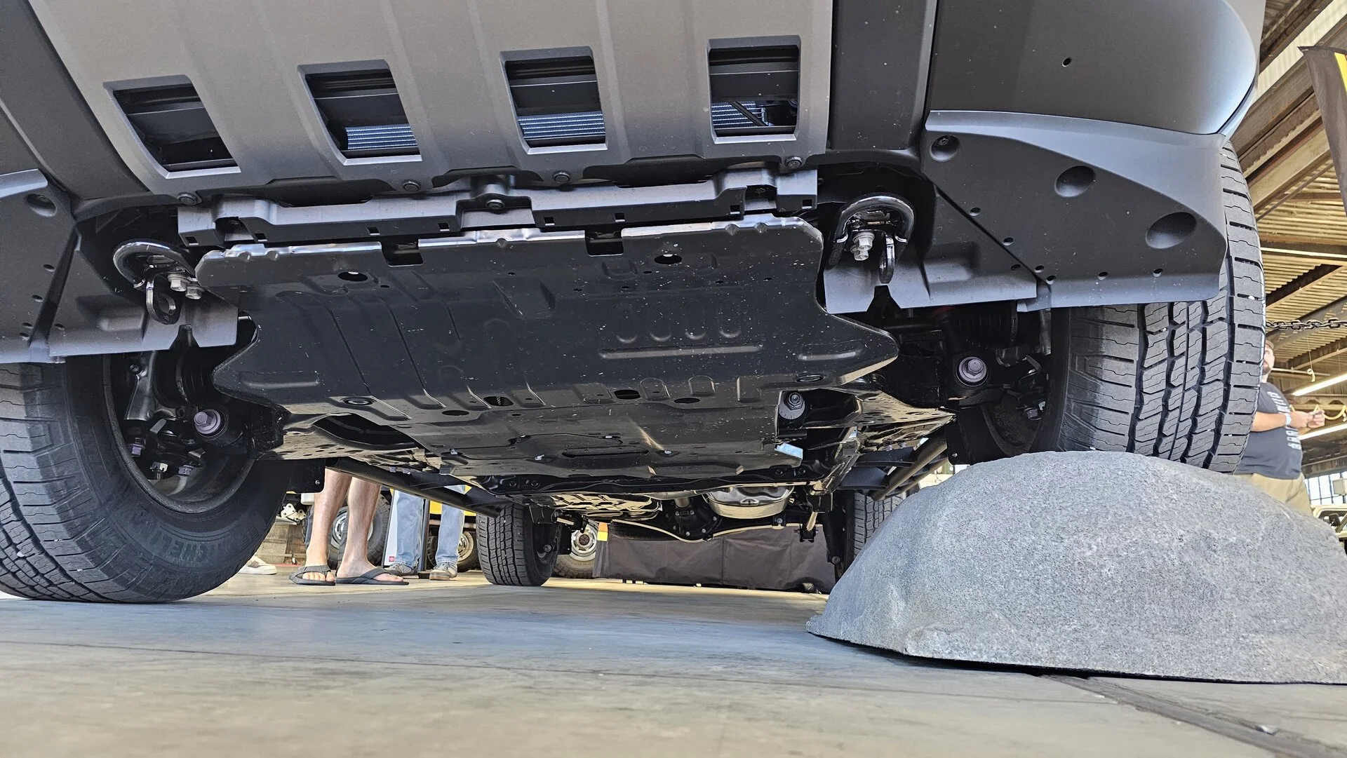

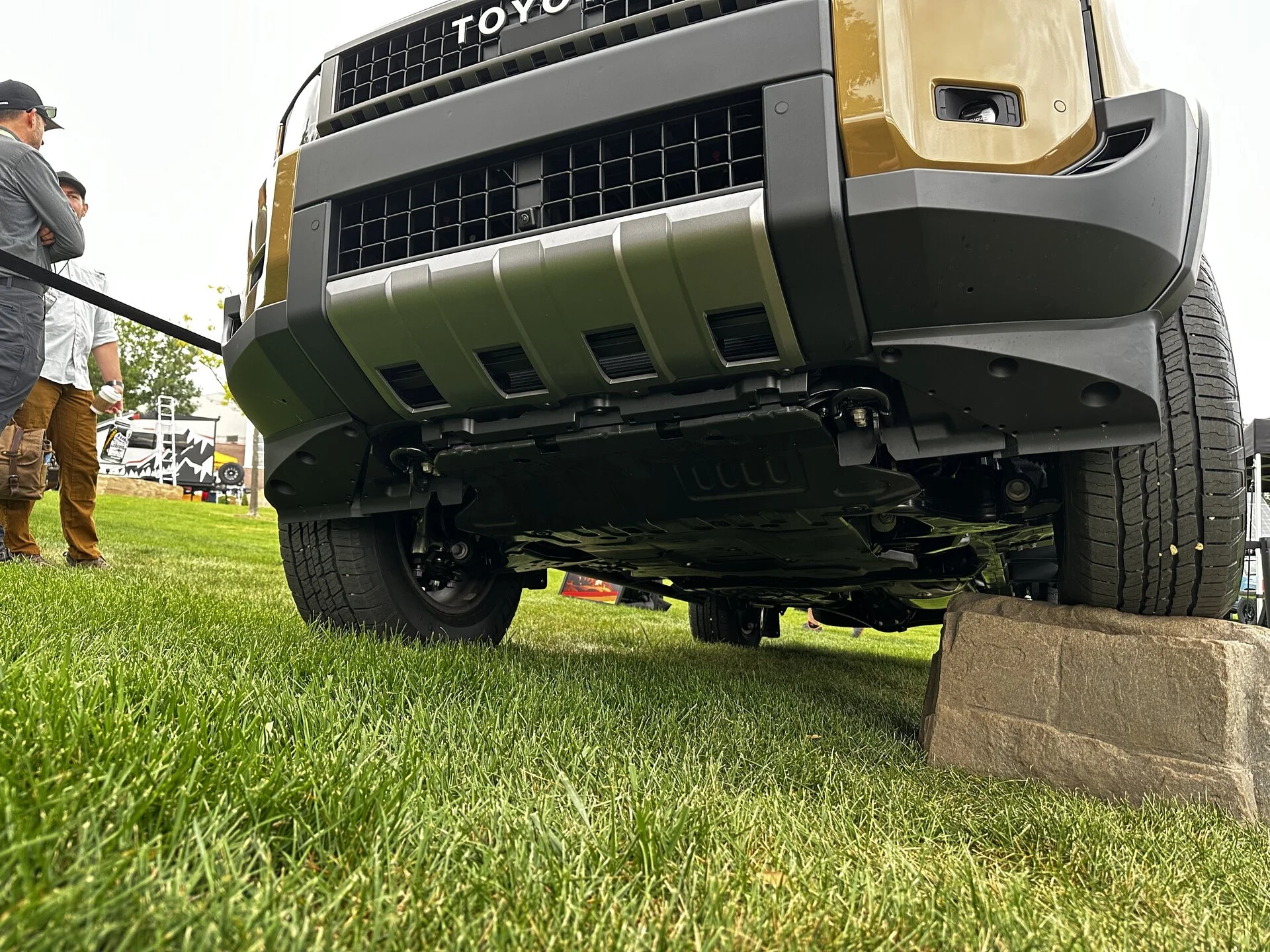

Close up of said rock...
