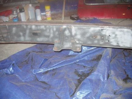

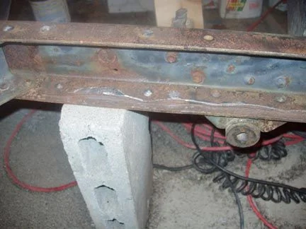

I bought some sand and started blasting today. It works pretty well. The only problem is my air compressor isnt big enough for this. I blast for 5min let the compressor sit for 10-15min and blast for 5min and repeat. But I cant buy a bigger one. I started by blasting all the way to metal. Then I decided on areas that arent rusty I am just going to do a quick spray over those areas so that they have a good tooth for the por. I dont know what to do on the rear open C channel frame. It has some flaking I will put up some pictures in a little bit.
Up to you.... I have plenty of exfoliation corrosion in those channels. I am going to remove the channels and replace them.
Worth it for the long run. BUT it its minor, you can coat it with paint and get to it in a few years when the money bags are oK. It can be done on the vehicle.

Here are some pictures.

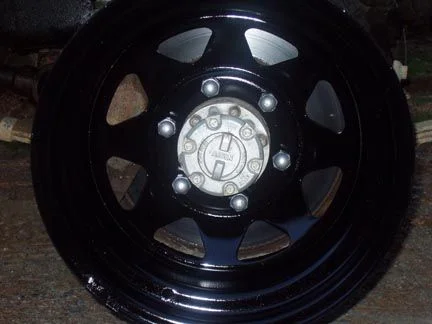

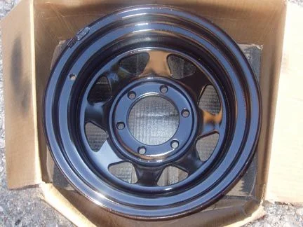

I did a little work today. I sand blasted the rust on one of the wheels then sanded it and cleaned the wheel with some mineral spirits. I put 4 coats of black and 4 coats of clear. I think it looks pretty good. I will be doing the other 3 soon. I am waiting to order and recieve my por15 so I can paint my frame. I included some before, after and mounted pictures.

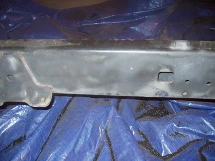

I have almost all the frame ground down and cleaned. I have to flip the frame over so I can get the bottom of the rails. The only problem is I cant do that by myself, so I have to rig up something to help me flip it. Any ideas? I am also going to start PB blasting all the bolts and stuff on the old frame so disassembly should be easy.

Since your at the rust prevention get some LPS rust inhibitor and spray it inside the frame rail. It comes in an aerosol can and goes in easy. It will give it a little piece of mind and it doesn't wash off with exposure...Just a FYI...Rims look good.:beer:
Thanks I thought the wheel looked pretty good. It took my a few hours to do the one.

I finished all the wheels this weekend. Today I flipped the frame over to get to work on the bottom. I took the bump stops and the front little engine shield/skid plate like thing off. I sheared a bolt in it and a bolt on one of the bump stops. So I will have to get them out somehow. Right now I am waiting to sell some stuff so I can buy a welder and a bigger air compressor. Its really slow work when you can only use air tools for about 3min and then wait half an hour for the compressor to cool down and work again.
