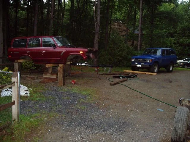

Nice going! Good project. (Don't let any youngsters play around under that body that's propped up on those wood blocks!!)

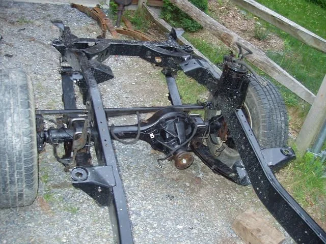

So today I got some more of the front torn apart. I bought the 4runner calipers and I plan to install them after i get my axle painted. For people doing a frame swap. The best way to get the springs out is to cut the shackle and cut the spring pin mount. Then once its out beat on the shackle bolts or spring pin until you cant hit it with the hammer then get a bolt and keep on hitting it. I also tried a puller but the cut and pound method is better. Also the best way to cut the U-bolts is with a grinder and a cutting disc. Just be careful because once you get enough of it cut the bolt actually snaps because it is under tension, so just be careful.

I got my front springs apart and one put back together with the AAL. I found that I have a broken leaf on the one spring set. I also got the front axle all painted. Tomorrow I want to have the rear apart and put back together on the new frame.

Today I got the front put back together and on the frame. It went pretty well besides puting the springs in backwards and having to do that over again. Too bad I cant put the rear together until I get a new leaf, still waiting for a certain MUD member to reply to my PM...:o. How do you like my shackle angle, looks pretty good, right?:D
Tomorrow I am going to pickup some supplies and do the cheating body work (fiberglass and bondo). I am just going to do one of the doors and the lower quarter because they will get replaced or cut out soon when I have the time and money. So for now its bondo. The majority of the body work I am going to cut and weld but the body is to far from the garage and the welder doesnt reach :doh:.
Looking good man, I just did that swap not to long ago and upgraded to an fj62 frame.
