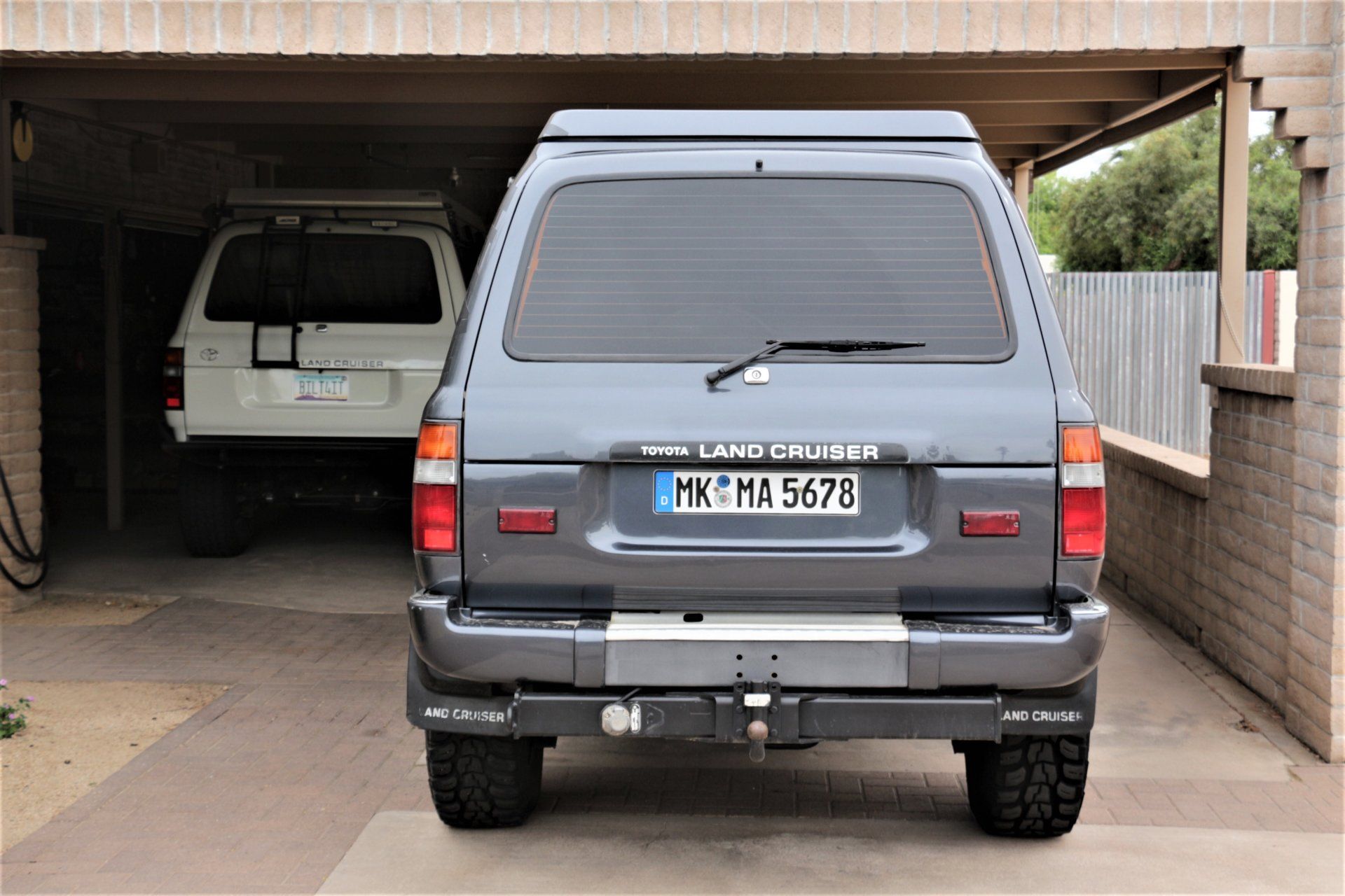

Tons of people told me this was going to be a PIA and costly. Again just because you heard 3X on the internet does not make it true.
Super easy zero issues
Before & After
View attachment 1967607View attachment 1967608
Very cool find! HDJ81's didn't come with trans coolers, not sure about HDJ80's, but have a look and add one if you don't already have it. Add a boost and EGT gauge (probe in manifold collector, pre-turbo), and a manual boost controller to turn it up to 15psi, really wakes these things up. Your green light on the dash not coming on till 2000rpm seems late, you might be able to play with the boost compensator and wake up the low end response with some more fuel down low.

IDI diesels don't handle boost nearly as well as DIs. The 1HDT was built from the ground up to have forced induction, the 1HZ was designed as an ultra-reliable NA motor -- and it does that very well.
Yes thank you for the picAs others mentioned, best place is on the center of the exhaust manifold, where the 6 runners collect, pre-turbo:

Sure... Right up until you install a pyrometer
You DO have a pyro, right? Tranny temp gauge is a very prudent install as well if you don't have one yet.
Cool truck. My 1HD-T is running at about 16 lbs boost with a 3" exhaust, so I see that red light all the time. Not worried.
Since you have the exhaust already, an intercooler is a huge upgrade on these motors. Even better if you can pair it with a G turbo and a Wholesale valve body. Like Enigma, I have none of these things
