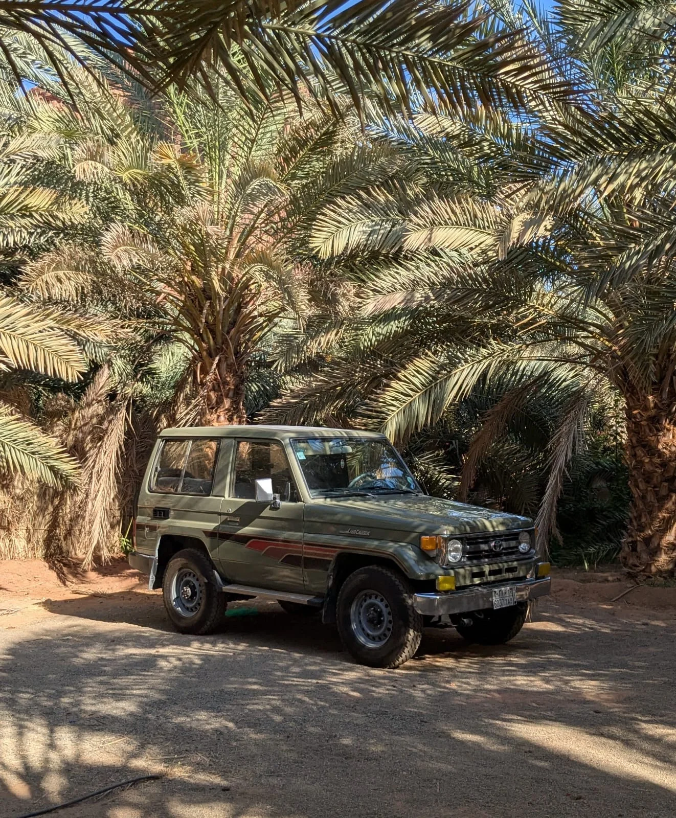

Hello all! I made a slightly impulse buy of a sight unseen ex government 'ruba' with 230K km on last week as the price was right. It's going to be a mostly daily and potentially driving it back to Europe in a year if Iraq remains safe-ish. I've been scouring the forum for info (such an amazing resource) but had a few specific questions you might be able to help me with...
- How important is the fan shroud and will the shroud off any 3F-engined LC work?
- I had the brakes serviced with new rear drums, new vacuum and master cylinder. Before the pedal had to be pumped to do anything, now they still feel a bit spongy/crap. Is this just what they're like? It's got discs up front.
- Any recommendations for tyres? I like the look of the skinny-ish 7.5R16s on at the moment but they are a mystery Chinese brand and not the best condition. 80/20, mostly tarmac, some desert.
- The 5 speed gearbox has a little bit of crunch sometimes when shifting. Is this normal/am I just a bad driver?
- There's a slight oil leak from the front left wheel hub. Is this just a new seal? The other hub has mastic on it /:
- Is there anything else I should get checked or any must do upgrades? Have had a brief look at the Pertronix kits
Cheers

Yeah I maybe should have gone with the 4.5 in hindsight but this was only 20,000 SAR and (stupid reason I know...) it's the only green one I've seen here. Cheers for the part number, toyotadxb seems like a good shout. Retracting seatbelts next on the list

So, there were no 1990 FZJ70 Land Cruisers. Does this have an engine swap? Or do you actually have an FJ70 with a 3F engine?

The front grill is from a post 1995 truck.
