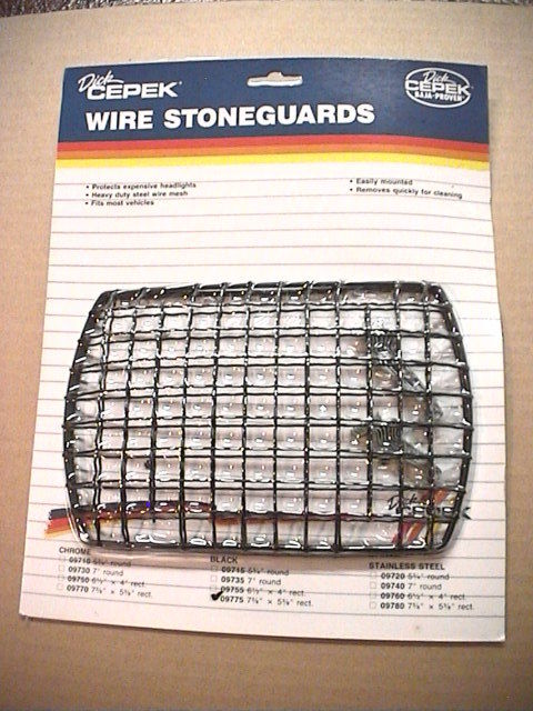

Mine are glass. I wonder if you can still buy these. I remember my parents had them on their 4runner when I was a kid.
Oh yeah! We used to have those on our station wagon as well. I'll be googling. Ugly as sin, but these headlights are such a pain to replace! Pretty much have to disassemble the whole grill. Not ideal in winter.

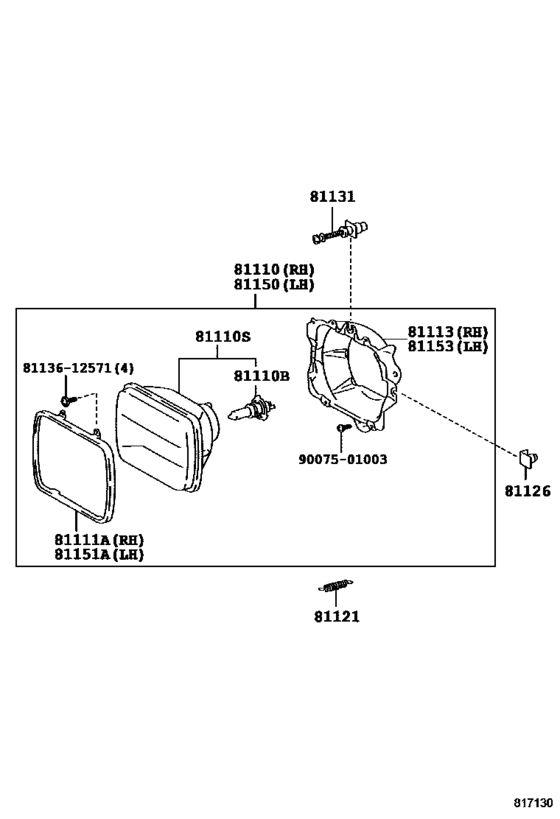

I double checked to see if the H4 style were factory installed in the LJ78 and KJZJ78, and it appears that they are. I'm confused why some of you guys don't have them. Could be the original Japanese owners tossed them when it came time to change bulbs.? Image from Megazip. Part number for 81110S is 90981-04027. Pricey of course. Between the rubber boot and glass housing is the H4 bulb.
I believe mine were removed during the initial import inspection because they face "the wrong way" so I think the original owner had them replaced with sealed beams to pass the inspection. Do yours bias to the left?
Yes they do, just slightly. Never had anyone flash me though.
Wish the original owner had kept them and given them to me! I think I'll have to order something off eBay or Amazon. Doesn't seem to have a replacement for Canadian napa.
