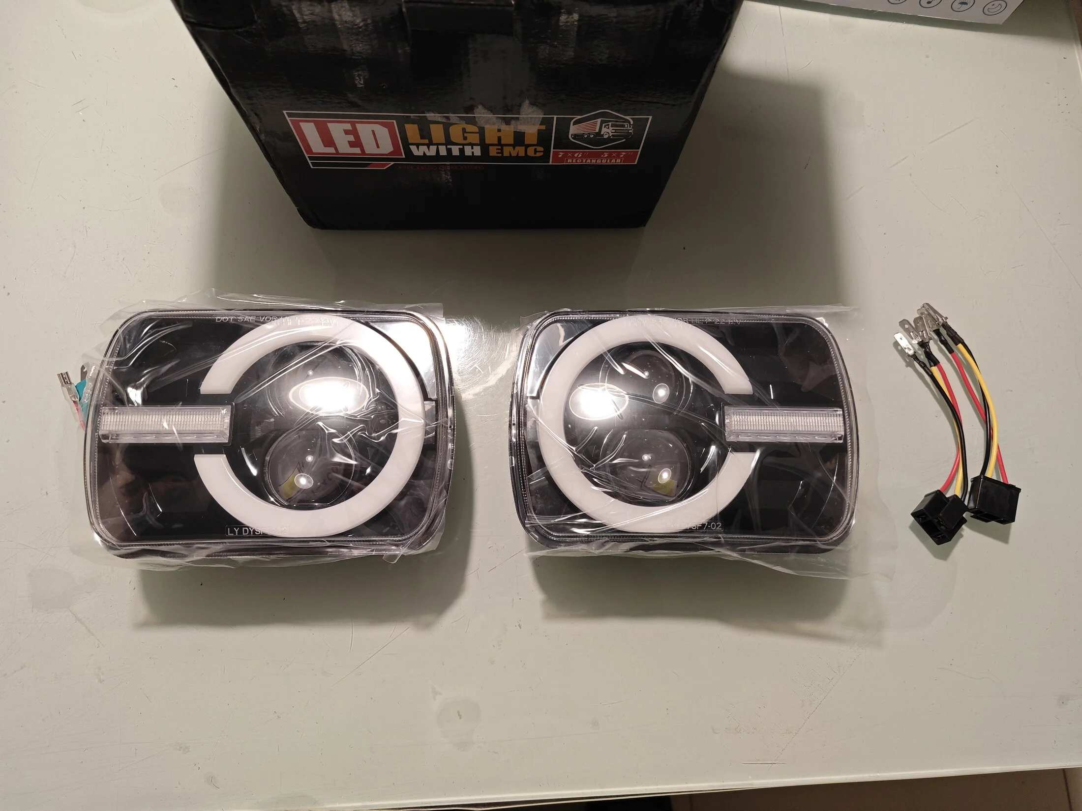

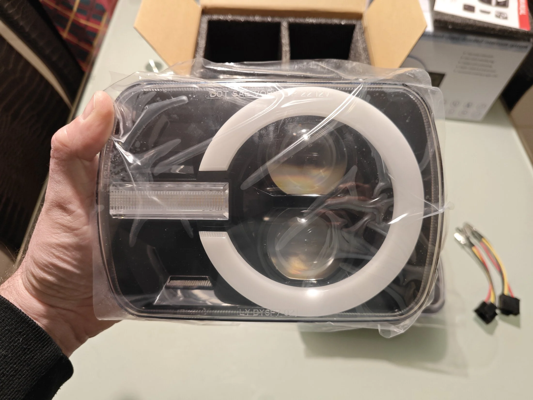

I just bought these off Aliexpress, I think they look really good! Should be installing them over the weekend, will give you an update later on if interested.

View attachment 3810890View attachment 3810891
Just a heads up, you may need to pickup a relay for these to work. I am not 100% though for the prado's, but if they are the same as the land cruiser and the headlamps are negative switched, you will want to grab one of these: Harness

You're right! Just stopped by the garage and plugged one side to see if it works and it doesn't. Guess I'll have to order the conversion harness.

Yep it's also H4 but I'm gonna use polarity converters instead. Stopped by at a shop and they said they installed many of them (mostly on Hiluxes) and they work well. Same as these ---> https://www.amazon.com/Aramox-Negative-Converter-Reversed-Polarity/dp/B07R76NZYP?tag=ihco-20

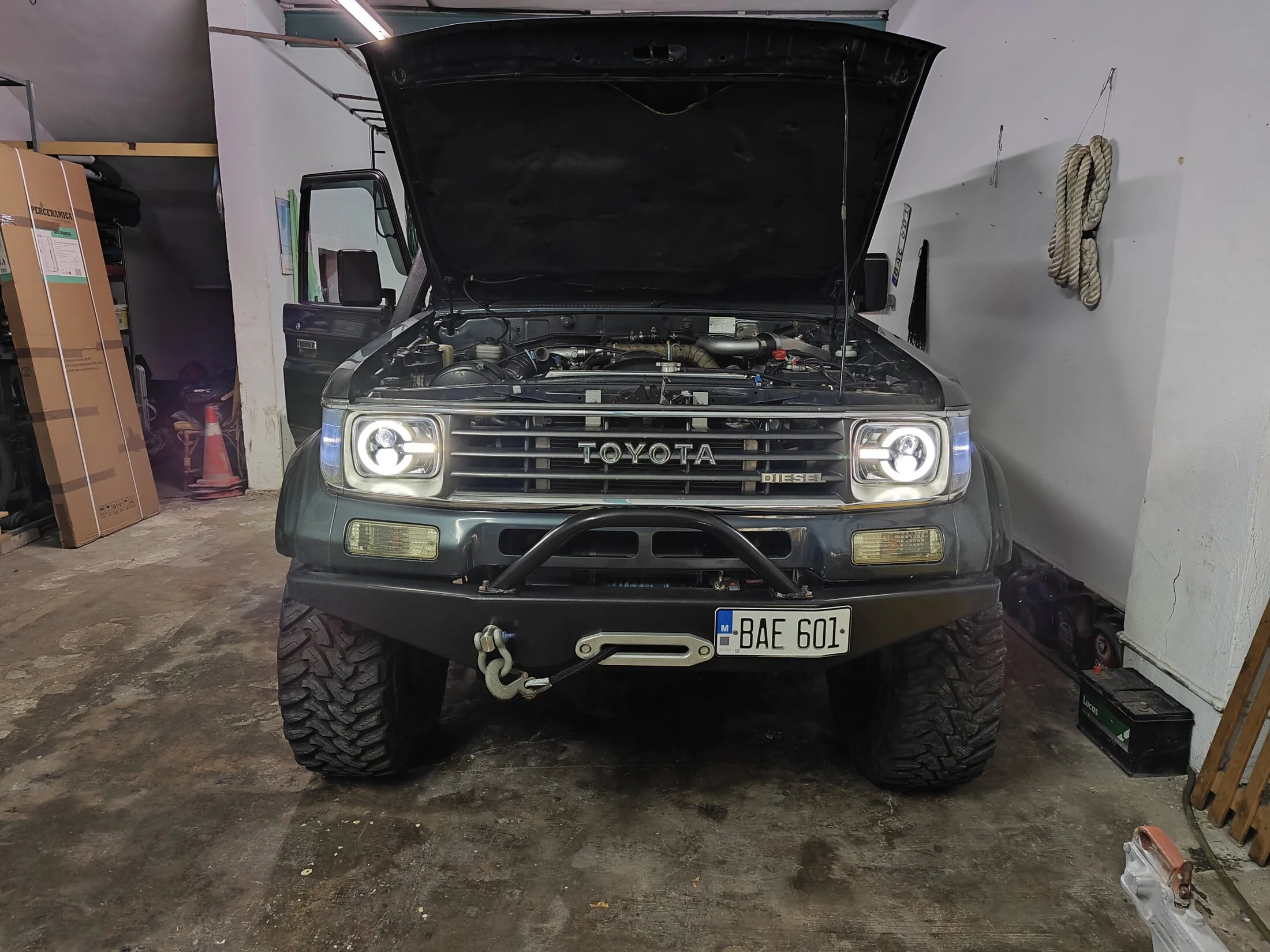

These ones should fit since I've seen other Prado owners install them, but I'll confirm tomorrow. Fingers crossed.
Guess they work just fine since regular H4 bulbs are filament type so polarity does not matter, unlike LEDs.
I Installed the lights yesterday, and as you said @AirheadNut they do not taper enough for the lamp retainer to fully sit, but I tightened the bolts (you need longer ones) just enough to create some tension and its fine. Probably if you keep tightening it might bent in shape and sit as well. Haven't really tried them at night yet but they look really bright!
