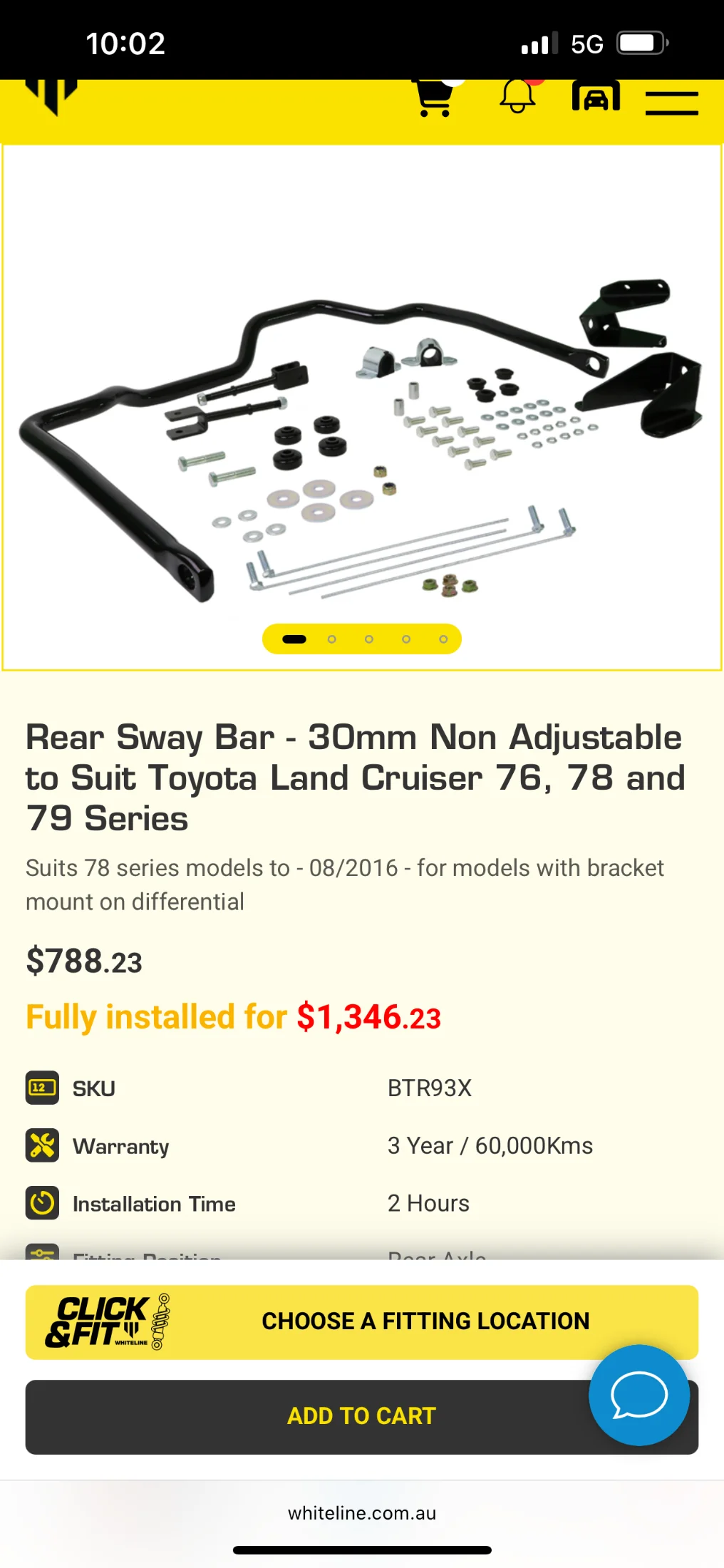

Looking for an after market solution for a rear sway bar for my Kzj78. I got the car without one and paranoid about the WOF inspection in NZ. Tried local part yards and market place etc but no luck. Is there any aftermarket ones that will fit or any other cars that I could retro fit to suit? A quick Google suggests that whiltelines kit will fit however I’m unsure?
Hello,
That sway bar may be intended for a Heavy Duty 70 Series, namely a VDJ76/78/79 or an HZJ/HDJ78/79.
You may want to ask the seller about this detail.

Exactly what I was thinking, will have to wait around till someone is breaking one for parts local to me I think.

Perhaps it is worth asking vendors (including your local Toyota dealer) about a sway bar for a KZJ78. It may be a long shot but there is nothing to lose in trying.
Chances are there is a stash out there with one of these available.
