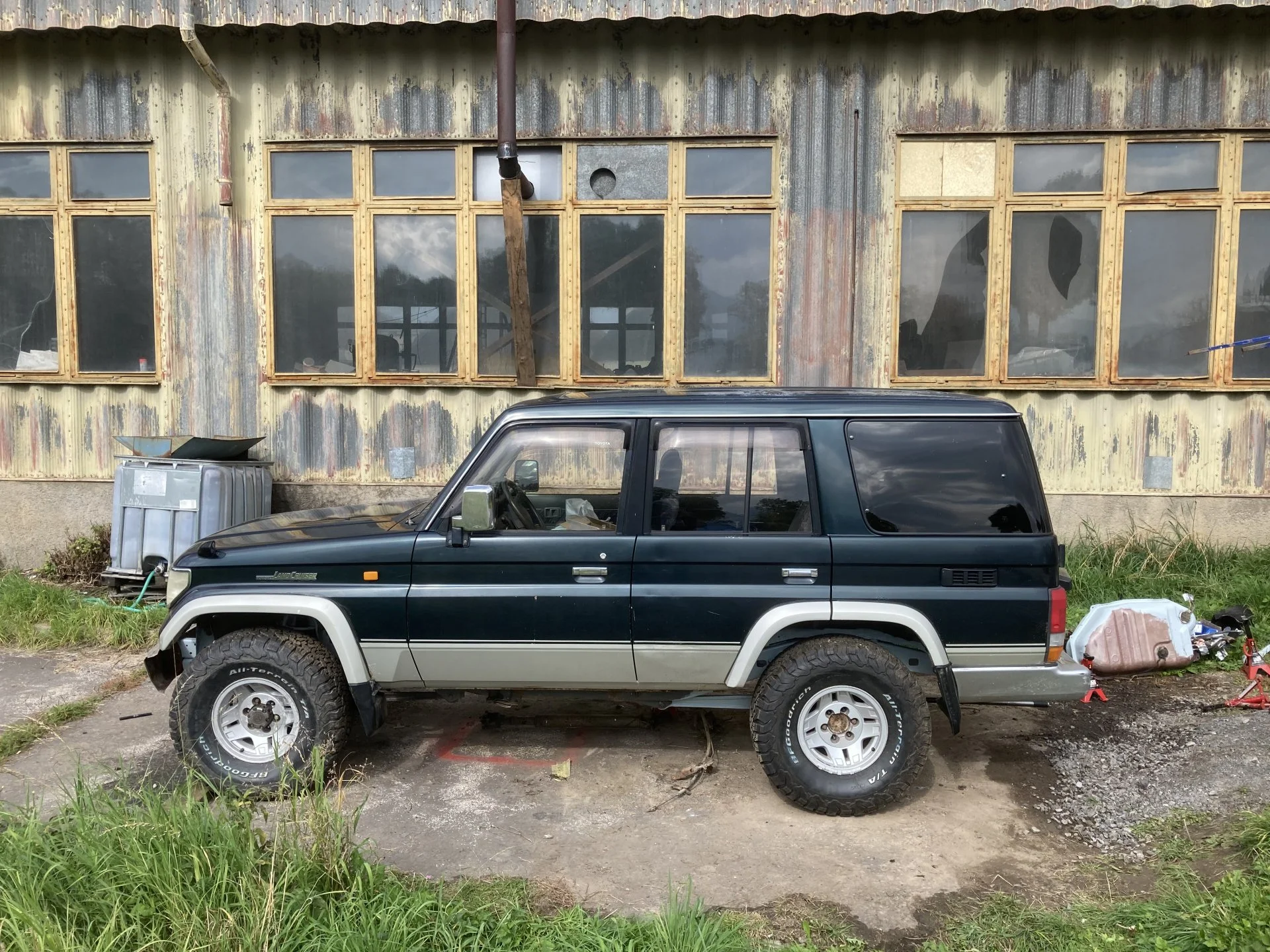

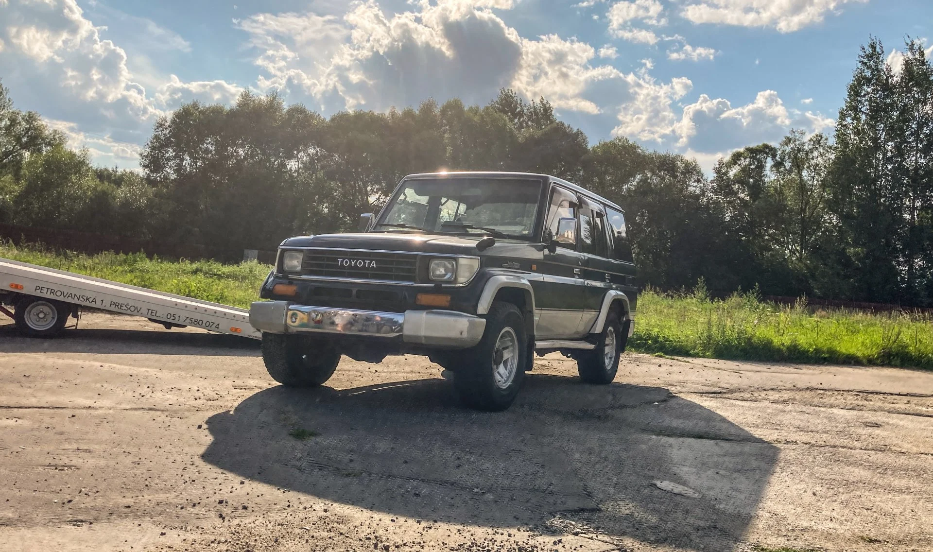

Hi everyone,

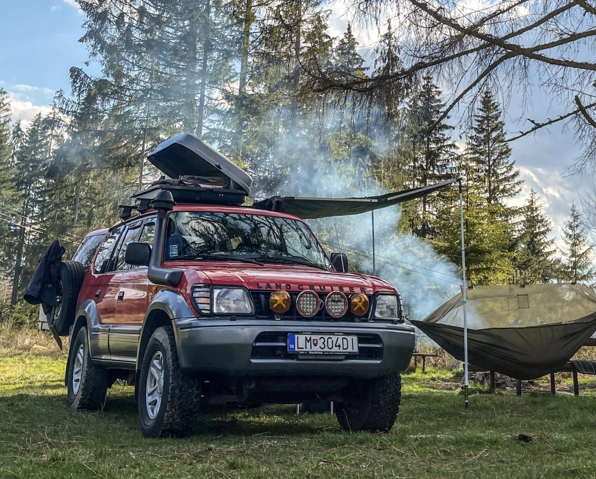

I recently had the pleasure of buying KZJ78 for my family. I used to own a KZJ95, but the five-door Series 70 was my dream. I hope we have a long way to go together.

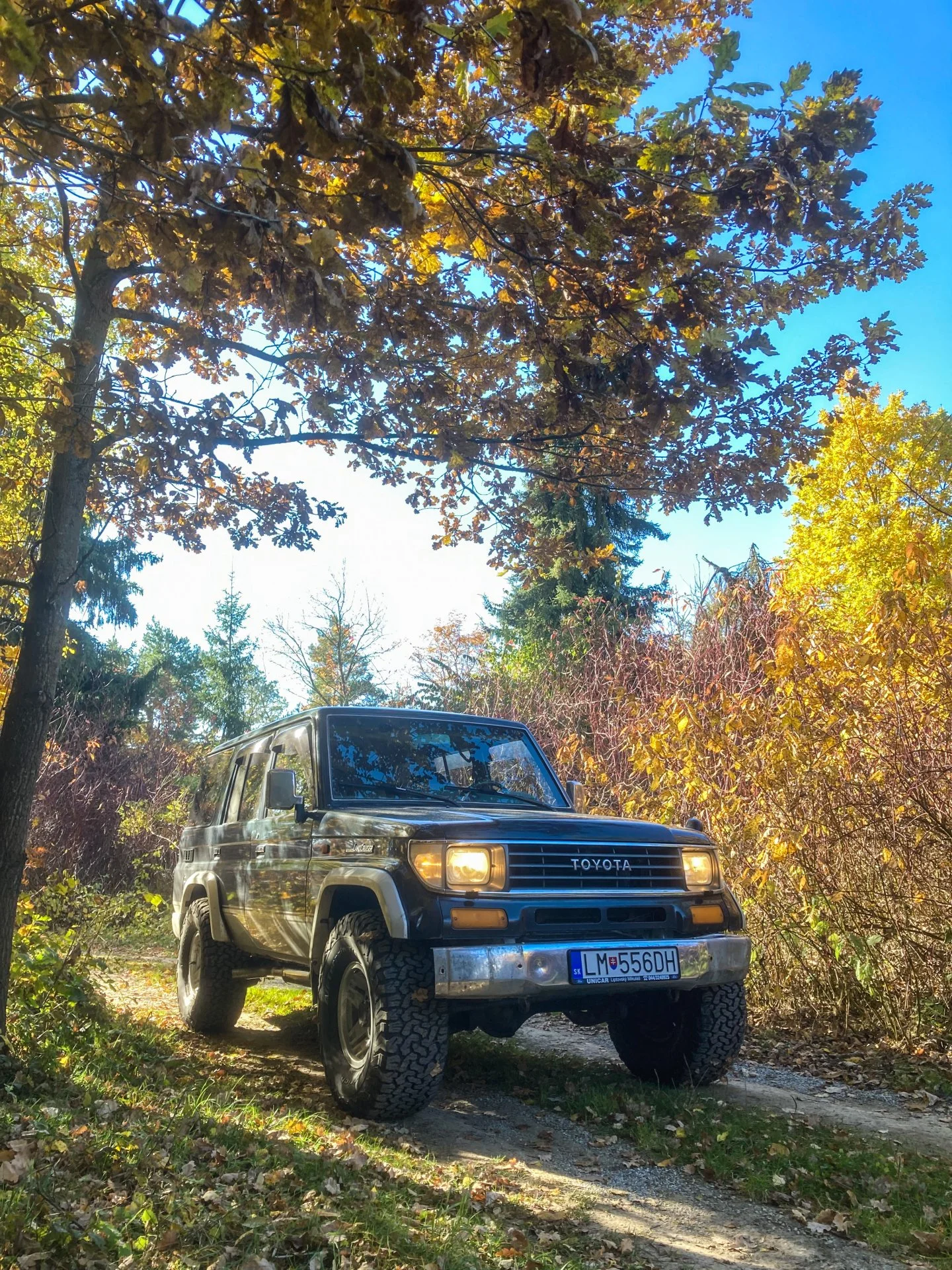

Two gussets hold the bumper. In turn, they attach to the frame with four bolts. This is for factory bumpers.
That bumper looks modified.
If the gussets are missing, it should be attached to the frame with the four bolts.

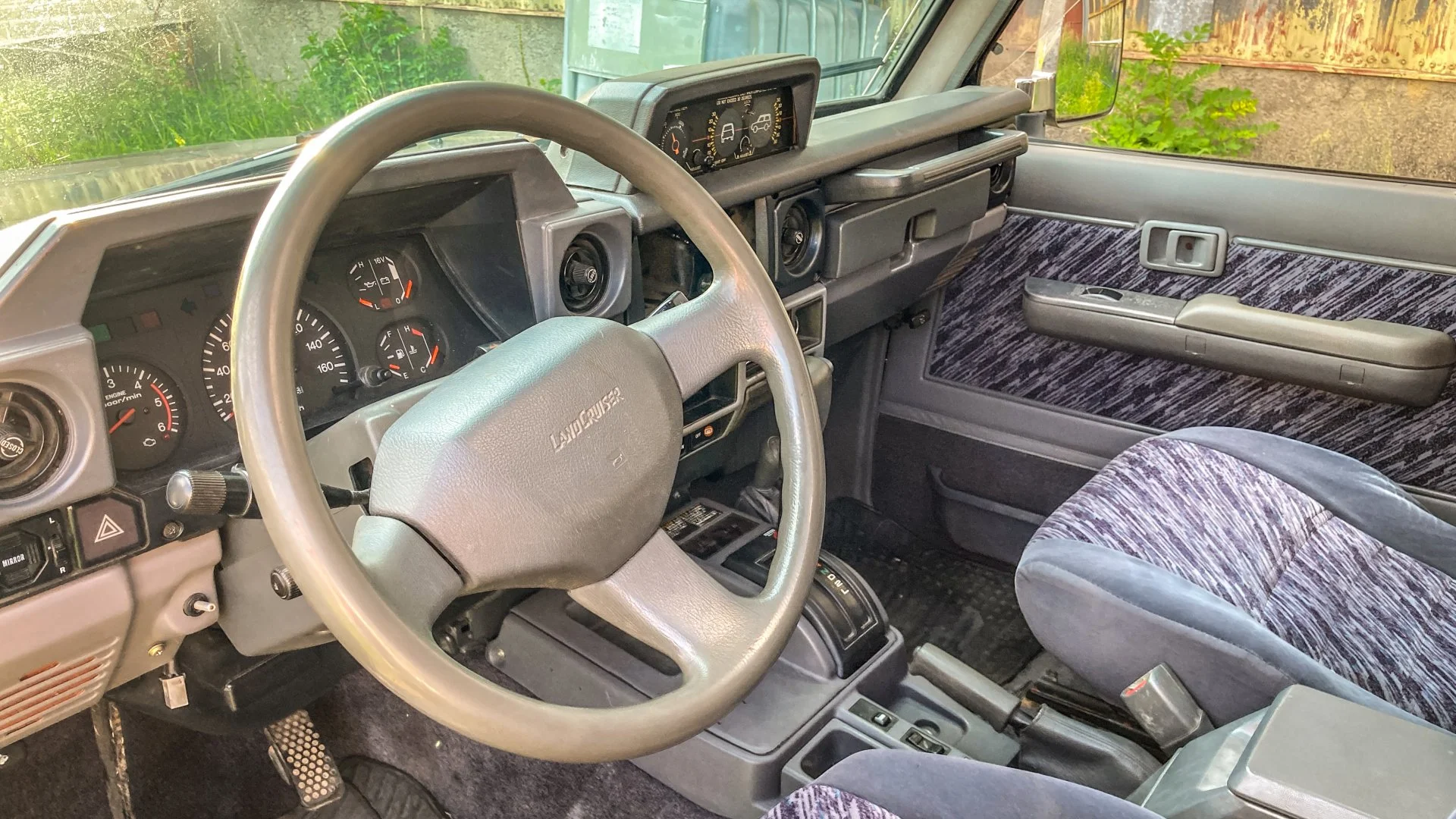

one question: what is the function of the normal / power button on the automatic transmission?
It changes the shift pattern in the transmission. "Power" delays the shifts; at least in the lower gears.

I dont know if you are aware of this or not, but judging by the shifter and center console position, this is a car converted to LHD and was RHD originally. Frame number can tell the truth
yes, the vehicle was imported from Japan and only then transferred to left-hand drive
