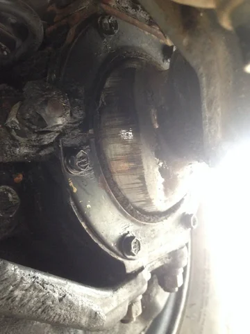

So, yesterday I just bought my first LC :clap:1988 LJ70 2LT 263,000km. The previous owner owned a mechanic garage here in Spain and did regular maintenance on her. I'm sorry of say I neglected to look under the front wheels before I bought her but this morning I went out and I saw grease all over the place.
The passenger side doesn't have shine, the driver(left) side is really shiny, but they both look pretty caked in grease. No leak spots on the ground though. I dont feel like this amount of leakage is normal, is there a problem and do I need to rebuild? i saw this thread https://forum.ih8mud.com/threads/ball-joint-steering-knuckle.143256/
The steering is a bit sloppy and she pulls to the right when I brake at higher speeds if that's any extra indication. He said to bring her back to his shop if we had any problems... Just wondering if I should call him or not. Here in Spain I don't speak much Spanish and he speaks no English so it is a bit of a problem trying to be understood.
L/h side looks like inner axle seal is leaking. The grease is out of the knuckles and is common when the wiper seals get old. This grease lubricates the cv joint swivel hub bearings.

The grease seems to be very liquid and a fairly recent leak. As many here have pointed out, the inner axle seal is probably busted. He might have replaced all the bearings 5 months ago, but maybe damaged the seal pulling the axles out and installing them back in. I would degrease and power wash all the area and then dig into replacing the seal. As others pointed, OEM or Marlin's are probably your best bet. If I was in Spain, I would probably go with OEM as you can probably walk into a dealer and get the new seal quick.
These videos have been put together by a MUD member @lshobie and they will probably be of great help to you (though you do NOT need to pull the knuckles to replace the seal, just dig in until you have access to the seal, replace the seal, and then re-assemble, unless you are wanting to replace the bearings as well):

The seller is trying to blow you off, in my opinion. The amount of grease/gear oil on the axles indicates that these axles have never been serviced or the service was done many, many moons ago.
Your best course of action is a full rebuild, including wheel and trunion bearings. That way you KNOW the axle is in top shape and don't have to worry about it failing at the most inopportune time.

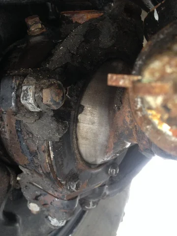

So I just started cleaning the driver side. Under a pound of grease is so much caked in mud it's like a rock. The arm was twice as thick, I couldn't even see any metal! It's got to be almost an inch thick everywhere.
There is hardly a touch of mud elsewhere, I don't get it!
It may look like mostly mud, but it is more likely a LOT of grease with dirt mixed in. That side axle seal failed the gear oil sloshed into the knuckle, turned the grease to soup and when the felt knuckle seals were eventually saturated, the soup comes out more and more. That is the short side of the axle, so the gear oil can reach that seal more readily when taking a turn or if the truck was regularly parked on an angle with that side of the truck on the downhill side. You can pump grease into that goopy side, as a temp fix, but the gear oil will just break it down and turn it into soup. This isn't good for the bearings because it washes them out.

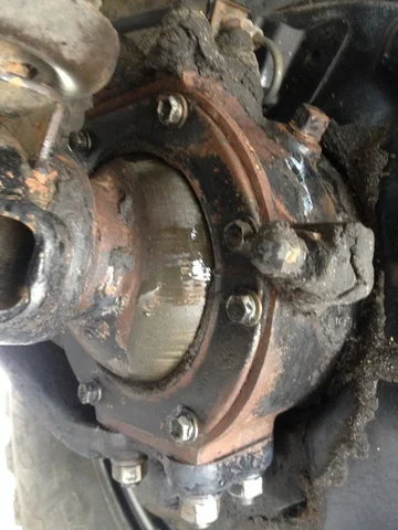

Well, I pressure washed and then drove 10km home and the driver side looks like that
Passenger side seemed to stay clean
It unearthed some rust I see, any tips to help that?
Next step is to check diff level but I have to unpack the garage and I have no idea where my tools are.
Yep, axle seal is toast and the felt is saturated with gear oil and no longer doing its job. Time to dig in and rebuild those knuckles. You will need a 54mm hub socket, a brass drift or brass hammer (for the cone washers), a seal puller and a full set of metric tools to accomplish the task.
