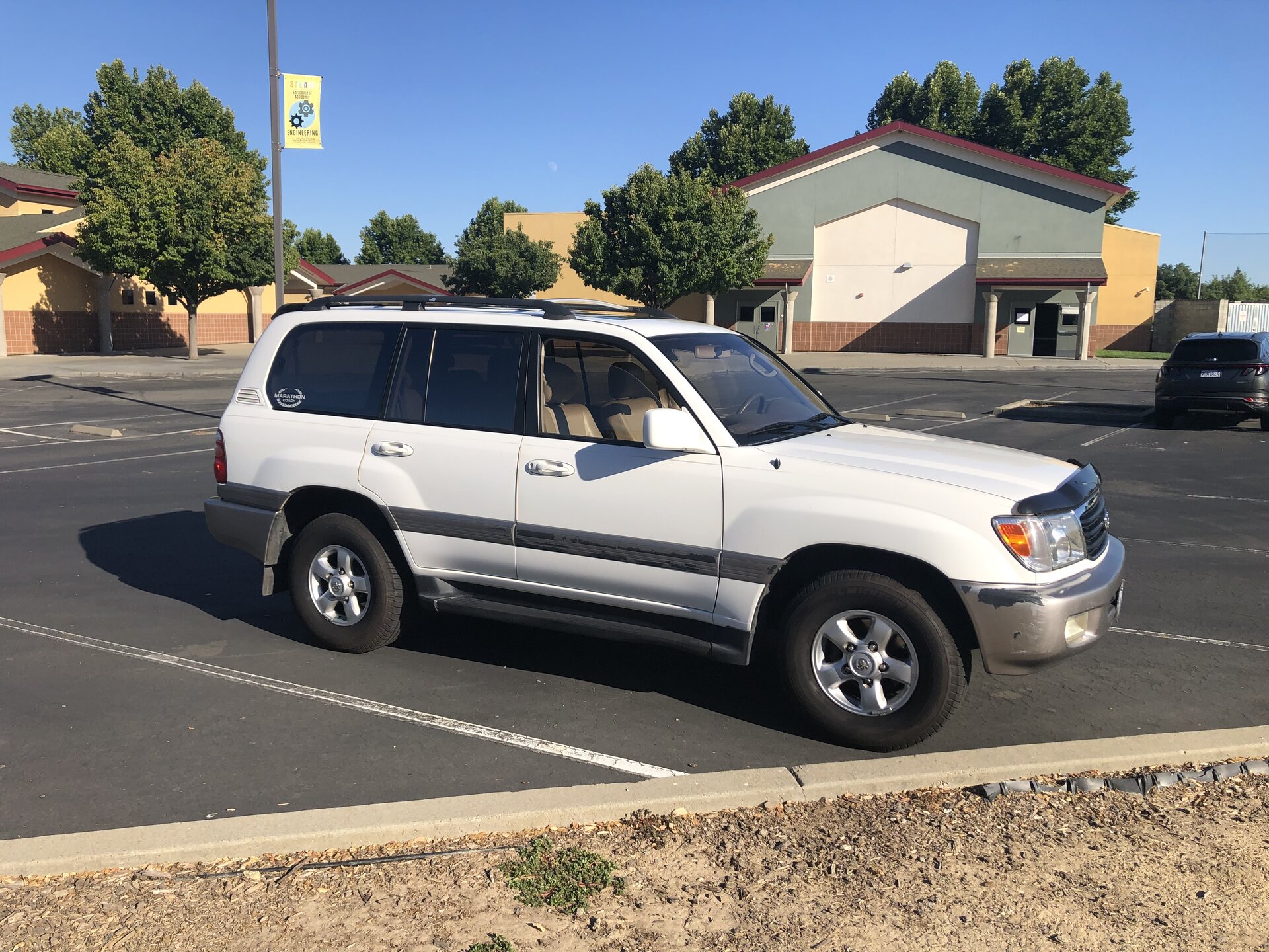

This summer, I flew out to pick up my "new" 1998 Land Cruiser in California. I bought it from the original owners with 299,295 miles on the clock. When I got there to check it out, I could hardly believe how clean and well cared for it was. Near perfect aside from a few scuffs on the exterior trim and cracks on the front seats. It came with a huge stack of maintenance receipts too (going back to 1999), which really provided some peace of mind for me.

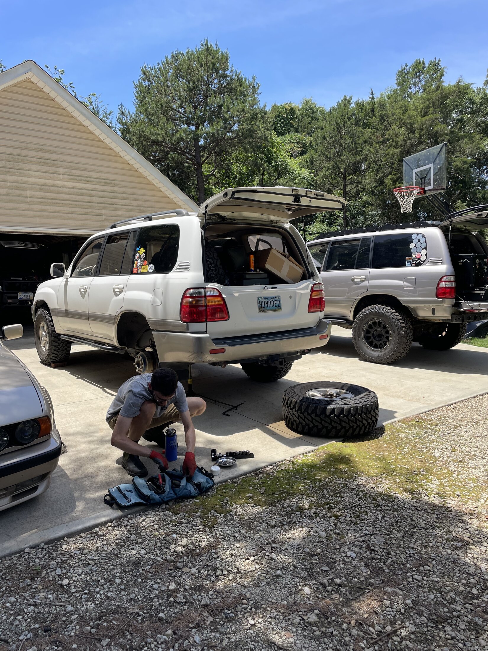

Poor man's oil change setup.

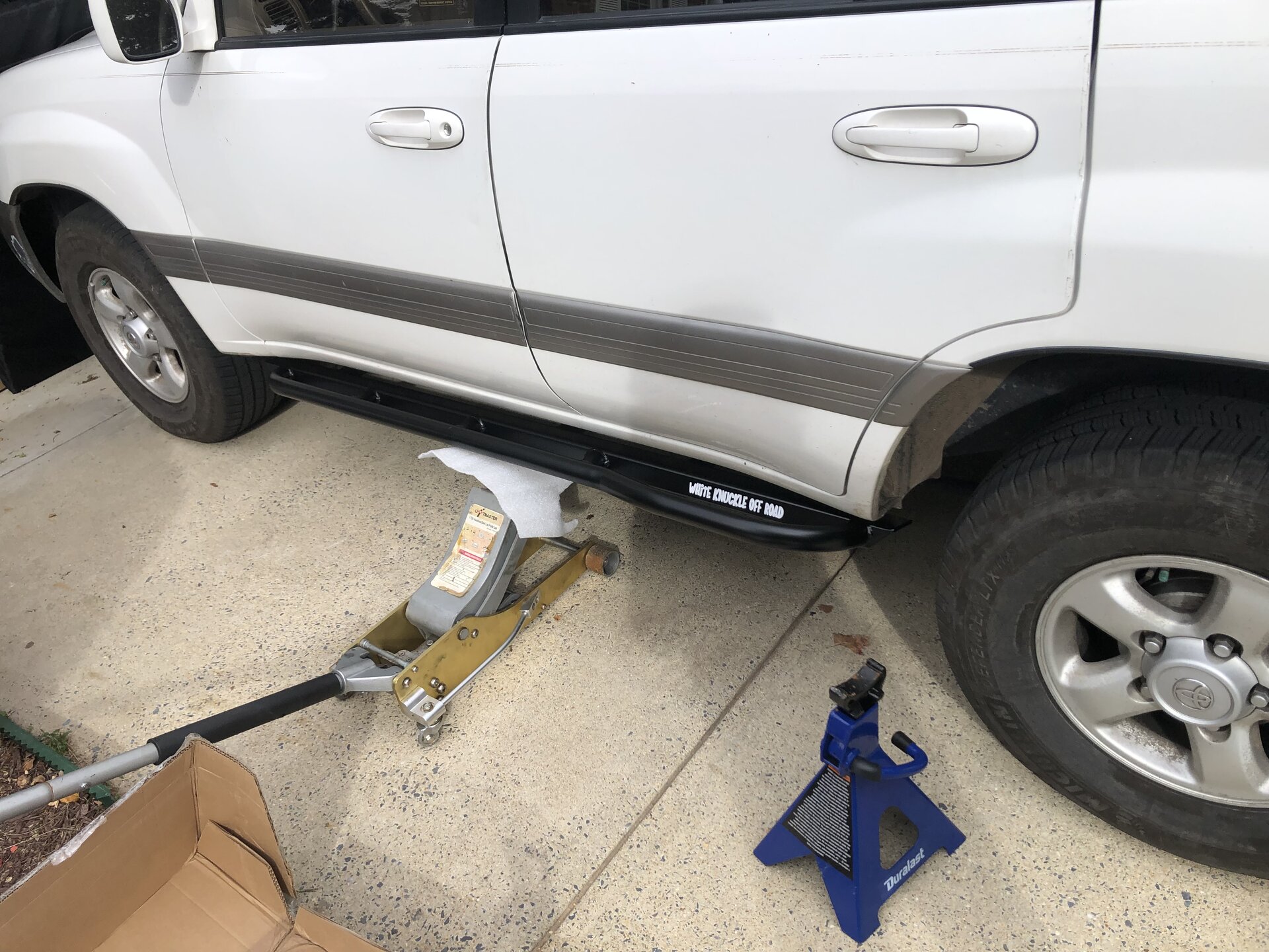

Got back home and got the running boards off right away. It was pretty surreal for me to have those bolts come out...easily. And have shiny threads instead of brown.

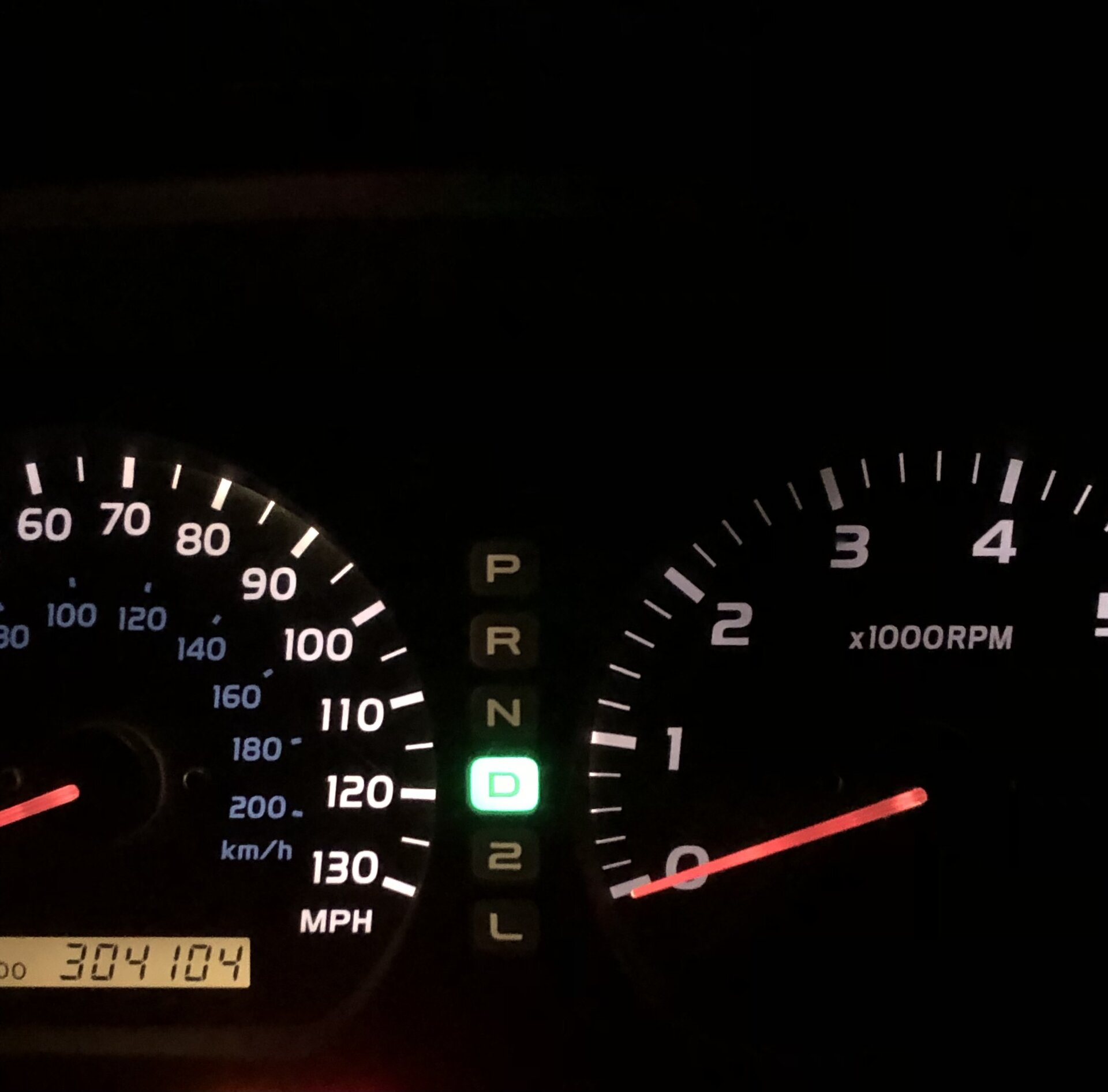

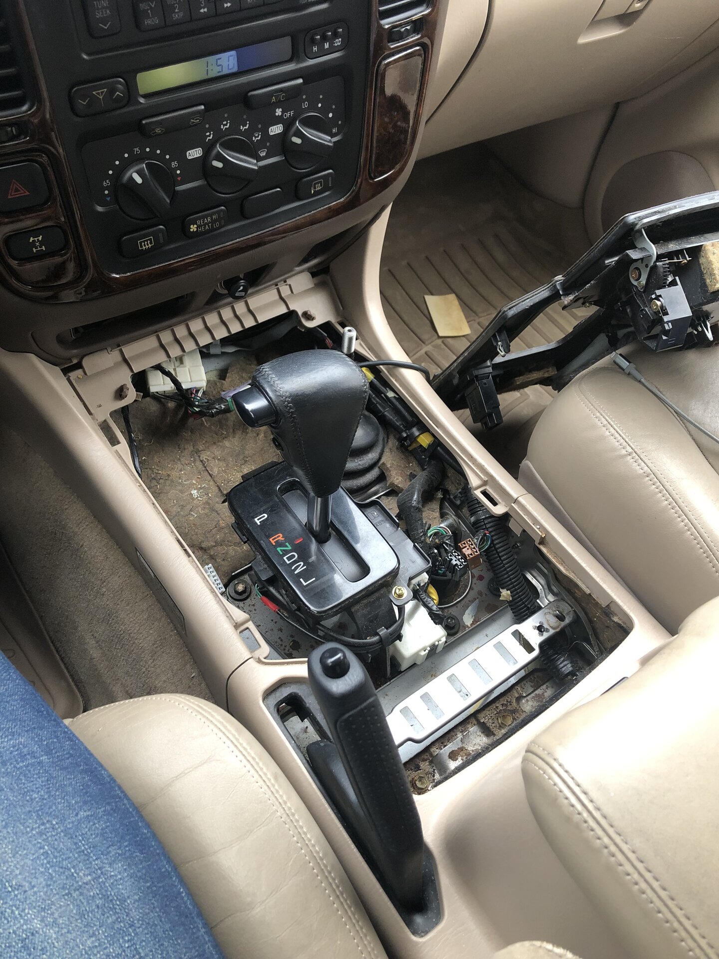

Failed MD safety inspection because the D light, shifter backlight, and parking lights were out. 2 of the 3 never worked on my old truck and I was not looking forward to having a working D light blasting into my eyeballs at night. Turns out it's not as bad as I expected.
While I had the center console apart, I installed some nice big 3D-printed cupholders from Cruiser Design & Manufacturing. The '98 cupholders are impressively useless compared to the ones in my '01. I found a business card for a flooring salesman in Seattle under the center console trim. The truck left Washington for California in about 2000 or 2001, so that was an old one. This truck also still had original Toyota salesman's business card tucked into the owner's manual jacket. Talk about a time capsule.

After driving cross-country holding my coffee and water bottle between my legs, these cupholders made a big difference!

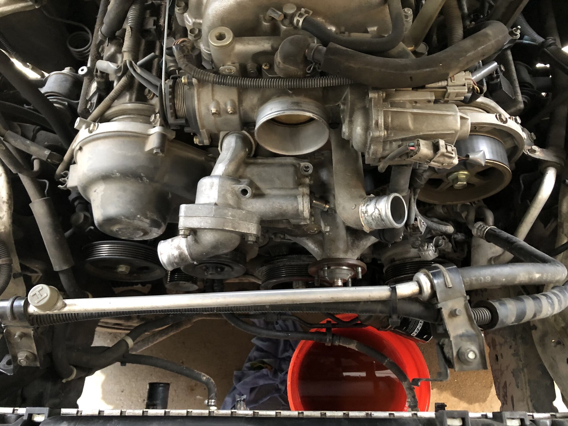

Next step: this truck needed a timing belt. I had just gotten the job done successfully on the old truck, so I felt more confident going into this one with that under my belt (no pun intended). Sure enough, I knocked it out much quicker this time. Big thanks to @cruiserpatch and @OTRAMM for very helpful videos, as well as mud threads from a few others whose names are escaping me right now. Having parts (i.e. pulley bearings, fan bracket, etc) ready before you start is a REALLY good idea on a truck of this mileage. On both this truck (304k) and the old one (283k) most of the pulley bearings were bad except the AC compressor. On this one, the serpentine idler had clearly been replaced recently, but I replaced the fan bracket and the bearing in the serp tensioner pulley. I found putting the new bearing in the freezer made it very easy to press into the pulley.
When I first moved my Scangauge over to this truck, I was unpleasantly surprised to see coolant temps hovering in the 205-215º range. It has a relatively new radiator, so I expected the cooling system to be healthy. While doing the timing belt job I replaced the cheapo parts store thermostat with OEM and all was well again. Amazing how spending an extra $10 on your thermostat can get you running 30º cooler.

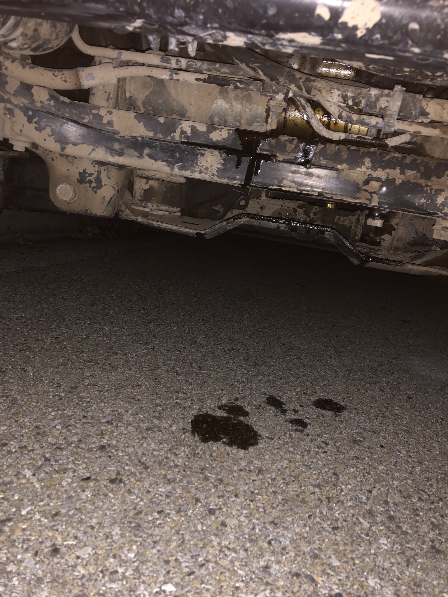

The whole job went smoothly until the very end, when I ran the truck for ~30 minutes to burp the cooling system. I shut it off afterward and discovered...

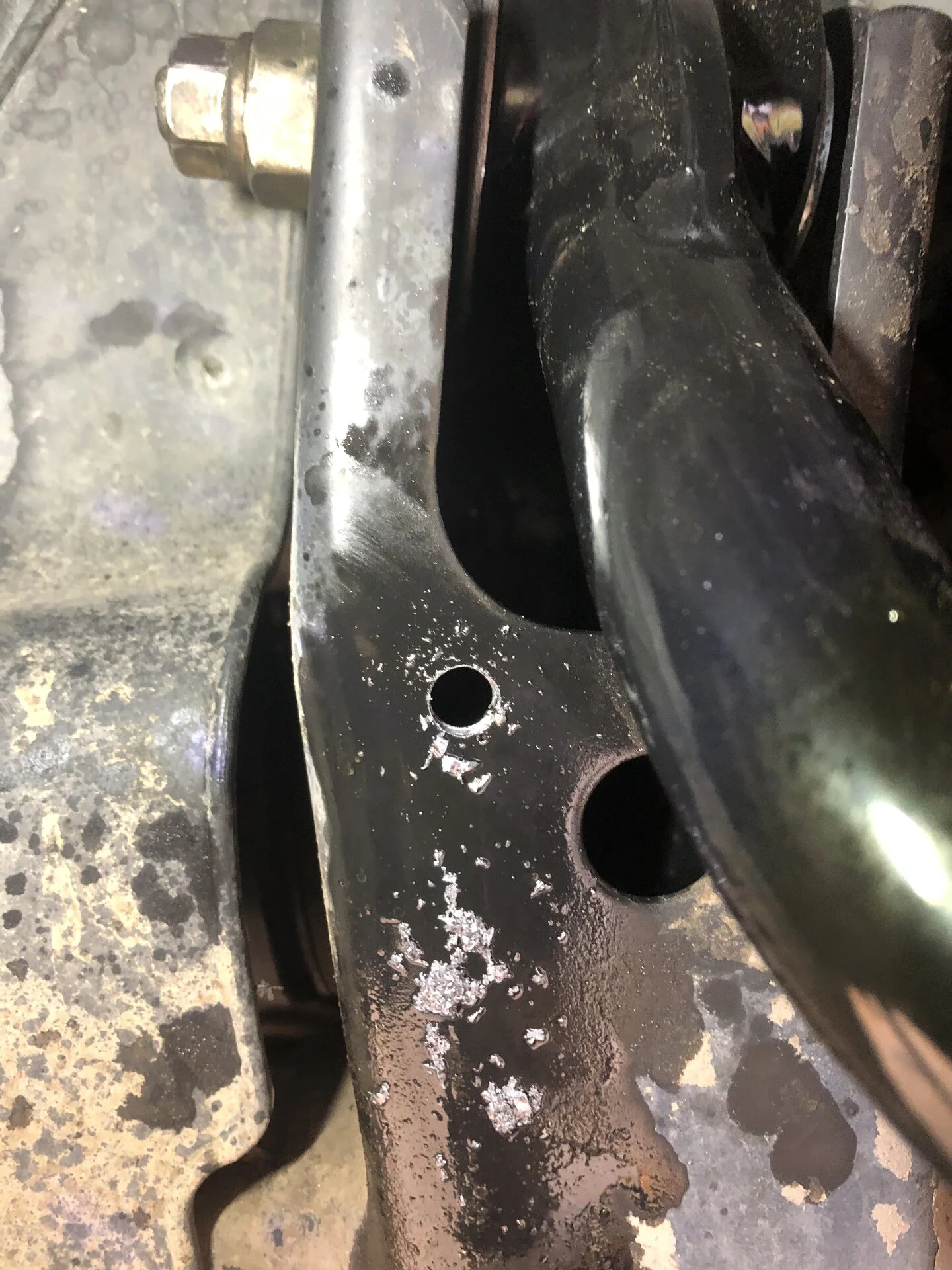

...I'd screwed up pressing in the new crank seal. I replaced this on both trucks because the area was a bit oily and grimy. So in an attempt to fix a tiny seep, I created a huge leak. I learned a valuable lesson (triple check that it's PERFECT when you're pressing in a seal that deep in the engine bay), and I ordered the parts to get back in there and take care of it myself. However, to make a long story short, it became clear that I wasn't going to make it to Cruisers on the Rocks just adding oil to compensate for the leak. It continued to worsen and it would not have been pretty had I tried to drive it much like this. HUGE shout out to the absolute heroes at Extra Mile Performance in Odenton, MD. They squeezed this job in on the day I had originally planned to leave for COTR and righted my wrong. An expensive lesson, but one I will be remembering.

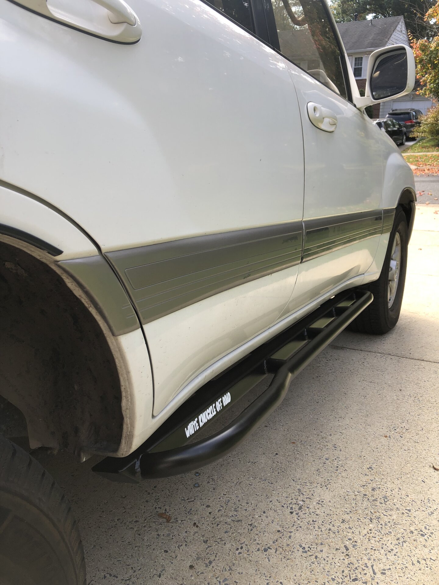

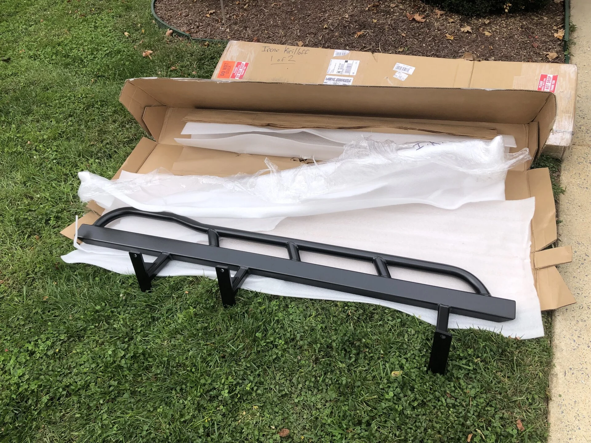

My White Knuckle Off Road sliders showed up in the mail, right on schedule. Craftsmanship, packing, and customer service were all on point and I'm happy I went with them.
Those bolted right up easily and I moved on to suspension. I put a lot of thought into what I wanted for this truck, and tried to take into account what I learned from my last build. There's been a lot of discussion recently among some of my close Cruiser friends (especially @ga12r1 and @cruiserpatch) about what makes a suspension system really work well offroad. That got me thinking, and I started taking notes from Lee's knowledge and incorporating my own ideas about how I wanted my rig to perform. I was fairly happy with my Ironman foam cells on the old truck, but I felt there were some areas that could be improved. I was also reminded on my trip home how great the ride is on a stock 100, and I wanted to try to preserve that comfort a little bit more this time around.

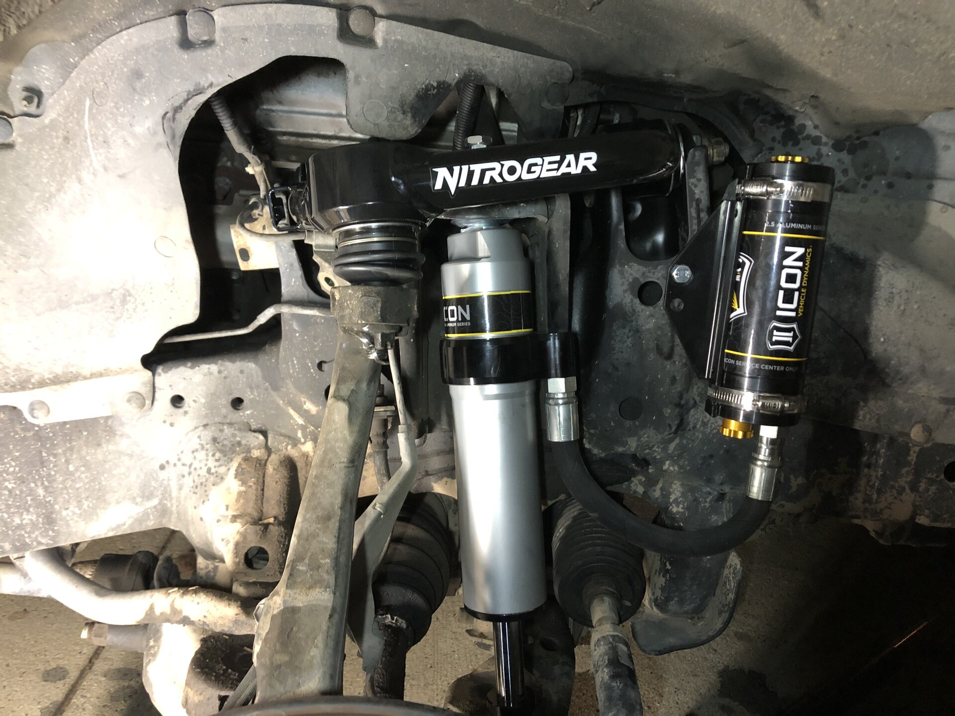

I figured that making the truck a little less oversprung and underdamped than my last setup would also help achieve the on-road comfort I was looking for. With all this in mind, I splurged on some Icon 2.5" remote res shocks. I kept the springs pretty light by re-indexing the factory torsion bars (I've come to feel the HD bars that come with lift kits are stiffer than necessary for most 100 builds) and going with OME 2860s out back. I was putting most of my build-starting budget into suspension, so I knew the truck would be staying light for a while.

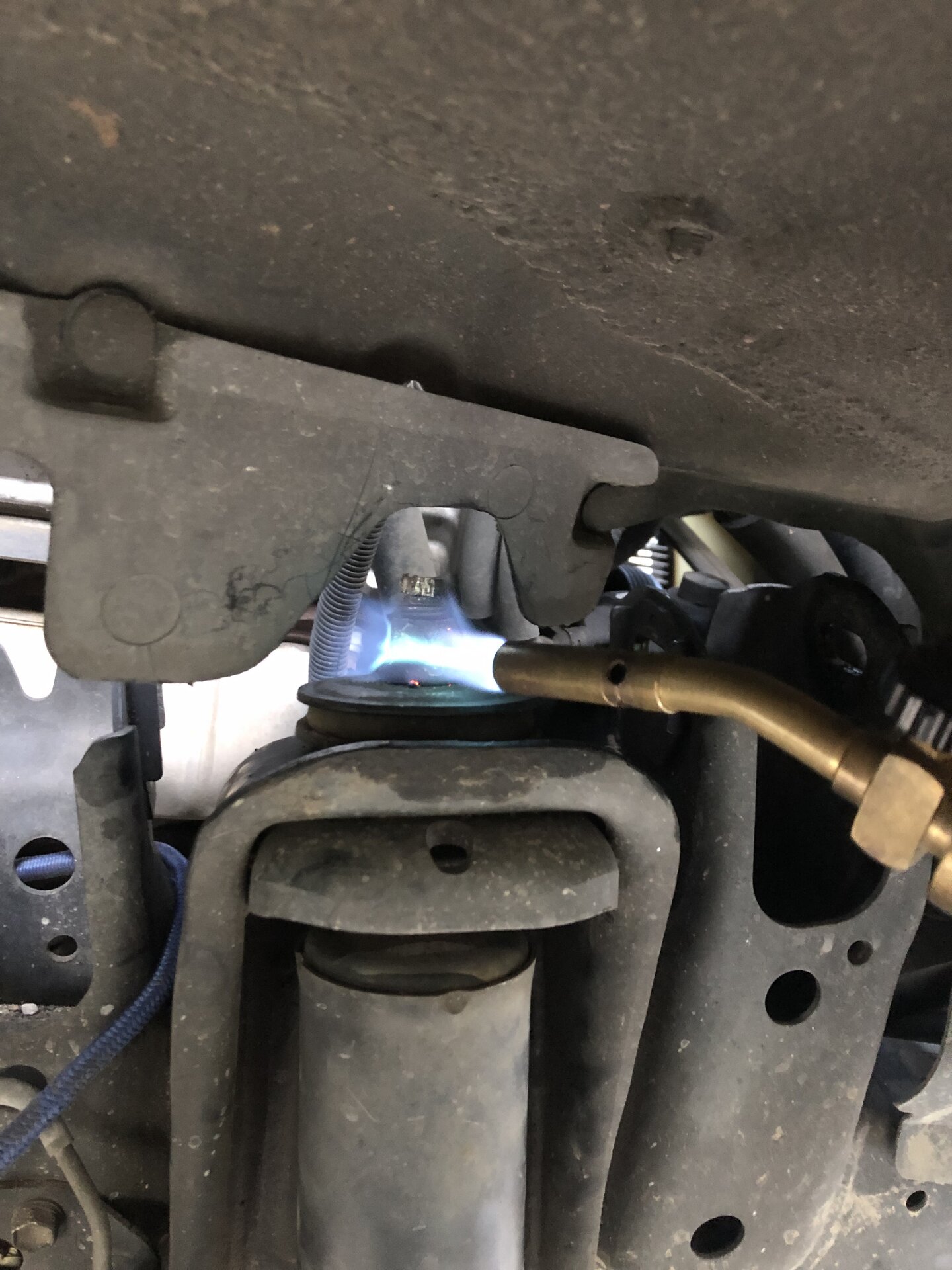

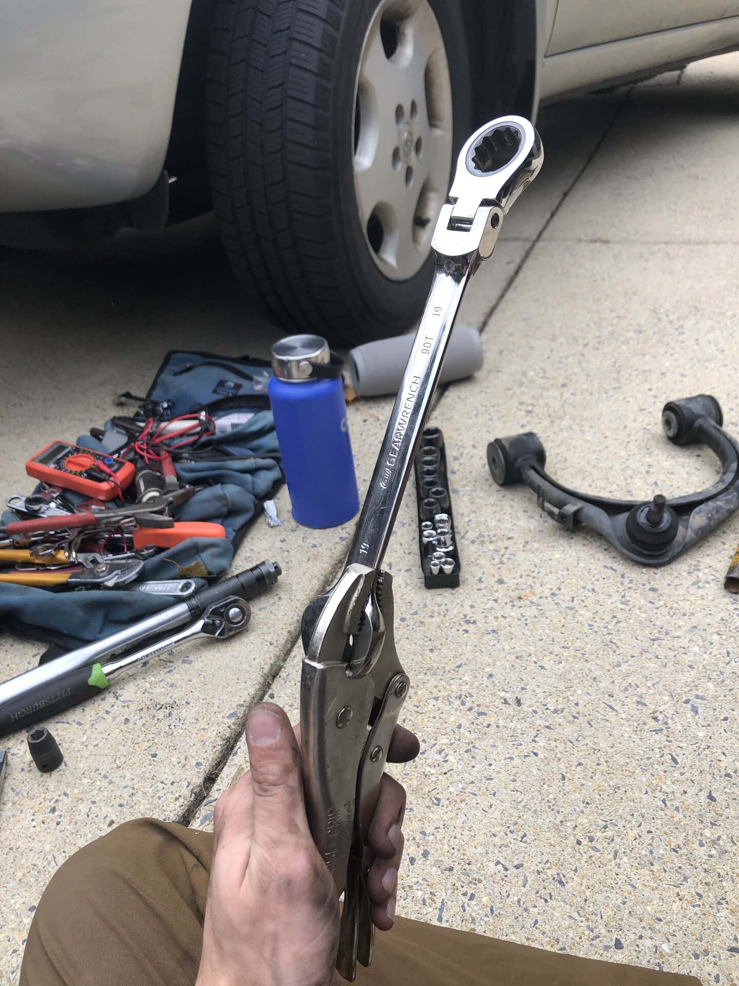

I figured it might be a little longer on this lovely rust-free truck before I had to break out the torch, but alas, those top shock nuts are a PITA. The "special tool" on the right below helped a lot on those as well.

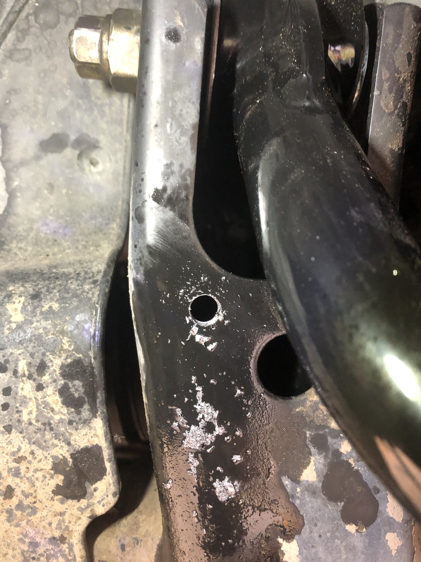

It felt pretty weird to drill holes in such a nice frame for the reservoir mounts.

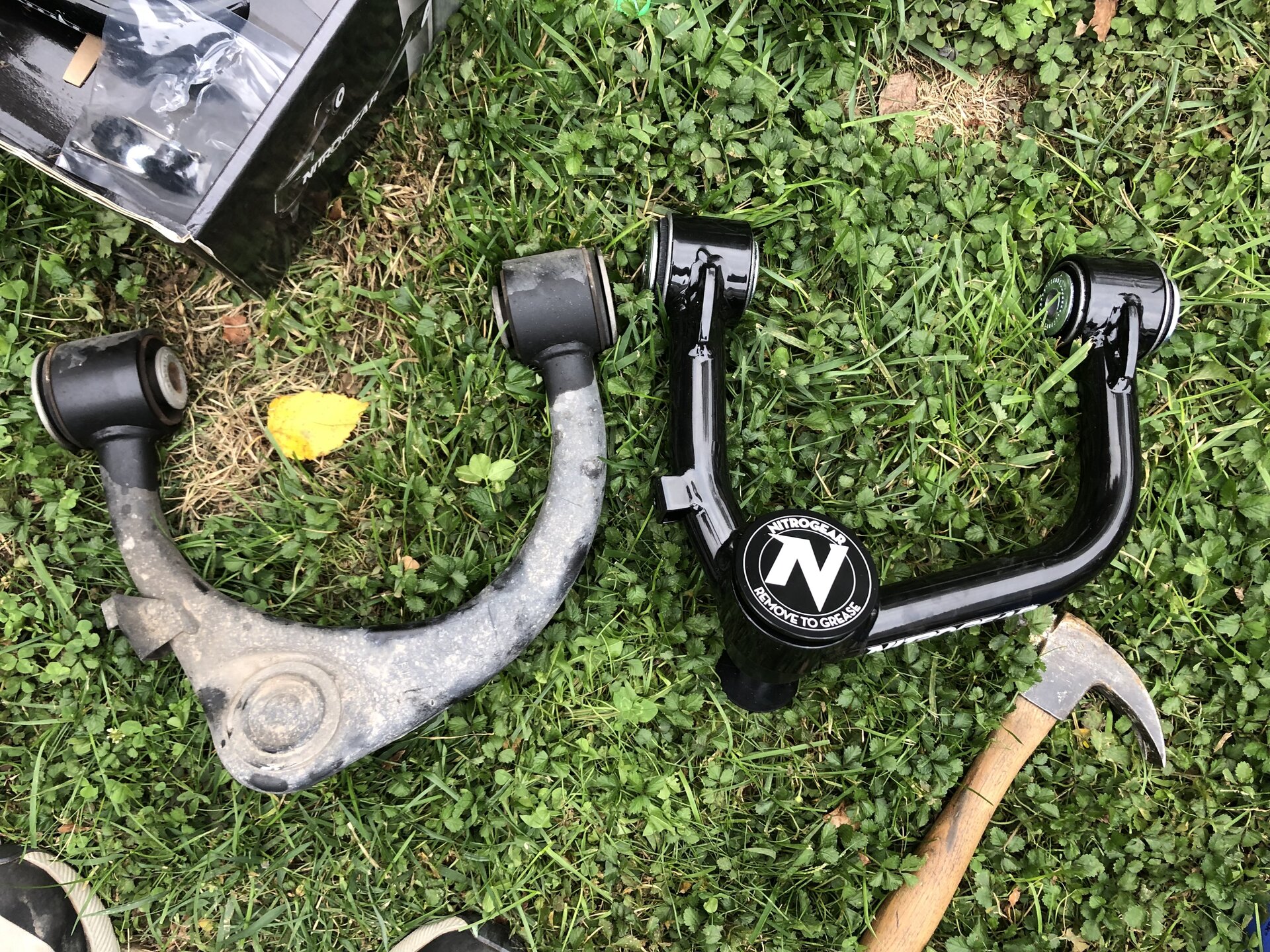

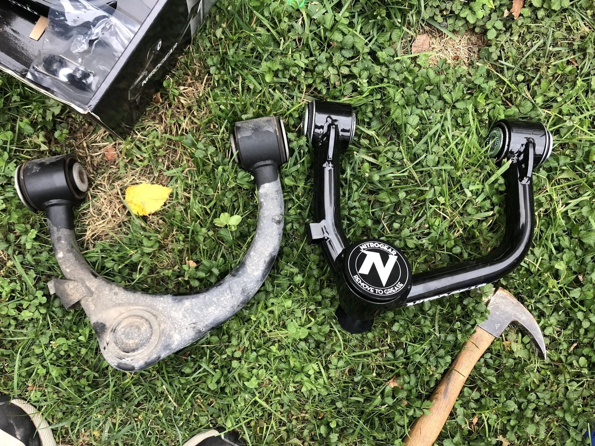

I also replaced the factory upper control arms with some Nitro ones while I was at it. These would allow me to get the most out of the longer-travel shocks, and get me nicer caster numbers once lifted. I actually bought these for the old truck and they just sat in the garage for over a year. Worked out well in the end. There was an immediate, noticeable difference in droop with the new shocks and UCAs installed. I forgot to measure but by eyeballing I'm guessing I gained at least an inch, maybe two.

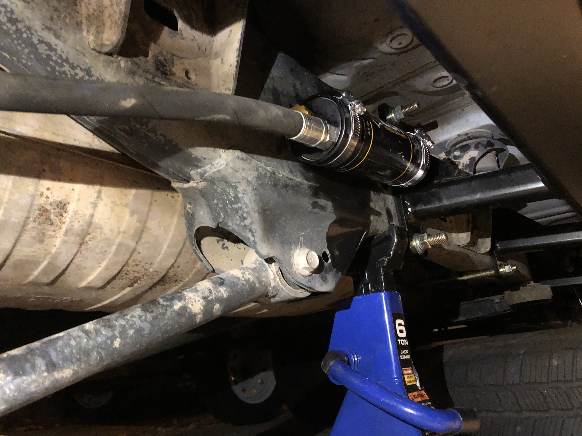

Rears also went fairly smoothly. I couldn't believe how much travel these shocks are capable of; I had the sway bar off and still had to lean my weight on the axle to get it drooped enough for the shocks to go on. I had to go dig a right-angle drill adapter out of storage to make the holes for the reservoir mounts back here.
View attachment 3483989 View attachment 3483990
View attachment 3484023 View attachment 3484049
View attachment 3484030 View attachment 3484029

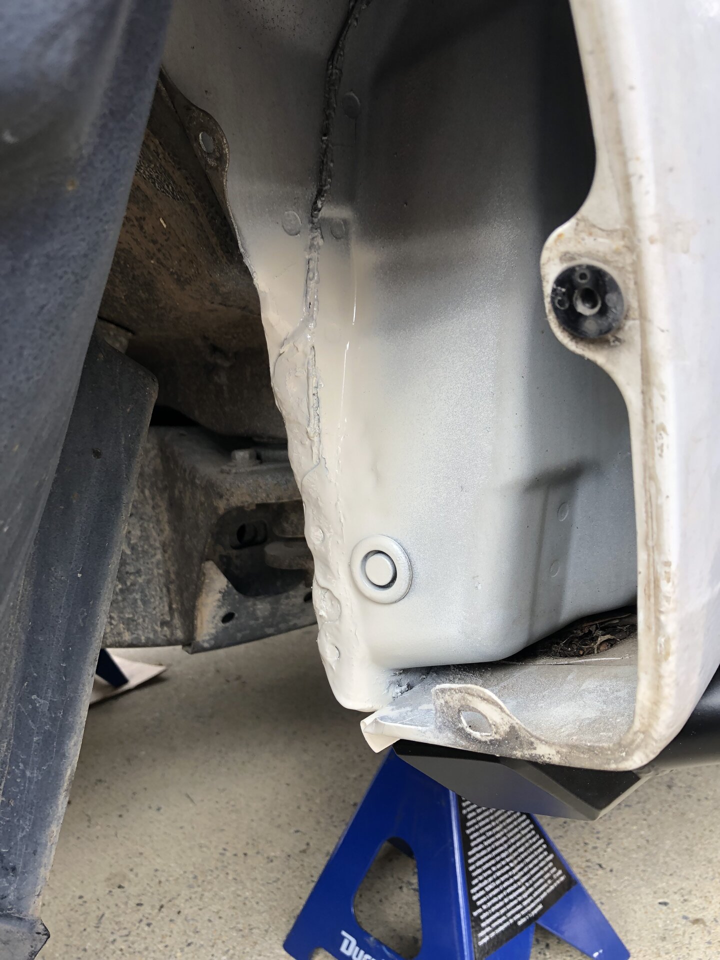

I'd already got my Spidertrax spacers swapped over from the old truck, and hammered/repainted the pinch welds while I was doing suspension.
