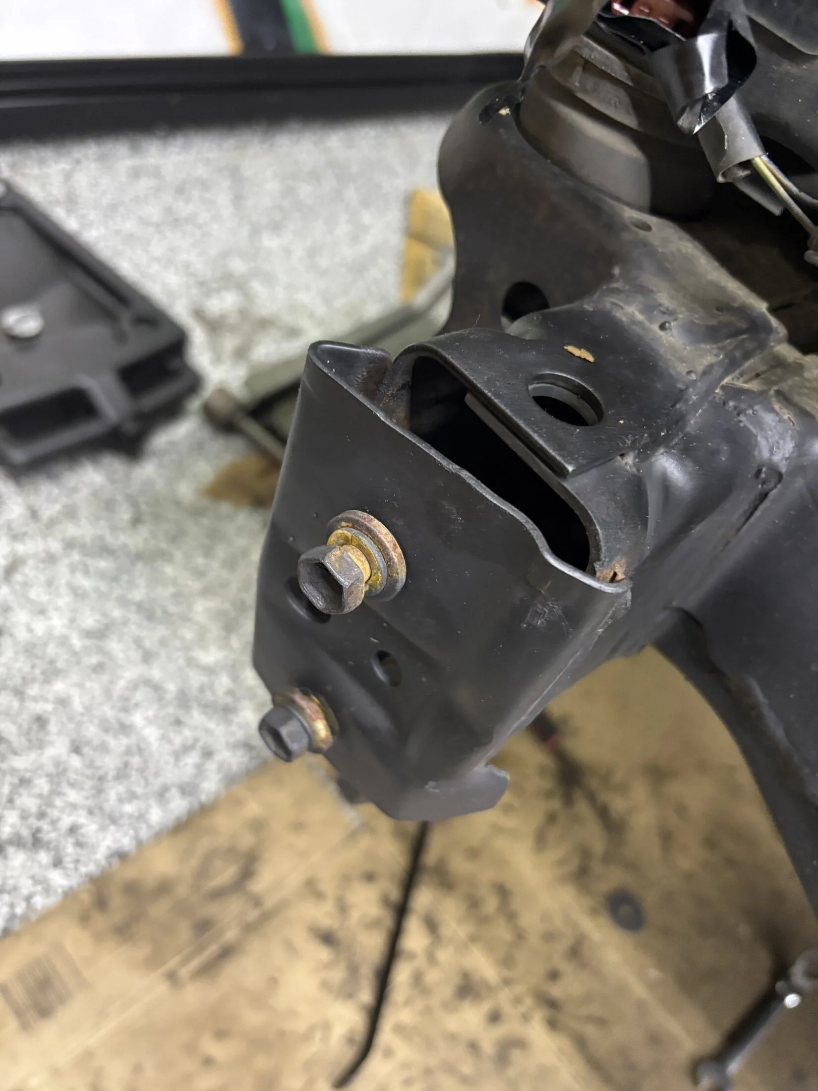

I ordered a welder for other stuff, can I buy these parts and weld them on or do I have to take it to a body alignment shop and have them tweak it back in place??
I also don't have a front bumper for them to line it up to, I kinda plan on getting a metal winch bumper. But also interested in going back to a stock bumper with a hidden winch .
What would you guys do? Can I work around this with an ARB front bumper? I think it mounts from the inside of the two protruding frame arms.
The frame is in good shape by the way, just these bolt "pads" that are fckd
I'm trying to remember, if I recall the ARB subframe may be able to work around those end bolts / mount since it uses a large packing bolt through the frames top hole ( If I remember correctly) I will try to find pics / how-to since it's been a while

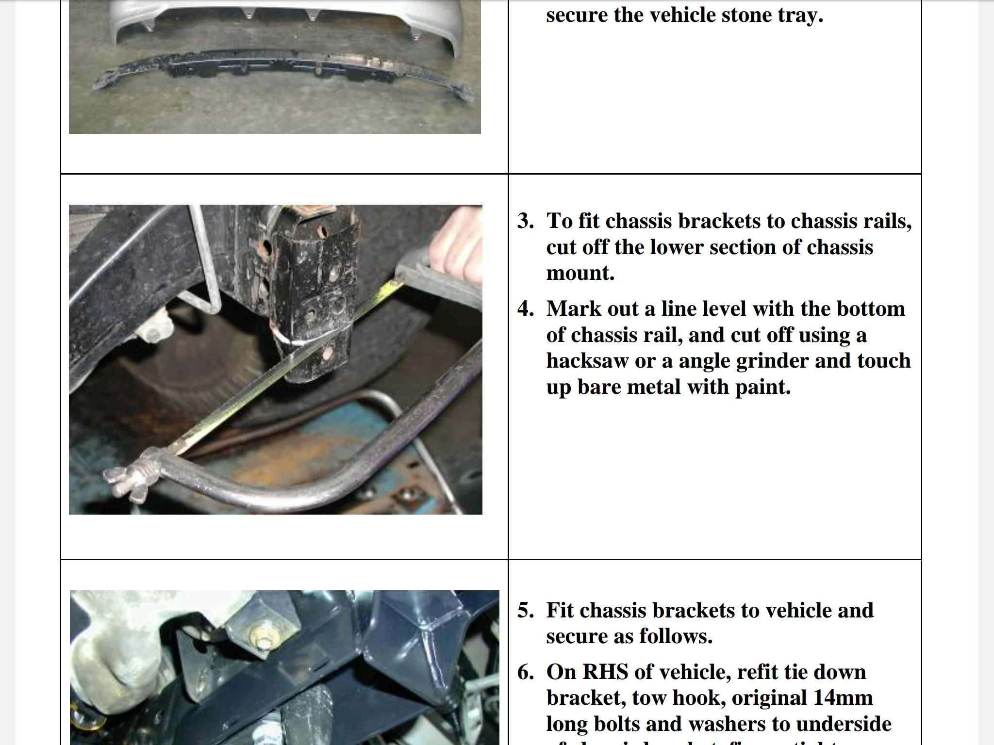

For an ARB bumper, and probably most after market bumpers, those pads have to be sawed off anyway.
You could dpwnload the installation instructions for any bumper you might be interested in to verify.
Im pretty sure thats not accurate, it depends on the model year ...I did not need to cut anything on my 2002 to install my arb.. . As noted above the arb bumper subframe slides over that.
OP, just call cruiser outfitters or ARB support
I have a TJM similar to the ARB and dont believe those are used in the mounting of the bumper. Since you have a welder you could probably cut those off, put them in a vice and get them back to reasonable shape and then reweld them back on.
1. If I remember correctly they are a little lop sided from the factory. Maybe not that much but some. I wouldn't change them at all until you have the bumper support brace to bolt on (if you decide to put a factory bumper back on)
2. @scubadoober said, looks like someone has been there already. Good eye.
3. I didn't have to cut those off when I mounted my Ironman bumper on my 2006. I would put an offer road bumper on.
You are right. I checked out the instructions and only the lower part that extends below the frame needs to be removed. Sorry for misleading the OP; It's been years since I mounted the thing.......
For sure and I also think that cutting bit only applies to certain newer model years . I didnt need to cut anything on my 2002
I did cut mine but I installed the 2003+ version arb on my 2002. Maybe the older version didn't require it the cutting? Different mounting system perhaps?
thread a very long bolt in there, and hammer it back to where its supposed to be , using the length of the bolt's leverage
