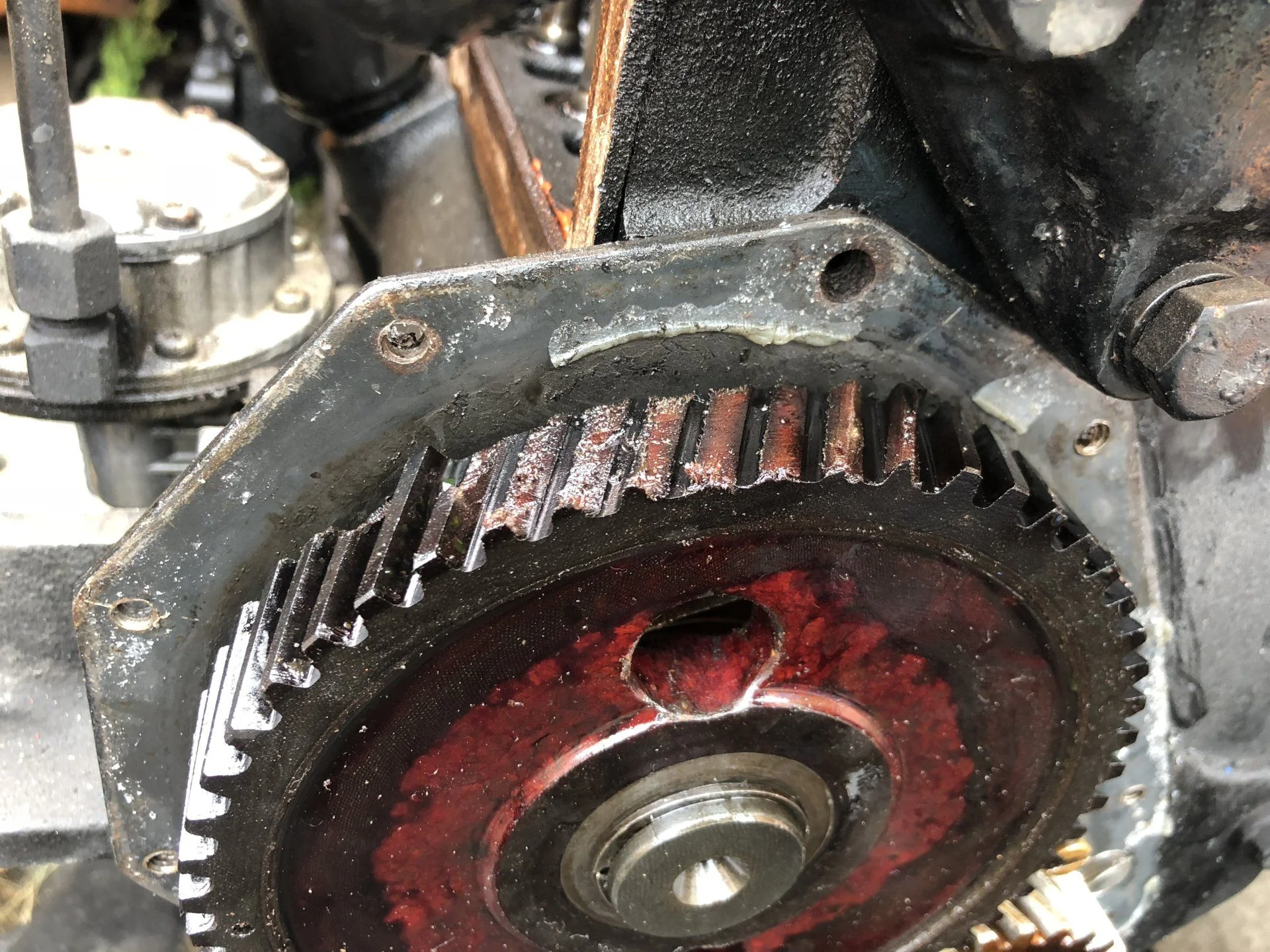

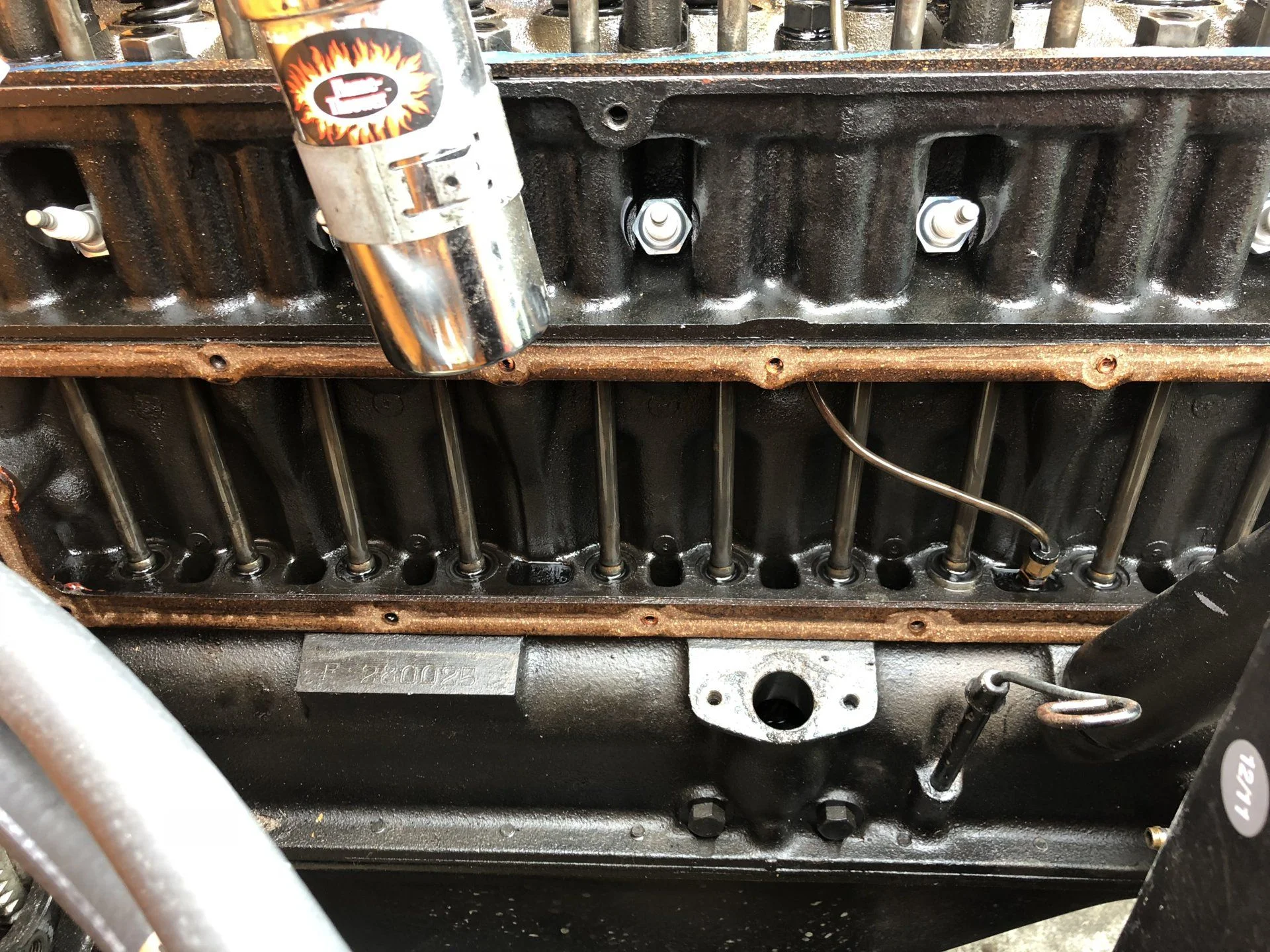

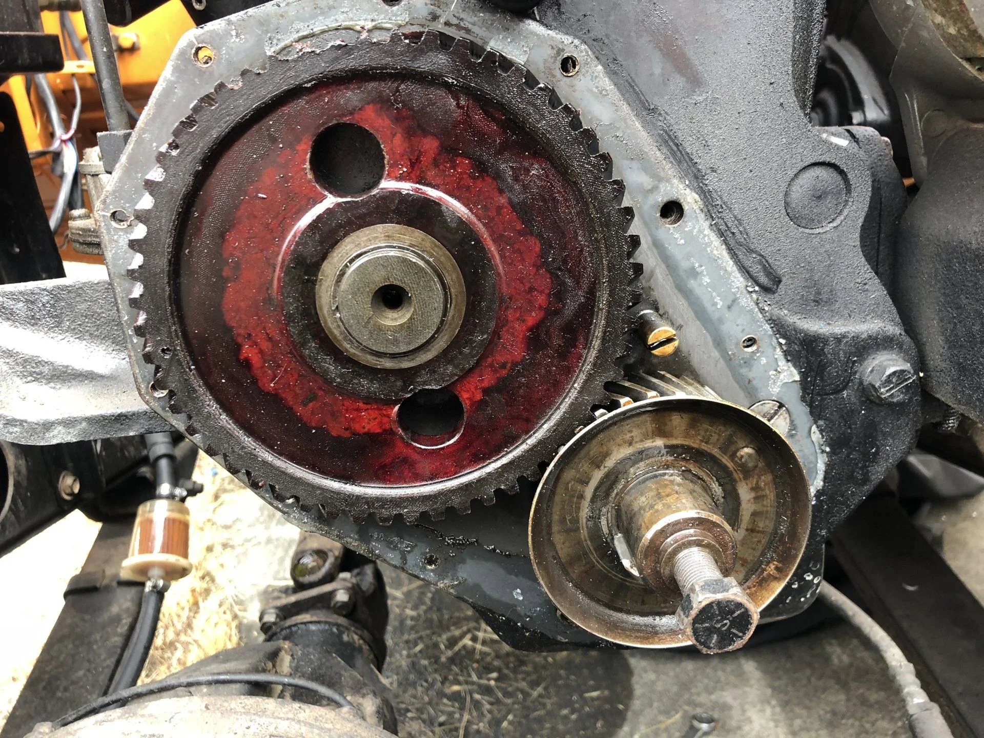

Howdy all. I was recently driving in my 1973 FJ40 On the freeway when I heard a knock. I promptly shut the motor off. Got it home started tearing stuff apart and got the timing gear cover off and noticed a broken timing gear. The crank gear easily was spinning against the bare spot on the timing gear. So I put a gear tool in to see if the cam would spin and it spins past the bare spot freely and once lined up with the crank spins together well. Was wondering if I can simply put a new timing gear on and re-time time it, or if there was something more serious that caused the timing gear to break. Like i stated both the cam and crank spin freely. Also i inspected all the push rods and they are all straight, and oil was relatively clean when i drained it.
Attached are some photos:
I would fit a new/used timing gear to it, and do a compression test. That should tell you something, especially if you ever took one in the past for comparison.
Yes, the motor had great compression and oil pressure

Unknown, however it was fiber glass and I’ve heard the oem ones were aluminum? Not sure if that’s correct though

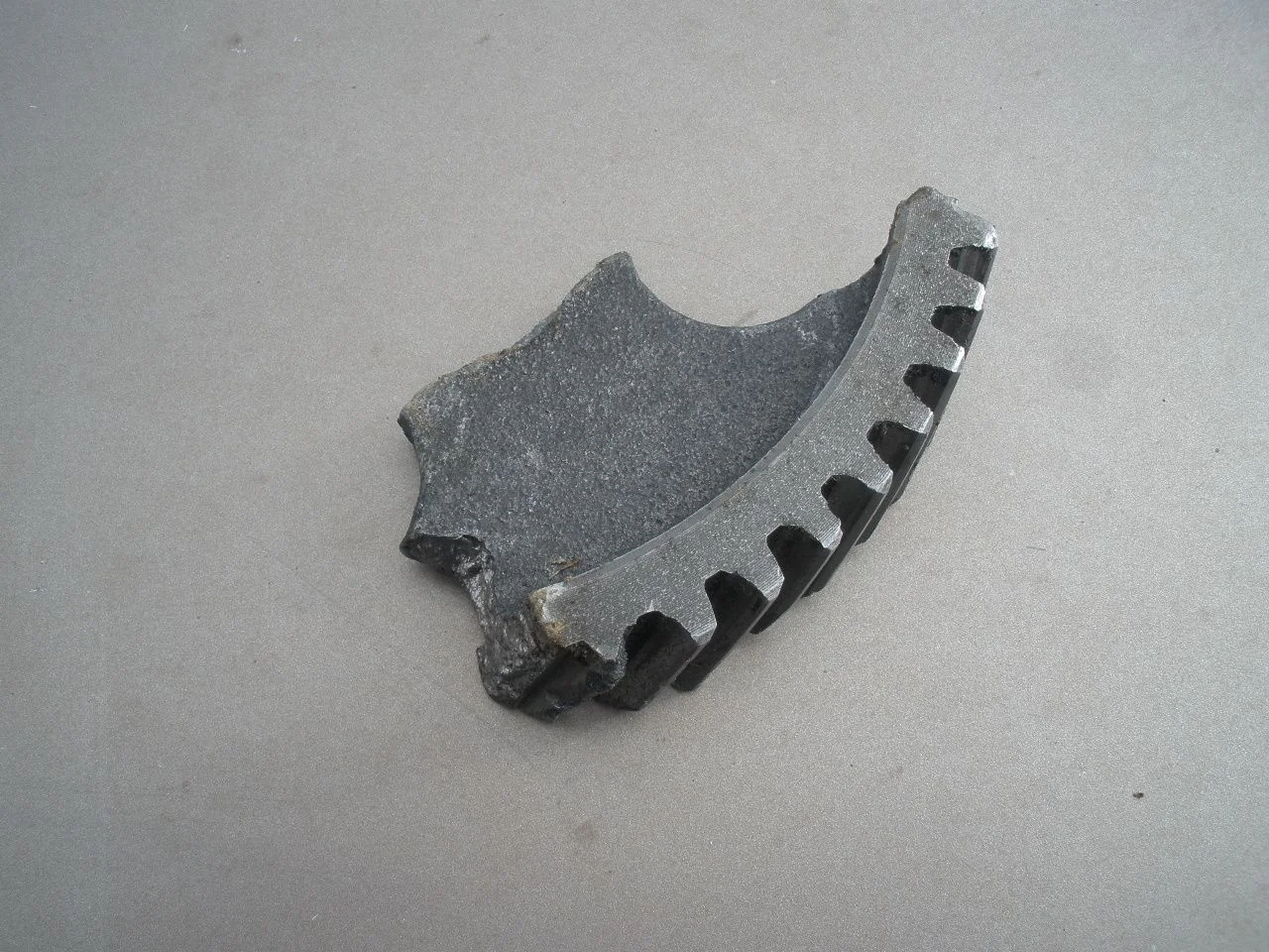

this is what happens with a foreign, non-OEM, gear
Those are different failures, no? The op’s is in the teeth, the last is in the web. Other posts about the web failures, but this teeth failure seems different.:meh:
Some F engines definitely had composite gears - I have seen them in junkyards (teeth stripped). I believe you can fit a later metal gear, and should do that.
I don't believe you can simply pull the old one off and put on the new on. Fairly certain you have to pull the cam to press on and press off the cam gear. That involves pulling the rocker assembly, push rods, dizzy and lifters. Not a lot more work from where you're at now.
That's how I did mine. However with the cam out I found excessive wear and a few lobes were out of spec. I sent it to Delta cams along with the lifters for resurfacing. I also had an RV grind done to it.
Yes the cams gotta come out. About to start that now haha, I’ll update what i find once it’s yanked. I’ll proably be replacing it with an oem Toyota Steel gear, just found oem part number. I’d assume i should replace the crank gear as well?
It's always a good idea to replace both at the same time, if possible.
1. The problem with spitting teeth at freeway speed is not knowing if one or more valves were left floating open when the pistons came up TDC, potentially impacting. I’d want to pull plugs and use a stethoscope camera to look-see if the top of any of the pistons look like carbon was disturbed.
