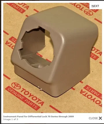

@cruiseroutfit Do you still have the grey OEM locker switch mount available for the 70 series? Will it fit the 73/74s? Since these only got cable lockers from the factory I'm not sure the switch mount would work?
@theferg bumping your thread again because I just saw somewhere else that you were planning to fit e-lockers into your 74. Any progress on this? I just bought a 74 and am trying to decide what to do... was mainly consider TJM vs. ARB, but would be interested to hear more about this e-locker swap you're planning/doing.
@fireball The 70-series also came with E-lockers on the post-1990 models when they introduced the front high-pinion. The POD (switch mount) shown in your post above is the correct POD for the 70-series and the dial-style locker switch will work perfectly (that's how they came from factory). The dash didn't change much on the 70-series until their later years and I am sure you can retrofit that POD to any 70-series model/year without much complication.
Thanks Alberto. I didn't know if there was also an interior re-design that happened b/w '89 and '90 that might affect fitment. The pre-1990 vehicles (like my truck) never got e-lockers so that why I was wondering if this would fit.
