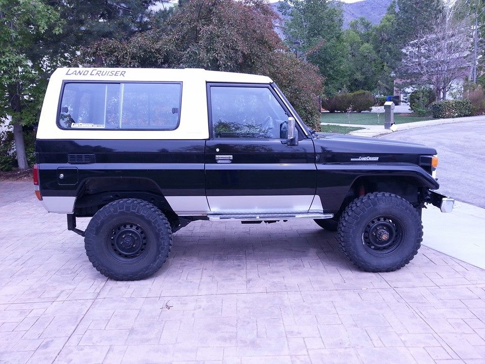

She had 205,000KM on the clock, and runs the original 13B-T with the auto. She also came already lifted with OME springs (plus add-a-leafs) and some ridiculously long shackles and the worn out shocks that were too short and barely hanging on. (All of this info was discussed up-front with Steve @ LCD prior to purchase so I had no surprises.)
I started molding her into my own right away by throwing on a set of 255/85-16 BFG muds on Tacoma/Tundra spare steelies.
Up next I got back in touch with my old buddy Kurt ( @cruiseroutfit ) @ www.CruiserOutfitters.com and got all the pieces to replace all the leaf spring hardware with OME greasable pins and shackles as well as the correct OME nitro charger shocks. This fixed the terrible shackle angles, as well as the rough, no-shocks up front ride. It was quite the difference once I was finished.

I then added some Spidertrax 1.5" wheel spacers on all 4 corners in order to space the wheels/tires out to the width of the body. The Tacoma/Tundra steelies run a ~5.5" backspacing on a 16x7" wheel so the spacers were pretty much mandatory. (FYI, the wheels actually won't clear the TREs in the front without at least a 1/4" wheel spacer.)

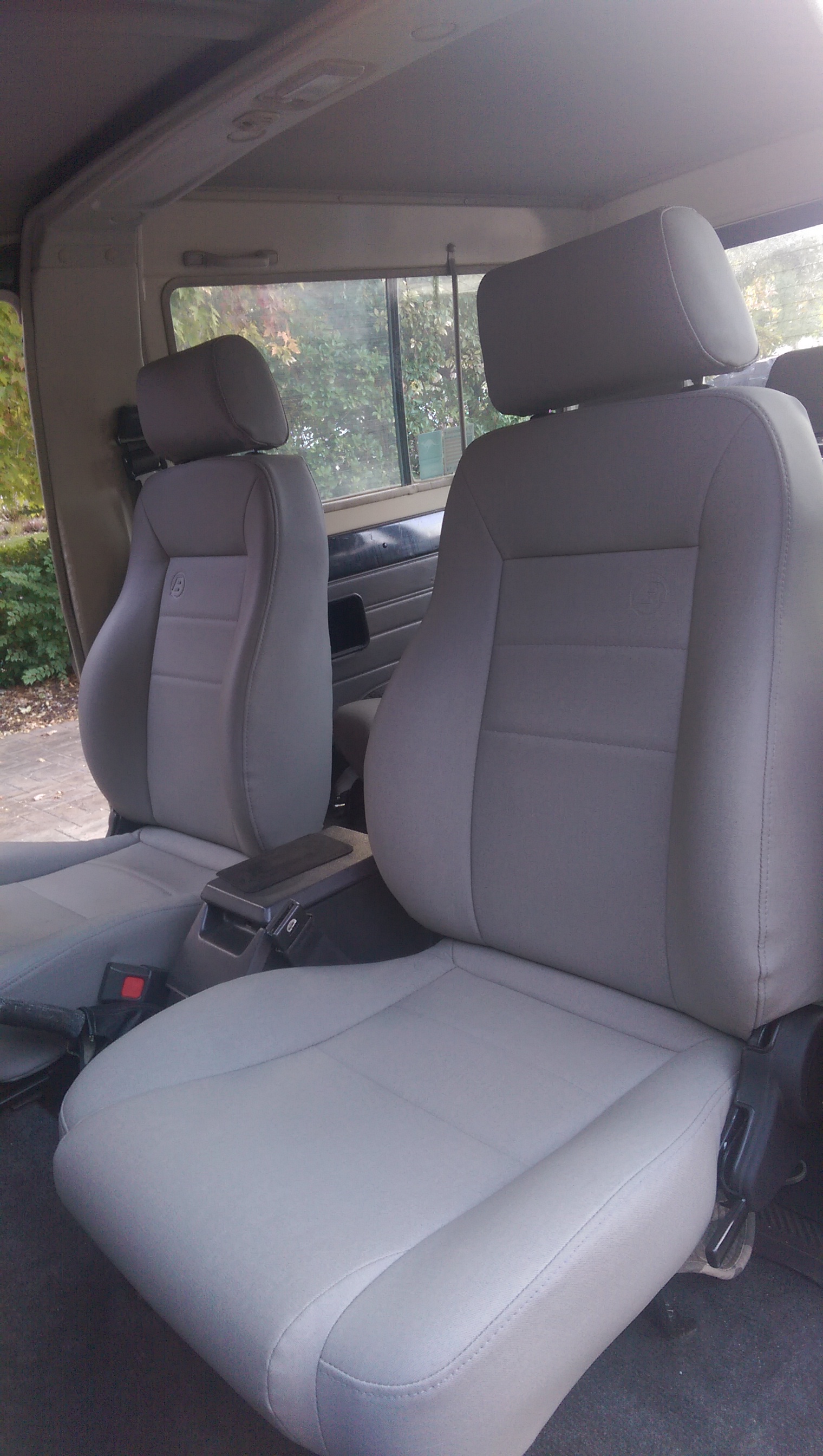

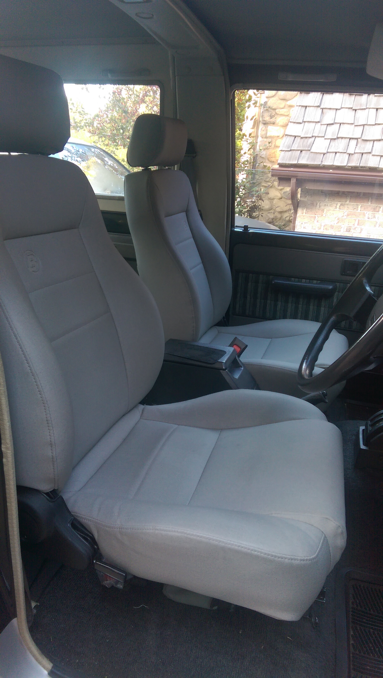

Back to the BJ74... she came with some ridiculous racing seats and no rear bench seat so I searched and searched for some replacements and found a few Mud and other Cruiser community folks that had some stuff, but nobody seemed to have a great, complete set available, and I also felt that getting any old pattern from any old other 70 just wasn't going to work for me given how cool the ones for these black ones are--and the fact that they should match the fabric on the door panels... I thought perhaps some straight gray ones from a new model 70 might work, but again, in the U.S., super hard to come by, especially as a set with the rear bench. So I ended up doing a little research into what J**ps are using and what guys are doing in 40s. I ended up taking a major leap (I knew they'd fit, but figured I'd have to do some crazy bracketry etc etc--especially in the back for the bench) and bought a set of matching Bestop TrailMax Pro II fronts and rear bench seat.
The front seats went in with barely any work at all on the existing seat brackets. I still need to get the driver's seat able to move back a bit further as I'm not completely comfortable with where it sits, but its def more room than the stock ones have.
After I got the fronts done, I started working on the rear bench. I set it in and it looked like the fit was going to be pretty good, albeit a bit shorter in width than I would really like (it fits completely inside the wheel wells), I then started looking at the mount brackets and trying to figure something up....while I was looking to fit them in, i noticed that the spacing on the mounting holes on the front brackets was nearly identical to the spacing on the factory nuts in the floor for the factory bench seat. Then I noticed that if I flipped those brackets from side to side (Right to the left, and left over to the right) they lined up nearly perfectly width-wise as well. All i need to do was lop a corner off of each to account for the wheel well, and then the front brackets and bench seat bolted right in. I couldn't believe it and I'm still super stoked on it. The rear latching mount for the bench seat was a different story and I have ended up making a custom bracket for it (sadly, I messed up and cut the striker piece too short and I haven't finished this piece.....Its on my list for "one day"....)
The seat part numbers I used are 39450-09 (RH front), 39451-09 (LH front), and 39435-09 (rear fold-n-tumble bench). They are "charcoal" (IMO, more like smoke--aka, light gray) and they are all vinyl. I'm really liking them so far, though I did have an issue with broken teeth on one of the reclining gears, but Bestop sent me out a replacement within a week after I filed the issue and provided pics and a video of the issue.

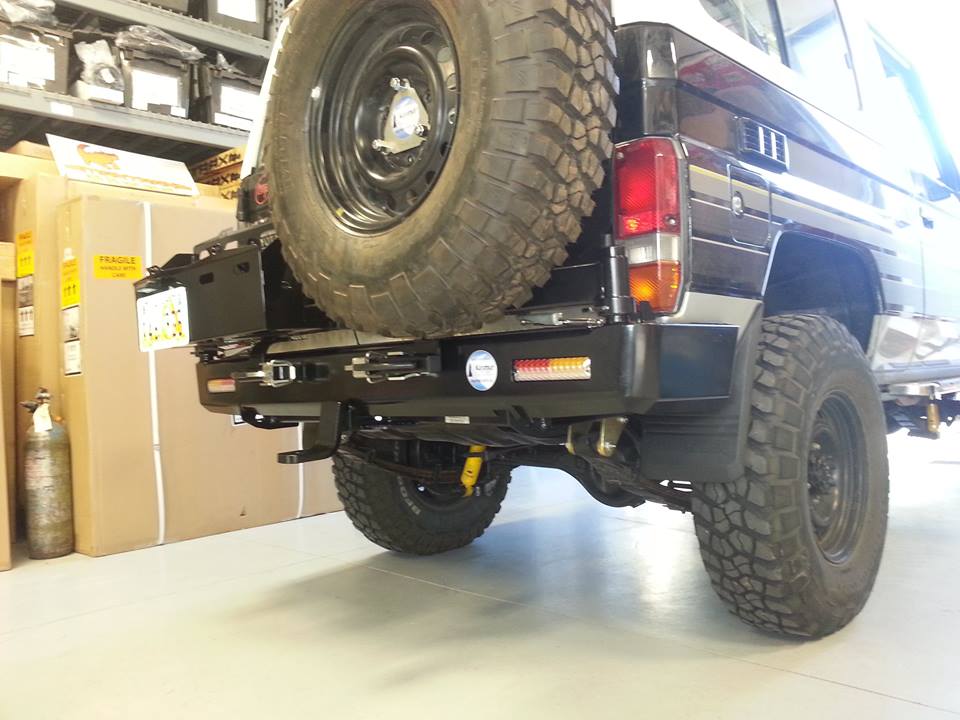

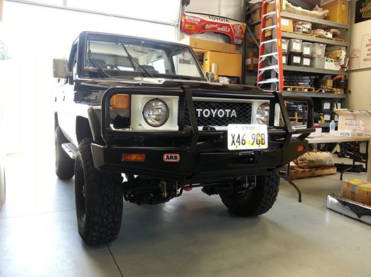

Once I was decently comfortable in the drivers seat, and she was handling well enough, I added front and rear bumpers and front winch. I plan to use this truck as my daily driver, as well as for mild to medium expedition type trails. Based on what was available at the time (earlier this year), I opted for an ARB front winch bumper with a 8000#, 24V electric winch from Come-Up, and a Kaymar rear bumper with tire and dual-can carrier swing-outs. All of which I again got through CruiserOutfitters.com (with the help of LandCruisersDirect.com and Outback Proven for the Kaymar rear). Got these all installed with the help of Kurt and Bryce at the shop as well as info from @cruiserdan as he had just finished installing a Kaymar rear on his BJ74. I absolutely love this setup.
I also added a set of OEM Toyota mud flaps on all four corners, though I had to remove the front ones as the 255s rubbed on them when turning. I plan to move the front axle forward an inch or so and will try fitting them up again and see if they still rub.

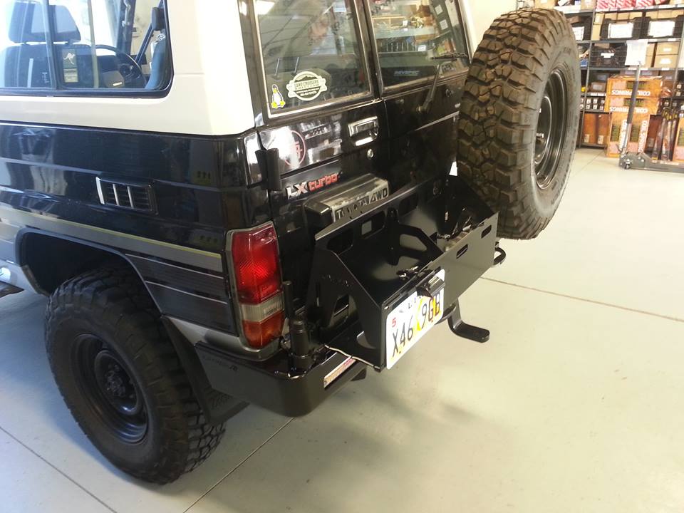

I really started driving her on a daily basis at this point. She was running really great, but after the Kaymar rear went on, I noticed the left rear corner was getting some nasty diesel soot building up on it. I peeked under and remembered I needed to do something about the tailpipe dumping out 2 inches in front of a cross-brace on the Kaymar rear. I tried to come up with a few different solutions on cutting it back or turning it down or adding a turn-down tiip, but nothing seemed like that great of an option. Then whilst I was debating that dilemma, I had to take a trip up to Park City via Parleys Canyon--its a steep pass that gains elevation super quick. I ended up getting super duper near the overheat line on the stock gauge. Like scary close. Luckily I was able to crank the heater and roll down the windows and take the pull at grandpa speed and I was able to make it. After that, my exhaust dilemma was decided: new larger exhaust all the way through. After searching around on here a bit and talking with a local trusted exhaust shop, I went with 2.5" starting all the way at the turbo turn-down pipe. I had to take the same canyon a week later again and it pulled it much, much easier and didn't get close to over-heating.

Nice rig, congratulations! Do those front seats allow a seat belt buckle to be bolted to the side of the seats? I'm trying to free up the floor in between the seats
Thanks all!

Very much liking the rear bumper with dual can carrier. Seems like perfect addition. Looks stout too.
I'm not sure. I kept the original belts in place. I'll take a peek around them and see if it looks like it can be done.
Did you bolt the license plate directly to the can carrier basket?
I did. I had to drill new holes for the US plate (as you may have guessed). I put the bolt heads on the can side, and the nuts on the plate side. Seems to work just fine.
Did you mount your plate some other way?
