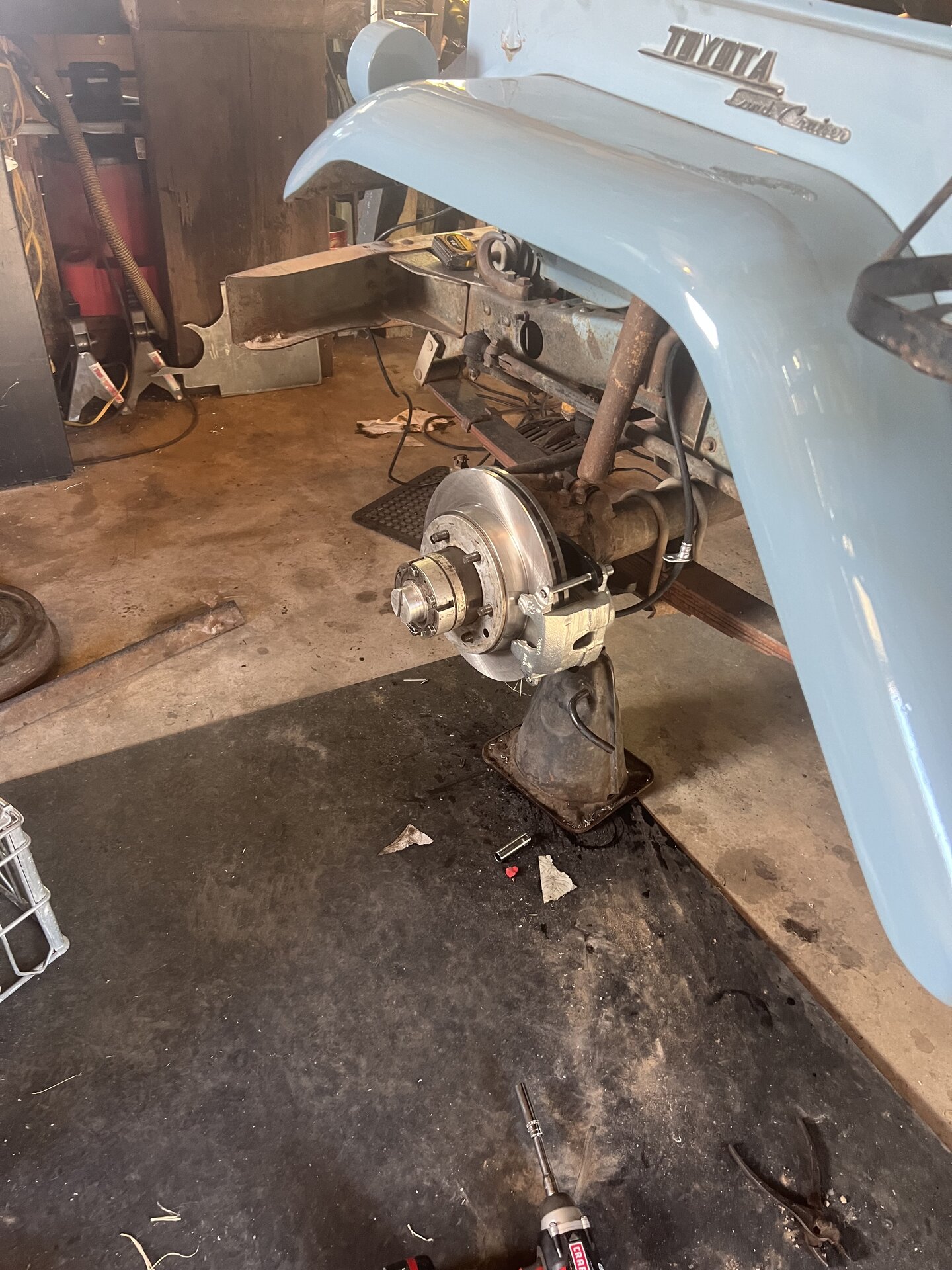

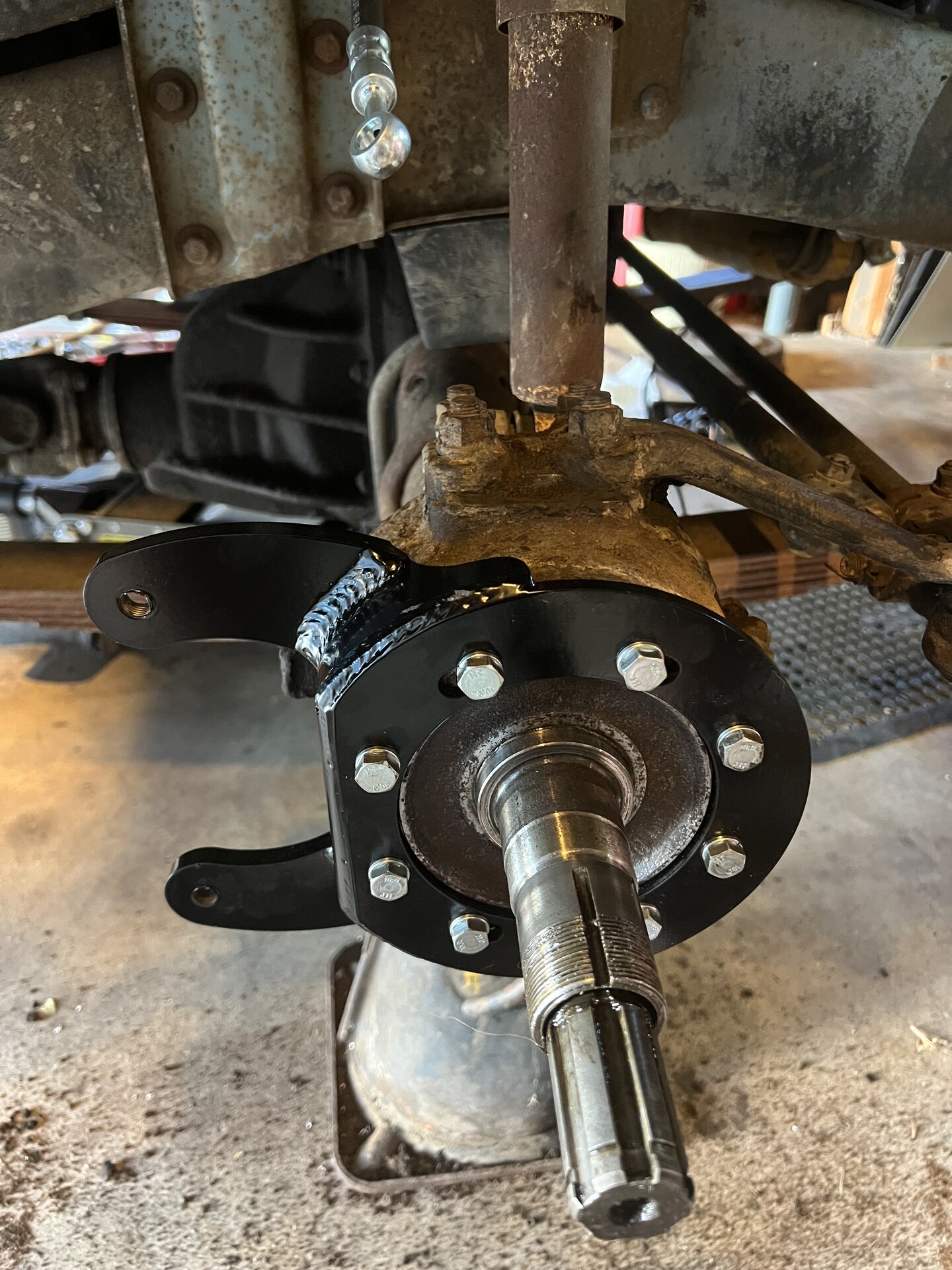

So far we have done the fronts and I ran hard lines. Going to tackle the rest this weekend.
It’s been pretty simple so far! We had to get some flexible hoses that were longer than the ones provided but the website clearly states that pre 1970 will require some flexibility so no big deal!

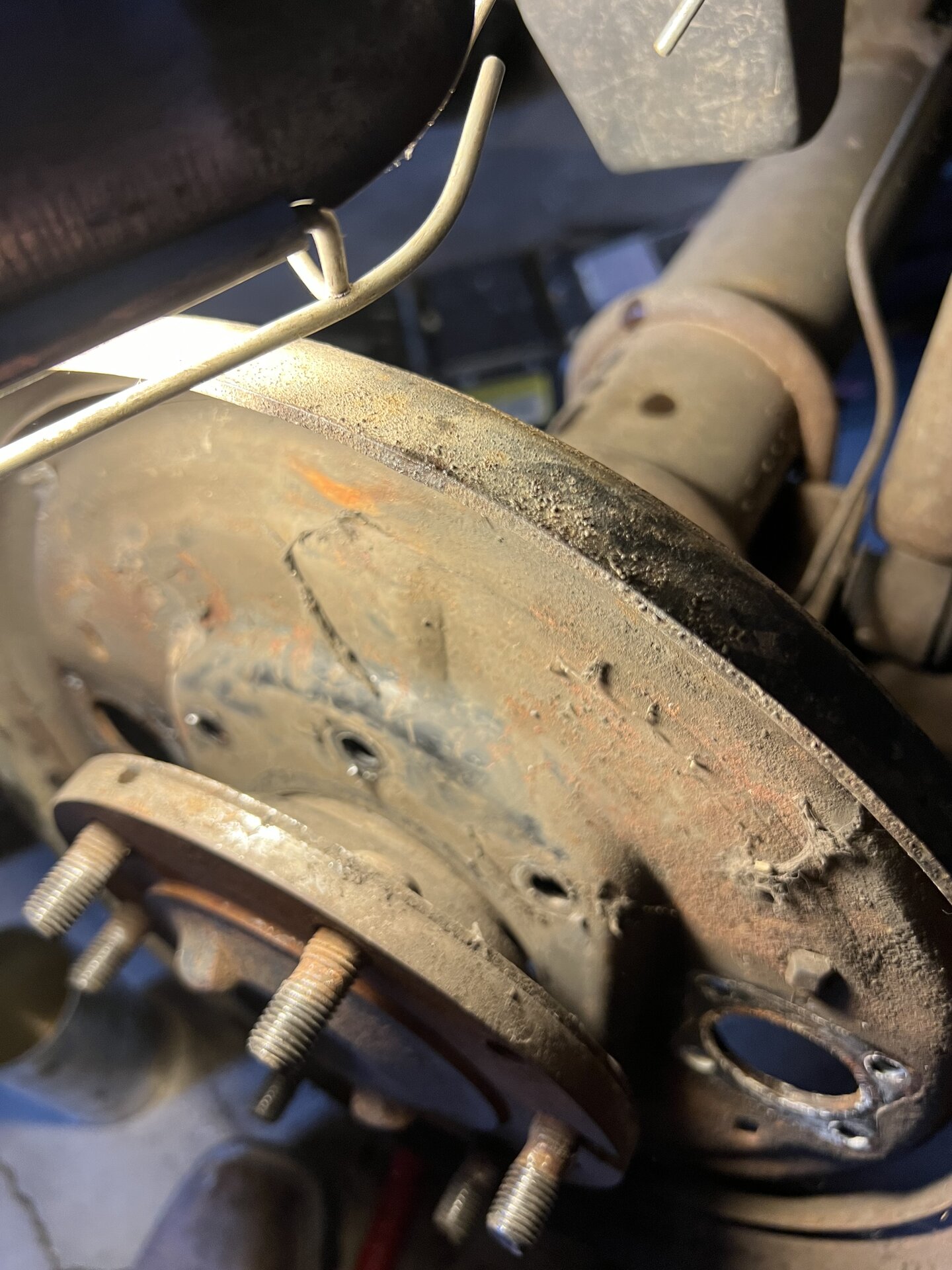

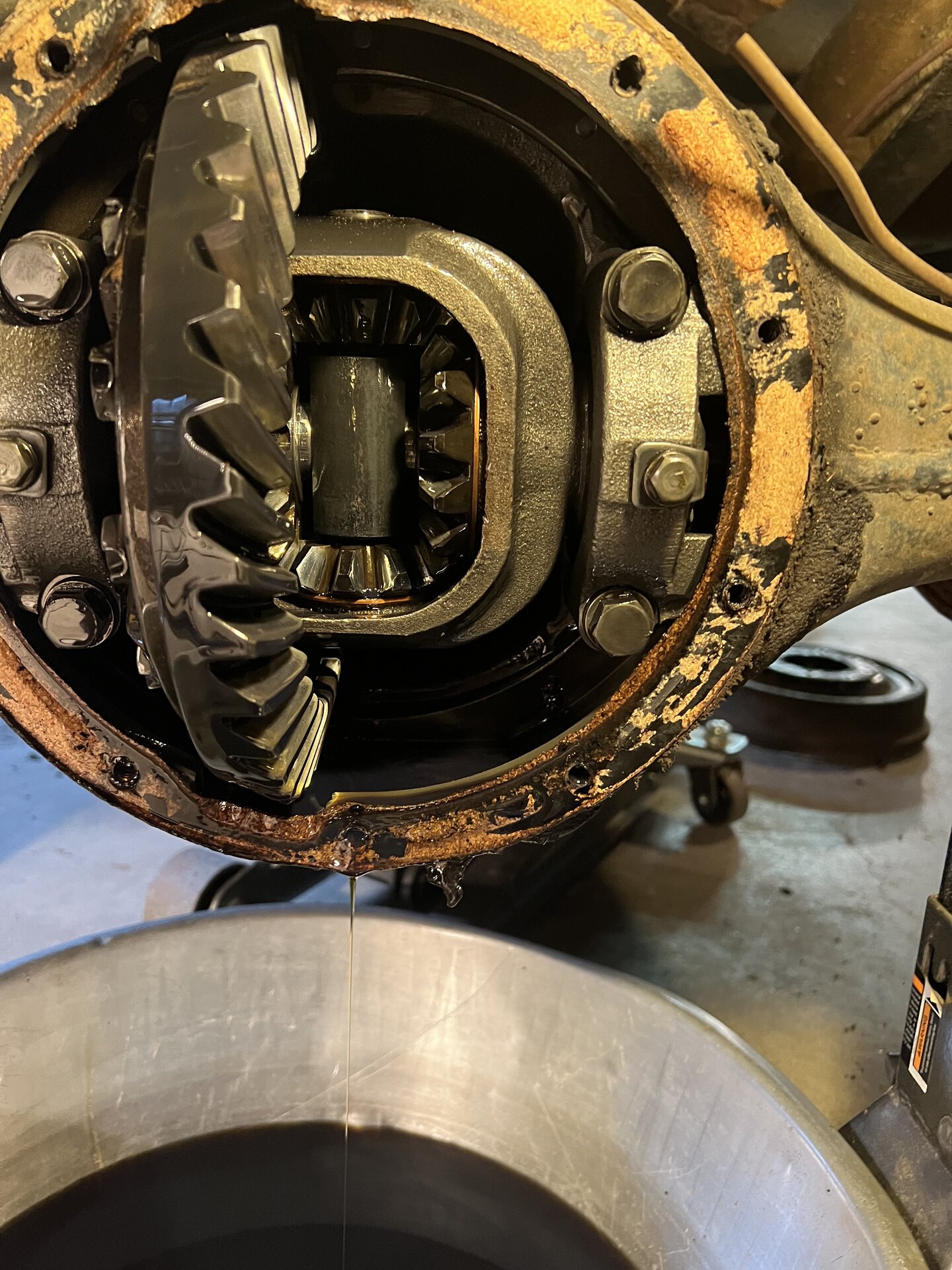

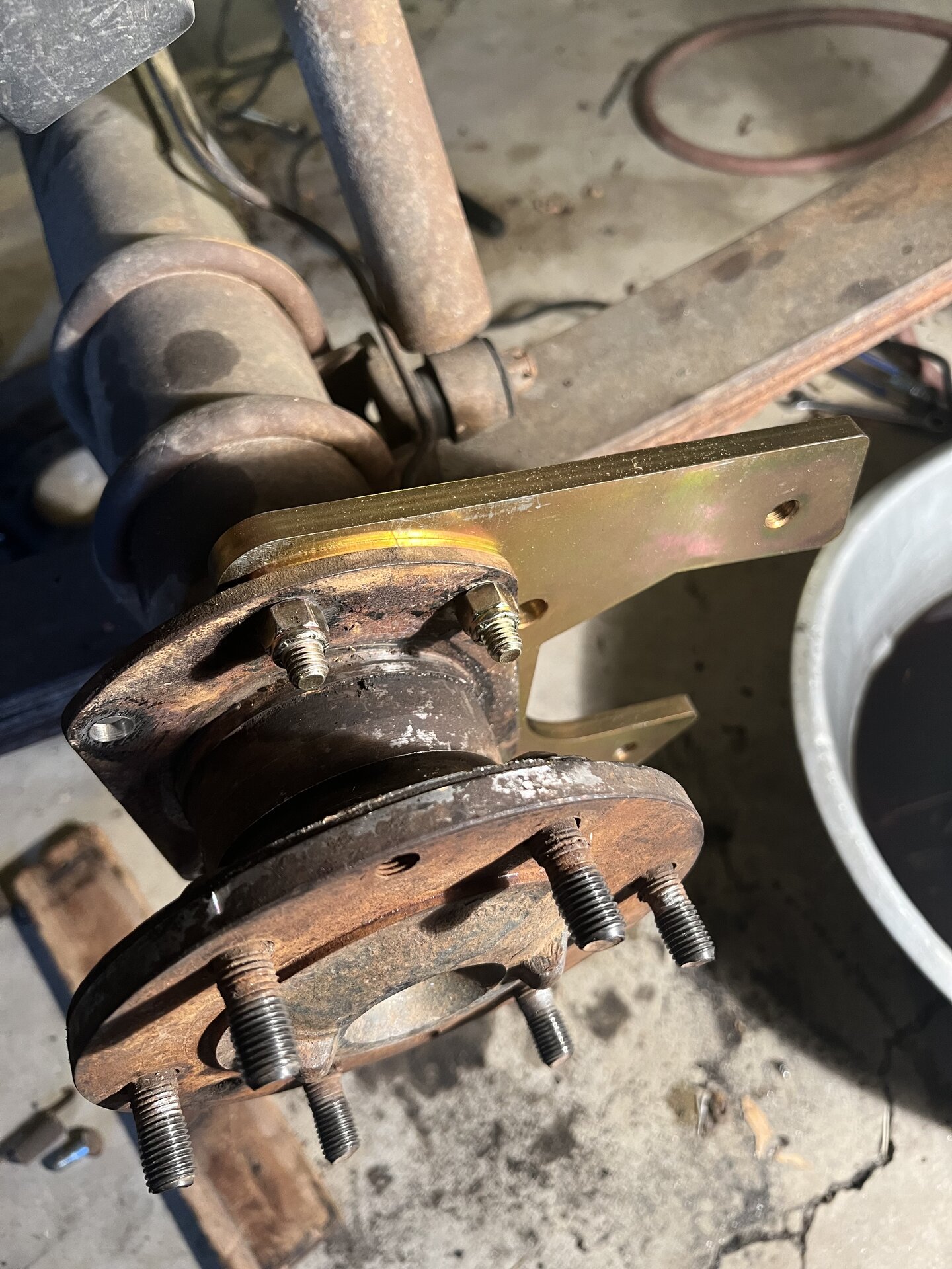

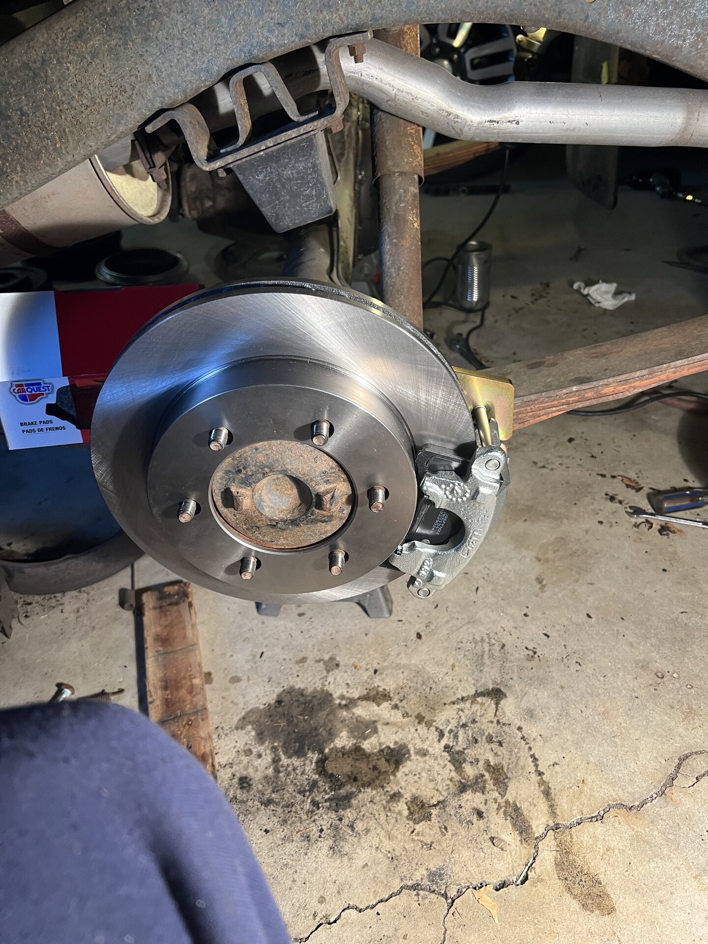

did the backs this weekend. Tried cutting the backing plates but didn’t have enough space. Pulling the axles was pretty simple with 2 people.
