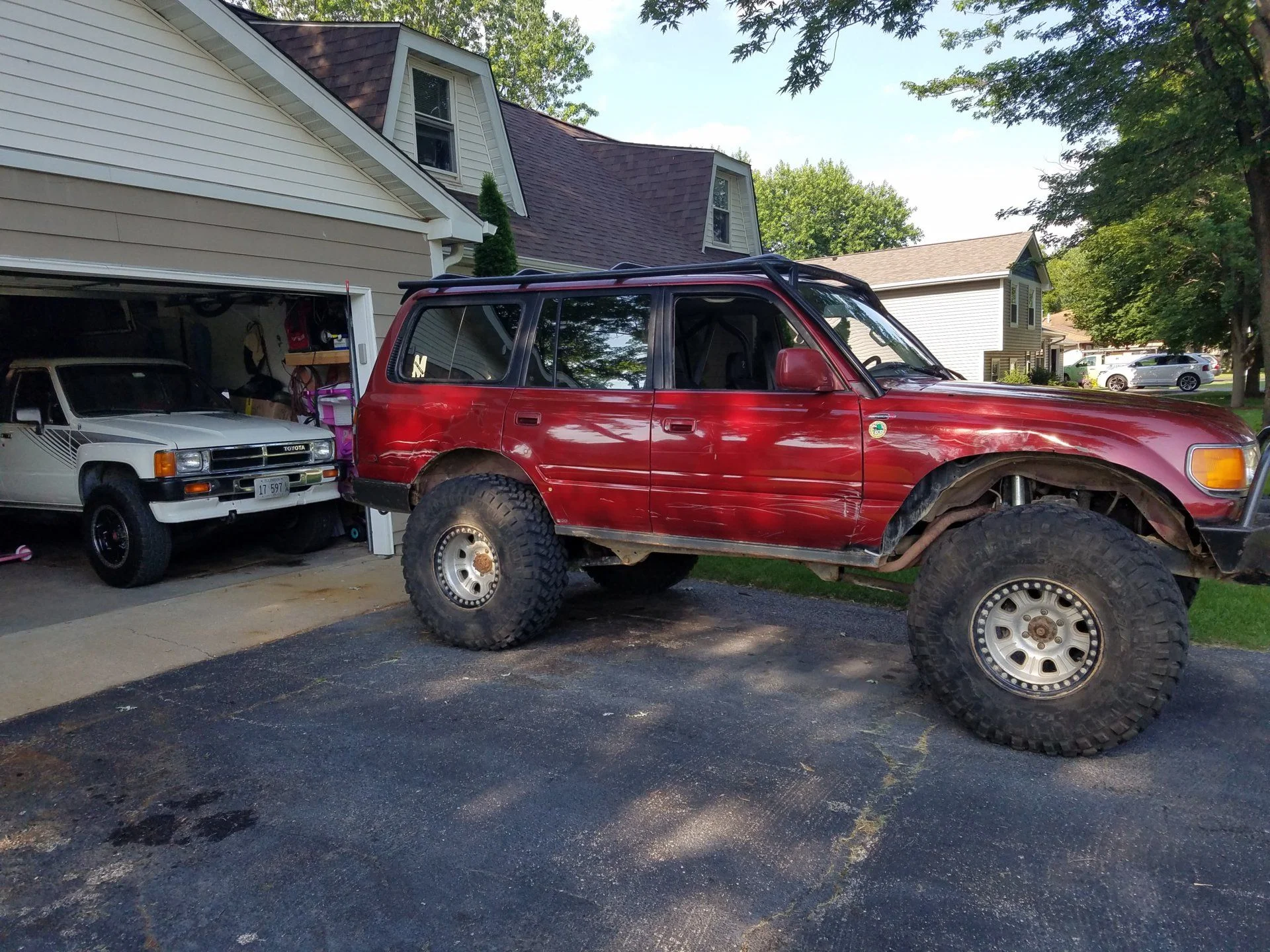

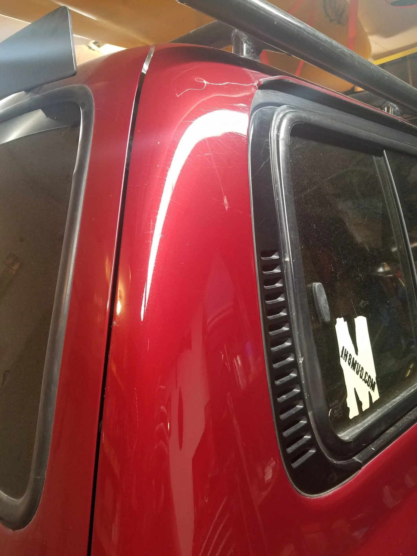

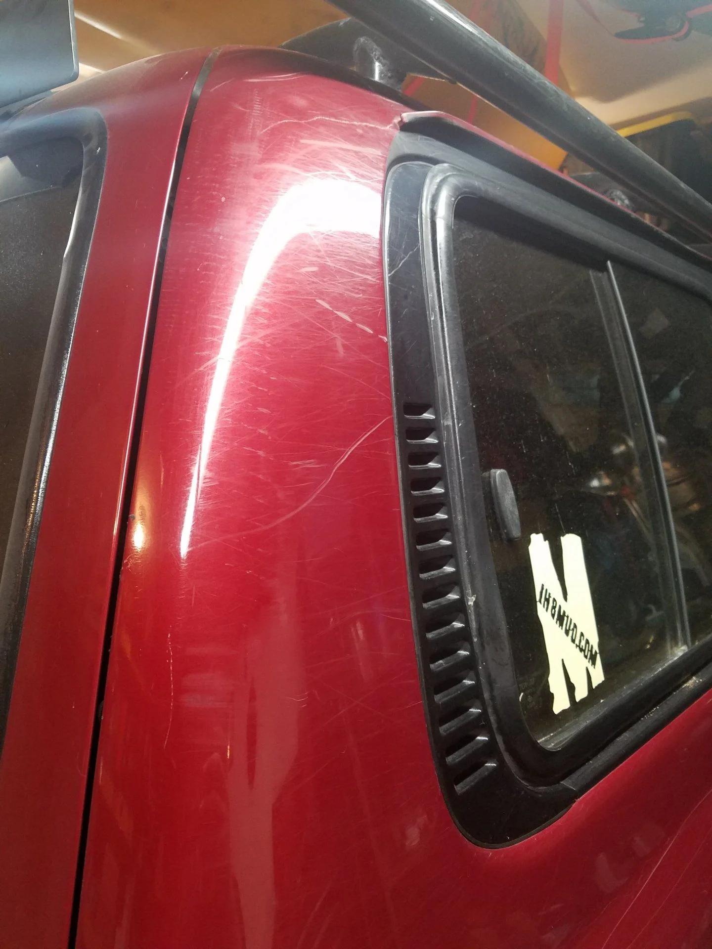

Haven't updated this in a spell. Obviously I did not make it into UA, so I decided to spruce the old girl up with some fresh doors, hatch, and tailgate. But, since I was putting in scratched paint, I felt I had to clean up what was existing.
The whole 80 got it all. It got compounded twice, polished, and waxed before our trip in June. Actually looked really good, but I now realize just how poorly the burgundy photographs. No matter what the pictures just make it look bland. But, I have all functioning and sealing doors again, and more importantly for my next project, a strait tailgate.

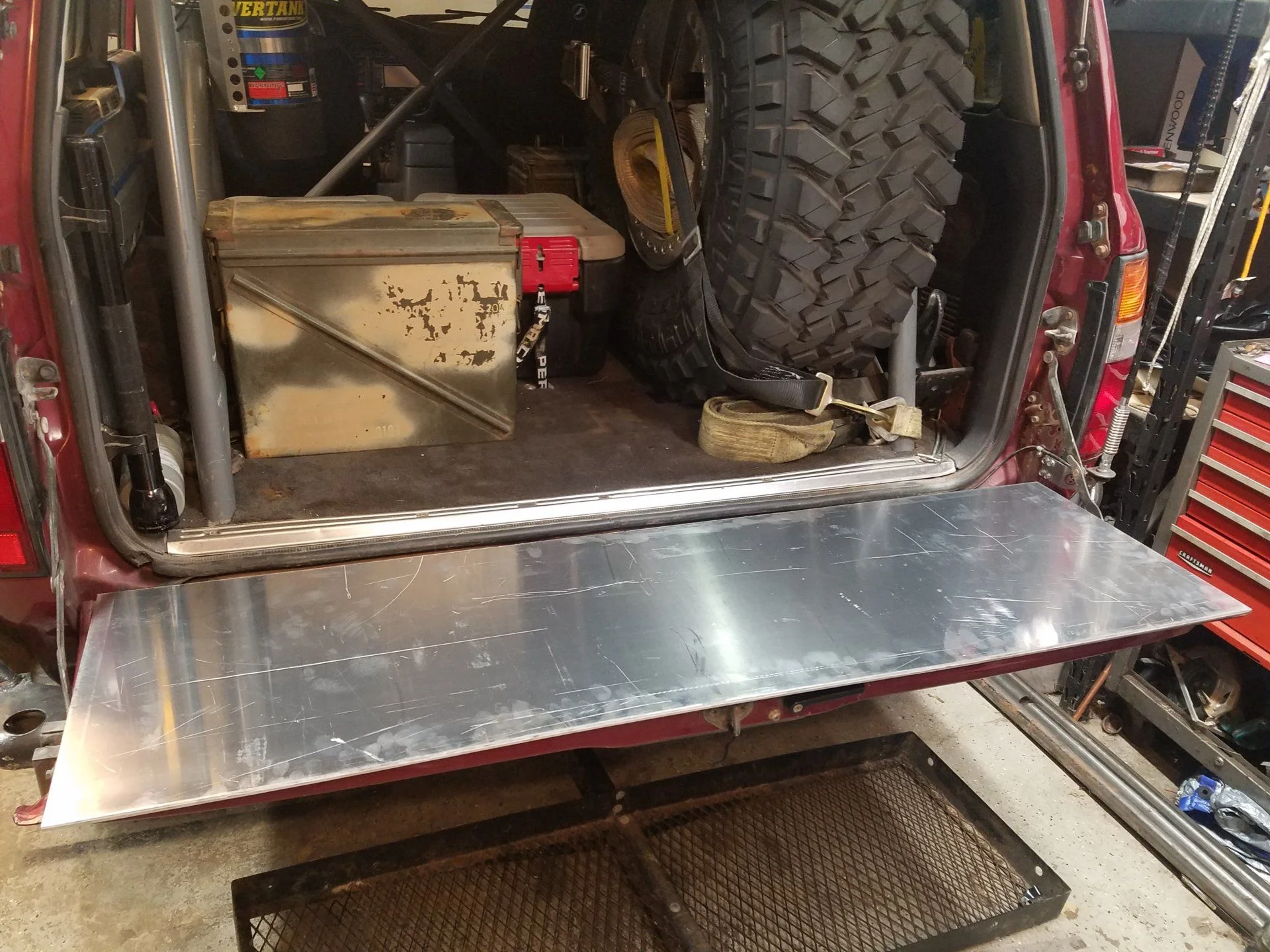

Which brings us to this weekends project. Couldn't stomach the cost of a tailgate storage panel, so I picked up a sheet of 1/4" aluminum and decided to give my own design a whirl. Still haven't solidified what I want to do for hinges, or even if I do one big door or two smaller doors, or if I am going to use stainless marine hinges that mount on top, or do a piano hinge on the back side to give it a nice flat look.
I plan on doing what I normally do, and that is just start cutting and see what I end up with.
One big door, continuous hinge, and so far I have riveted it all together. Need to drill the holes for the slam latches, lay carpeting, and add some reinforcements to the opening.
