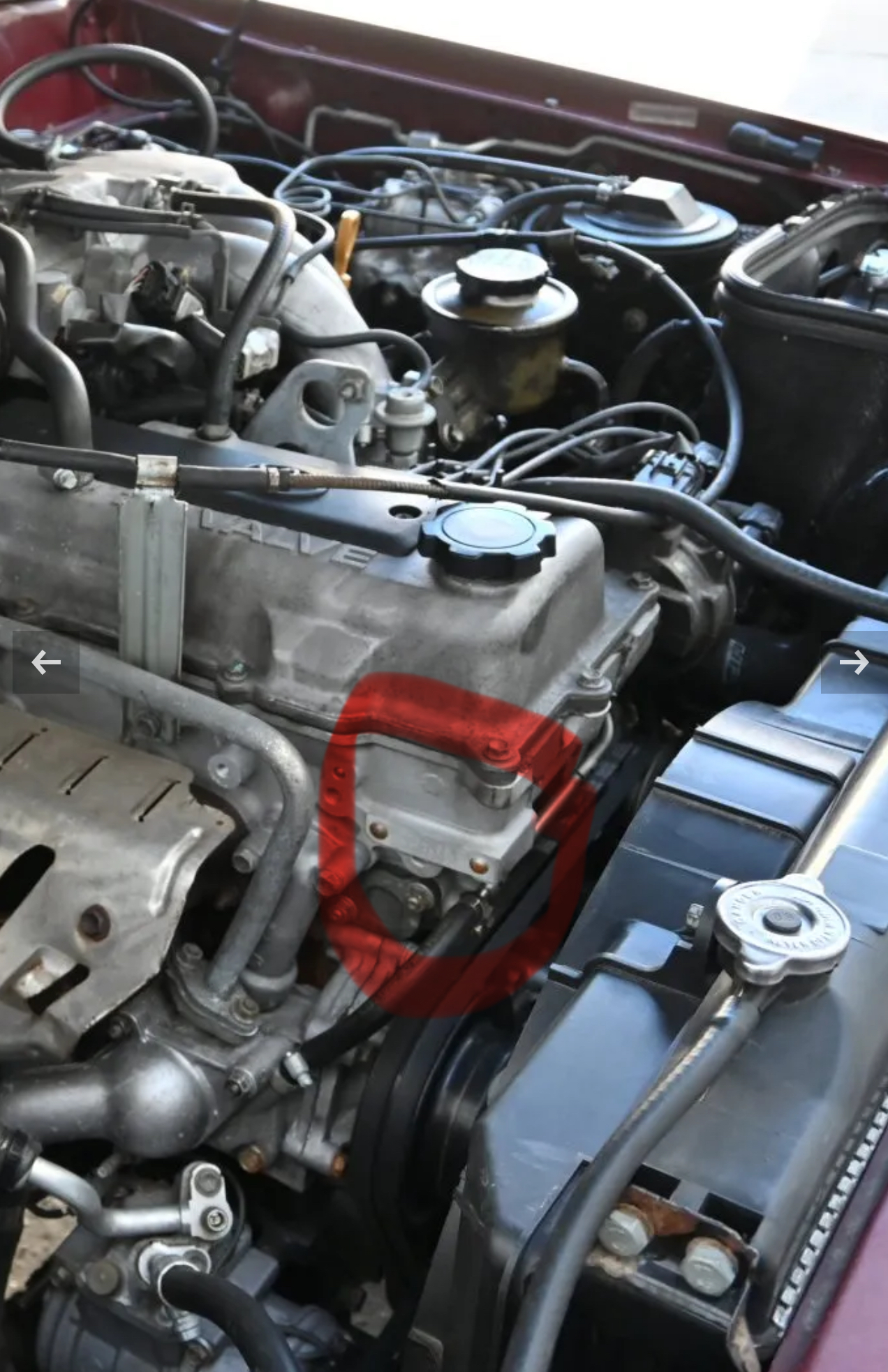

What years did they start putting the vin on the cylinder head? I see more pics of engine bays without the vin than with the vin.
Both my 95 and 96 are on the head, you can drill it off pretty easy, don’t remeber if my 94 has it or not as that truck is not at my house. Usually if the truck has been sprayed again on the inside you won’t have the door vins anymore,

My ‘97 has the vin here on the engine, not sure if they did that on ‘96 as well. Also there are usually 2 holes on the firewall in front of the driver, those are missing.
I can confirm I have this VIN plate on my 96', but rather then a flat silver, it's got Toyota printed in black on the background. I would have to check the 95' but assume I'll find the same.

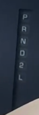

Driving my LX450 today, and I noticed my lit D light...very bright.....very noticeable.
I swapped it out recently, but the original D light was still working when I pulled it at 179K miles.
I believe many high mile FJ80/LX450s have their D light burned out. It is pretty much a meme at this point.
I noticed in the driving video that the seller posted, the D light also appears to be not lit. OP can confirm that.
Below is a capture of dash from the driving video of the seller.
Makes you think...
Makes you think...
