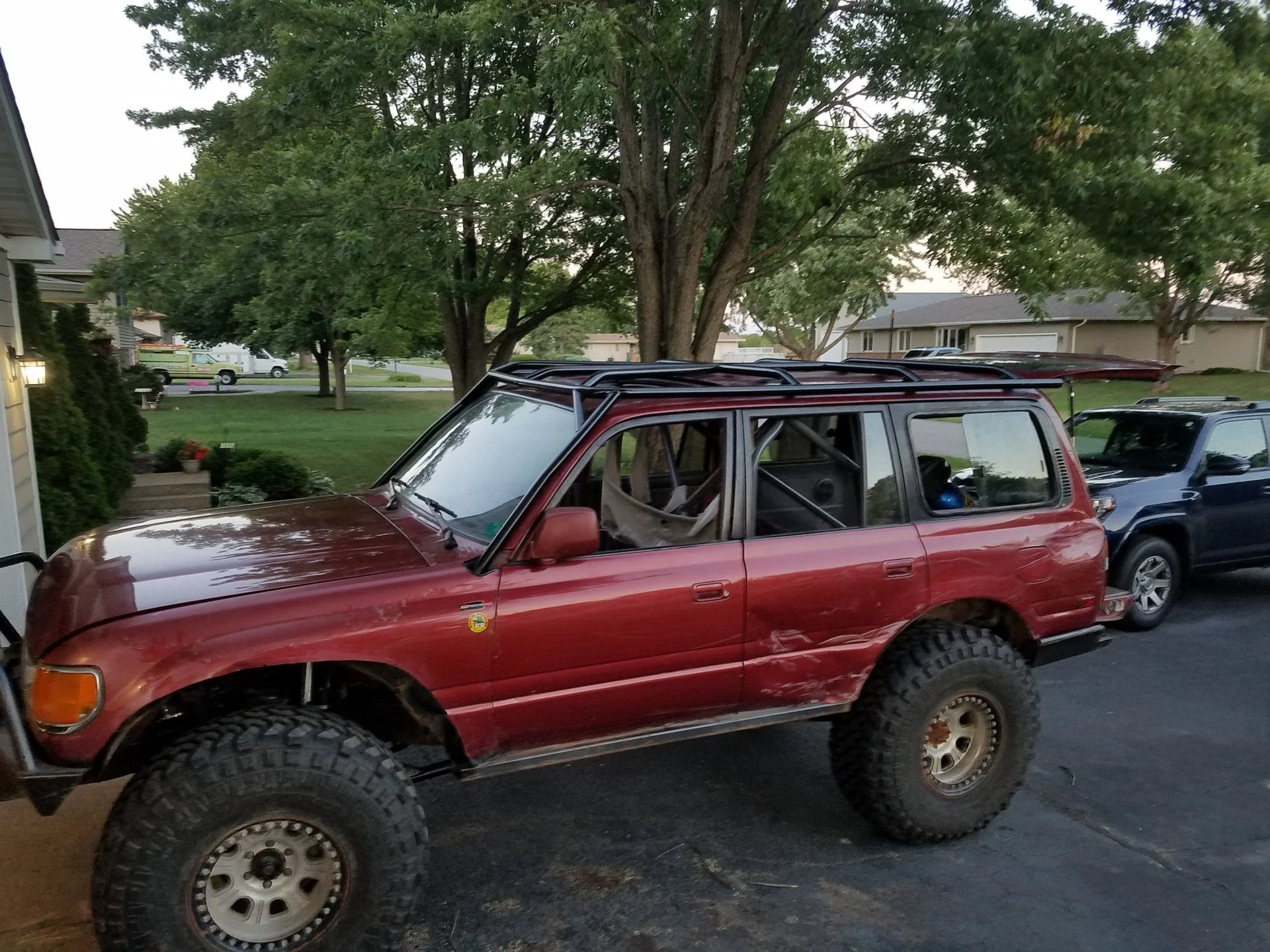

I mean yeah, it's a bit of a pile, but I am rather fond of it. This year it even made the Christmas card over one of our dogs, lol.
It's going to get a minor face lift though. On my way to Detroit for a new hatch, tailgate and doors. Gonna look pretty funny with the mashed rear quarters and a bunch of shiny, un dented sheet metal around them.
It's got some serious time before it ends up in the classifieds. I hope.

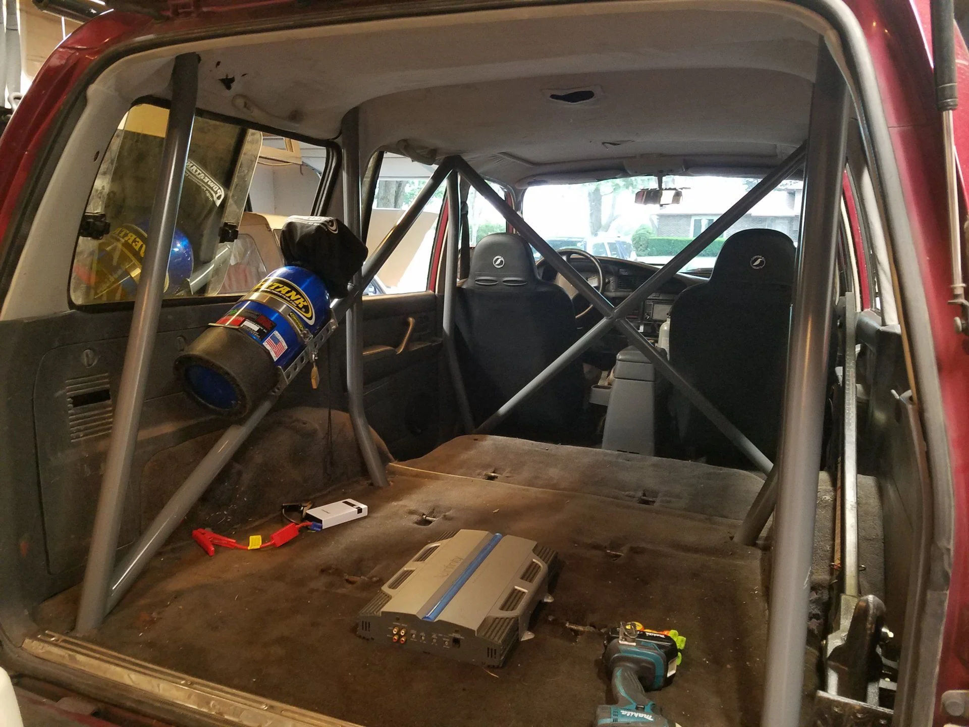

That's a lot of tube in there.
13.5mpg to boot.
144 feet, give or take a few. A little over 24' of scrap and a-pilliar bars I wasn't happy with puts total tube used at 168'. When I get back from Detroit today I should be able to get the rest of the cage build uploaded.

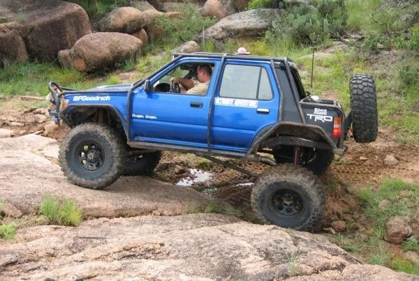

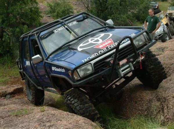

I was the "Toyota Guy" in 2007. Awesome awesome awesome trip.
Blue 2nd gen 4runner? That thing was awesome! UA has always been a dream for me, but until now I never thought I had something ready for it.
And thanks, I do appreciate the comments on the build. And I do hope to fully leverage the board if I get selected, lol.

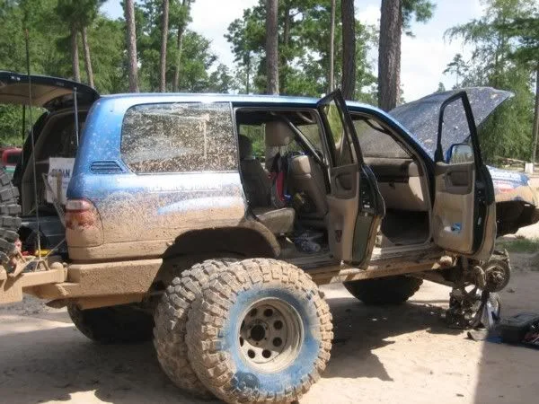

Met the Slee guys there with the Blueberry. Still keep up with Ben a good bit.
Great trip all the way around. At 8pm the night before we left at 6am, 4Runner had zero axle shafts and both diffs pulled. Long week. Swapped rear diff x3 in one day.

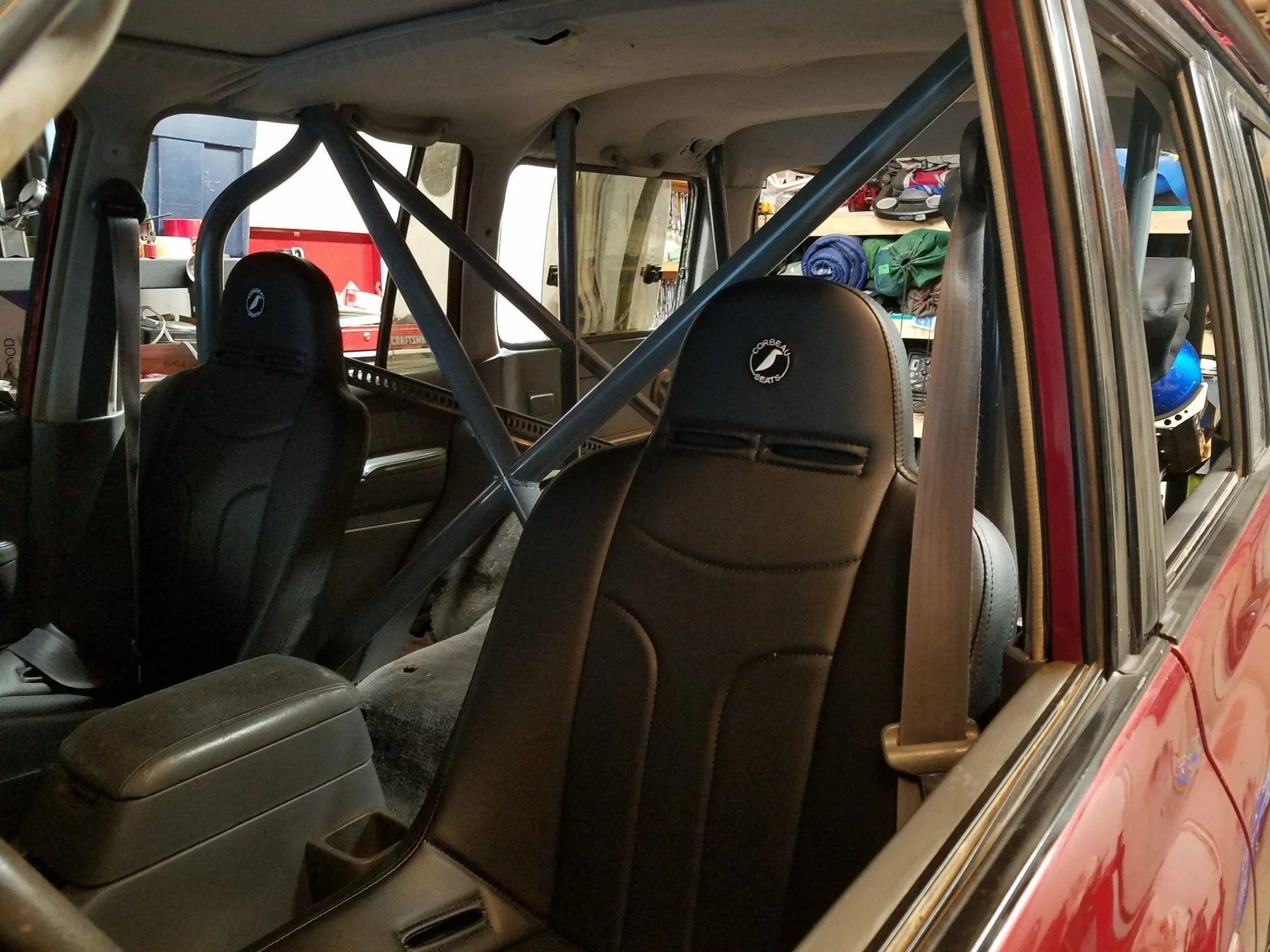

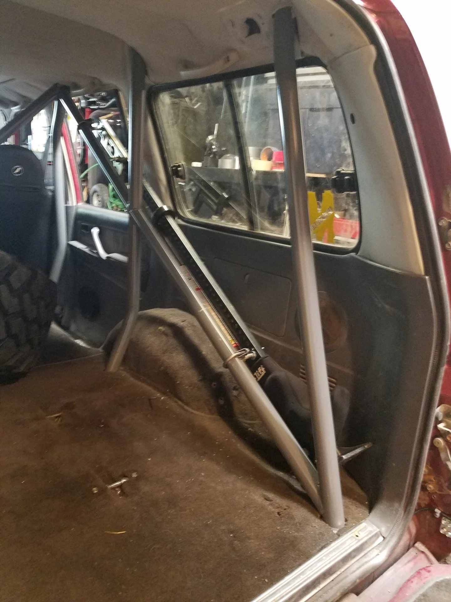

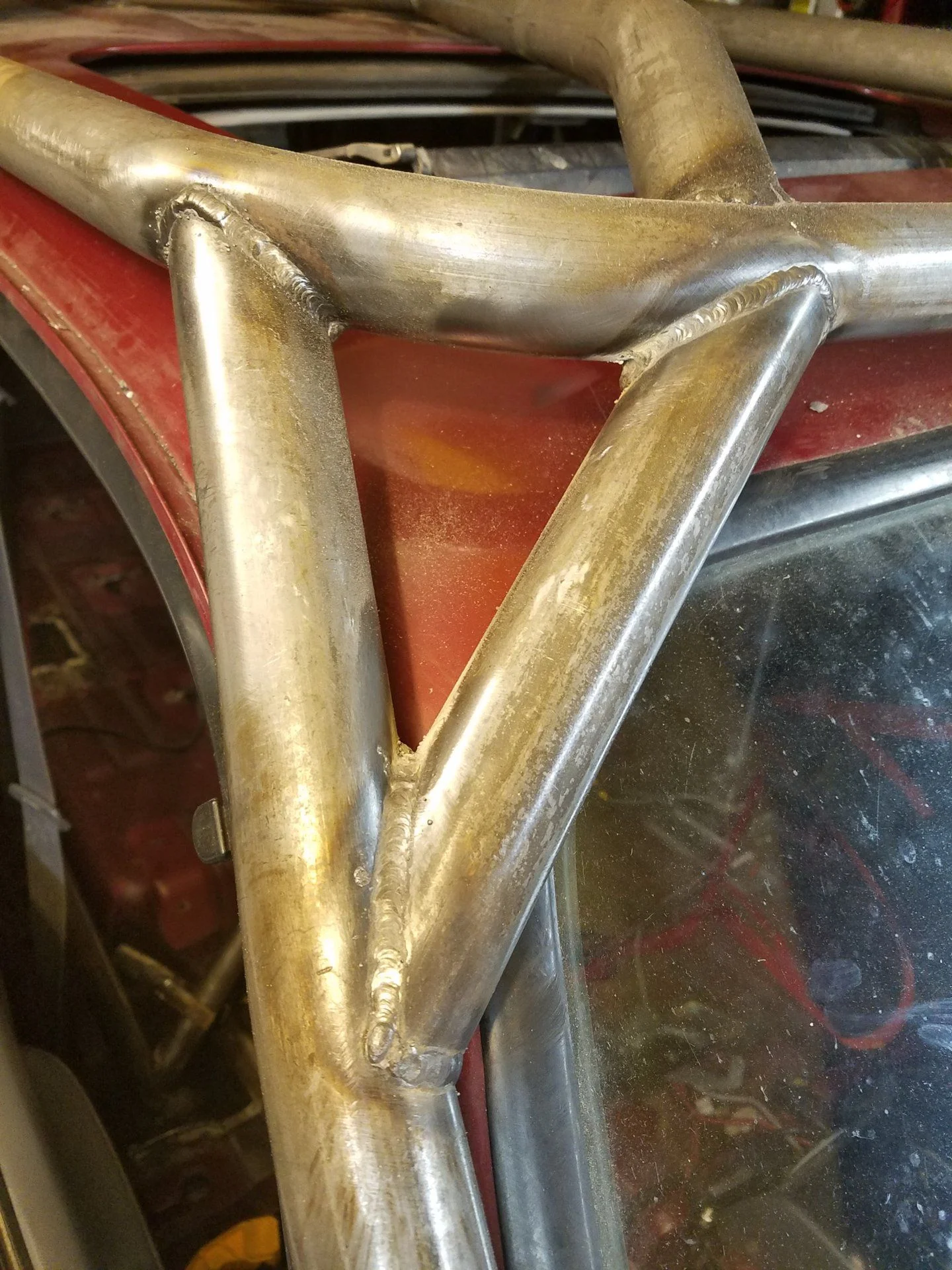

Once the hat was final welded on the garage floor, tossed it back up top and got ready to do the final gluing together of the top and bottom halves of the cage. I used a ton of anti spatter spray on the paint, tried to cover the windows the best i could, and still almost burt the truck down in the driveway. Whatever that crap toyota uses on the roof for insulation burns insanely easily and quickly. As half of my roof was on fire i remembered just how bad the cleanup was the last time i had to use a fire extinguisher inside a vehicle, and since i was in full welding gear, i just reached up and tore it all off while on fire and threw it into the driveway. Put it out with the hose, pulled as much of the rest of it off as i could, and went back to it.
100% of this cage is welded with my little Lincoln 135 with flux core. May not look as pretty as TIG or a gas machine, but she will hold. I definitely had to channel my inner contortionist to get all of the joints fully welded, but i was able to do it.
While i had the interior out i pressure washed the carpet, couldn't believe just how much better they looked. 23 years of grime ground into it had that water looking brown for a long time, and actually changed the color of the carpeting. Carpeting was in by June 25th, headliner by the 29th.

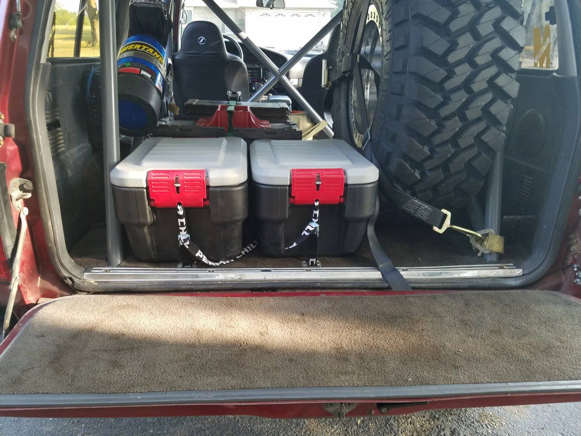

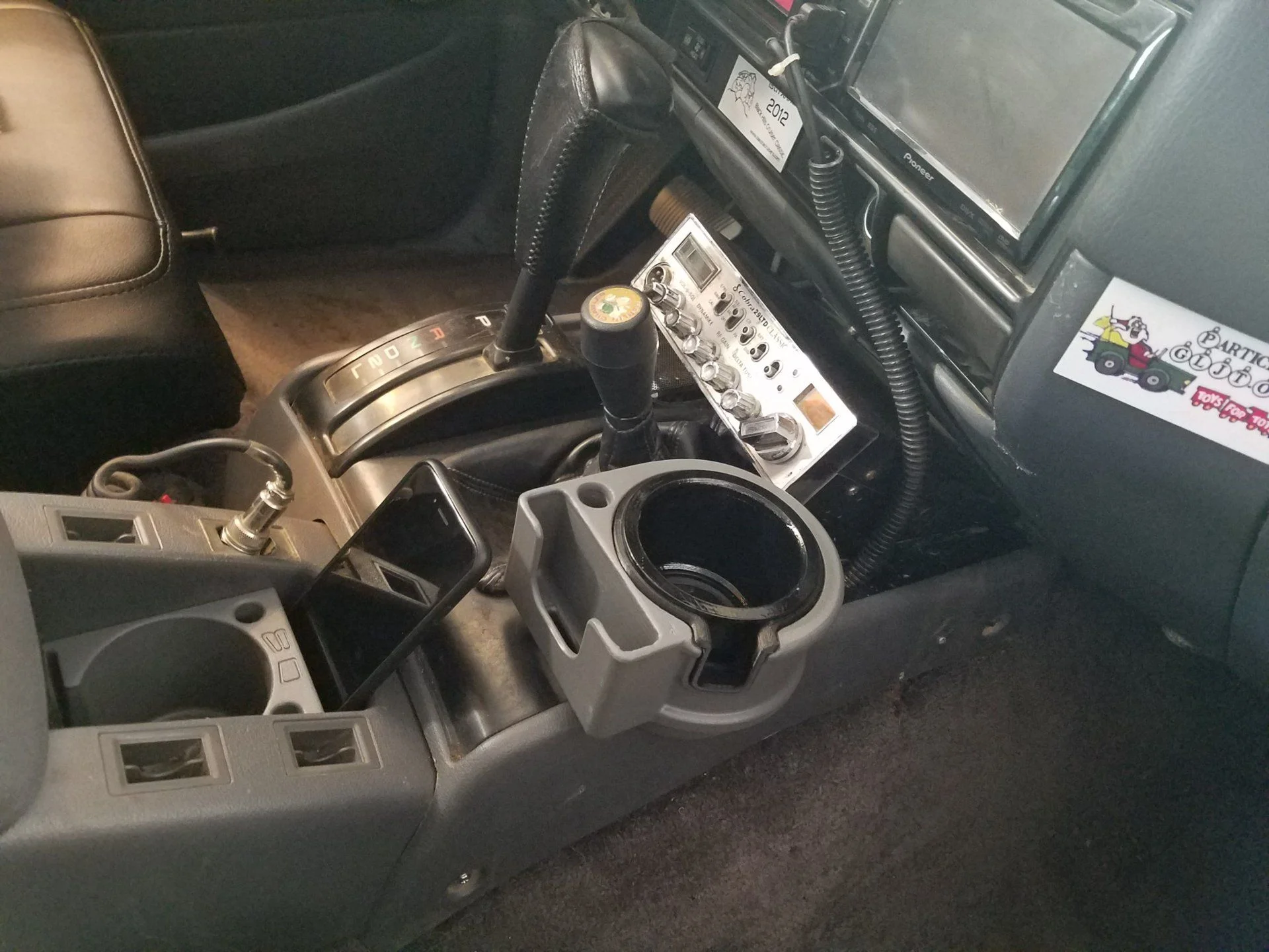

Made up a hi-lift mount using some exhaust clamps and some hardware i had around the garage, getting the 60" hi lift out of the way. New spare tire and wheel arrived just in time to get mounted up, along with the most important mods to date. Some BH3D cup holders.

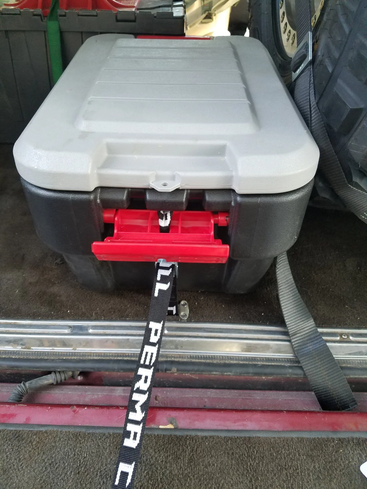

I like bins and totes for storage, as they are easily removable, but alway struggled with how to secure them. Since Gander Mountain was going out of business, i snagged up a bunch of their cooler tie down kits to use with my Action Packers. Mounted the brackets to the floor with their hardware, ran the straps through the latches, and this allows them to be full secured when closed, but still very easy to pop open to grab tools. Been pretty happy with how these are working.

Holy shoot, that spare is freakin' huge :)
You don't realize how gigantic it is until you are heaving into your cargo area, and looking at all the space you thought you were going to have just disappear.
Appaently a 40 fits in a 80 pun intended.
+1 on that insulation burning if you look at it too hard. I burned so much of mine
I'm not gonna lie, it scared me. Like the first time I burned a dried out Christmas tree. That was the last real tree I ever put in my house. I feel the same way about that insulation on the roof.
Do you have 40" between the cage posts so you can lay the spare on it's side? I could feel a noticeable difference in handling with the spare flat and right behind the front seats (back seats removed). And that was only a 35" tire. More weight towards the center obviously.
Yes, and I experimented with that. Since my cooler, and two action packers still need a home, they were either going to have to go on a platform, or work them in behind the passenger seat next to where my single back seat will go.
The cooler and totes actually are the same weight as the spare, and I was keeping the Cog about the same.
Now, once my tailgate storage is done I will re evaluate. I picked my new tailgate and hatch last weekend, hope to start that soon. If I can kill the two action packers of tools/parts/junk, I can lay the spare back down and build a small shelf for cooler and gear above.
