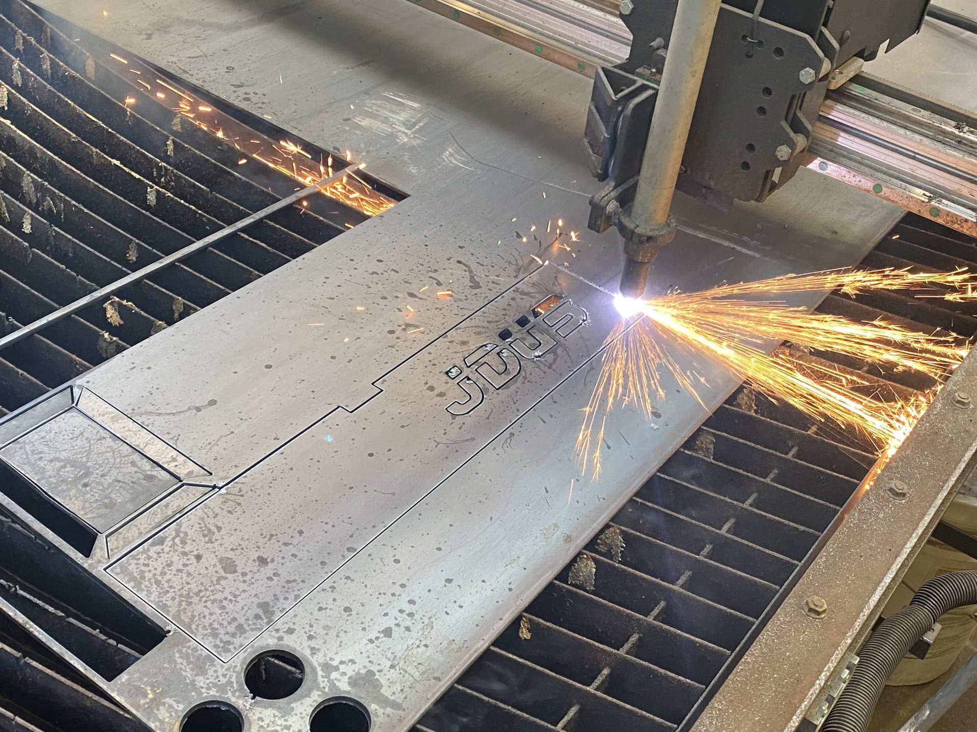

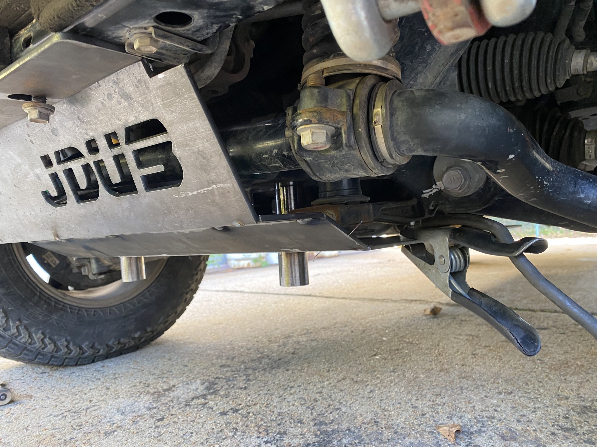

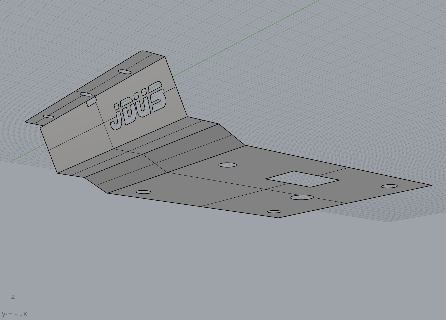

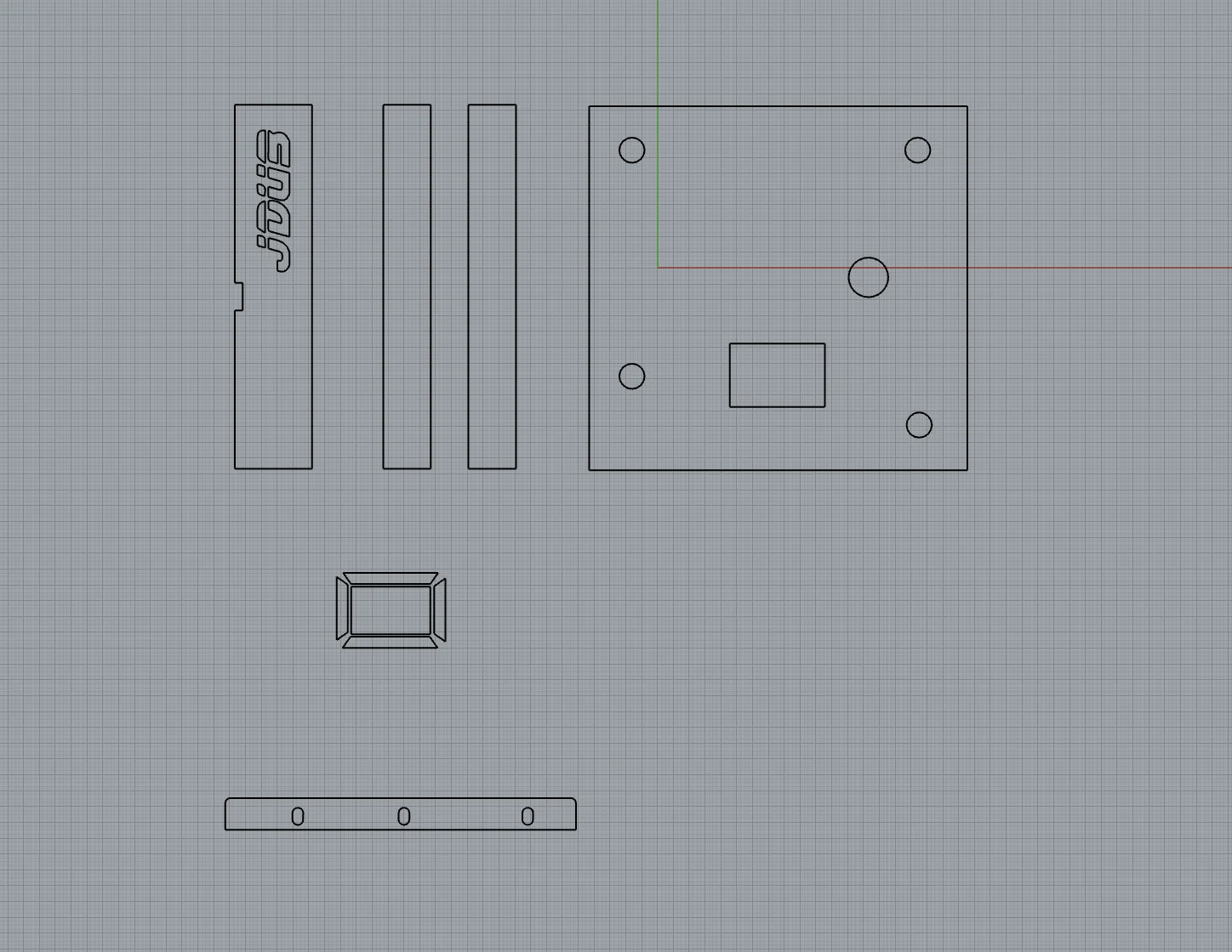

I’ve been working on a front skid design for a couple weeks now. Using my Tacoma design as a starting point, this skid has an oil drain hole, and as much clearance as I could get (with a diff drop). Was going to do an oil filter trap door, and I still might, but decided pulling the skid down twice a year isn’t a bad idea..
I will post the cut file when I am totally finished, as I am still tweaking it as I go.

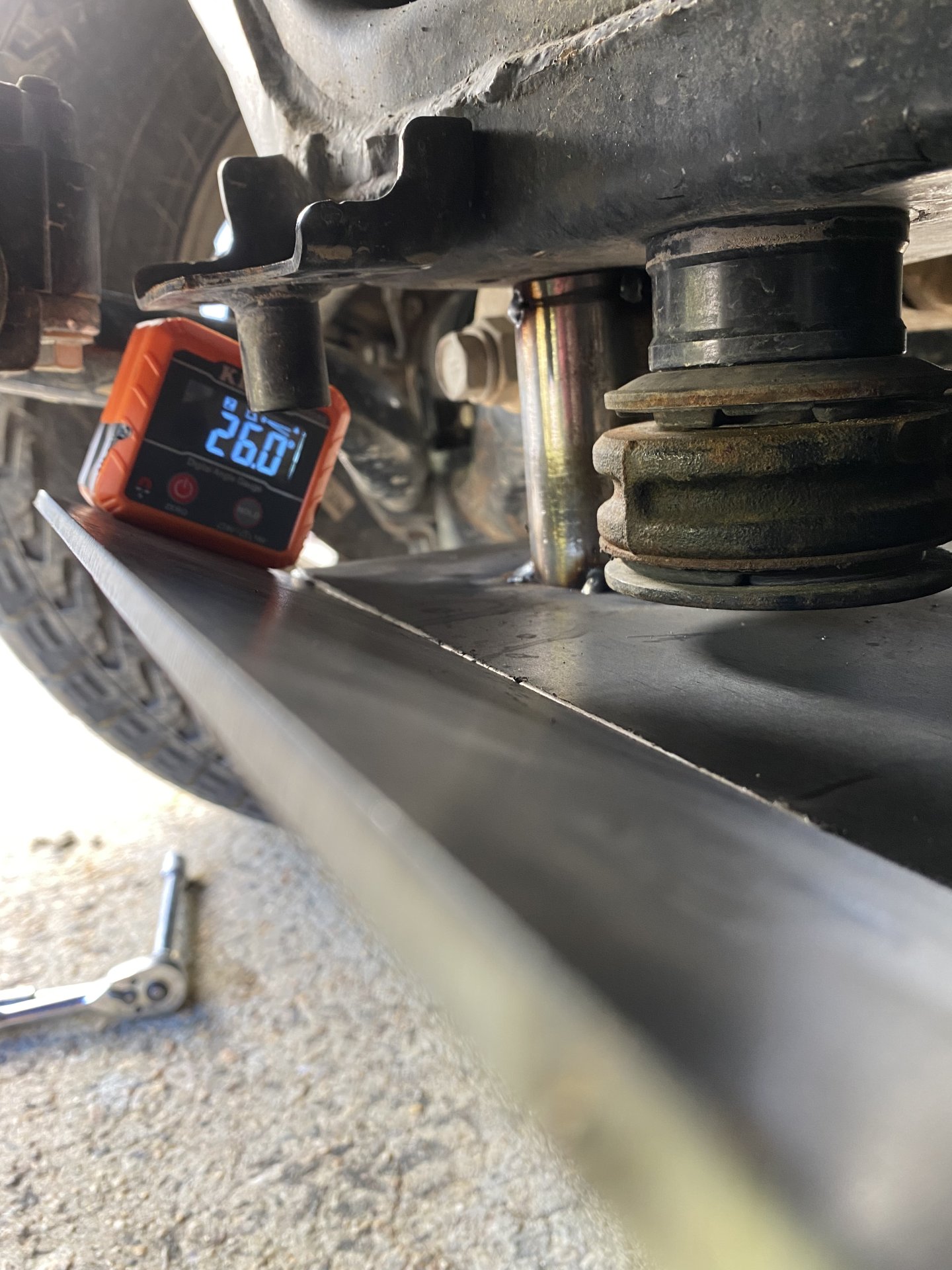

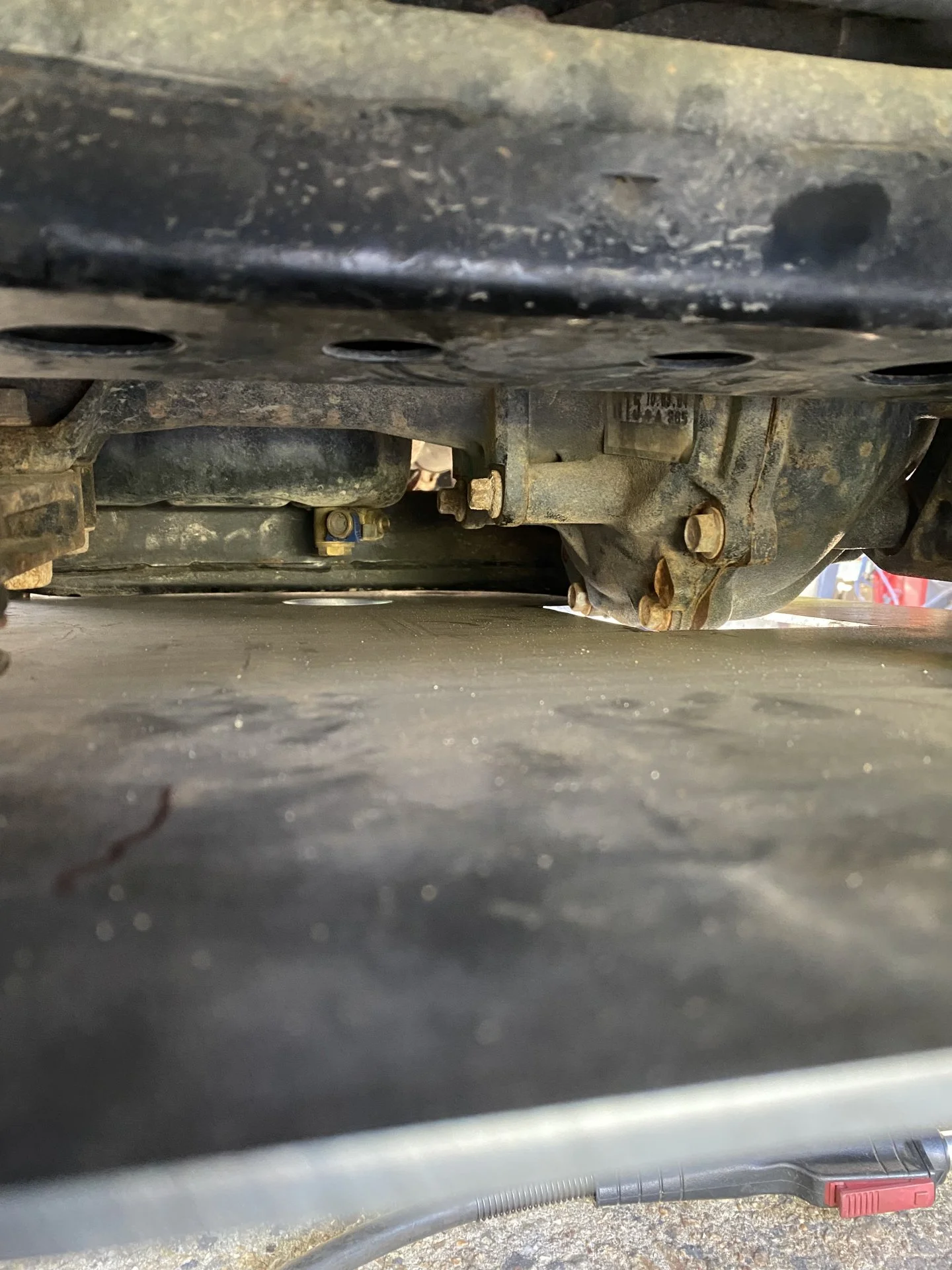

I removed the front kdss protector bars and gave the skid 1.5” of clearance below the sway bar, which is what the oem bars have for clearance. Once complete I will test out in full articulation to make sure it doesent hit anywhere. (I have kdss spacers)
Uses all stock mounting locations and bolts. (Although will be upgrading to grade 8-10.9) I ran a tap in all spots with some cutting fluid to clean everything up. I recommend this everywhere on your rig, helps a lot in my part of the world where corrosion is prevalent. Luckily there are only like 3 different sizes, I keep the taps in my rig tool box.
My plan is to contine the skid set and design a mid/rear and gas tank protector.
Material: 3/16” mild steel. I’ve made 1/4” aluminum versions, but prefer how steel slides over rocks. Especially for the front skid.
Teaser: also in the process of designing bolt on sliders plates/sliders. Stay tuned for that.

Looking good. Do you plan on adding side ridges or gussetts? The factory mounting points are tacked nuts, if the skid plate deforms, the factory mounting points will either get tweaked or the tack welds will break.
Yes and yes. Gussets are key in the very front, I will be adding verticals support all the way back too, it really helps a lot.
I’ve never had an issue with the factory nuts, but I agree they are tenuous. I’ve bashed my Tacoma skids pretty hard, and never damaged the mounting nuts, I guess I bashed my arb GX skids too, bent them reall bad and nothing damaged to the mounts.

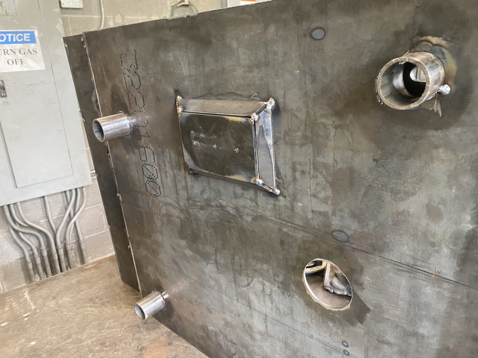

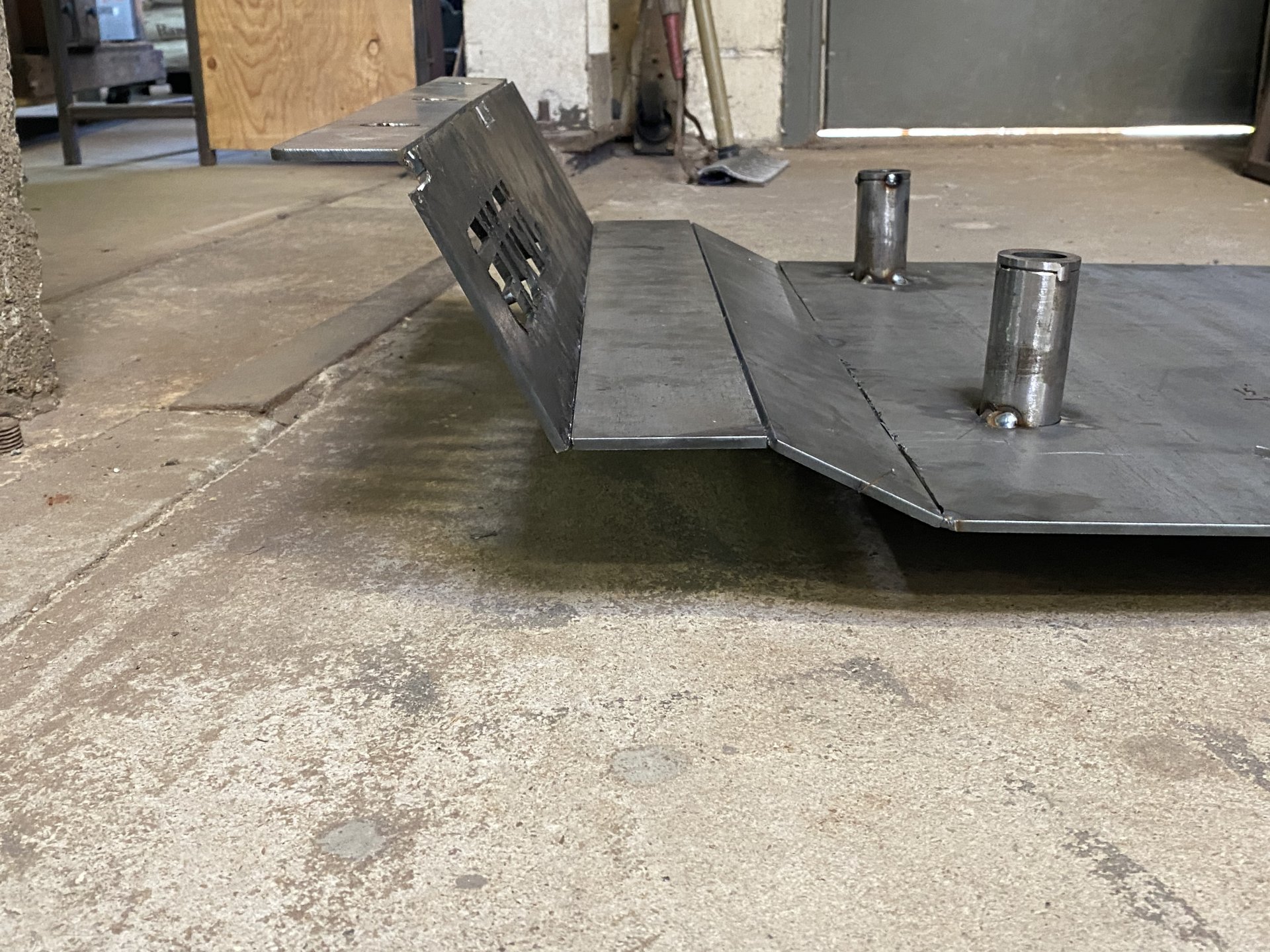

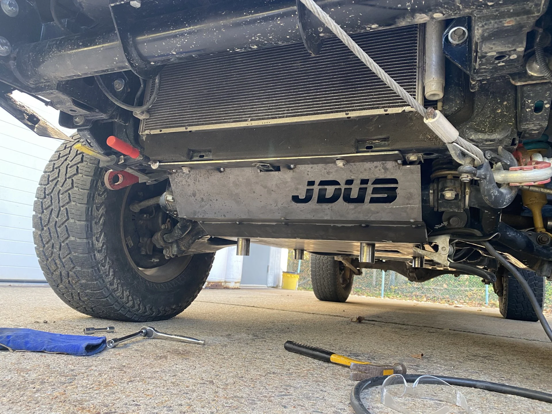

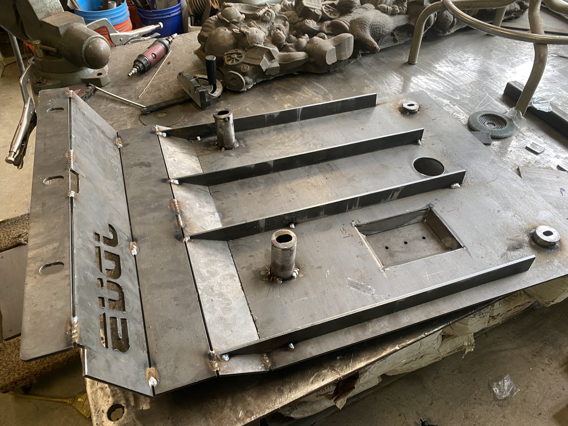

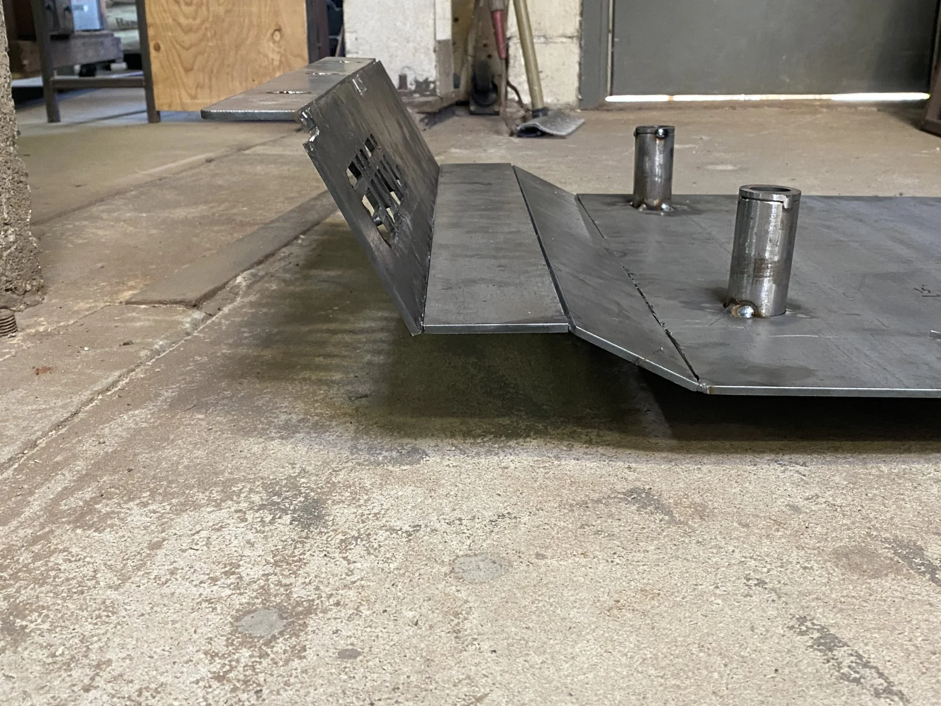

Little progress, got the gussets on and diff drop plate tacked in. Now I need to jack the rig up and throw it back under to measure how tall I can make the side pieces. (See where they would hit the LCA at full droop) also need to cut and attach a rear plate for the next skid to attach to.
That is looking very bullet (rock) proof!
So looking at the power panel in the bottom picture, it looks like you have a shop and this isn't a home garage job?
Also, nice touch with the laser/waterjet cutout of your logo!
View attachment 3156993View attachment 3156994
Lol yeah not my garage. I got some serious power and gas to this building. I’m a college sculpture professor. Lucky to have access to the facilities, including a CNC plasma. If you look close you can spy one of my cast iron sculptures..
