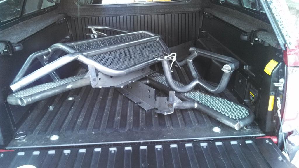

If the carbon steel skids get beat up of in the future, I'd just pull them off and have them blasted and powder-coated again. I'm getting my sliders blasted and coated in a few weeks as they look kind of crappy after 4 years and 4 winters on the rig. This will probably cost me around $100, but I'm getting it done as part of a big batch of other powder coating.

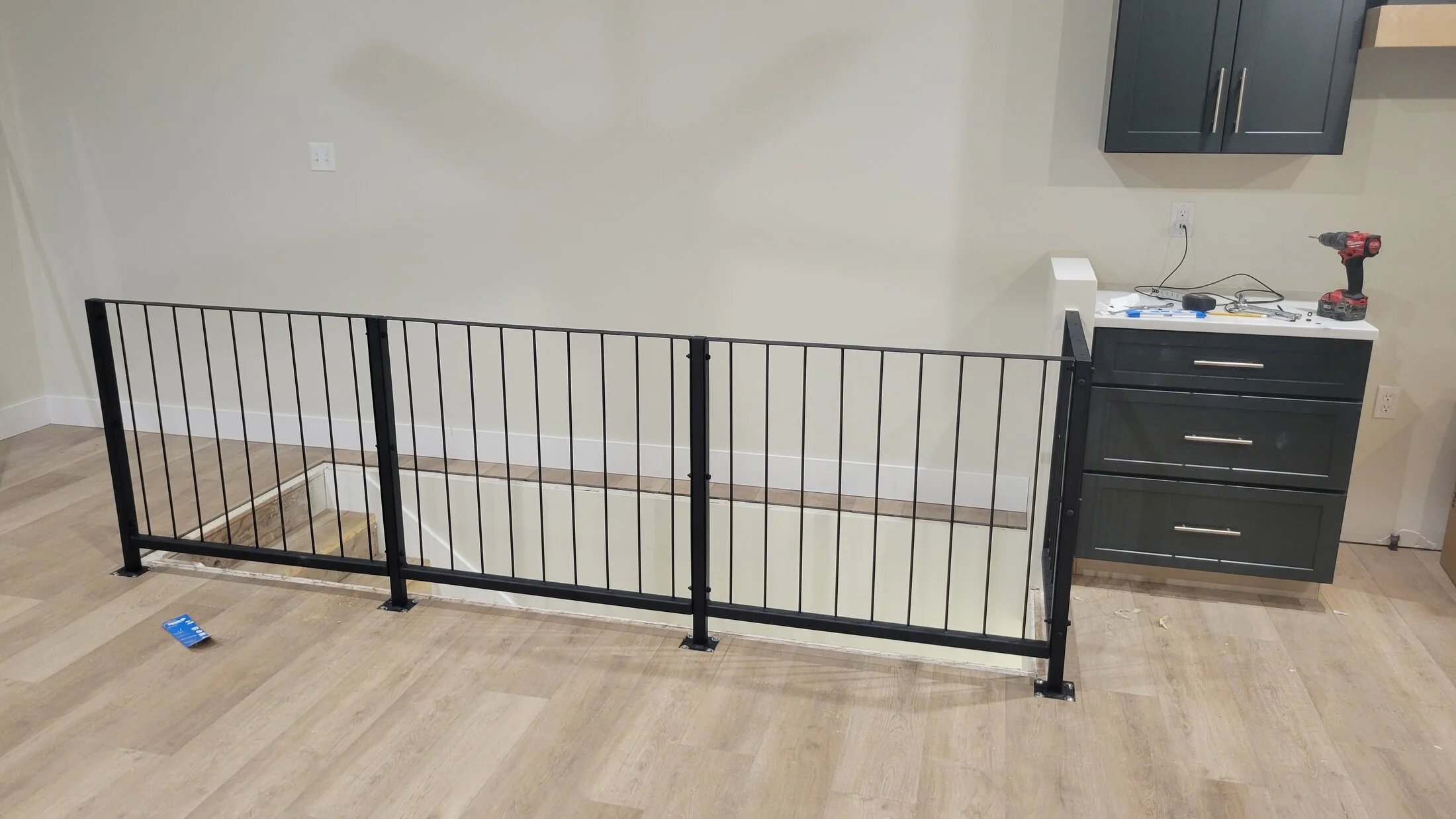

I have a cousin who owns a sandblasting business and a great local powder coater who is also cheap :). Blasting and coating these only cost me $235 and it was ~12 feet of railing. I'm working on another ~65 feet of them at the moment for outside. If my sliders last 4 years in powder like the rattle can job did, it's definitely worth it for me just for the time savings in prep work and paint.

I had my Taco armor powder coated by a commercial place in town even though I was a small order they showed me around the plant and treated me like I was spending thousands instead of $200.
