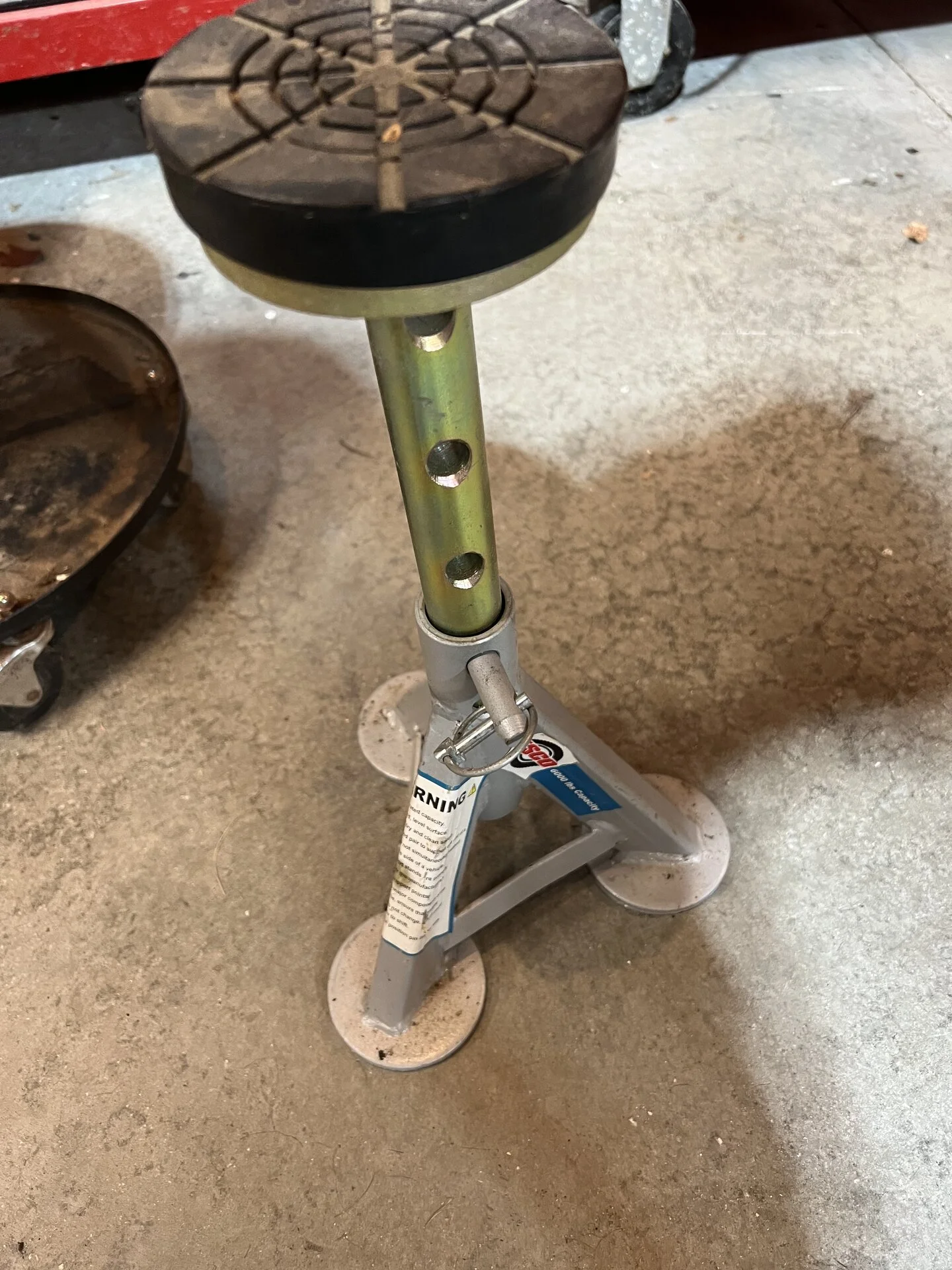

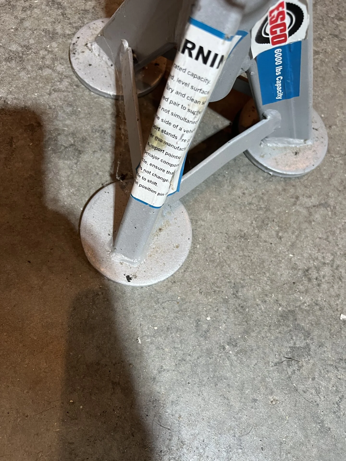

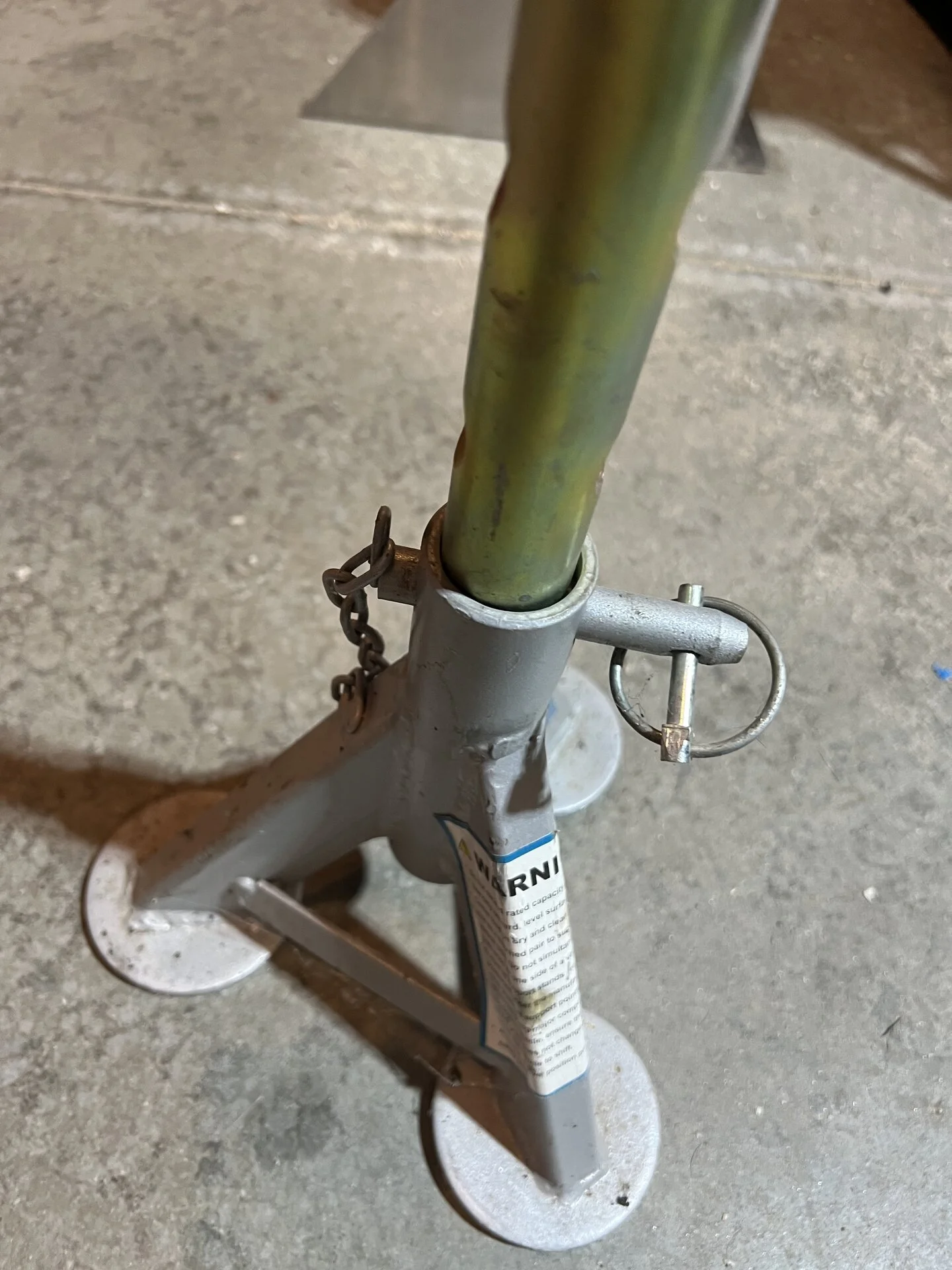

I have 3 ton escos that I like. I wish they were 6 ton in the same design. They have large round foot pads, positve locking pins, and a flat surface with a nice round pad.

Esco design features I like:
