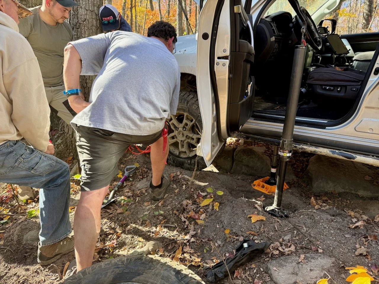

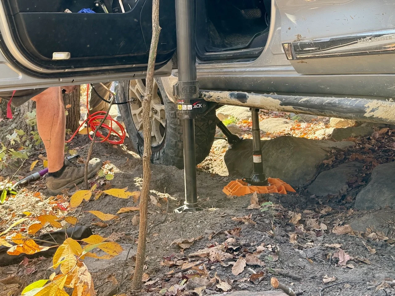

I blew a bead on a trail last fall, front driver. It was a really awkward situation on a slope, driver side leaning downhill. Had to winch front end to a tree to avoid sliding downhill into more trees. Grabbed the ARB jack and placed on driver side Bud Built slider. As I jacked, it was bending/flexing the BB slider towards the frame. My truck is very heavy on the scale and this side was taking all the weight at an incline downhill (pics don't really tell).
If I was on even ground the options would have been easy. (hint - to avoid banging the jack on your door, open the door)
We ended up adding 2 OEM bottle jacks to assist with the help of the ARB jack base. I own a Safe Jack (bottle jack) but did not bring on this trip and in hindsight really wish I had it - going forward, it's going with me. The ARB jack is nice but not always ideal in terms of placement. I would assume the same with Hi Lift. If you have a winch and snatch blocks and/or recovery rings, I would lean towards a good bottle jack + the OEM with base. I also like this jack stand base >> Jack Base Plate - https://emsoffroad.com/jack-base-plate/
FWIW - My ARB jack is out of warranty, a part (skewer) broke on this trip. Months later, finally got around to contacting ARB last week and they had a new one delivered within a few days.

This is where the OEM bottle jack saved the day. Modest Toyota jack beats all expectations with 11" of stroke travel.
Agree having a base for any jack so it doesn't sink, to maximize all stroke travel, is another great tool to have on hand.

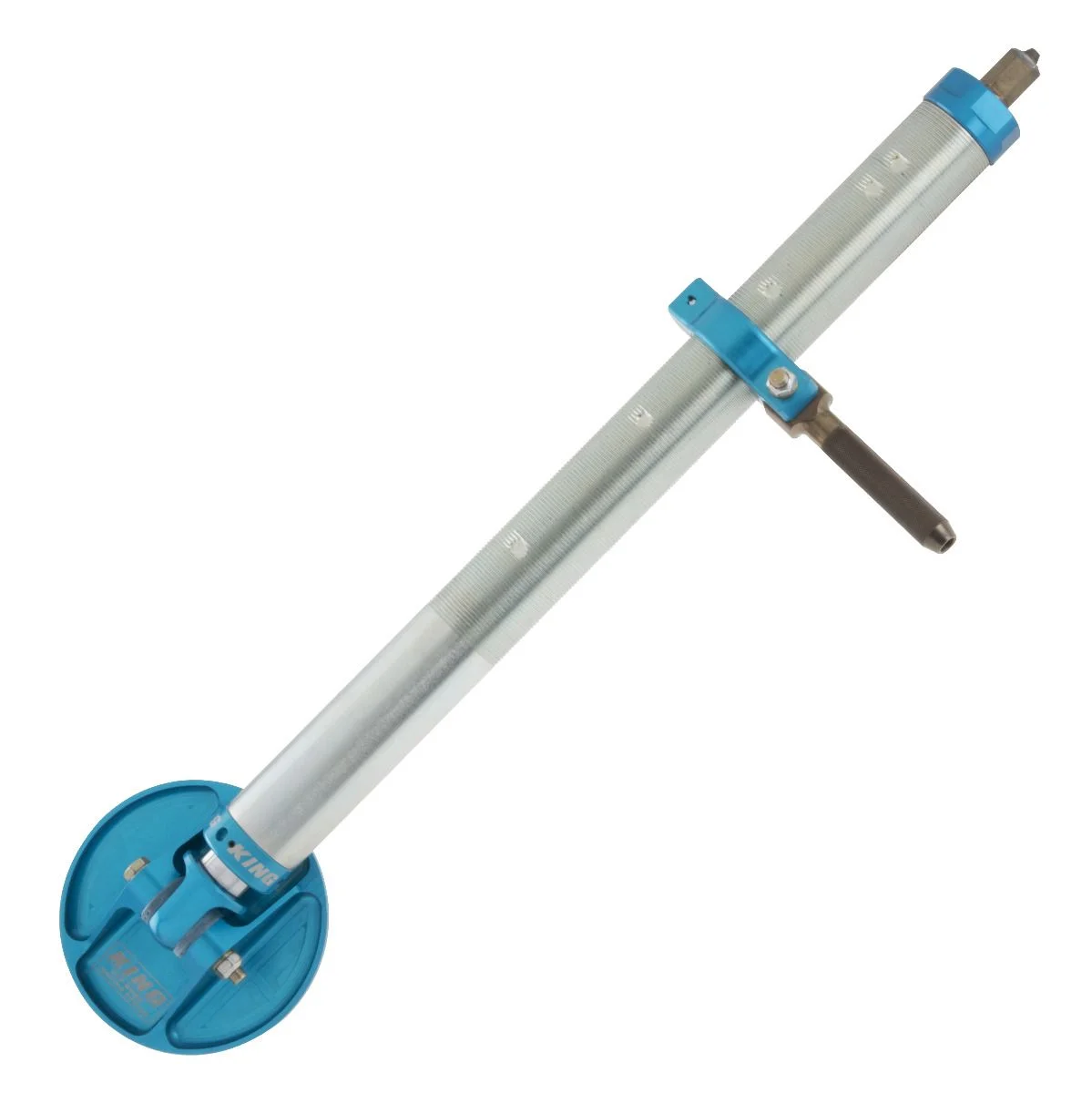

Mods, feel free to break link if against the rules. It’s a “PMP jack”. I don’t know anything about it, but sounds versatile if it works as advertised.
These look interesting. I’d like to see one in person to see how “packable” they really are.

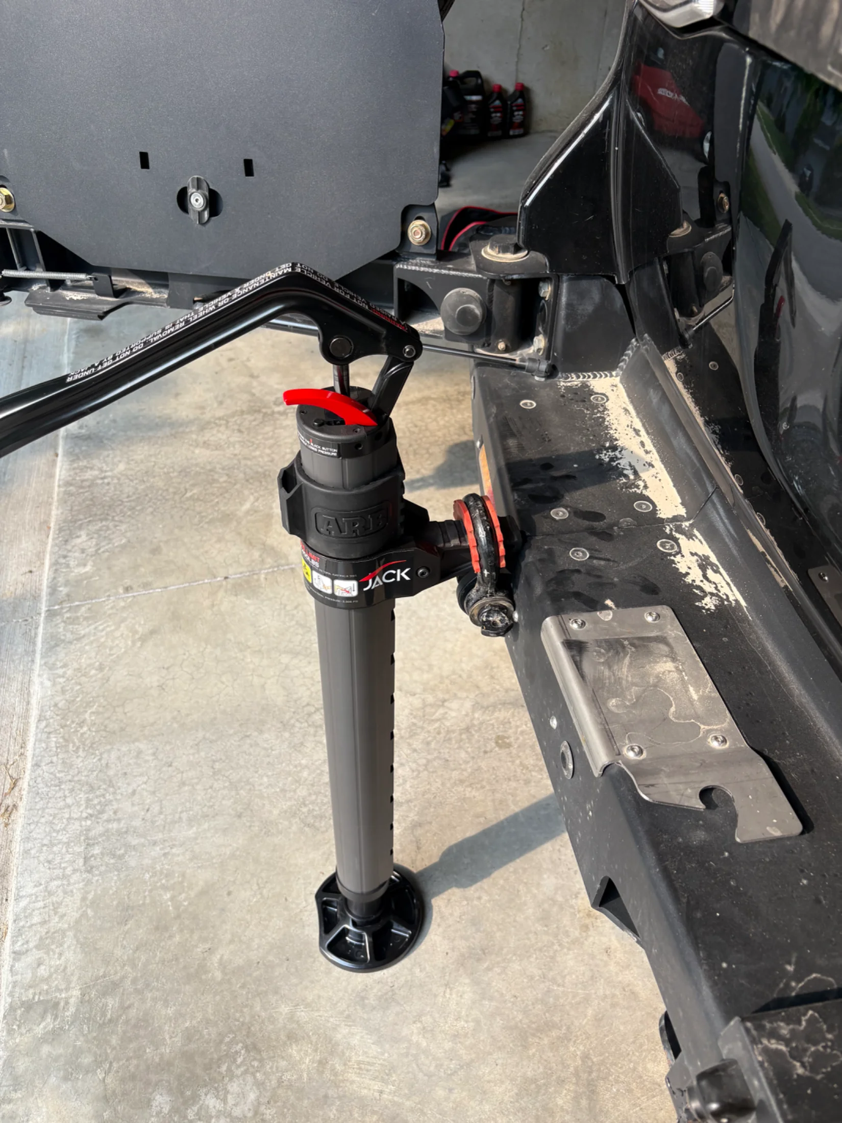

I was just in my garage playing with my new ARB jack and thinking about lift points. While I was at it, I crawled under to scout ways to strap the axle to the frame before you lift it. Certainly possible but there are brake lines and ABS wires that need paying attention to. I may play with doing this in my garage on each corner so I have an idea on how best to route the straps.
On a side note, I messaged Dissent on making a lift points on the side wings of their rear bumper and they do not recommend it as it is aluminum and not designed for loads like that. They recommend lifting at the recovery points. You can’t directly just do that but you can lift a rear corner using a bow shackle on the recovery points.
A “sling saver” style shackle might be better as it would have a flatter spot to engage the jack jaw in. A “billet” block with a pin to go through the recovery points hole would be cool.

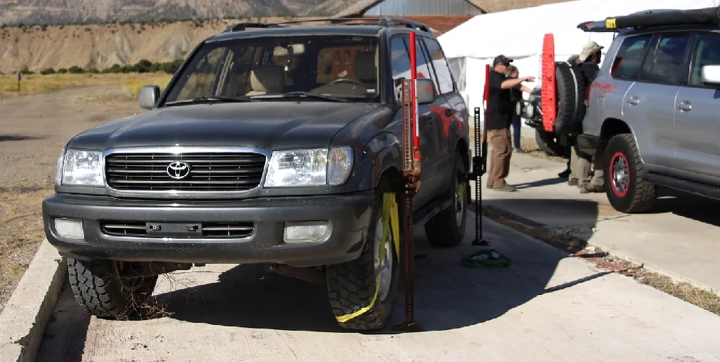

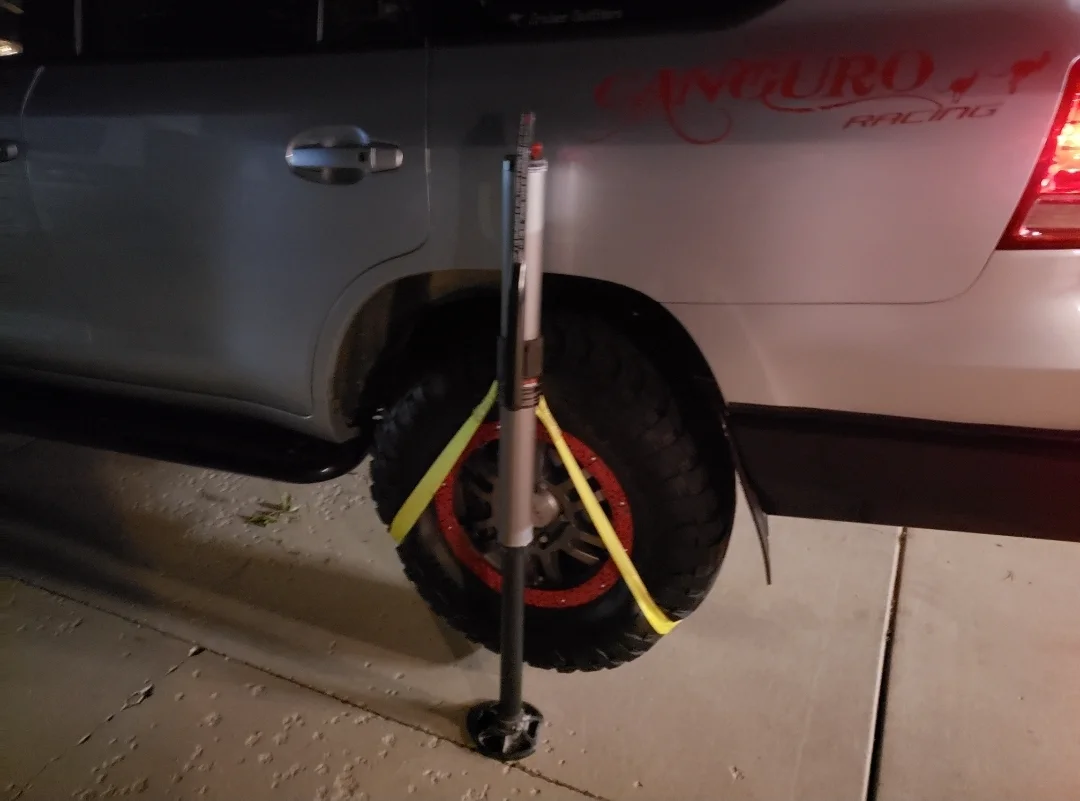

Hi-Lift + lift mate or Hi-Lift + and a short static strap or endless loop makes a fantastic lifting device for many needs. Not ideal by any stretch for tire removal for obvious reasons BUT in a scenerio where you need a lifting tool AND winching abilities it's working.
Here is one of each in use:
ARB easily works the same way:
