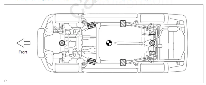

So... has anyone here actually damaged the OE skid plate when jacking properly from the ring under the cross member? Or is this just MUD lore?
Maybe it's just ignorance on my part by I've raised both my 100s and 200s countless times using this point. There's a reinforced structure there to take the force. And I remove the plates with each OCI to keep things tidy and inspect the engine from below. They always go right back into place, no warpage, no damage. I get the desire to do things 'properly' but this seems like unnecessary effort?
These are the jack points shown in the service manual. No notes indicate the recommendation to remove the plates first.

Before I removed my OEM skids, I used the round "hole" as an orientation for front lift point and used that to jack the rig up. I think it bent a little, but can't remember for sure as shortly afterwards I replaced everything with Budbuilt skids. At worst, the damage was cosmetic however best I could tell.

I sold my skids when I got the Slee system then E&E's, so I can't provide evidence, but mine were definitely bent and required straightening from doing this with the bare cup-shaped top of a floor jack. I did eventually start using a 2x4 to help, but even then things seemed tenuous, due to the structure we're jacking against.
From memory the round spot is built into the bottom of the center "spine" part that supports the inner edges of the front side plates, and when you check that out it isn't very thick steel. Definitely nothing like I'd expect from the cross member itself. Because of this I just started zipping the plates and spine off with the battery impact before jacking the front of the truck. Odds are I needed them off anyway.

Interesting. I don't use the factory front cross brace partly due to my experience on my 100-series. The OE skid did deform before positively lifting. It feels that way when lifting with the 200-series skids too. So I rather lift from the lower inner arms where it's absolutely stout. It's not flat but with a jack pad, works well for me.
