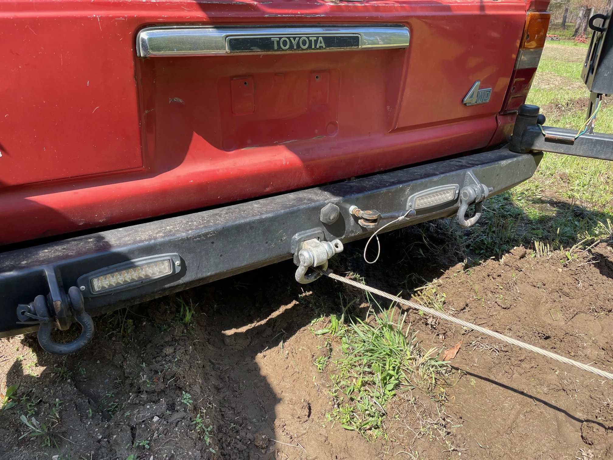

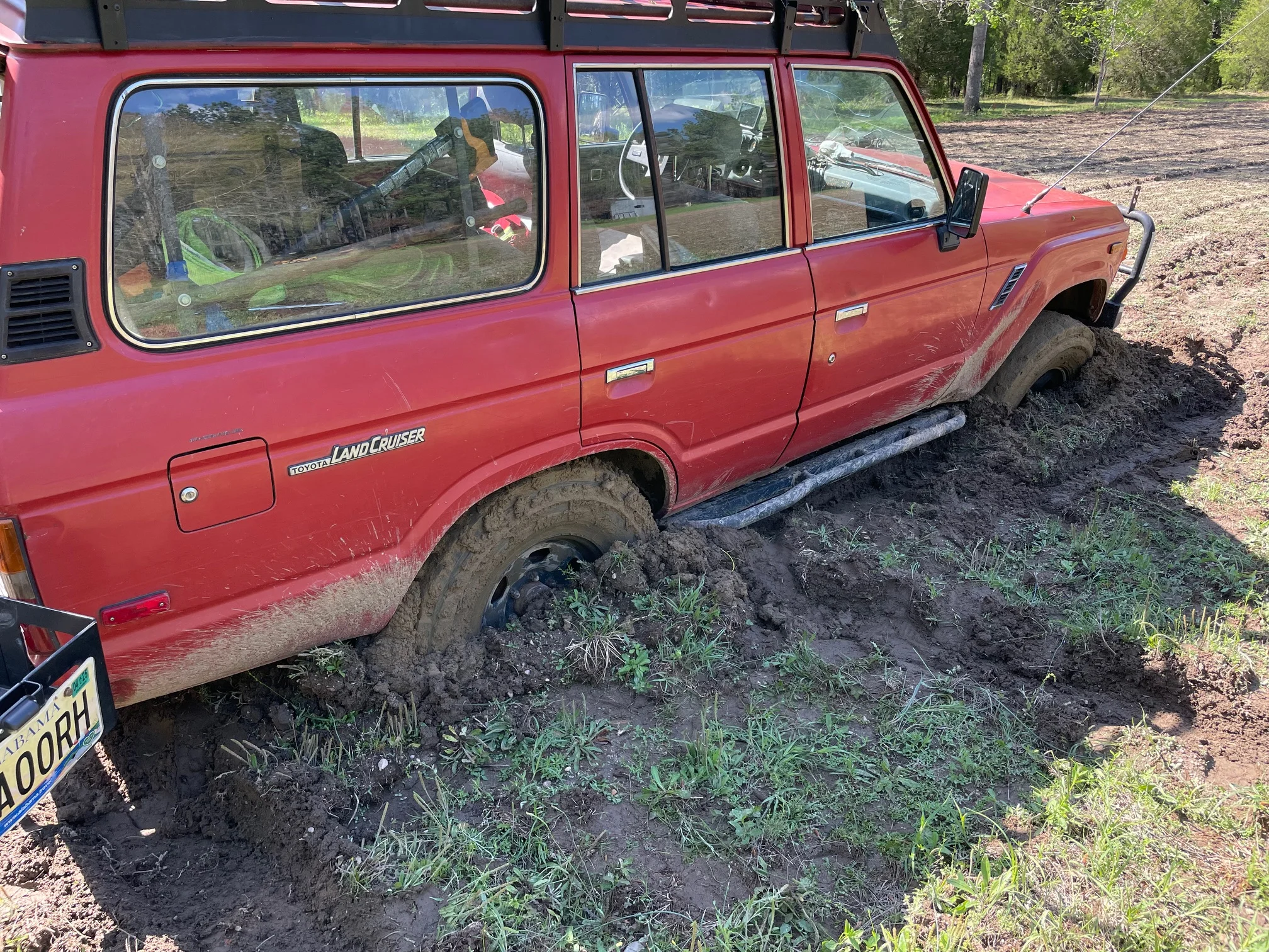

Agree, don't. If you need a rearward pull that often rig up a winch in the rear. I've done front mounted winch/backward pull a couple times when it was only lack of traction on a muddy road. It worked ok, but earlier this week I got into deep mud and tried it again. Stalled a 12k Warn winch without moving the Cruiser. Wire rope cut a notch in the lower portion of the roller fairlead.

I bet it was fun stringing the cable in the mud under the rig… lol

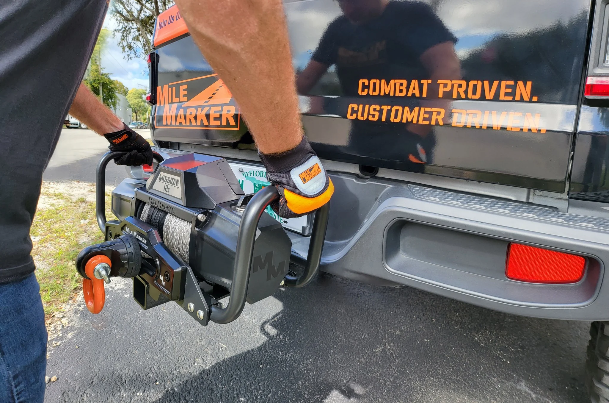

winches are so cheap these days, just get a 2nd, fab up a mount that locates in the tow hitch so its removable and run +ve & -ve cables from the starter battery to a large anderson plug at the rear.

Or you can do 2in receivers fr/rr with a removable winch mount. Just need to run dedicated wires to rear with a high amp anderson connector. Just be careful with off angle witching, lots of stress on the hitch insert

I’ve tried that setup just to see whether it works. I can report that yes, it does work, but it’s really a handful. I have the regular-style snatch blocks, and had the (synthetic …) line catch in one of those when a slight angle developed during the pull; probably better to use those rings designed for synthetic line. I’ve decided that when the time comes that I need to winch myself backwards, I’ll sling the line under the truck, even if that means I’ll have to kiss the line goodbye afterwards. Since I carry line extensions anyway, I can wrap one of those onto the drum and motor onwards.

I know you don't want to hear "add a second winch", but the china freight winches are decent enough to put a secondary winch on the rear. I have a nice Come Up winch in the front, and a Apex 12k in the rear. Will I ever need it? Probably not. But I bet it gets used for all sorts of stuff besides vehicle extraction...
