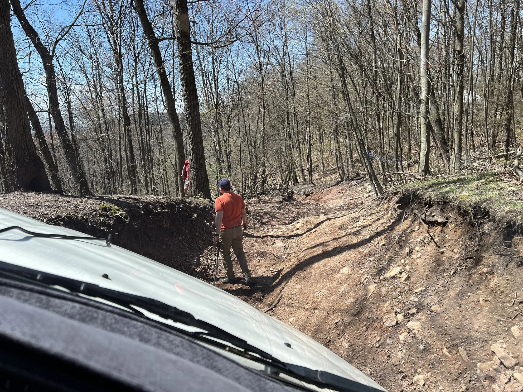

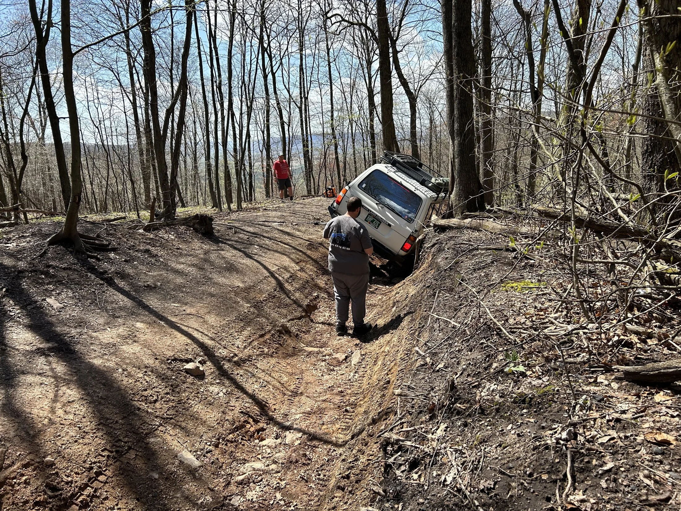

Think also about the redirect, not just extraction.
In the pictures below I was driving and the rear end slid down into this tree root/ledge. If I kept driving, it would have mangled the rear quarter even more and probably ripped out the taillight.
We used my front mounted winch, two snatch blocks (traditional AEV pulley style), two tree savers and soft shackles to redirect the pull on the rear bumper to allow me to pivot off the root and get clear.
I'm the dope behind the wheel, not the guy in the photo. :) The angle felt fairly sketchy... The recovery was smooth.
PS. I was the tailgunner, so there wasn't anyone behind me to winch from behind.
PPS. It is hard to see, but the winch line runs uphill, over and back down, not under the 80. Friction is a synthetic winch line killer.
