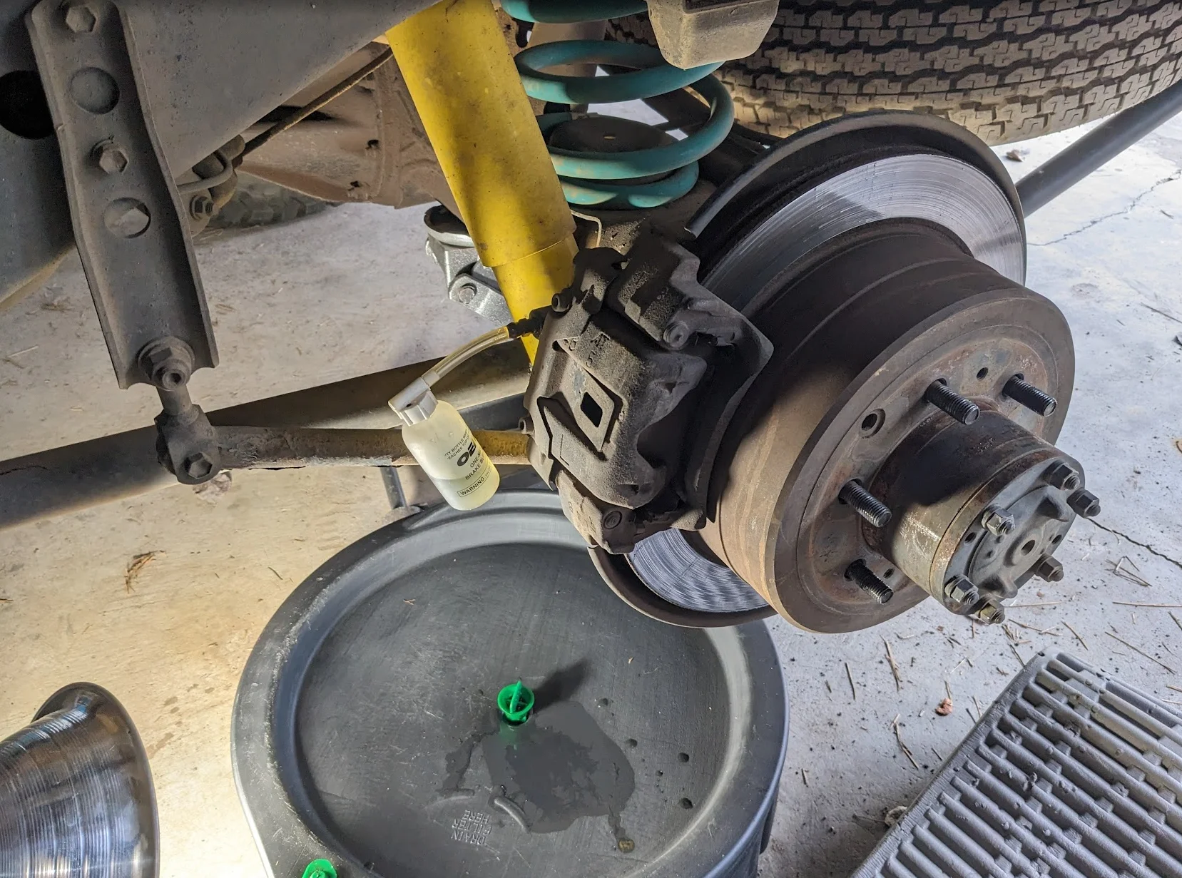

Switch to a two year interval for brake fluid and I bet this never happens again. It's often the most neglected but crucially important fluid to keep in good condition. With a one man bleeder (also known as the gatorade bottle method) it's easy to replace the fluid without introducing any air (the fluid drains into a container with the hose submerged so air cant be sucked back in). I have four vehicles and a motorcycle so I'm flushing brake fluid pretty regularly and this method works great.
