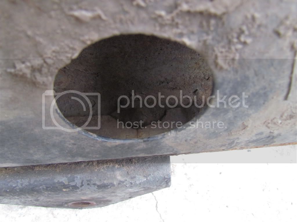

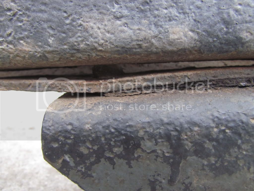

Last november work started to slow down and i tore down the Cruiser. In that process i found that the chassis was in even worse shape than expected. For instance, the left front springhanger was almost torn off the chassis and it was full of cracks.
Here are two pictures of the spring hanger:

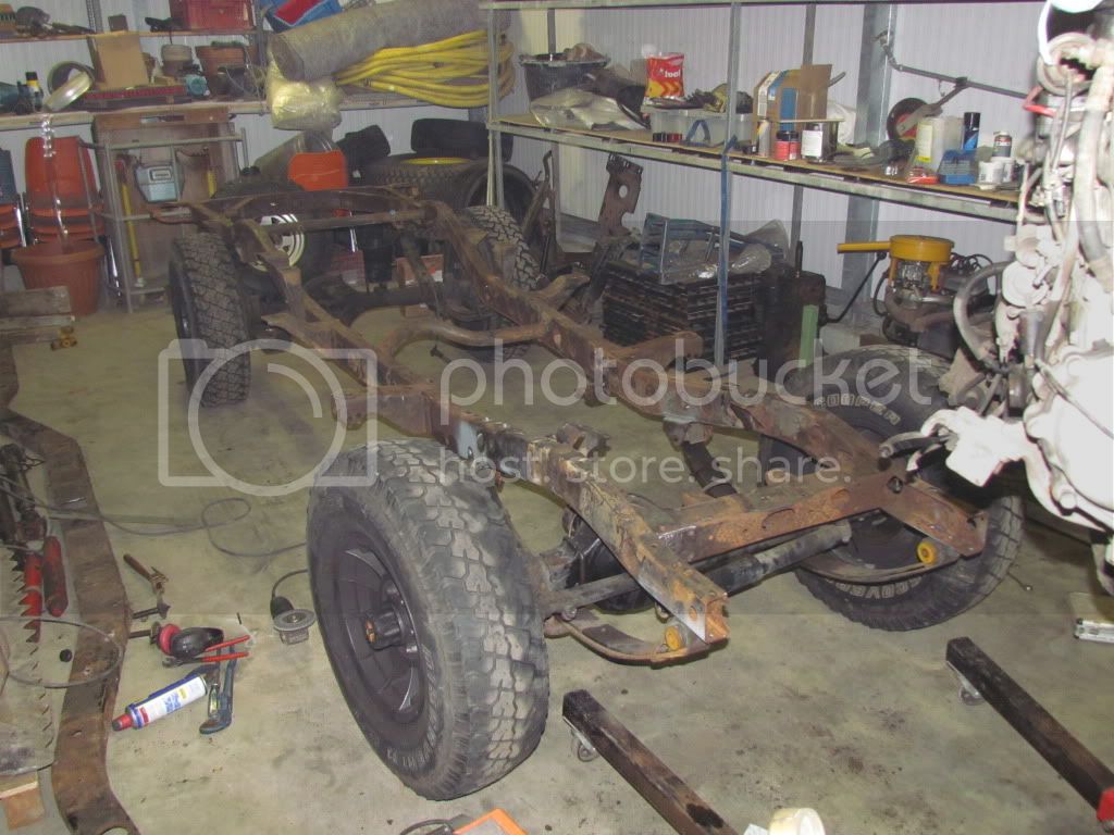

I was a happy camper to get that one weighed in and to get the Ozzie chassis in my small and messy shopish area.
I kept it SUA to be able to move it easily.

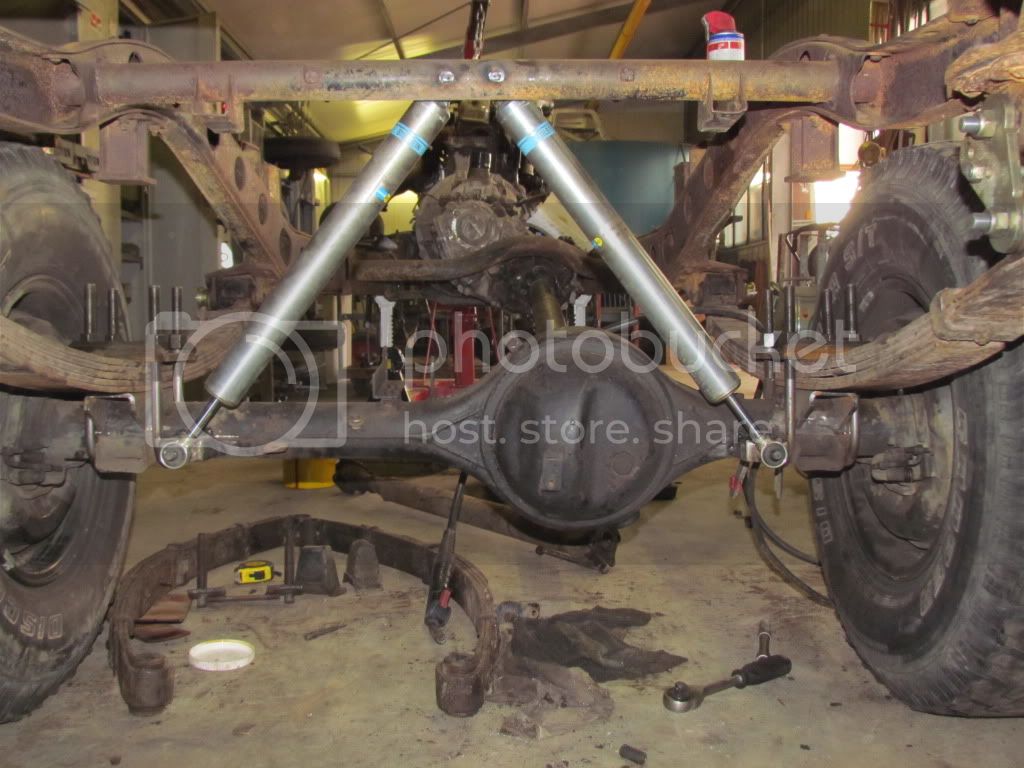

Than i moved to the rear axle. That's the easy one. In the mean time i placed the engine and transmission on the chassis to be able to get the pinion angle right.
At the same time i found out that 14" shocks are to long to be fitted, even when mounted on a angle. But i fitted them anyway, but that's all i have right now. I have a line on 12" billies localy, so they will be swapped.

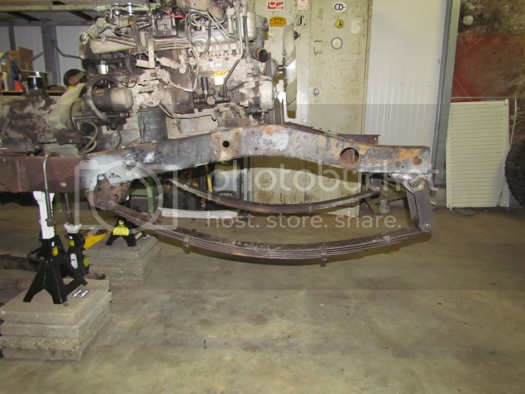

On to the front axle.
After reading a thread about using FJ60 rear springs on the front of a 40 series. I thougth what the heck. And i was lacking usable 40 front springs and rear 60 springs where easy to get.
I moved the fixed spring hanger 45mm towards the rear and the front hanger 10mm towards the front. And used a longer shackle to take up the excess spring lenght. This resulted in a pretty steep shackle angle, which should be good for droop.
Then there is the C&T. Eventhough it's not that hard, you still have to take the angle grinder to a perfect front axle. But in the end it's really easy, just nervewrecking.
I set the caster at 3 degrees. Thanks to Georg (Orangefj45). I was planning on 6 degrees, but he advised me against that much.

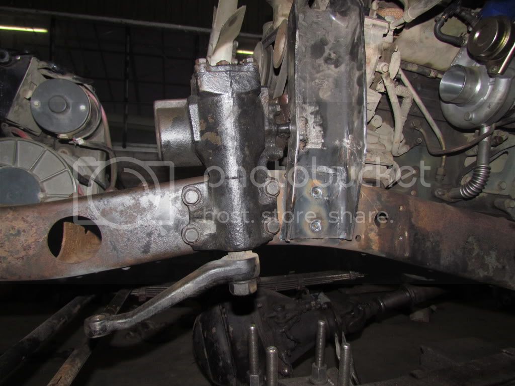

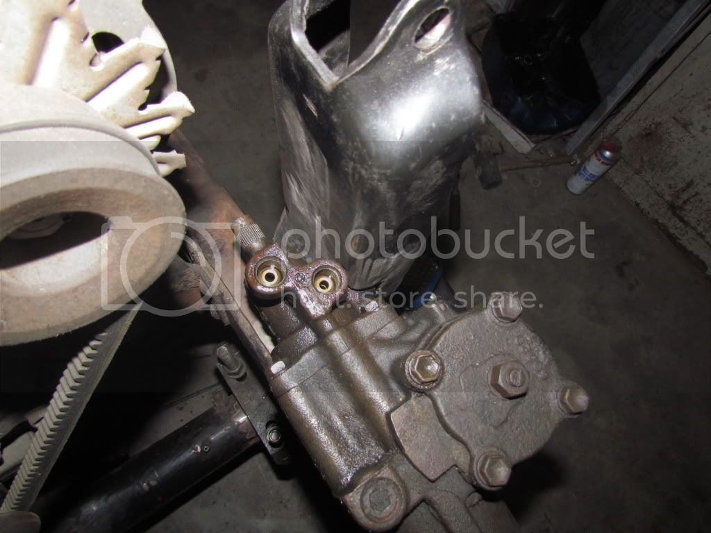

I also had to place the 60 series PS on the new chassis. Together with the Ford shocktowers it was a tight fit. Especially since i guess i replaced the steering box with one from an LJ70 Landcruiser. Which has a weird protrusion on it. That resulted in the shocktower needing surgery. But in the end it all fits.

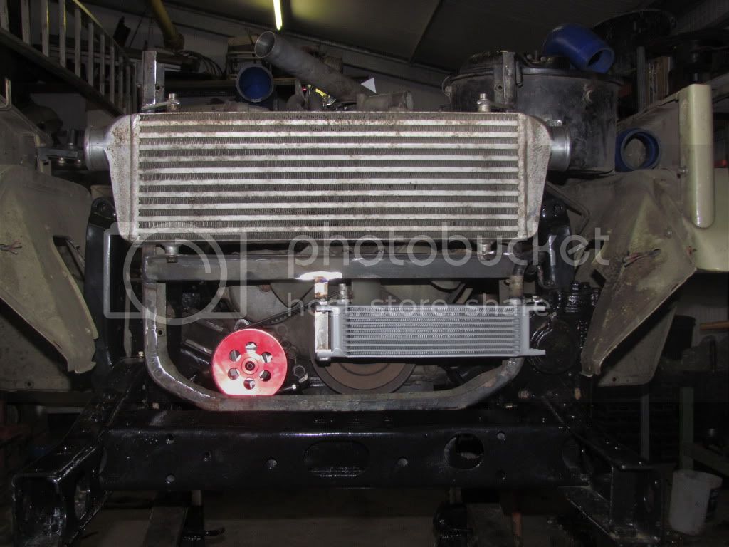

Next up was the PS pump. The stock one was tired and because i was planning on running 37" tires i needed an upgrade. I ordered a Trailgear pump and fabbed up a bracket to fit it on a 12HT engine.
I also moved it to the A/C pulley. This way i have a little more room for the lower radiator hose.
I also fitted a Mocal oilcooler for the PS. And with the intercooler it gets pretty crowded up front.

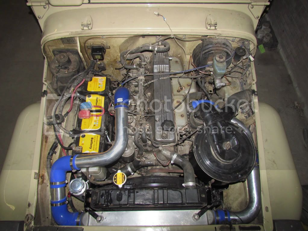

After mocking up everything i found out that because of the taller shocktowers there was no room for the intercooler piping the way it was before.
That called for a ricer blinged out intercooler piping kit and piecing together something that fits.
It doesn't even look that bad with the polished piping and i removed two restricions in the previous piping, which should help performance a bit.

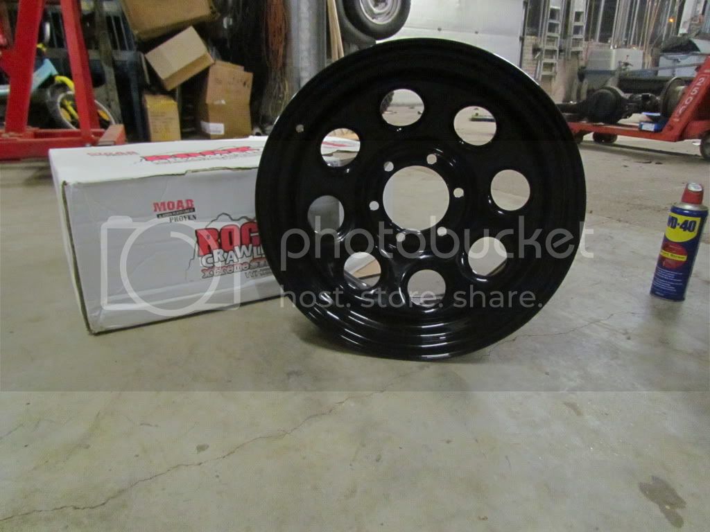

In the mean time i ordered a set of 17" steel procomp wheels from 4wheelparts. I couldn't find 17" wheels which i liked in Europe and in the end i got the wheels i liked for less $ than wheels i didn't like if i bought something overhere.
These are the ones i got:

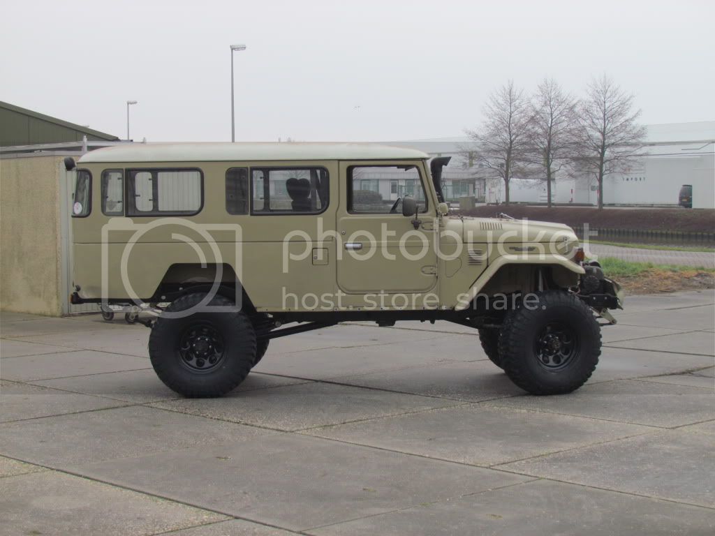

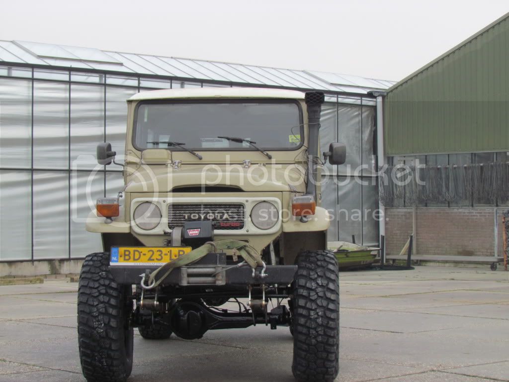

Then after all was done, this is the result:
And for fun a comparion with my other car:
The Troopie ended up a big bitch.:D
I still have to do some tidying up, but it drives so much better now than it ever did SUA. The only downsides, it doesn't like corners but it's not a sportscar anyway.
I took it up to ~90MPH and it tracks straight with no vibrations what so ever!
