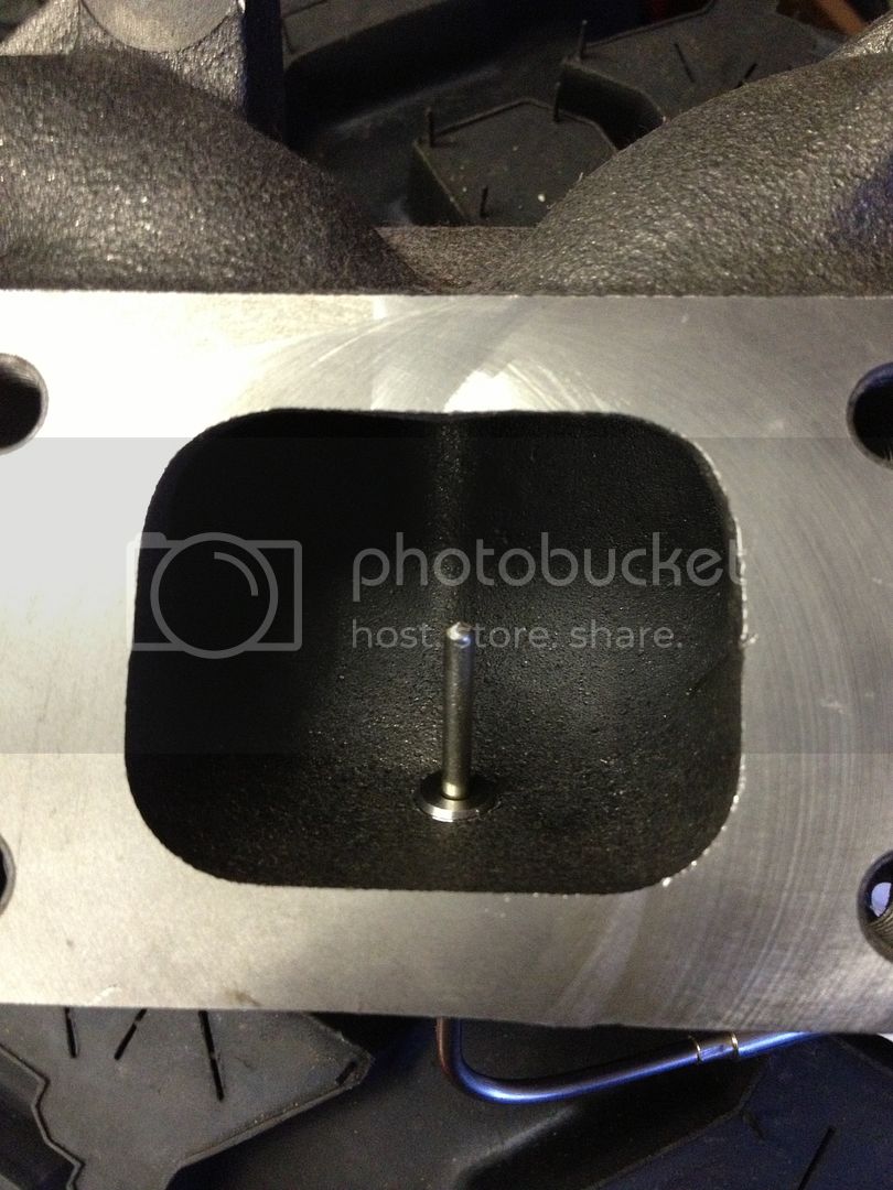

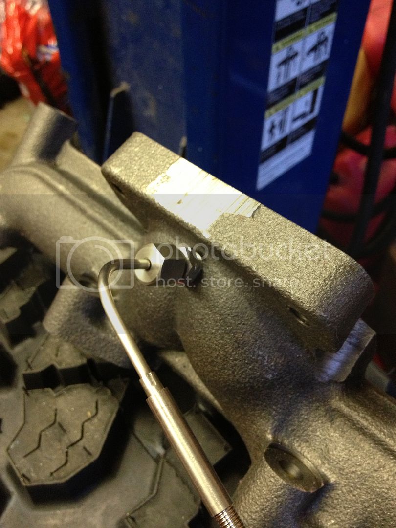

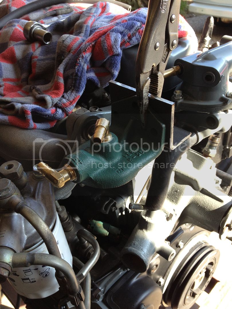

I drilled and tapped my manifold for the EGT probe and got the prob positioned right in the middle of the exhaust stream.

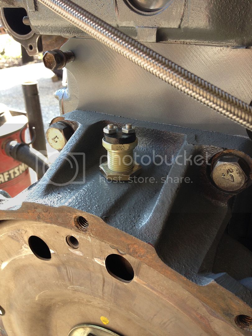

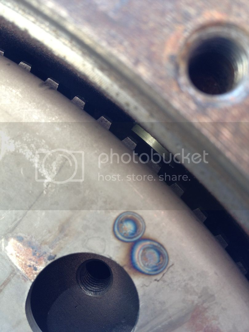

Then I installed my flywheel tooth sensor for the tach.
Backed it out from touching 3/4 turn (about 1/16th)

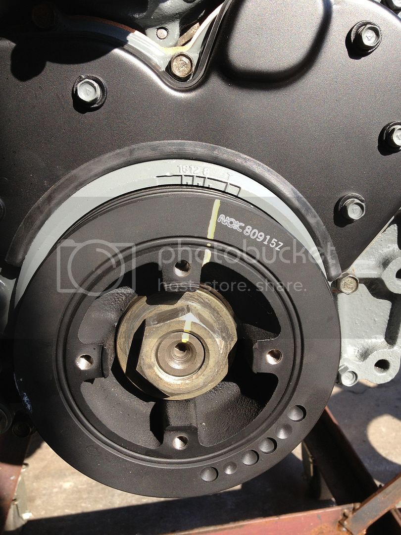

Crank damper installed and torqued to 315ft/lbs crank nut and damper marked to visually tell if anything moves.

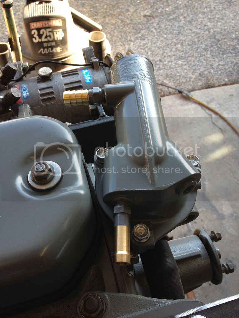

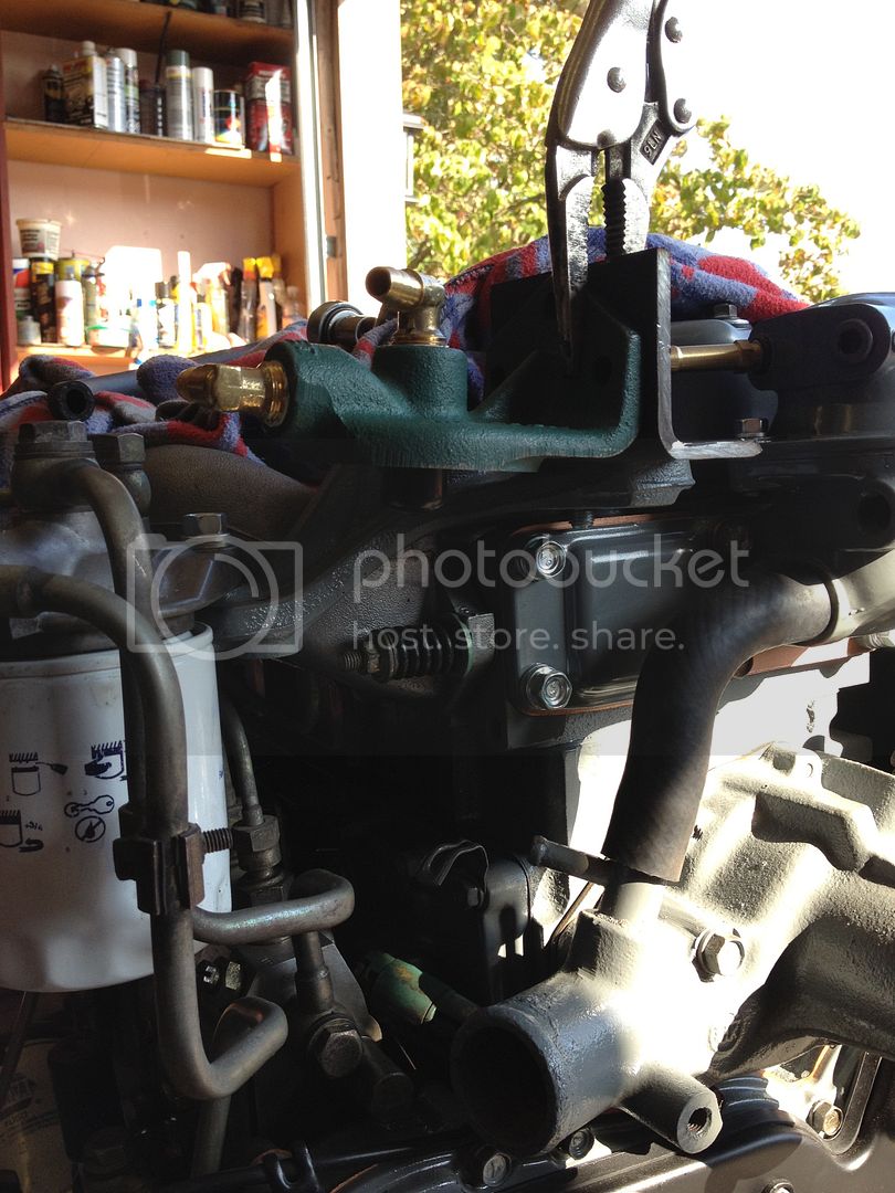

Wix coolant filter head mock up ( will wait till the filter arrives to finish.
Fittings installed for water filter and turbo water cooling.

As for the coolant filter, where are you tying into for the supply and return?

For supply and return its tied onto the fitting closes in the last picture that is the return. The feed is feed off the old turbo coolant feed by the water pump.
Main reason for doing it was you saw how rusty this things cooling system was. Secondly I saw how badly plugged my rad was on my truck when I got it. Thirdly it cant do any harm, its cheap so why not. I like to go overboard on things as I'm sure is evident ;)
As for interval of changing most say 40k miles. Im sure my first one will fill up fast. So will probably change it within 10k kms. The only way I know of to tell if its plugged is to feel if it gets hot along with the coolant or not.

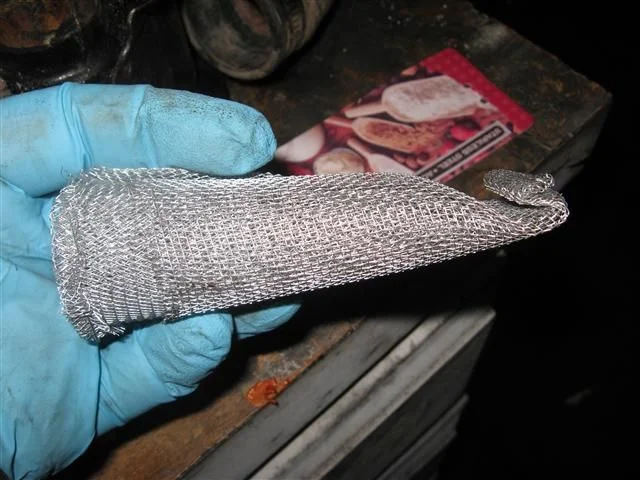

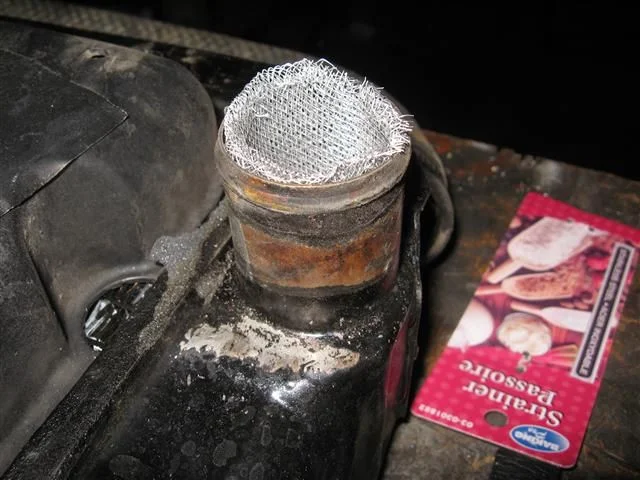

Here is that cone filter I talked to you about Jereme. It worked great to catch big stuff that would clogg your rad. It flows well and does a good job as a full flow filter. I accidently left it in when I towed my trailer this summer in my 1fzfe and coolant temps didnt suffer. That debris is about half the size of a pea from my 3B. Pretty big actually. I was shocked when i saw it. That was after the rad flush too.

Yes I am defiantly going to do that for the first few 1000 kms, do not want the rad getting all plugged up. The other filter I'm putting in is just a filter to maintain the coolant and keep particles form building up. I plan to flush the cooling system after the first couple thousand kms when I remove the mesh filter. Before any of this gets used though the engine is getting a good flush with the garden hose to flush out anything that broke loose since I had the block cleaned. The heater cores in the truck are going to get a good back flush too once I get the 1fz engine out.
Still got that mesh cone? ;)

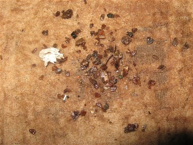

Yeah I sitll do. Let me know when your working on it over the next week and Ill come over with it for ya. It looks retarded, but worked really well. I did a back flush on my heater core plumbing and got disturbing amounts of crap out from them. They put out way more heat after. I think they were very clogged. That bypas filter is a great idea and will maintain your system really well. Your motor might shed scale for quite some time as the pics you showed from when you recieved it were pretty nasty.

I got a surprising amount of what looked like sand out of my heater cores when I back flushed them last. I think this coolant bypass filter is a great way to maintain the cooling system for minimal cost ($50 total). I have no doubt that this engine will have lots of crud coming out of it no mater how well I tried to clean it when it was apart.
If you mix green with red or pink, the acid in the red/pink causes the silica in the green to drop out as pretty much literally sand.
Yeah, mine was full of it when I first got it. I completely flushed the system 2-3 times and then filled with new red. I think I am going to do the same again and just fill with regular green. There will be no Red/Green mixing going on. The main concern at this point is just stuff working free from the engine since it was such a mess on the cooling side. I know the rad is clean and do not want to have it get plugged up.

A far as your coolant filter, isn't that the thermostat housing, thus no flow until it opens? You mentioned the t-stat or upper connection was your return,,,,that should be the inlet or pressure side, hot coolant is pumped into the block at pump and out the top rad hose?

I have been fighting trying to figure out the flow of the cooling system. I picked the two lines that I have because they are the same ones used by the stock motor to cool the turbo. Also I believe that the hot water flows out of the engine on the top rad hose ( if cold water flowed into there the T stat would be continually closing with the inrush of cold water). Honestly though I had the hardest time trying ot visualize the flow of the this cooling system. If this filter is only filtering when the T stat is open that's ok, not idea but I do not have many other choices.

I'm going to leave the coolant filter plumbing and mounting till I have the engine in the truck now the way I had it plumbed it was going to be a high point in the cooling system and that would not work.
