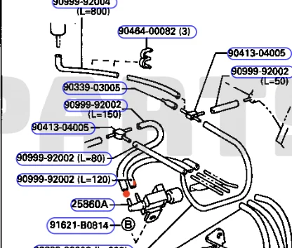

I had these two vac hoses swapped, still lagging but just 1hdft lagging. Doesn't helping that all my other turbo diesels have been highly modified 5.9s.

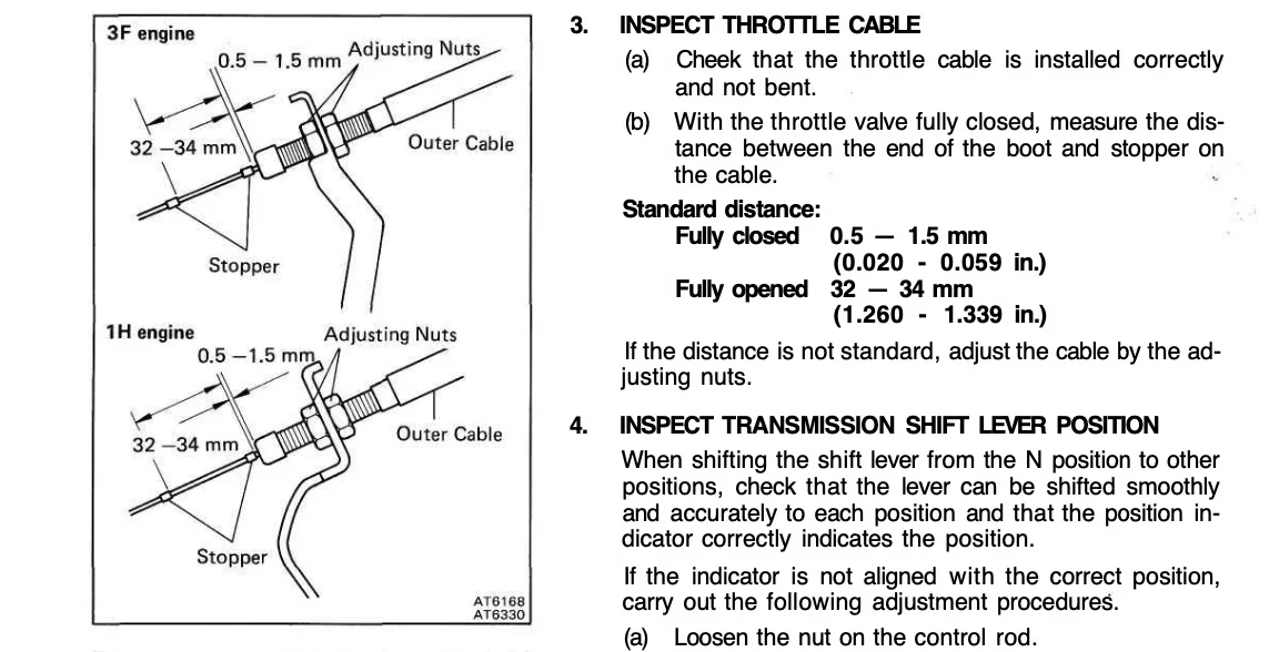

Worked on the Rig last night, no avail on still dealing with the lag. Then through a deep search saw someone mentioning the exact same symptoms as me and it ended up being the drop down cable to the tranny.
So I adjusted this morning before work. Holy cow! Night and day difference. The cable is pretty stretched so I will be ordering a new one from Radd Cruisers.

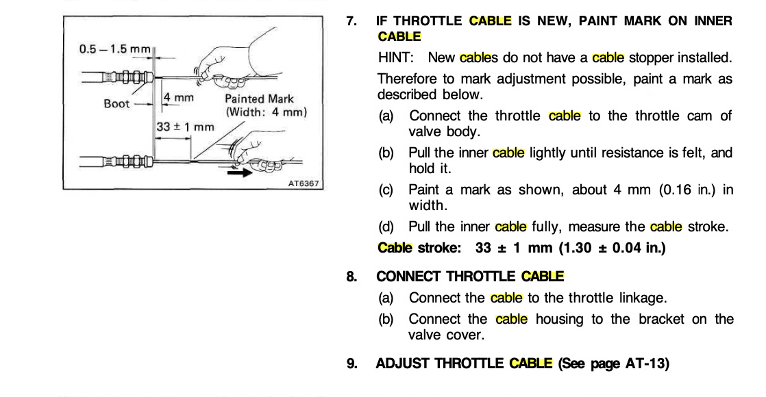

Any advice on kickdown cable adjustment? My 93 has similar lag. It's not as bad as yours. But definitely needs adjusted.
My kick down cable did not look the same as whats in my FSM, but I adjusted (tightened) per the manual and just did trial and error. Based on the fact my doesnt look the same, I think mine has already been replaced as it only has one stopper. Since I don't know the history of the vehicle I will replace anyway though.

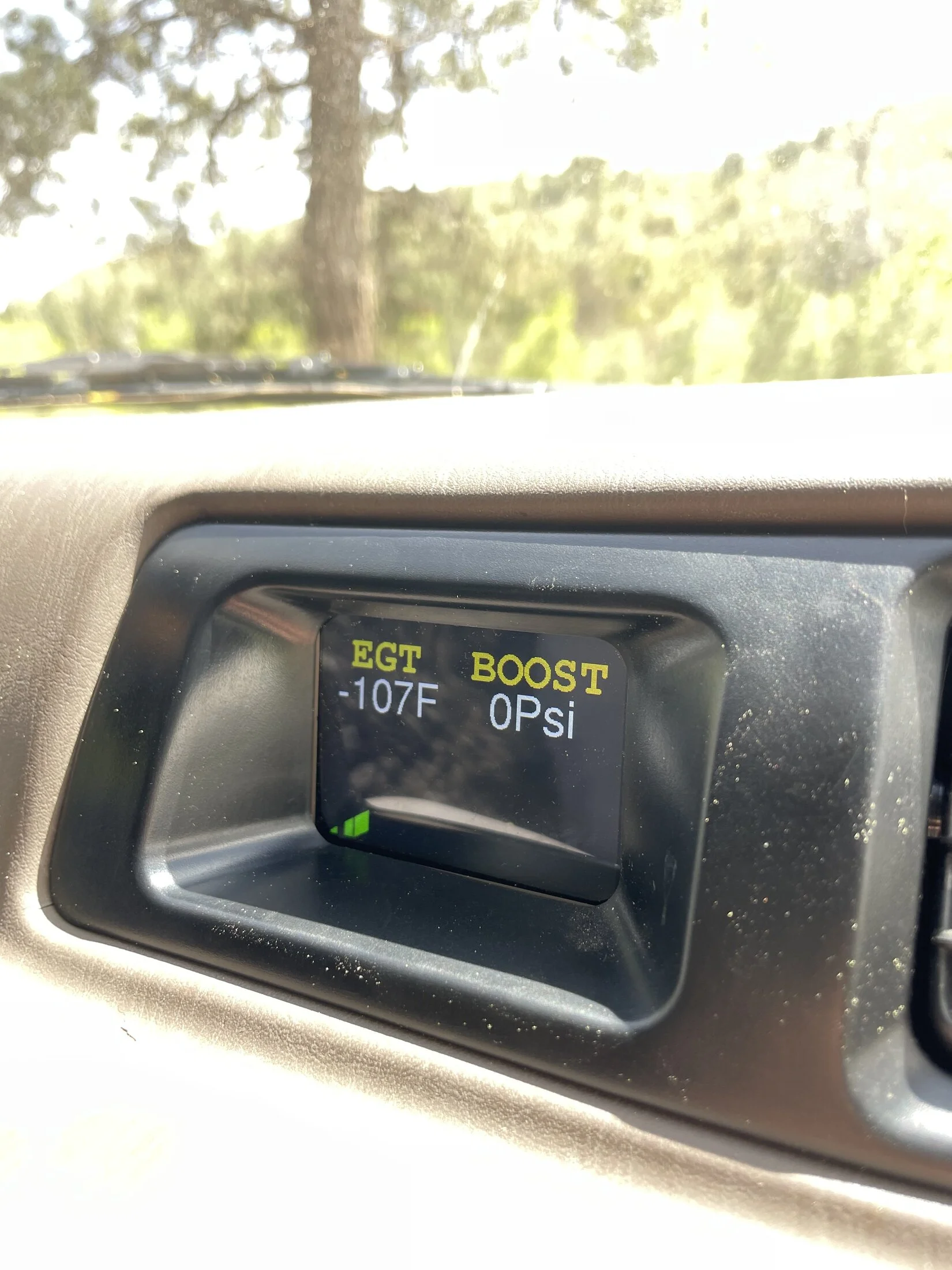

Installed Lutz Auto gauge system. Was the only one that I though was really clean and I don't like things stickingout. (a pillar are sexy though). Pretty straight forward process, well made kit. The only problem is 30 year old plastics. Started it in the morning and ending up waiting until it warmed up because I felt like the cold plastic was going to shatter!

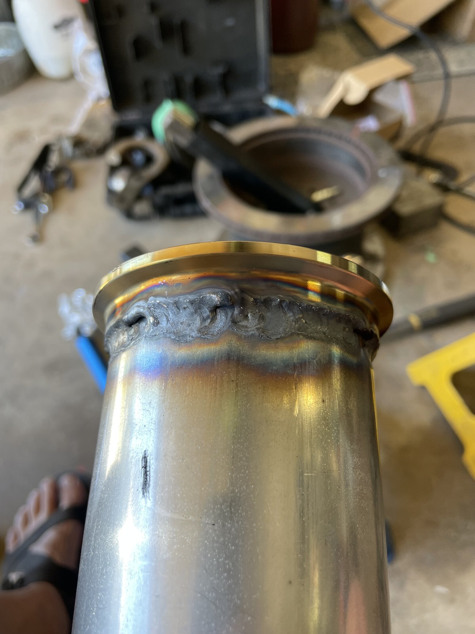

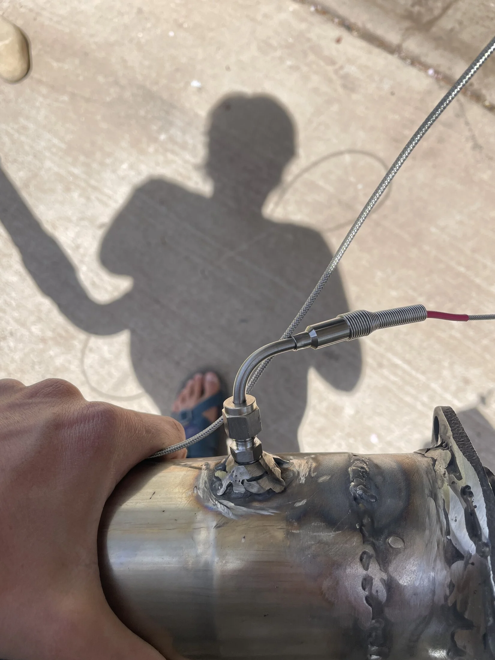

"welded" a bung onto the custom Exhaust I am in the process of making. I am not good at Tig. Will eventually pull everything off an fill an grind to look pretty with my buddies mig.
