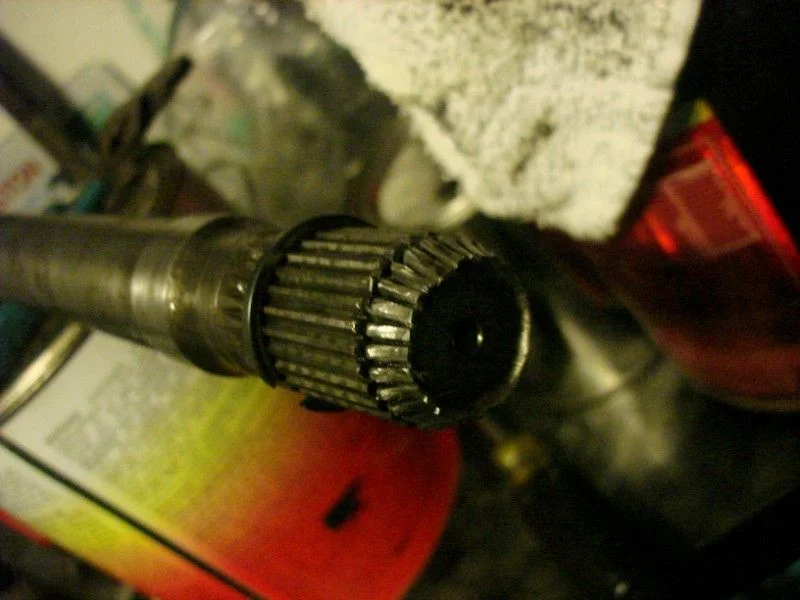

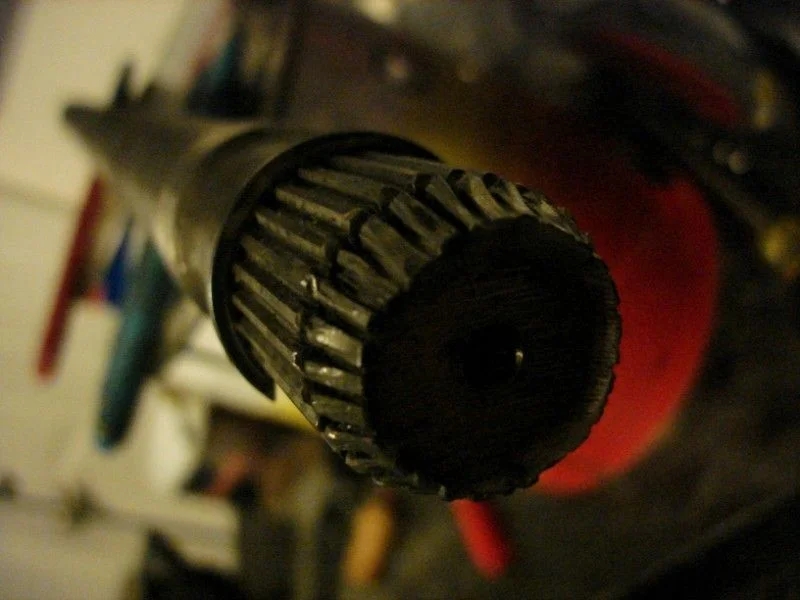

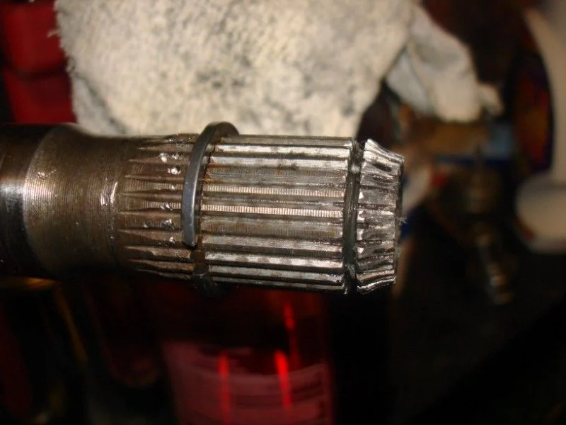

Doing a C & T so I decided to rebuild the knuckles. This is what my long side looks like. Is it safe to run it? DSC02690.JPG
Like he said, shafts are cheap. But if you don't figure out WTF caused that, you might be in for the same...or worse.
Keep digging.;)
Best
Mark A.
I was gonna suggest that a brokenafued one was the cause, or maybe a smithereenified one but you might be right. ;)
Mark...
Thanks for the replies. I found this while rebuilding the Birfield. The Birfield, race, cage and balls all look fine. What else needs to be checked?
As aside, I have never driven this truck. I got it as a project and I am still putting it together.
Thanks
Brandon.
Hey!! Maybe it's a new method of getting the C-clip into the Birfield......NOT!
Were you using Aisin hubs on a 75-78 front end with the longer birfields?
I am using Aisin hubs. But I cannot say for sure about the rest. My 40 is a 71. and the knuckles have been clearanced to fit the larger knuckles and disk brakes. Mini truck swap is possible?
