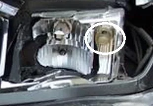

BTW, if you happen to go back to the yard.......I'd about kill for the little plastic cover over the parking light bulb. Can't find one anywhere without buying the entire light assy. One small philips screw and its off!
