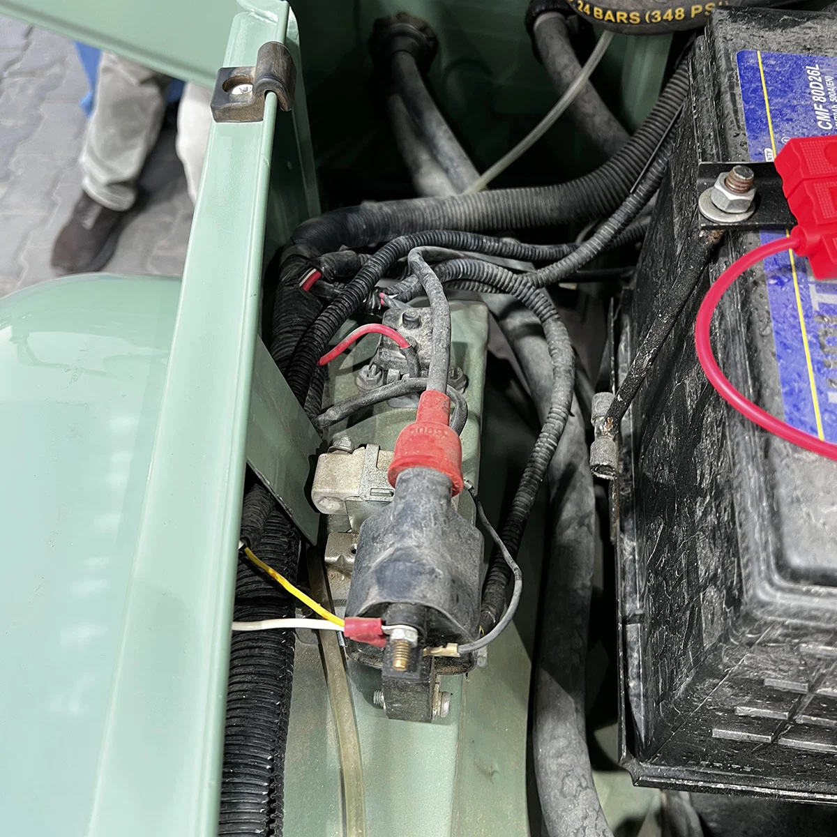

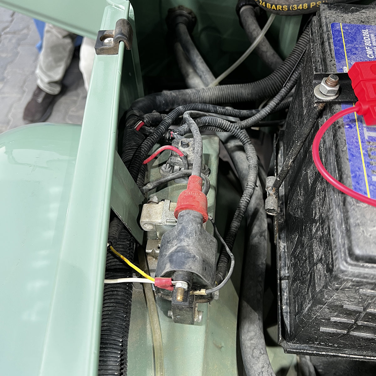

there isn't a coil installed i think, well it's not the cylinder coil at least. they installed this for me:
Not familiar with your particular vehicle, is that coil factory? Looking at the wire connection could be also poor connection.
no, not factory, i actually hadn't seen a coil like this except in my vehicle, not even sure how to search for it online since ignition coils brings up the regular cylindrical ones.
The coil could be your issue also the wires seem too small for a coil and it needs to be solder in all terminals and sealed.
