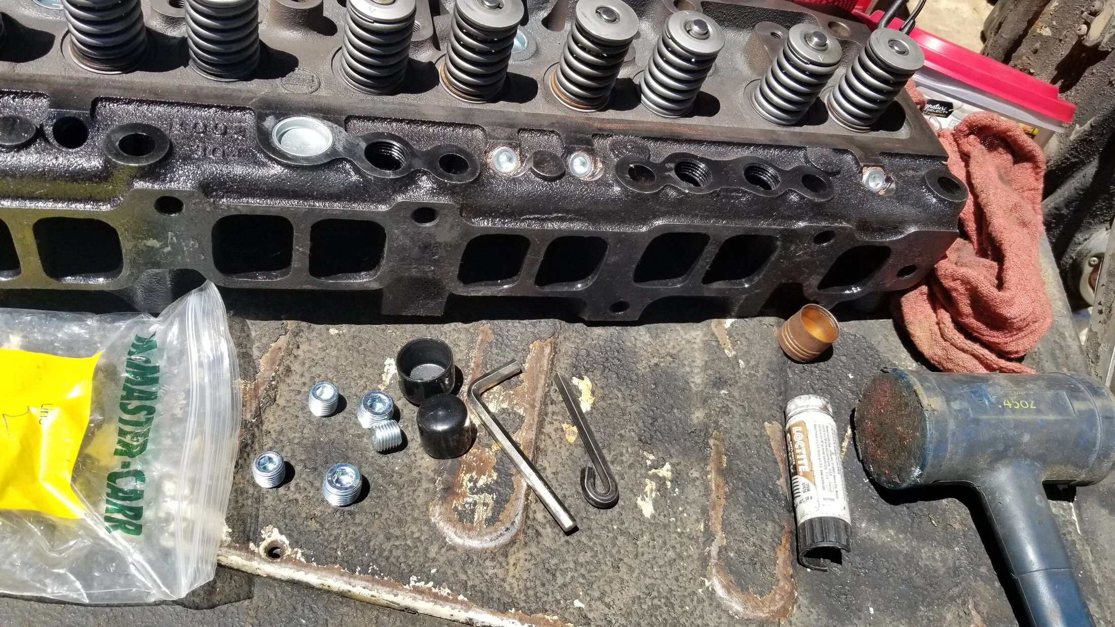

Here’s what I found the beginning of the year. 10 pieces for $8.95
I have a 2F engine and they worked great.
Jim C. Has a storefront here, he sells a kit for a 2F air rail delete, very reasonably priced with quick delivery. Comes in a Mcmaster-carr bag. Comes with some extra parts too

For extra buck or two total nickeled brass over the steel would be my choice. Be sure and consider shipping, I buy a lot of stuff on Amoron all the time - I have nevered paid for shipping.
What type of thread sealer should be used on these air rail plugs?
Liquid sealant for high-temperature applications. Loctite makes one.
