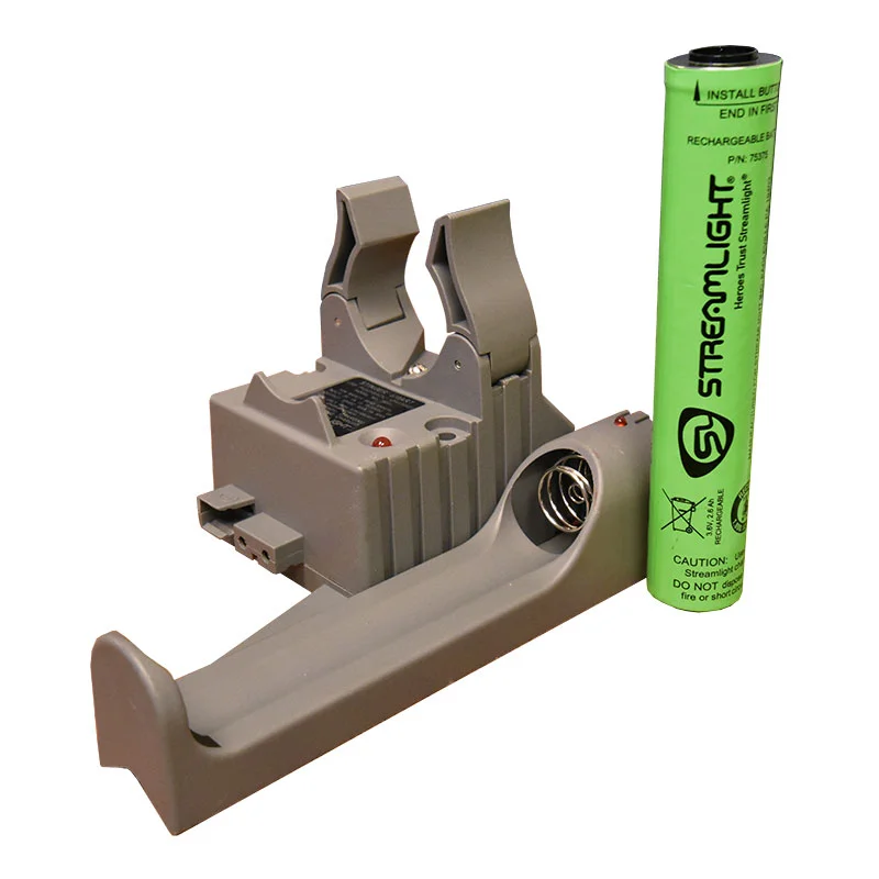

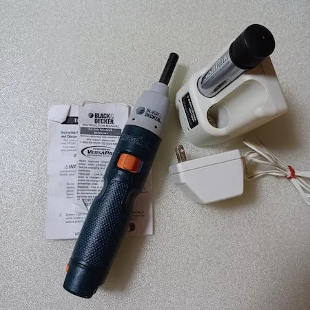

Your post made me think about an old Black & Decker VersaPak screwdriver - that I still have around here somewhere - and also of the StreamLight that one of the guys at the shop has that kind of reminds me of the B&D setup...
That got me thinking about updating the old screwdriver (which offered Ni-Cad or Ni-MH batteries) - which led me to this: Black & Decker Versapak Upgrade to Li-ion - https://www.instructables.com/Black-amp-Decker-Versapak-upgrade-to-Li-ion/
The initial (2008) Instructable uses two RCR123A Li-Ion batteries, but down at the bottom he has an update where upgraded it again to an 18650.
I know that doesn't help you much, but I might just drag the old B&D out and see if I can do the 18650 upgrade to it.

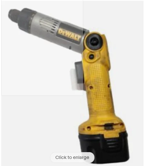

mine looks like the one below. Must be 20 years old. Was quite nice actually, although big by today's standards. Can be made straight or with a pistol grip. The NiCads are about dead. They are smallish 7.4V pods, a bit short for an 18650. I've been toying with the idea of replacing the nicads innards with a couple of 18650s in a tray of sort but I need to find one that can handle more current than the usual piddling amount. Or maybe use those individual connector caps they have for large banks of 18650s.
yes, that would be perfect, but I don't have a 3D printer nor do I know how to use one, so maybe some day on that one, but not quite yet, sadly. But for the time being, one can do wonders with epoxy and time.

The old batteries probably aren't Li ion though, so the BMS won't be right.
yes, I would need a BMS too. Fortunately, I think you can buy 18650 with BMSes built in, maybe that's enough.
I am stunned, BTW. I watched a disassembly video of that old Dewalt screwdriver. That thing is built amazingly well. All cast metal, ball bearings out the wazoo. I don't think you can buy anything like this today. And I really like the idea of having the adjustable clutch. So more incentive to fix this rather than getting a new plasticky one. Mine is more like a hybrid between a screwdriver and a drill/driver, I think.
