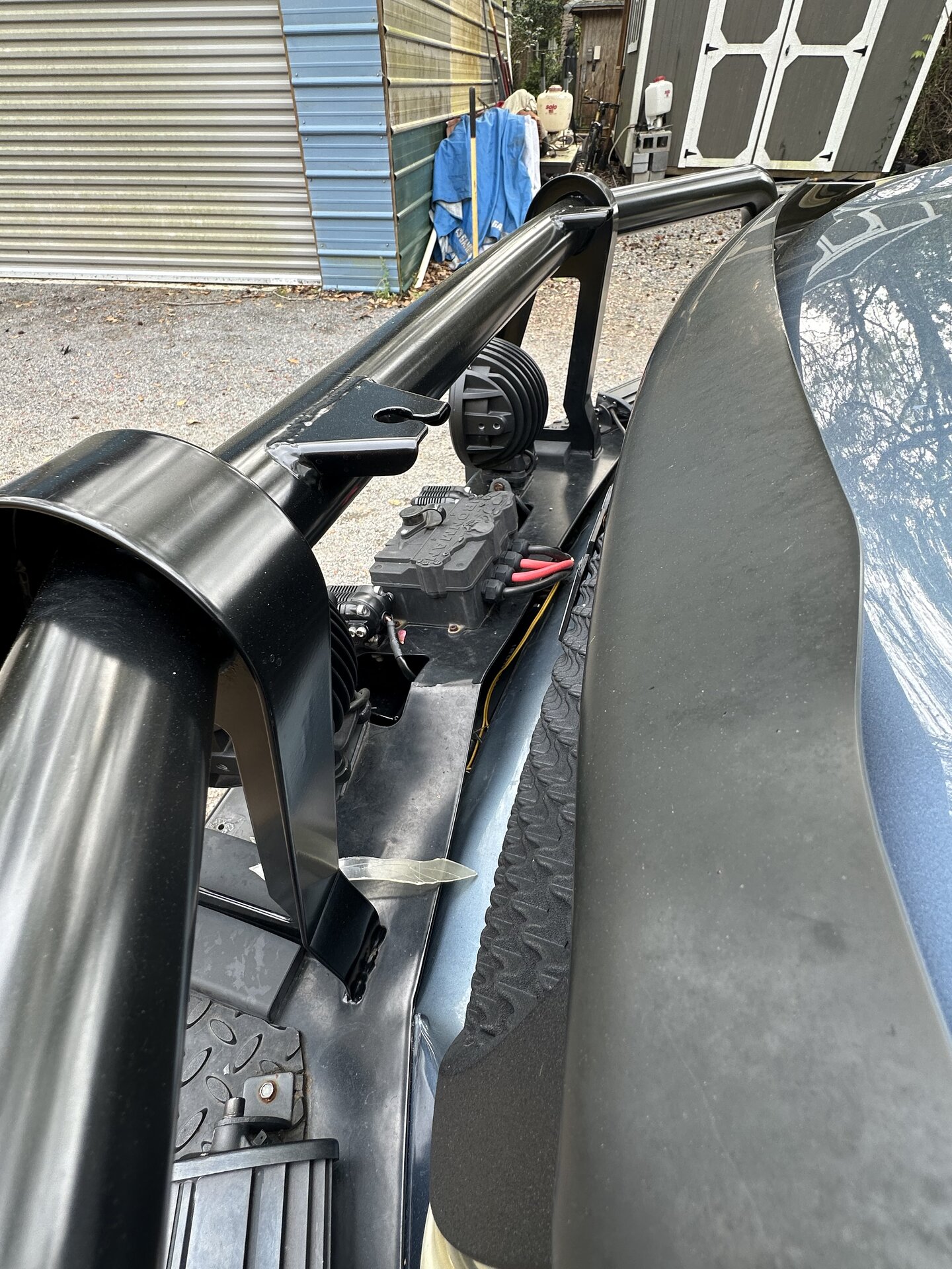

If you have the Forged UCA’s and haven’t replaced them or at least replaced the Upper Ball Joints yet. I’d get on it. I’ve never seen a ball joint come apart like that. I was in LE for 26 years and worked a lot of collisions. I’ve seen them shear off in collisions and I’ve seen them shear off on the trail but never just come apart going down the road.
To get back on the road required, new upper ball joint (moog), lower ball joint, new CV axle, new brake hard and soft lines, and new abs sensor wire.
I also have to order a new headlight and a new bumper. Probably going to end up getting both headlights so they match and may end up replacing the lower control arm on that side since everything got tweaked. I also have a new set of UCA’s ordered that will be going on as soon as they get here.

We replaced the upper with a Moog to get back on the road. New set of UCA’s are supposed to be in the way. If they aren’t here soon I may go ahead and replace the other side with the Moog. Going to relic run in a few weeks and not wanting to drive 4 hrs pulling a rig on a trailer with the Ironman upper ball.
I had emailed them with my order number to see if my set was part of the recall and never got a response. Like you, put it on the back burner because I figured they’d get back in touch. Nope. Just driving down the road and the joint popped apart. When I contacted them they said my email went to the Australia recall office.
On the bright side. If there is one. The bull bar took the hit like a champ. 30 mph hit and other than the bumper cover, headlight washer and the headlight it was minimal damage to the truck
