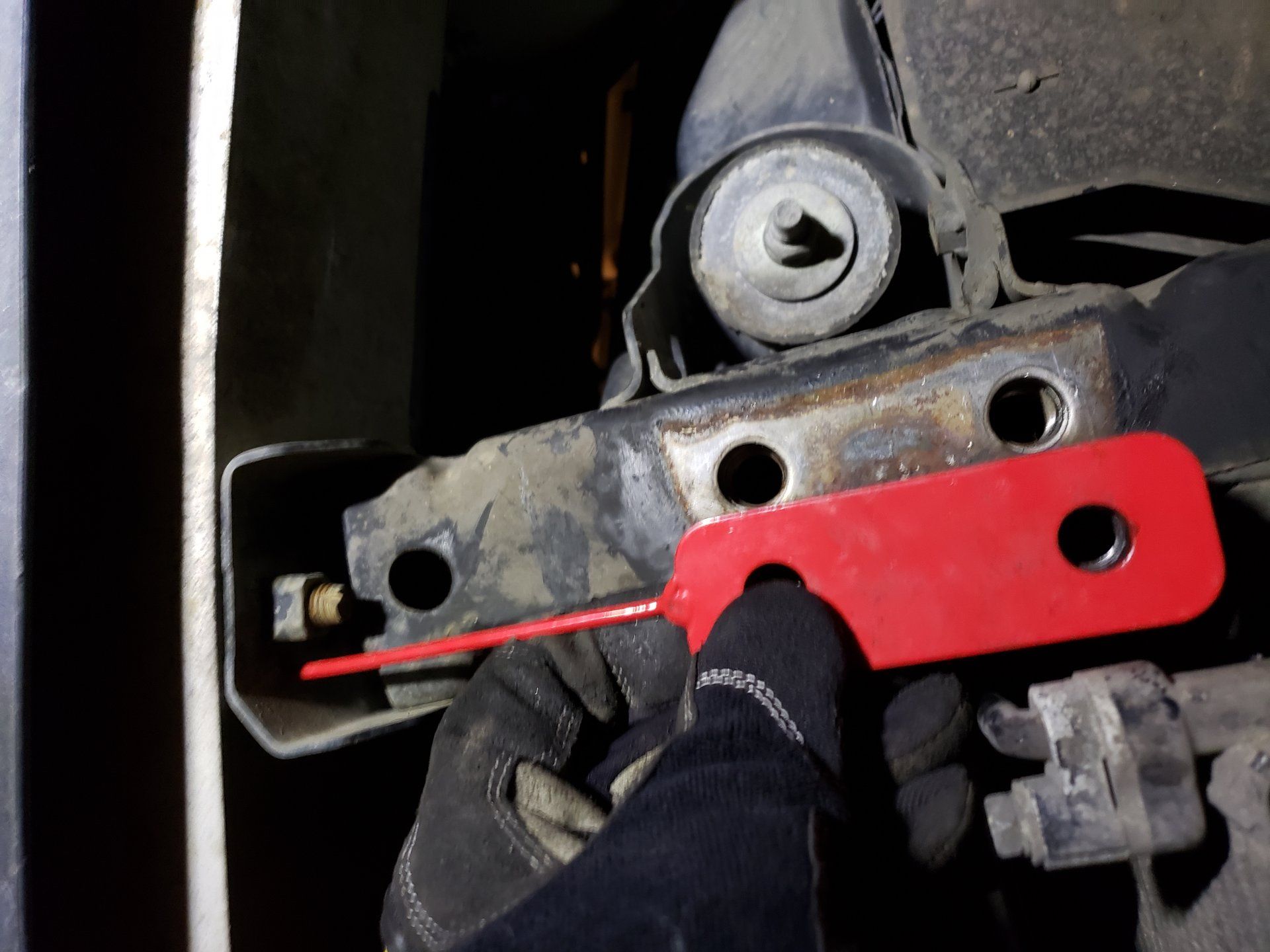

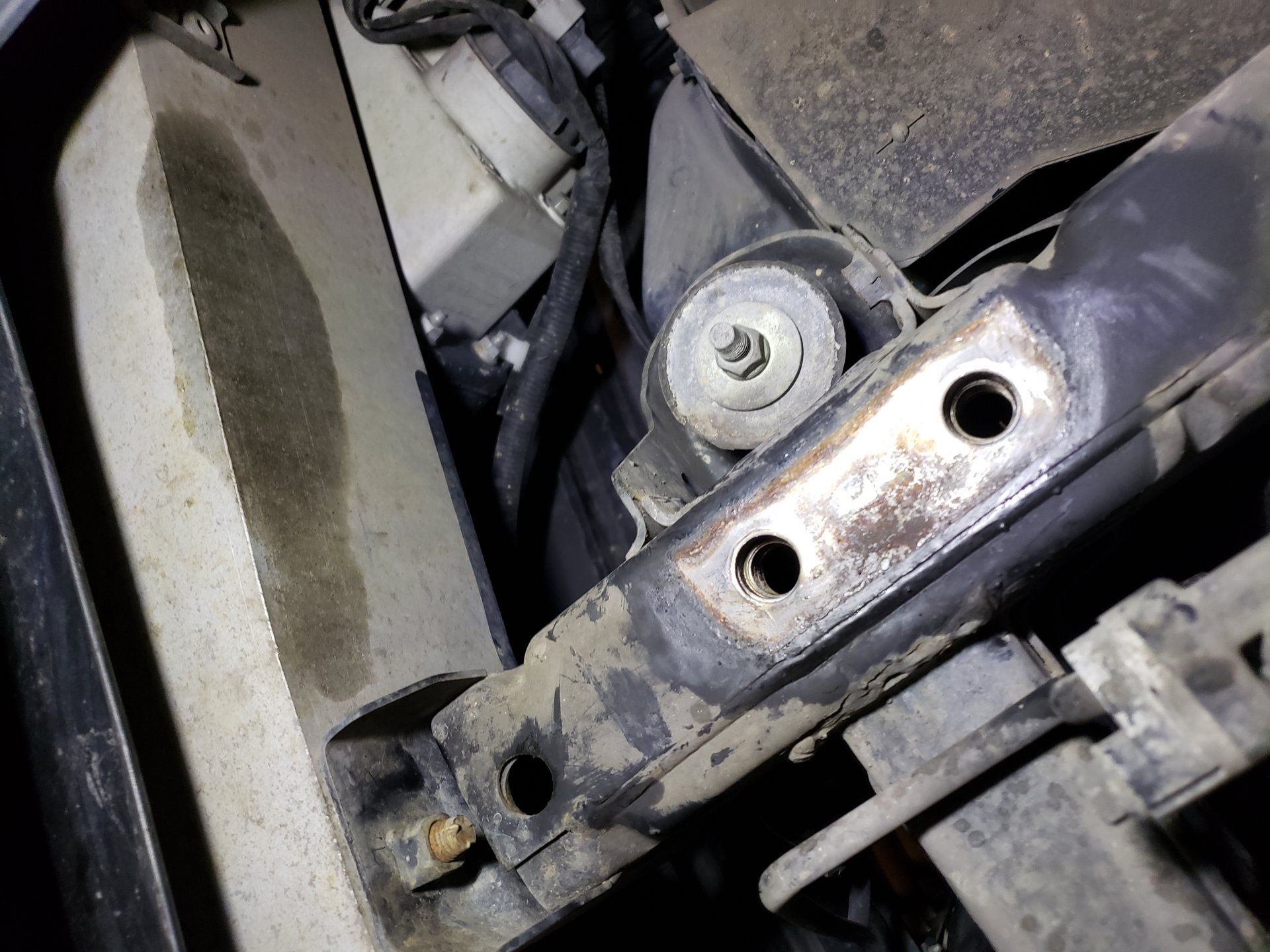

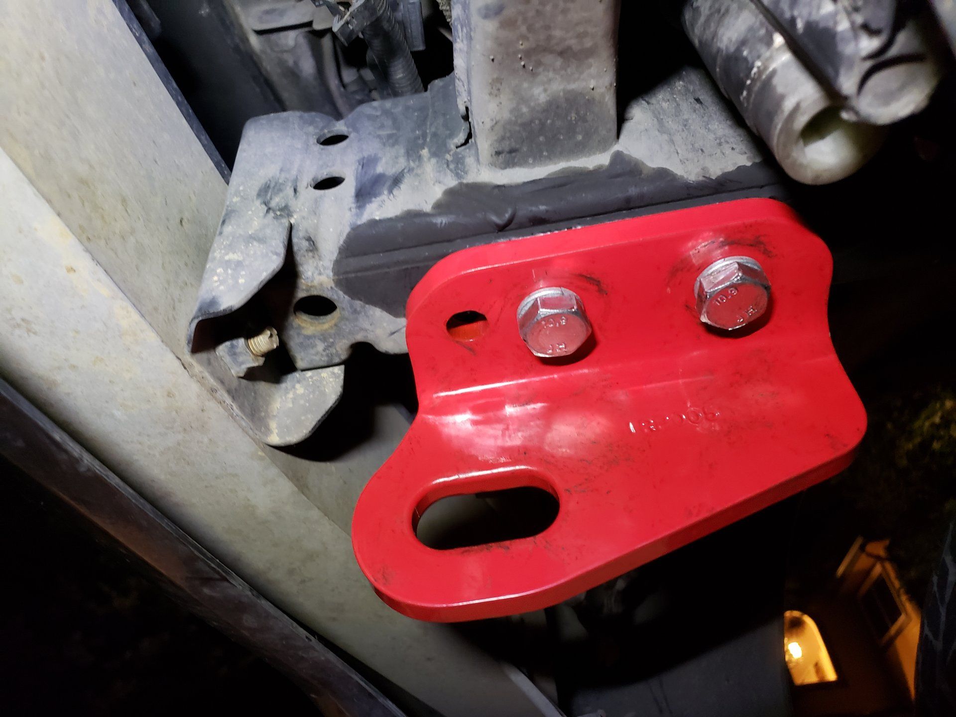

I'm stuck on the driver side install, the instructions are a bit unclear and not model specific. There's a supplied "nut plate" they say to side inside the chassis rail, and the nuts on the plate are a different size than the hole/thread in the frame itself. There's also a weird bar sticking out of the plate that appears to be a spacer but the spacing is slightly off.
Do I need this plate at all, or can I just bolt it right to the frame like the passenger side? Attached are pics of the passenger side, instructions, plate next to frame, and frame holes.

@Lalalx470 thanks for the pics, I wasn't sure on the non-lock washer either. The instructions left a lot to be desired for the less informed (like myself), but I figure people who have been doing this a while know how to do it blindfolded and don't need the manual. Having extra bolts + plates in the box did not help my confusion.
