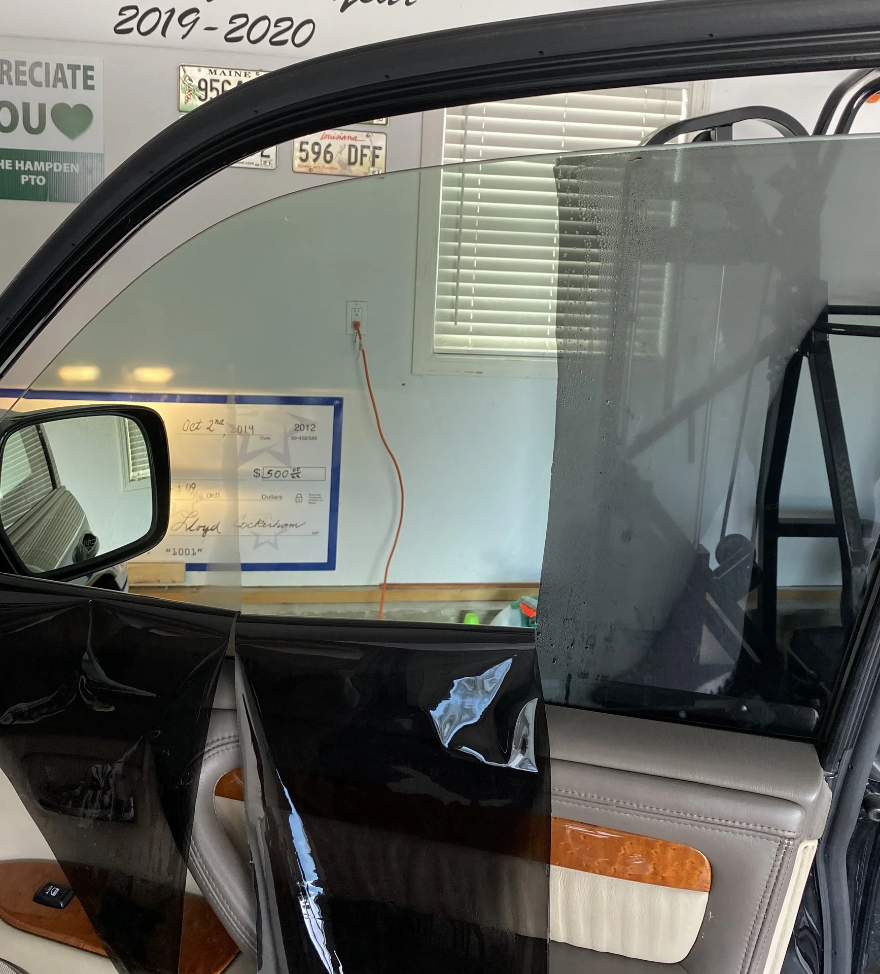

Day 1: Bought it and went for an inspection the following day. Failed for the aftermarket tints on the front windows. Put my wife’s clothes steamer on em and took them off with a razor and a careful hand. Got my sticker right after.

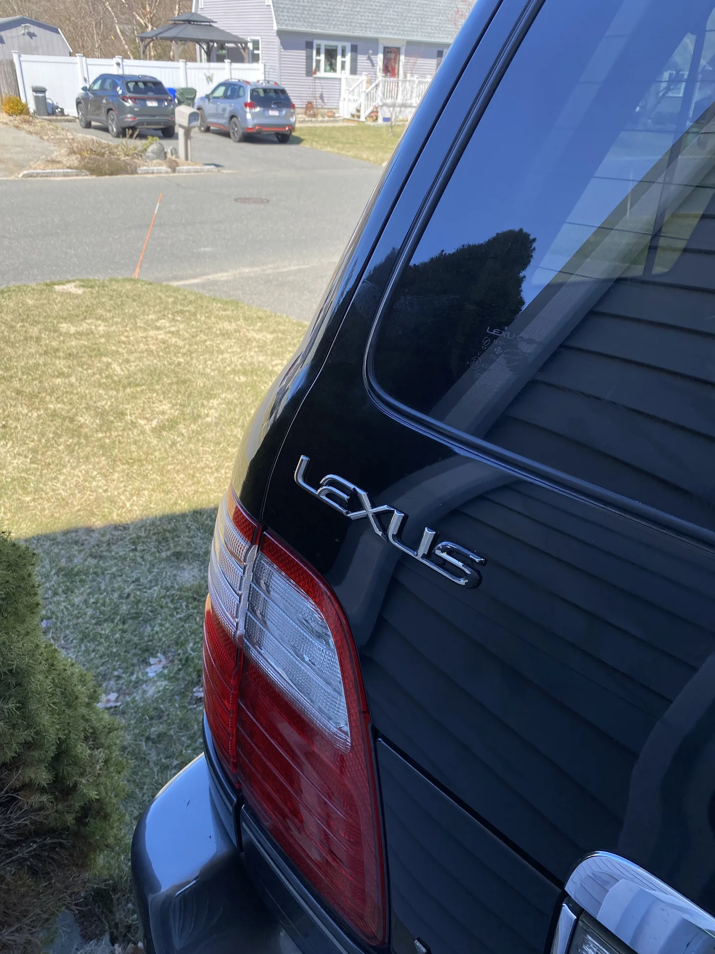

Next up was removing the plastidip on the rear badges. Wd40, plastic “pry” bars and a cloth and all set in no time. Nice chrome underneath the Lexus and the LX470. Under the “L” symbol is gold, so I left those dipped for now. I’ll have to circle back and match ‘em.

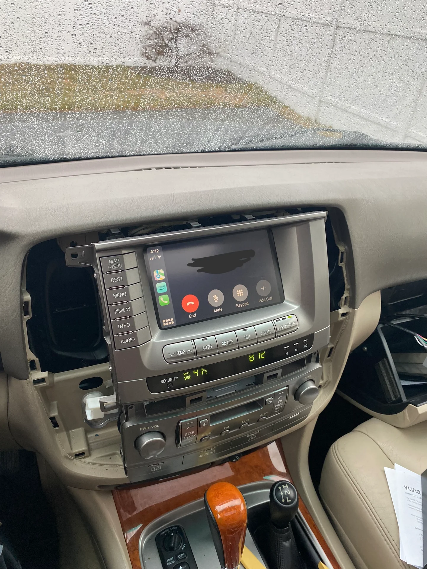

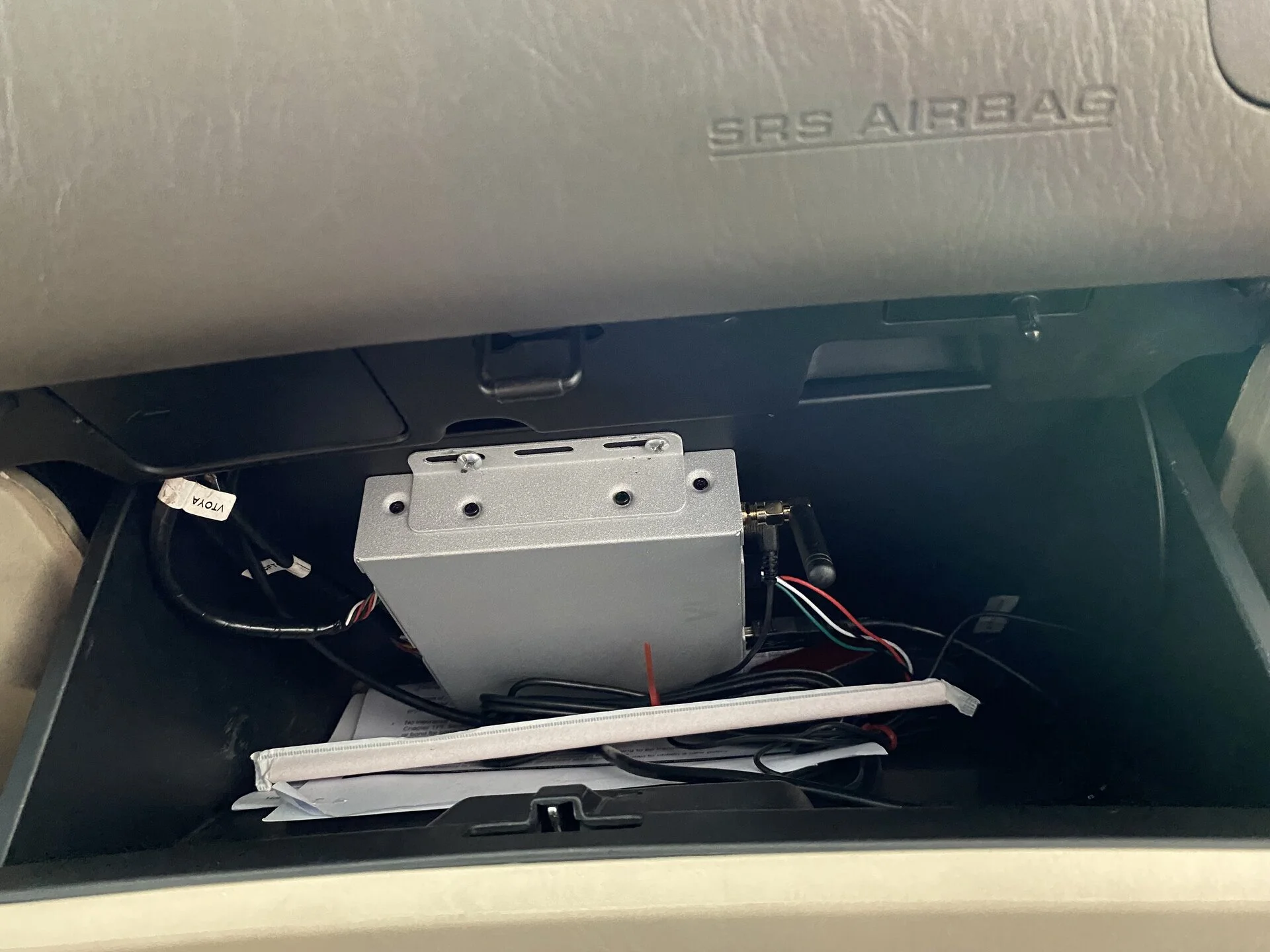

My first decent sized solo job was putting in the grom vline2 for apple car play. Electrically it was a simple plug and play. To get there, you really gotta get into the guts of the nav unit. I was impressed that none of the trim snapped in this process. I ended up mounting the unit in my glove box. I later took out the cigarette lighter to install a USB pass through. At the same time, I mounted the microphone behind the rear view mirror. Install came out CLEAN by the end of it.

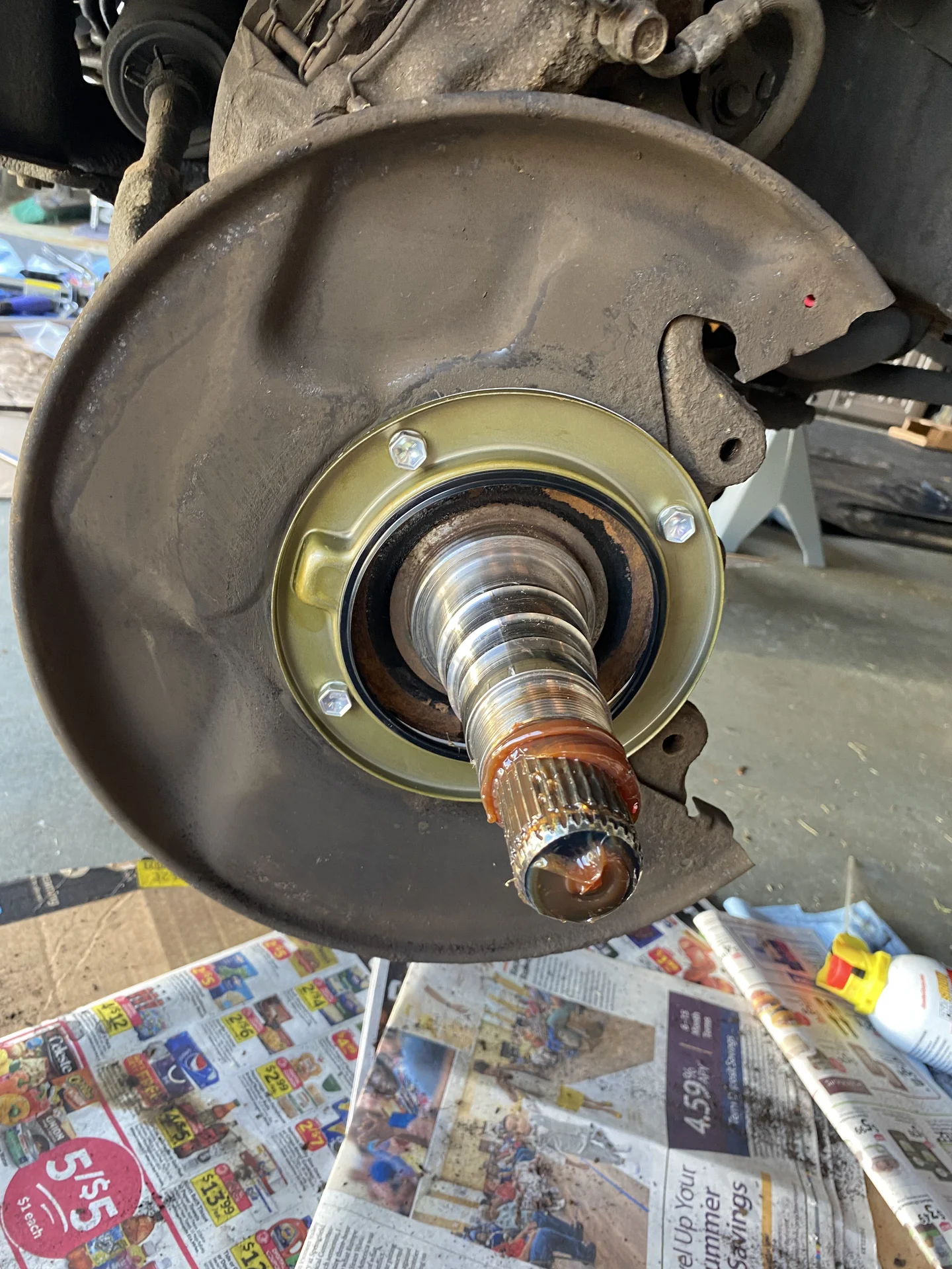

Getting a little more comfortable mechanically, it was time to address the wheel bearings. The pre purchase inspection noted a failing wheel bearing, passenger side. I noted nothing when driving and didn’t feel excessive play in the wheel when I had the vehicle jacked up, but I did know the bearings need to be repacked every 30K. Opted to bang out rotors, brakes and brake fluid “while I was in there.” Rotors were probably ok without replacement, but brakes needed some love.
On the passenger side I wasn’t happy with my seal installation. The seal was noticeably deformed. I should have used something bigger to evenly tap in the seal. When I put everything back together I could hear noise when spinning the rotor on the shaft. I pulled it all out and put in a new seal, also I packed a bit more grease in my inner bearing in case that was the source of my noise.

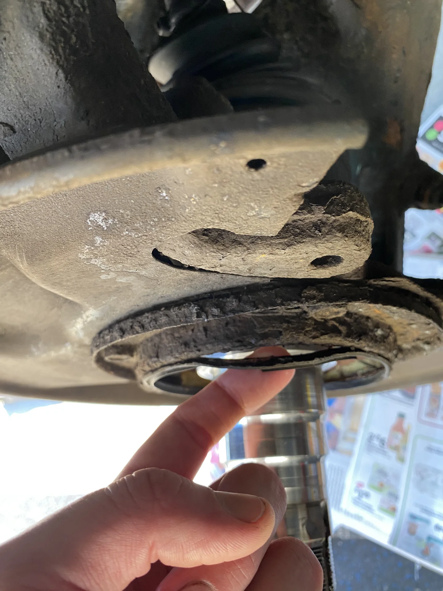

On the drivers side, I had a hell of a time with rust. Root cause was the “Knuckle Spindle Oil Retainer” was shot. I had to order a new gasket, hardware and neck. The passenger side wasn’t as bad, but will plan on replacing the retainer next time.
Con'td
During the wheel bearing job I was hemming and hawing over the spindle bearings and greasing them. Eventually bought the slee tool and some ngli 1 grease.
While I was waiting for parts, I pulled out the power steering fluid reservoir, soaked it in degreaser and then blasted it with brakleen. Slapped it back on and did a nice flush. There is slight weeping on my power steering rack, that Lexus flagged on the PPI. Hasn’t moved a bit on the reservoir, so I’m just monitoring. I made sure to flush slow and threw in some AT 205 with my flush and fill. I know there is risk in doing a flush and it’s believed sediment in an old system can help keep things plugged. I simply don’t believed deferring maintenance is the solution for deferred maintenance - so I’ll roll the dice.
Still waiting for parts, I went ahead and started a brake fluid flush using a vacuum bleeder. Rear brake bleeders were shot. Got replacements in short order and bled all four corners. Since I’ve got 2 bottles left of Toyota DOT3, I’ll come back to the rears when I hit rear brakes. Laying under the rig gets old after a bit!
Parts in and hubs back on. To my dismay, no room for my circlip. Thought I royally botched the job. Turns out, it’s pretty common. Eventually found out TheForger on here makes a CV Puller. Pulled em out and bought myself the clearance to install the circlips.

Happily! Since mine has navigation it’s a plug and play. It wasn’t cheap, but I did get 20% off buying through a group buy I found on subreddit r/Lexus. The Grom Vline2 uses the existing screen, so brightness and quality are not ideal at times, but Grom did they best they could have to plug and play. Since the AC controls also live in the navigation unit, we’re a little boxed in.
Only hiccup I had was the unit stopped working which was resolved by swapping to the other usb port on the unit.

Any way you could post some pics of the glove box and how the Vline sits in there? Did you adhere it to the glovebox itself or is it floating? Do all of the cables get in the way of the box opening and closing? Is there any strain on the wire connectors when opened or closed? Thanks!
It comes with mounting brackets, which I used for my install. The wires are long enough to allow opening without issue or tension. To get the wire runs right you’re best off removing the glove box (like 2 screws), and then you can see the open channels you need to use.
My mic wire is going off on the right and everything else is on the left.
My mic wire is going off on the right and everything else is on the left. View attachment 3436516
Nice finish to the install. Mine is still unattached in the glovebox. I've been meaning to move it to the center console and maybe have it take the place of the stuck CD player.
My DVD player lives in the center console, courtesies of the previous owner. So thankful they didn’t install it like barbarians, since that might have made my grom install an exercise of patience. The glove box is so uselessly tiny anyway I just threw it in there.

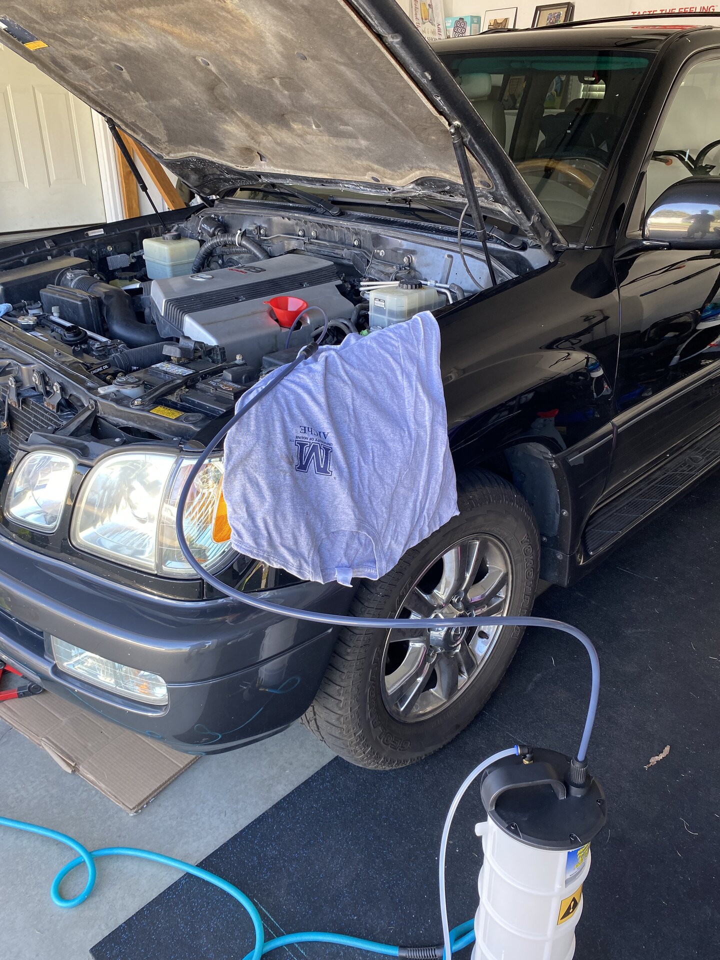

I used an extractor and sucked out the oil from the dipstick. I wouldn’t necessarily recommend this but I didn’t want to open a can of worms. I got out 6.3 L or so, so I feel good that old stuff is out.
Oil change done!
